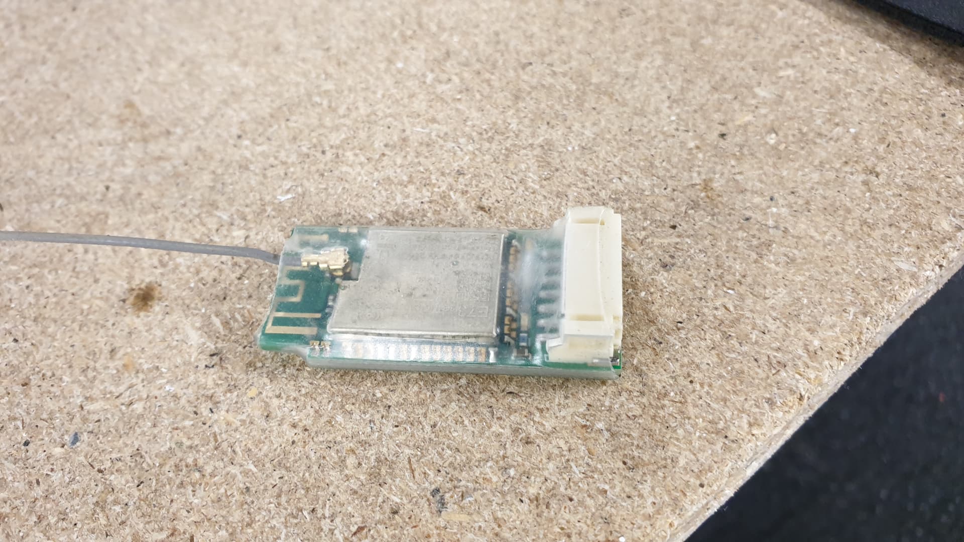

i have the metr pro can version, it came with the external antenna, can i remove it and just use internal antenna ?
You should be able to, yes. Obviously do some testing before you pot it into your enclosure or whatever, just in case it kills the range too much.

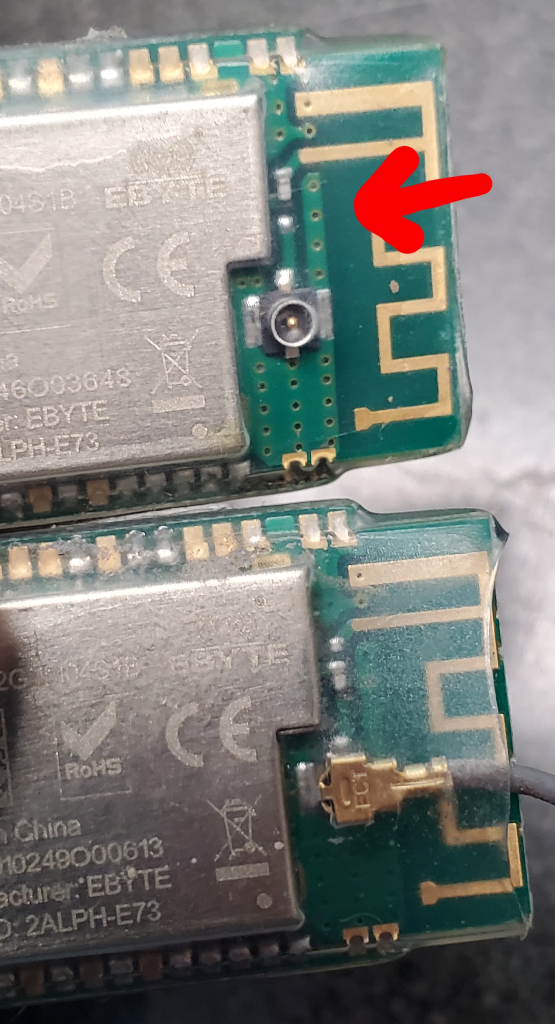

I believe there is a jumper you have to solder if you switch antenna types.
I see a small component bridging two of the three pads there. Probably either a capacitor or a low-value resistor as a jumper. Shouldn’t be too hard to move if you have a steady hand and a decent iron.
Not without moving a microscopic SMT capacitor over
Got to move that piece over
Doesn’t matter which way it’s flipped polarity-wise but it needs to connect the PCB trace antenna instead of the socket.
It’s a high-skill solder job. Probably need tweezers, a hot air machine, and a magnifier.
Ah, nice, that should be a prob, thanks for the info

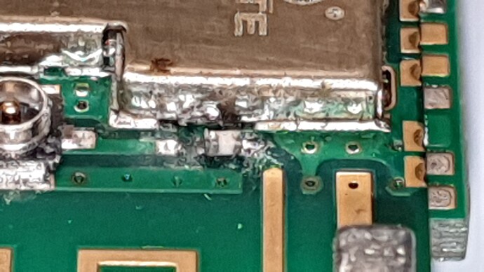

Hard to see but I measured it and I have conductivity from the traces to the resistor, by no means I can see what I’m doing though

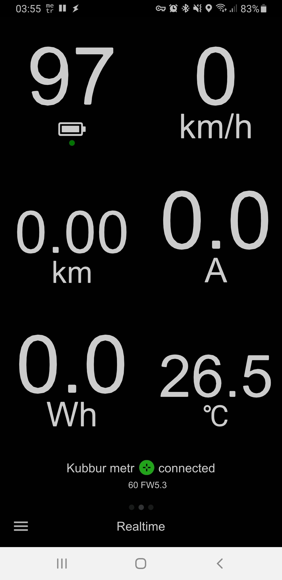

Works
That’s fantastic, I’d put a dab of conformal coating or silicone or hot glue or epoxy or anything on there to make sure it stays put
Nail polish if needed, preferably acrylic
