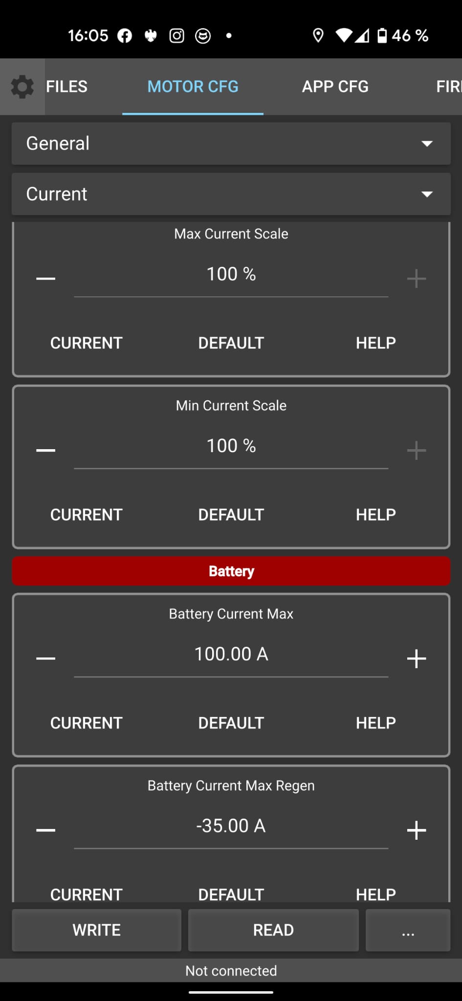

Not sure about the tooth Count, but its definitely 5:1.
I am logging via Vesc App, it is using Phone GPS. It is Off by around 15-20km/h…
Im viewing the csv within the vesc Tool in PC.
If you know it’s 5:1 then just type in 1 tooth and 5 teeth.
Off a constant amount regardless of your speed, off 15km/h when you’re going 15km/h? Off 15km/h when you’re going 100km/h? We need more details.
OK I am an idiot. Set the ratio in one vesc, logged the other…
Any idea on the motor current issue?
Can you screenshot your motor current settings and upload the CSV log?
100A battery max per motor sounds ridiculously high.
It’s fine I guess. It is a mountainboard for offroading :grin:
But I just saw, the log says “Current Motors”, plural. I did not know that the log adds both values. Then its fine I guess.
:man_shrugging: I run 80-100a on a single motor setup, seems fine to do so on a dual as well.
I’m almost positive it’s combining motor current as the field says current motors
image so you should be good.
yes, max value in Excel is 84 :slight_smile: Sometimes the VESC Tool is just too smart for me…
I hope you have 8AWG wire or bigger exiting the battery.​
It’s 10AWG only. Had no problems yet and the current is only that high for really short burts.
Ohhh I misread this.
Yes, 200A total from the battery is… a lot.
So 100A motor each is OK
but you should set your battery amps on each ESC to (cell specification x p group / 2)
If the current is that high for more than a few seconds, you will likely achieve atmospheric escape velocity.
That is correct :joy:
I mean its a 20Ah lipo rated for 12-24C. Lets say its 10C realistically then I still should be able to draw 200Amps for a short burst, right? If that ever will happen, which I doubt.
You will only be able to draw 190A maximum, and only at exactly top speed. In reality, you’ve completely disabled the battery current limits. Top speed is precisely the moment when you DON’T need that kind of power.
Yes you are right, I could step down a little bit, but it is not really a usecase, is it.
I wont go top speed without dying :smiley: Thats just what happens when Jenso (no-wind) builds your board :joy:
