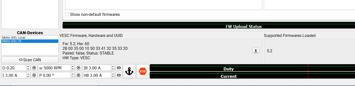

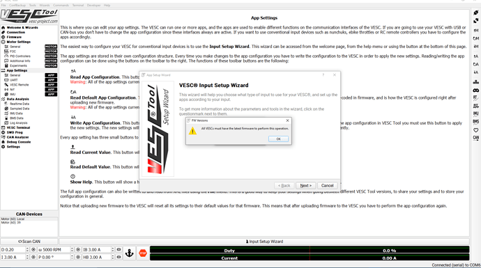

Trying to calibration my puck with the wizard. Why do I keep getting this screen?
MakerX DV6 running 5.2 on both sides as far as I can tell
