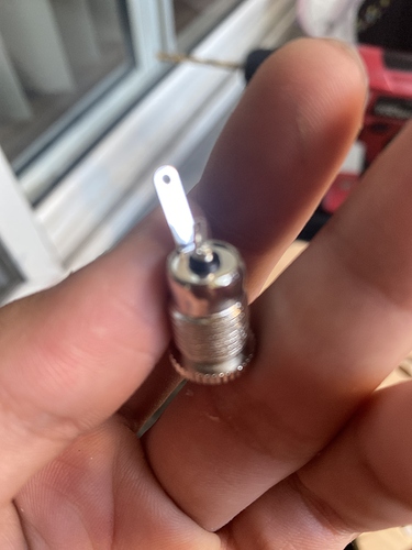

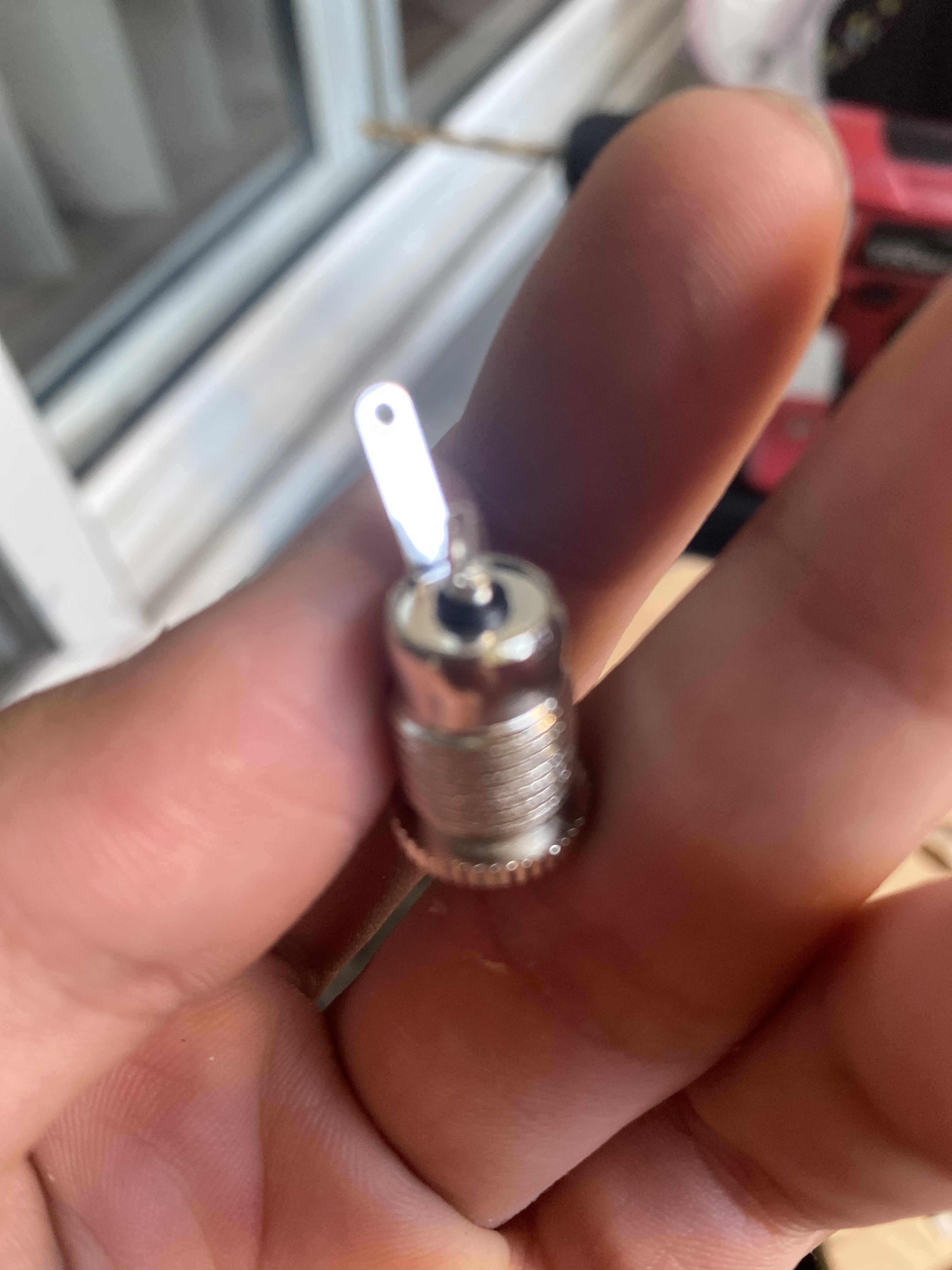

What’s positive and negative lol. My stupidest question yet
As long as you’re careful, plug it in and measure voltage. If it’s giving a negative voltage, you have the multimeters positive and negative leads backwards.
DO NOT TOUCH THE PRONGS TOGETHER WHILE THE CHARGER IS PLUGGED IN. THIS WILL COMPLETE THE CIRCUIT AND END BADLY.
I think the center is positive and the side prong is negative
to expand on Justin’s comment
what you are intending to measure is the polarity of the male DC5521 (5.5 x 2.5mm) connector this will inform how you wire the female side in the image.
This is how most if not all the chargers I’ve had are. You can check the charge brick for the symbol that shows the pin polarity.
It’s just a standard charger I’m using that I got from Tb lol
lol if the charger polarity is not published on the charger you can carefully measure the voltage using a multimeter as described here. lol
Center pin is positive. I solder it while a male is plugged in to make sure the pin doesn’t move while it’s hot.
brian - are you suggesting the plug is designed in a way that would prevent accidental phase to ground contact so it can be left unprotected? this is absurd! :laughing:
LoL no I’m just saying I don’t trust the rubber stuff around the base of the center pin. I don’t want it to become crooked after soldering. So keeping the mate plugged in holds the pin straight while it’s hot. It also has a side-effect of cooling it off faster.
