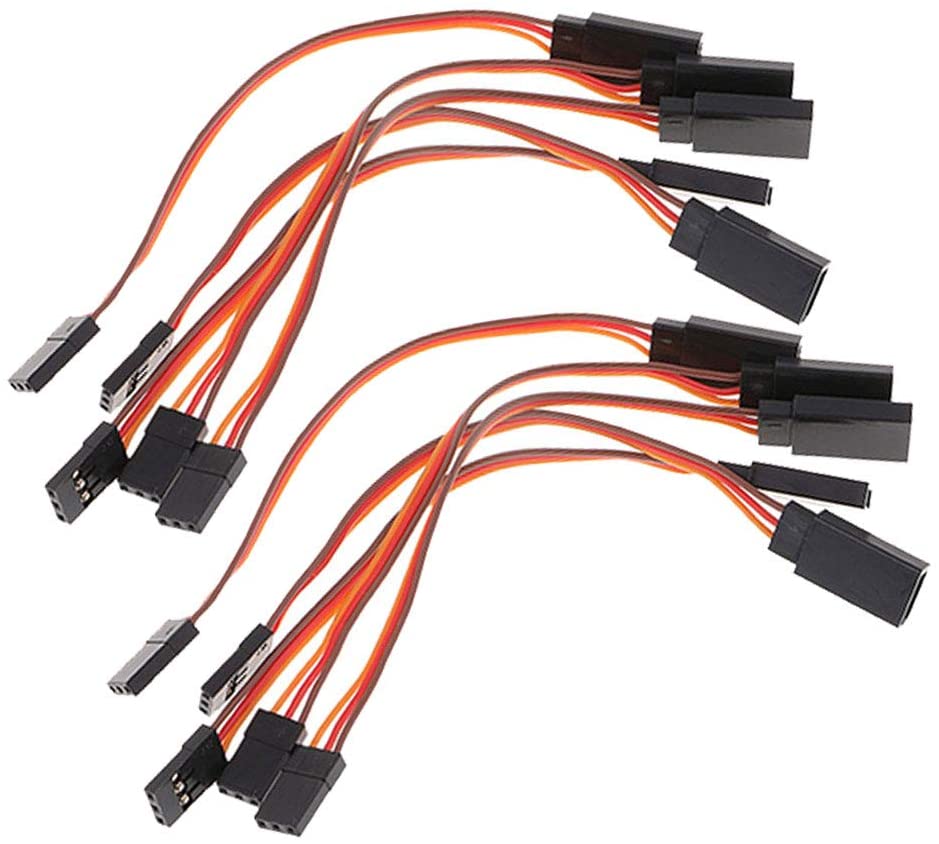

I had to make a PPM cable, this is the pinout:
Reciever Channel 2:
GND-5V-Sig

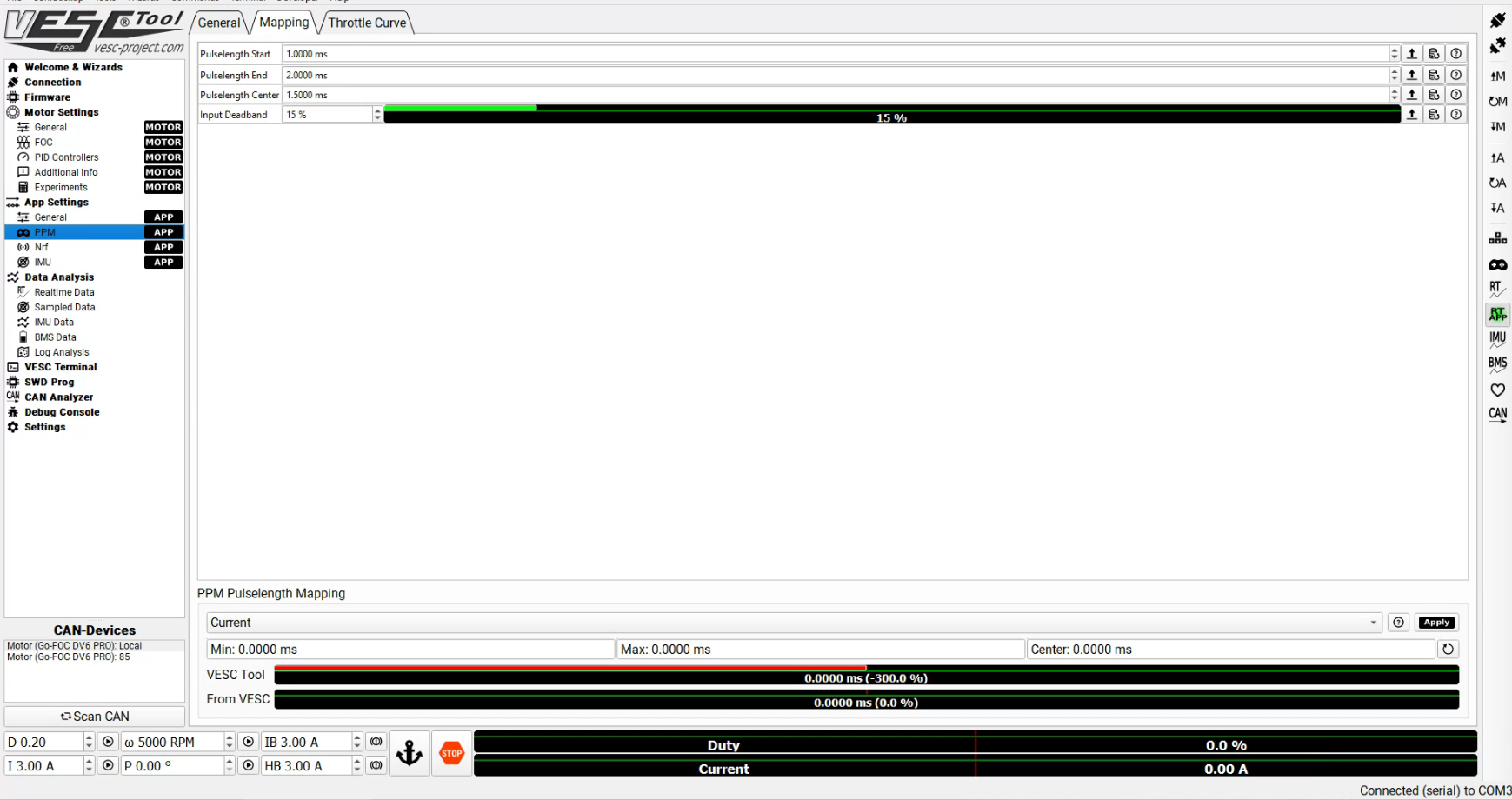

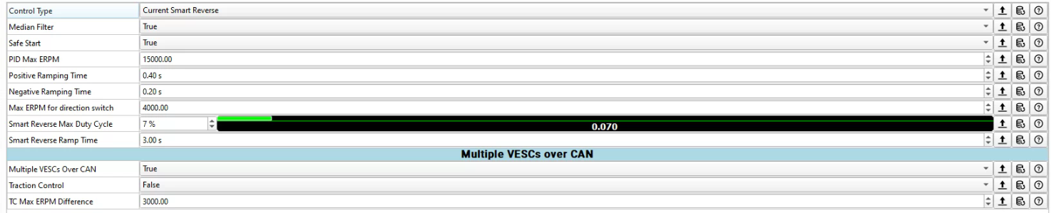

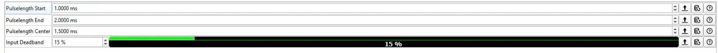

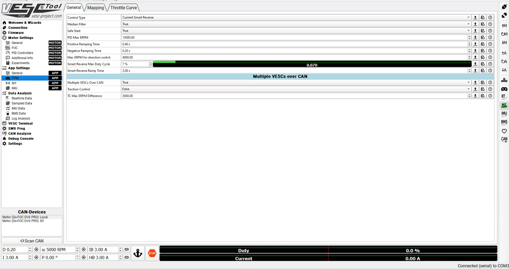

When I say screenshot, I mean the entire window, not just those fields you’ve edited. I’m looking at other details you may have truncated here.
Some of the things I am looking for are not in the screenshots.
there’s nothing truncated, those were all of the entry lines in the window, what’s cut out is just the 2 sidebars and menu bar
Right, but I’m specifically suggesting not to measure it, but rather to count and then multiply.
Yes, and there is a lot of information on those sidebars, on the status bar, and on the menu bar.
Screenshot 2022-01-07 12.53.54 AM

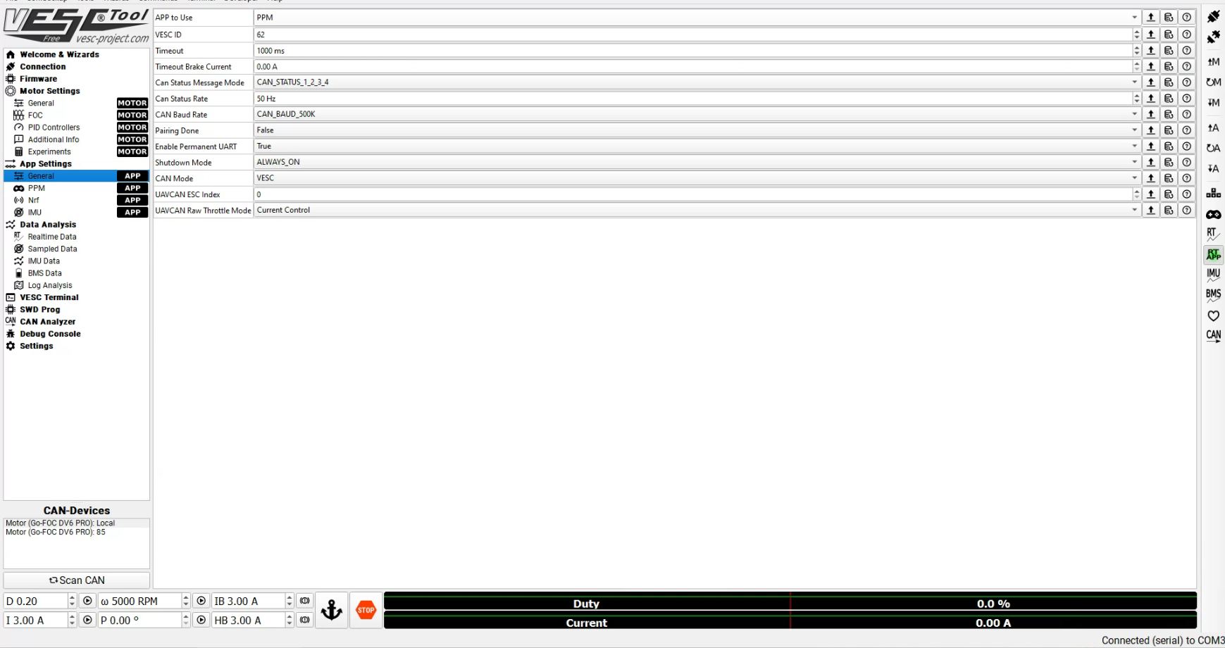

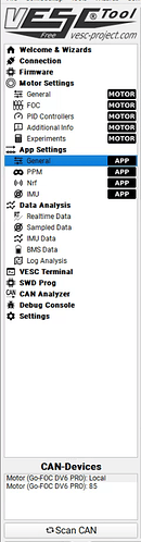

here’s all the stuff I cut out
Would it really kill you to just do what the person who’s trying to help you is asking? It might, just maybe, make it less of a pain for the both of you, and who knows, maybe more people would be willing to help in the future. Just saying.
Dude, just post a screenshot. I’m not going to piece all this together and then wonder if all the information was even presented simultaneously.
Do you want free help or not? My goodness
I may rescind my offer
I thought I was
here’s attempt #2.
it would be much easier if I knew the information you were after
Good boy. pats head
It looks like the white wire isn’t connected, and hasn’t been connected since the ESC booted.
