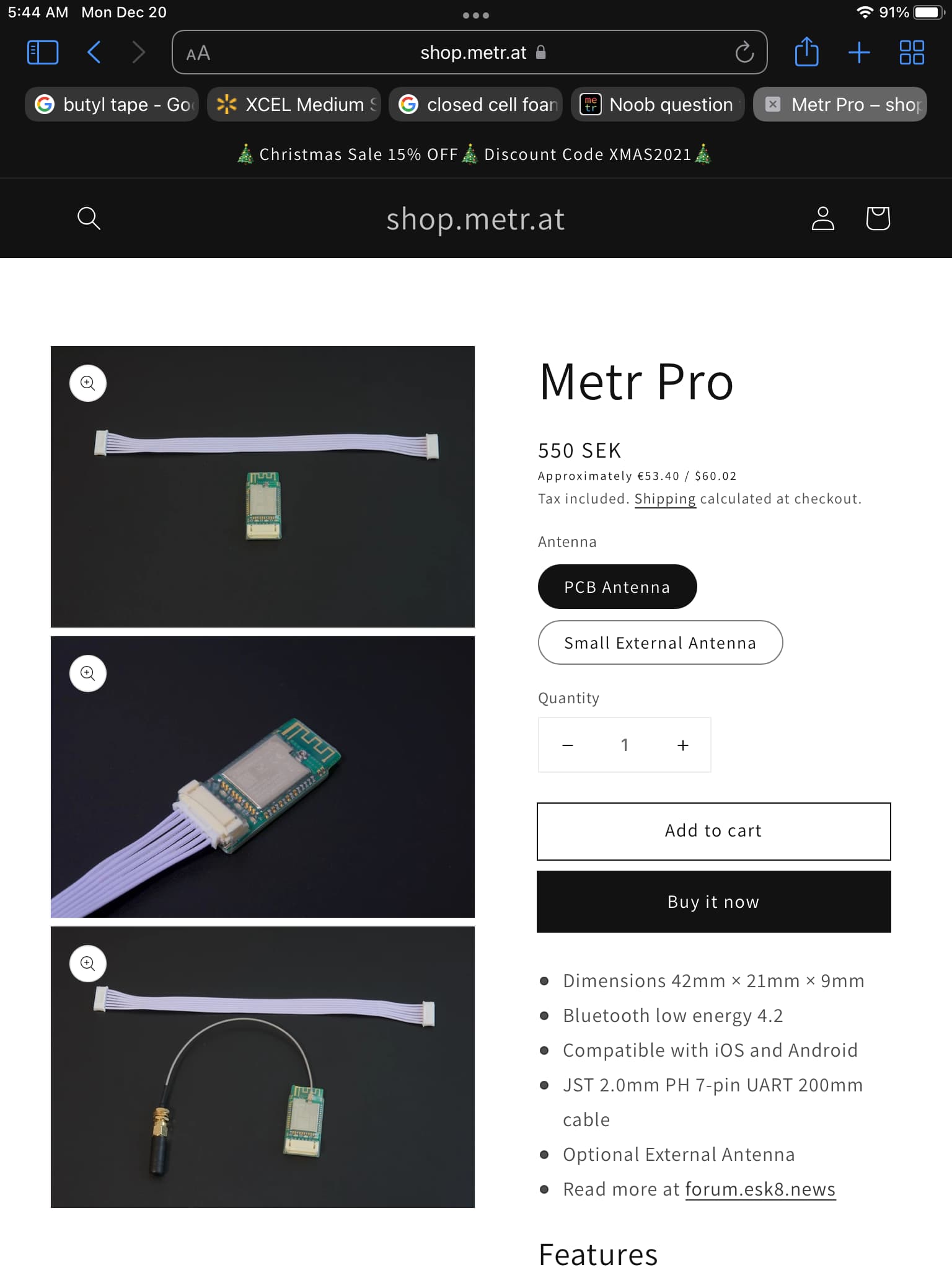

A Metr pro is probably more than enough for you.
All metr devices use the same app, so you don’t lose any base features depending on device choice.
Metr pro CAN and Metr LTE offer more “hardware based” features (which can still be added down the line if you own just a metr pro)
Davega is a screen for realtime data that you mount on your board.
iLogger and the the robogotchi work similar to the metr, all fantastic devices with each their own awesome features.

Think in all it just depends what’s the best deal for the price, having a screen on the board would be pretty bad ass tho. So many choices

a screen on the board is cool, but IMO you won’t want to be looking down at it while going fast, and at that point other telemetry like a metr is far more useful, as it lets you interact with the system on a deeper level
this coming from a guy who thinks the Davega is cool AF
60$ isn’t bad for a metr pro
I feel you, would be cool if you can just attach the screen to your wrist or something (don’t know how big it is) but, sadly reality comes in and sometimes things don’t work out that way, also which one should I choose?
ACTUALLY…
metr supports smart watches (WearOS and the apple one), and you can get a wrist-mount for your phone (my preferred method) and use the “keep screen on” feature
:frowning_face_with_open_mouth: alright yep. Metr should hire you as an advertiser, definitely just got a sale here :joy:
