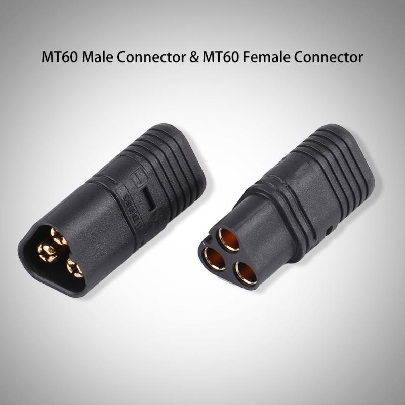

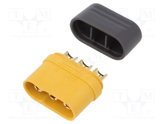

Hi guys I know this is a bit of topic but did any of you guys ever used the mt60 connector on your build ?
I’ve seen people using the mr60 connector
645678_1
And for what I’ve seen they look like the metal connector parts are the same size
And I was pondering buying the mt60 for my board because they are slicker
Any thoughts on that?
Wrong thread, but yes, I’ve used them to make adapters for my Loaded hubs, and on a build where I wanted to minimize horizontal space. They are just as big of a pain in the ass to solder as MR60s. Only difference is shape. Go for it if you want
Harder for me.

Honestly both are easy to solder lol
12awg wire is super easy
MT60 and MR60 will work the same, it just depends on your board. They both are made from the identical bullet connectors. Just make sure you get Amass brand connectors.
Once you know the correct method it’s doable. But sometimes even tinning the wire will make the 12AWG too thick to fit in the bullet. Or if you don’t have enough heat the wire strands will get stuck and bend away. I hate it!
