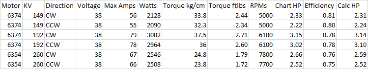

Lower KV motors use thinner wires and can carry less amps. Take a look at the chart above for that Reacher motor and look how the rated amps change with KV. I don’t understand why Flipsky/Maytech and others don’t properly rate their motors when the KV changes. They all say 80A regardless of KV which doesn’t match up with more detailed motor manufacturer specs.
Selecting KV should really be based off max motor RPM (a 63mm motor can do ~18k), battery voltage and pulley size limitations. esk8 recommendations went off track when the early VESCs had a low RPM limit coupled with gearing limitations on small urethane wheels. If you put a 140 KV motor on a board that had a 170kv motor you may notice higher torque right away, but if you change the gearing to match the same top speed, you end up with less.
If voltage could be anything we wanted, lower KV motors can make perfect sense. Notice how the lower the KV, the higher the volts and lower the amps… but they still recommend like 22s on 195kv to get maximum power because these motors can spin to 18k.

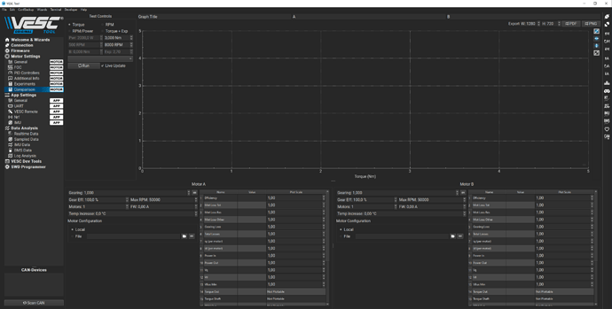

The new VESC-Tool will have a mythbuster buit into it. It is called motor comparison…
You can basically plot your motor efficiency in a graph and play with voltages and gearing etc.
https://vesc-project.com/node/2859
In order to measure efficiency we need to measure mechanical power output correct? I see a “torque out” and “torque shaft” field in there so can it accept a load cell input for example (HX711/Arduino)?
Im still on vesc tool 3.00 and im wondering how the “KV” command works. It only outputs 0 KV but it would be great to get KV from vesc tool instead of calculating it myself.
