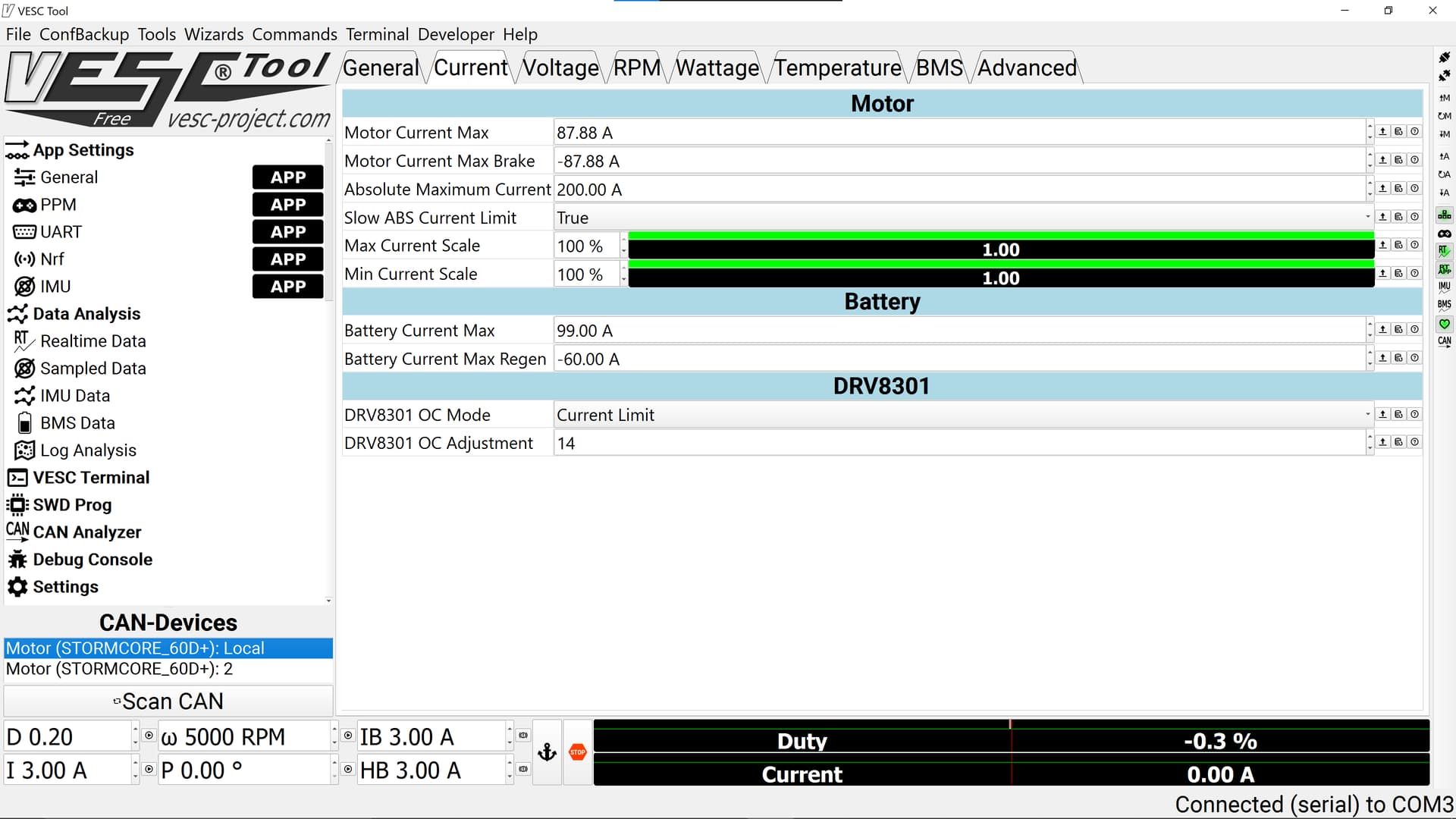

I am programming a stormcore 60d+ with vesc tool, and I haven’t done this in a couple years lol.
Do I have to write my motor settings two times, once ‘per side’?
I wrote settings into motor(stormcore_60D+): Local, and they didn’t write to
motor(stormcore_60D+): 2
So do I split my amps per can-device?
So 50a motor per can device, 25a battery per can device?
or in motor(stormcore_60D+): Local, do I write them as 100a motor 50a battery?
Sorry if this is confusing, I am a little confused lol
Also is there anything else I should change in vesc tool besides Duty cycle current limit start?
yes
they’re each separate, so it depends
those motor amps are pretty low, what motors and battery are you running?
If your battery can do 100 amps out, then set it to 50 per side. If each motor can handle 100 motor amps then do 100 motor amps per side. On my Evo with a 12s4p p42a, I was running 100 motor amps/50 battery amps per side.

You can start out at 50 motor amps/20 battery amps per side. That’s still more power than any prebuilt board on the market but shouldn’t overwhelm you.
