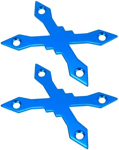

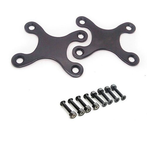

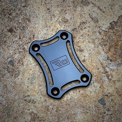

What do you call that metal plate that makes it so the screws aren’t exerting all of their force on the screw-rim of the deck?image
x-thing / xthing / anti sink plate / top plate / x thingy on top of deck…etc :joy:
i don’t think there was ever an official name for such an item, so everyone just call it something
Yes but I am trying to find one retail and I’ve only been able to get limited results. Are they exclusive to group buys on this forum?
Not using one wouldn’t hurt my deck, would it?

no, i don’t think any vendor do exclusive sale only for user on this forum, since technically anyone can join and buy stuff off here.
if u value ur deck, u should use one, but u won’t have to. the x thing is just to prevent the bolt bite into the deck when u tighten the nut by distributing the force to a larger surface.
Also antisink washers are another neat way of protecting the deck. Surprised that they aren’t as commonly bought as I think they look awesome😎
