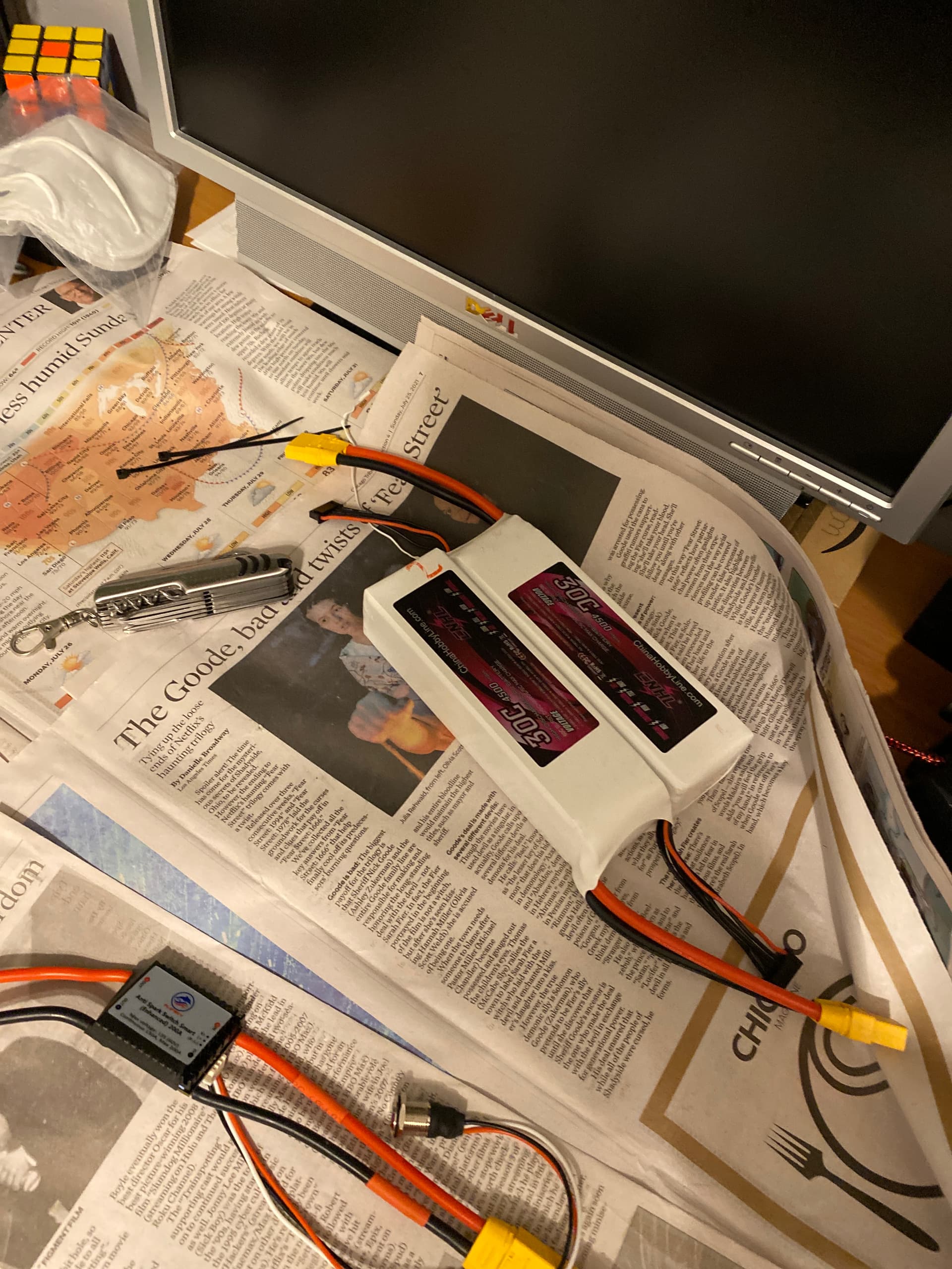

Alright so I got a question. About to assemble all the electronics in the enclosure. Is it good to add foam on top of the lipos or other electronics (VESC, BMS) so their protected from vibration? Or add foam inside to divide the electronics so they can’t hit each other all tho I’m using velcro to keep them secure?
I would put fishpaper between them and on the sides, and foam on the bottom and top, front and back
You can also use RTV silicone instead of foam
On the lipos or can I add foam on other electronics also? I also said foam cuz I got a lot so might as well use it

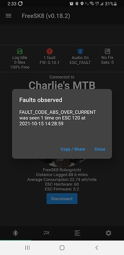

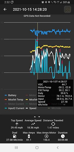

I finally decided to just fuckin send it full speed up a hill and I got the fault! I never thought I would be excited to see a problem!
Any idea what this is from?
What esc are you running? V4 or v6?
This is just my best guess on a solution, but try bringing the motor amps down to around 60a and see what that does.

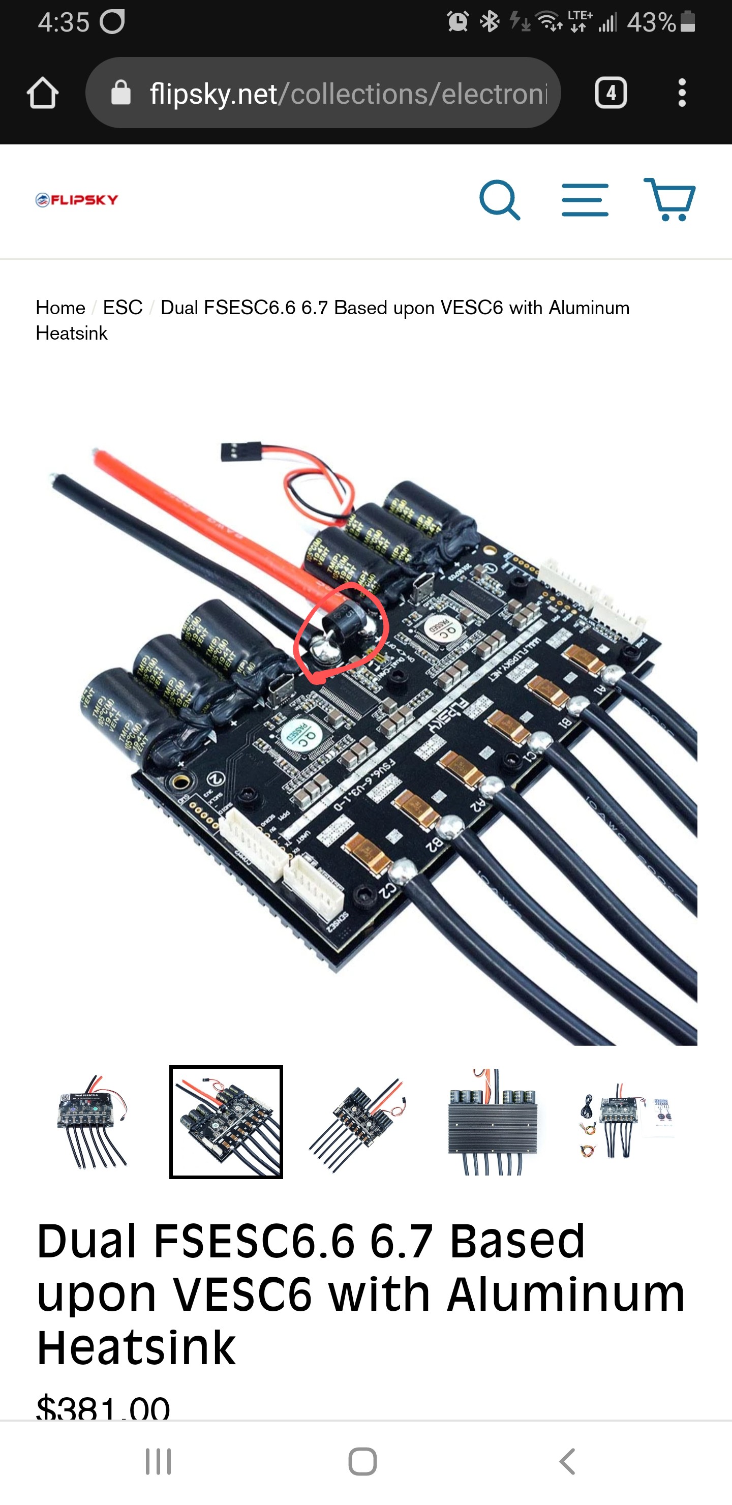

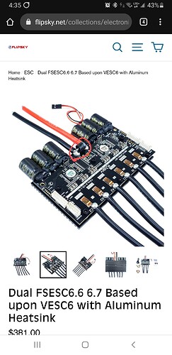

One thing that my fsesc didn’t come with is the little capacitor looking thing connected to the + and - wires.
Yeah I have one but Its on a 10s that doesnt see really any speed.
I’d say drop the motor amps and see what you get.
Transient voltage suppression diode, shouldnt be the cause for over current faults.
