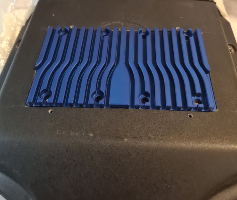

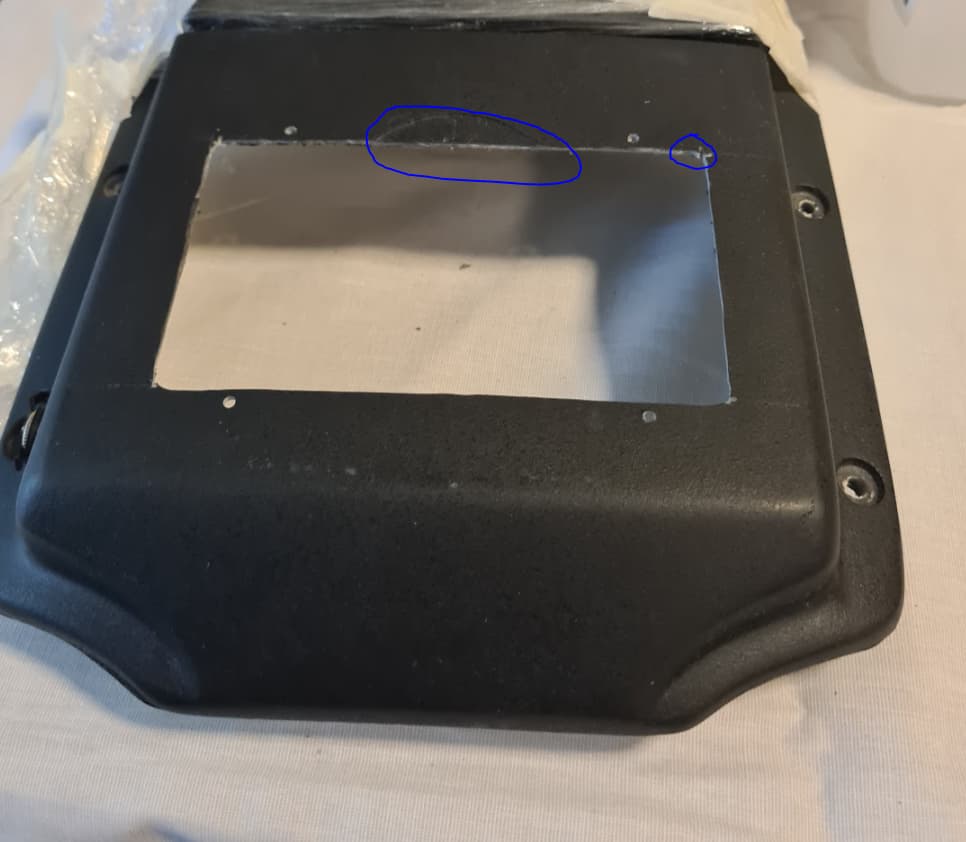

First time cutting heatsink hole, It fits OK, I’m happy for a first try !
→ How can I fill the imperfections and the top of the logo (both circled in blue in the 1st pic) ? The goal is to make it dustproof/water resistant as possible. Thanks :slight_smile:
What I would do is the following:
Clean up the edges with a fine file, and wipe them down. Use black or clear silicon to screw the heatsink onto the enclosure, allowing the silicon to fill the gaps. Once it’s screwed down, you can wipe it clean, filling those extra holes.

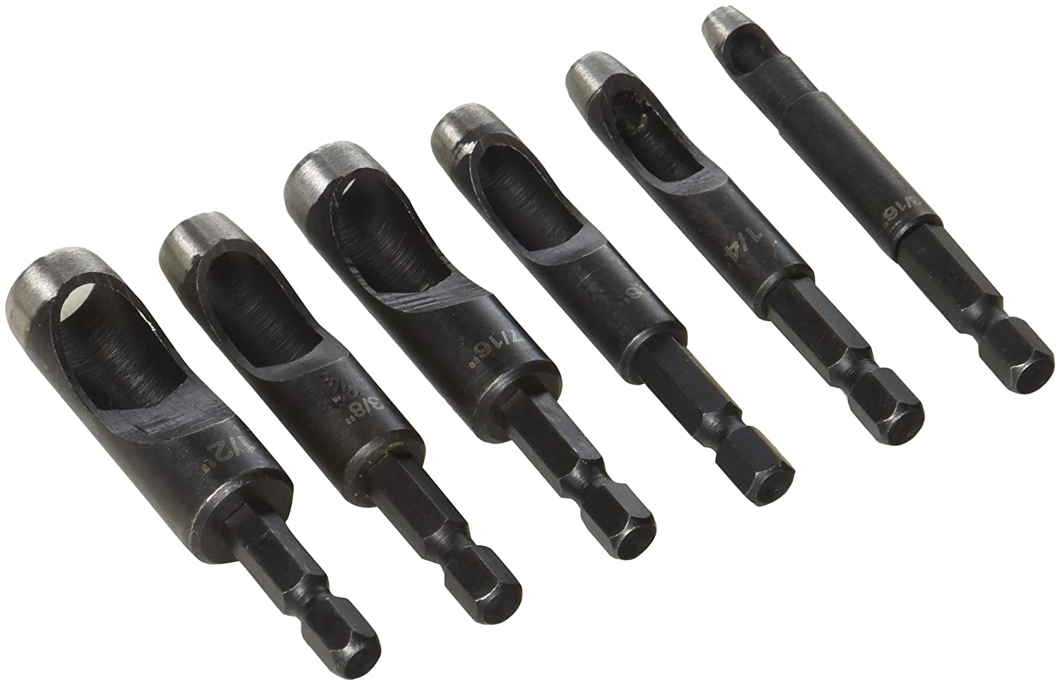

They make hollow drill bits specifically for this sort of thing
Easy peasy, just go slow unless you want to enlarge your enclosure hole too
Harbor freight has a super cheap set if you’re in the US
