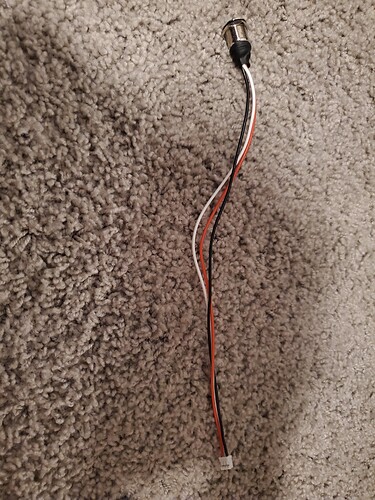

Hi guys, I am having trouble getting the nut off of the main part of the switch here. The nut doesn’t want to fit over the heat shrink. Is it OK to cut that off and apply more after I’ve gotten it attached to the enclosure?
This reminds me of the flipsky smart antispark…Just cut the shrink, install ur things, heatshrink it again.
Thanks, just wanted to be sure I would mess up anything too bad in the process ha
Don’t go full waterjet on it, cut lightly, if it is the flipsky smart AS, then one of the wire inside is solder across two switch pin, u probably don’t want to cut that unless u want to do more soldering
Thanks for the help! I’ll give it a shot
