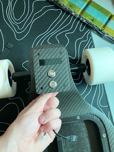

No name yet. Dual Flipsky 6374, Focbox Unity, 100mm Boa Wheels, DIY Integrated Evo Deck, P42a
That carbon fiber finish looks immaculate! Wow! :star_struck:
Fantastic !
Incredible work. Really well done.
It looks amazing so far, but out of curiosity, what are these irregularities?
so i think the one furthest down is just some weird lightning but the other ones are folds in the vacume bag which compressed the fibers in these areas making them wider that the oders.
Bummer! Nit picking aside, it’s a better job than I could have done! Really nice work dude, you must be pleased
I’m really not an expert at Composites especially getting that perfect surface so i’m really happy with how it turned out. So Every Deck is gonna be a bit better that the one before😉
Wow, fantastic build. Love seeing this kind of craftsmanship.
BTW feel free to share some updates on your Dad’s RC jet project. That sounds bad ass too!
Yeah wed like to Rsee that too :smirk: Anyways im blown away by your efforts, super job on the deck.
I think you’re being coy. Really well executed.
My first time doing Glass frit griptape
