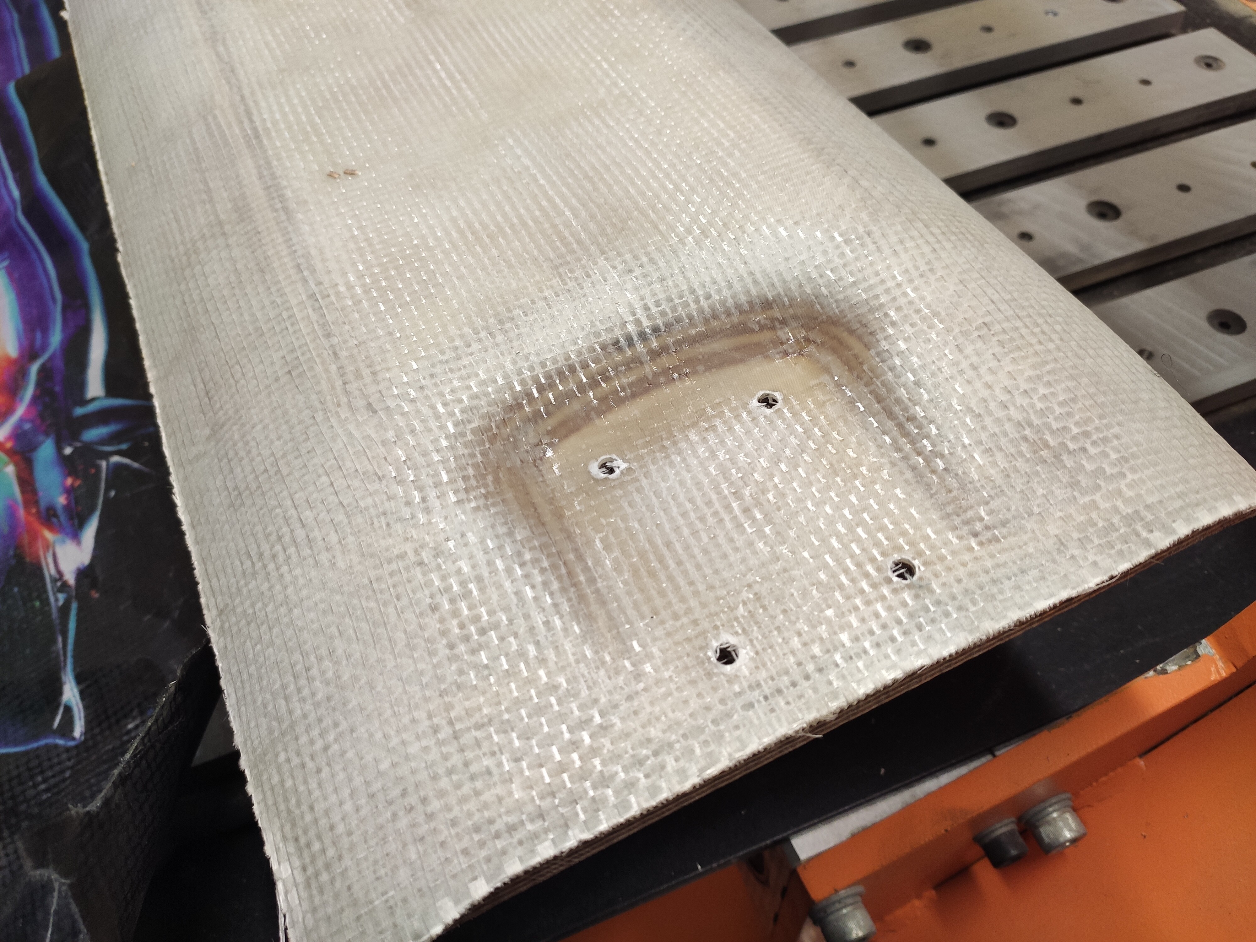

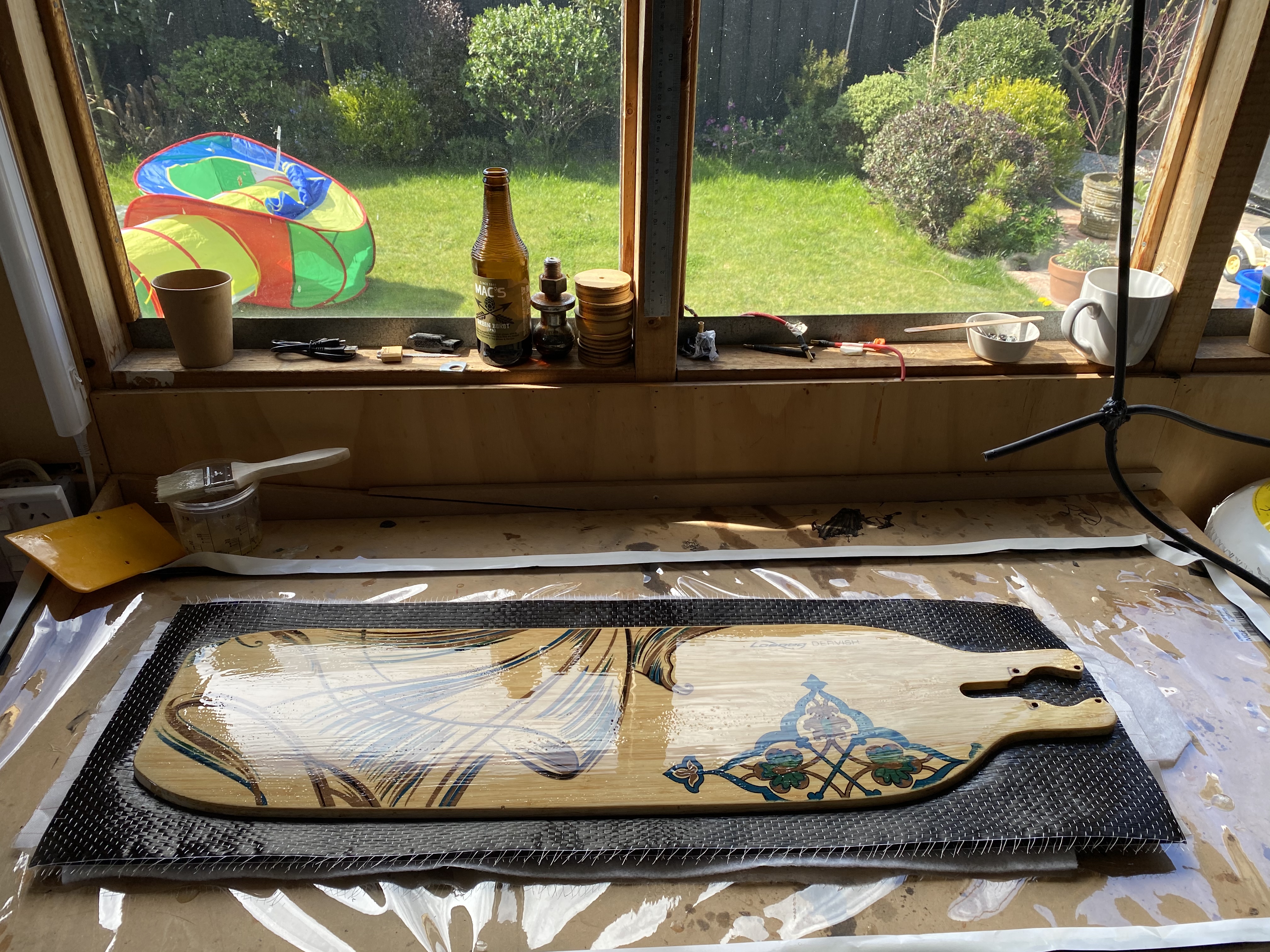

How on earth have you done your skin? looks amazing can this be bought in EU?
Secondly - How does it flex/did you need to increase the motor wire hole or was the size suffeciant?
(Ps any idea what size the screws are for the enclosure lid? mine seem to have vanished)

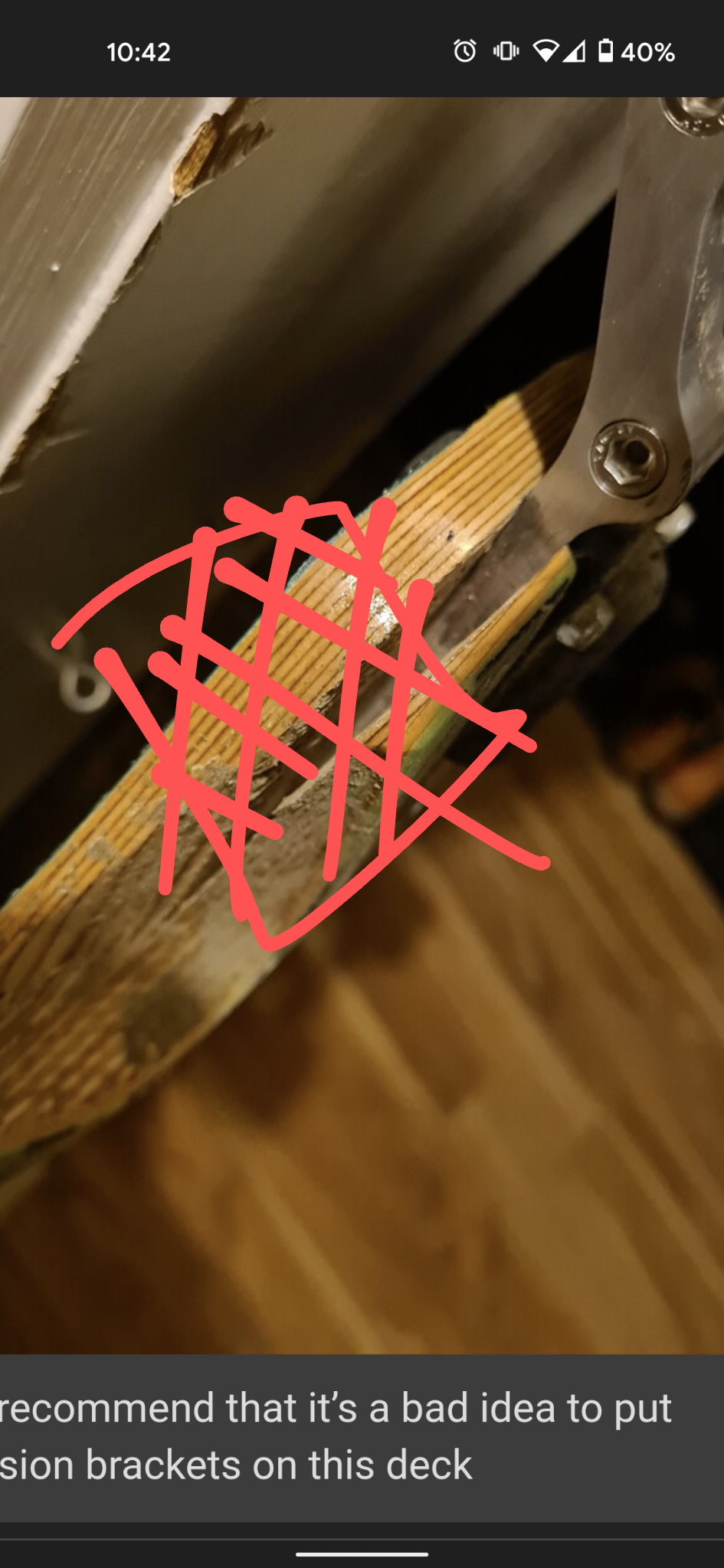

I can recommend that it’s a bad idea to put extension brackets on this deck.
The deck has no flex.

You can skin it yourself if you’re committed.

RIP NimbleStiff :frowning:
Al, what are your plans for this build now?
Can you easily re laminate something like that with some epoxy? Or is it out the door and on to the next one? I mean it looks like the structural part of the deck is still intact.
Errmmm… the bit that broke was pretty structural :sweat_smile:

I had fibreglass, carbon and the cloth skin. Didn’t help :sweat_smile:
Around the entire deck? Why can’t I see it in the split?
Nah i didn’t wrap the rails.
I would imagine that unless a deck is specifically designed for these brackets it’s going to always have extra stress in these areas. It’s a totally different distribution of weight. Which decks are designed for them?
G bomb make these style brackets and make decks for them. And other LDP decks. I have a loaded dervish which I have chopped and reinforced with UD CF which goes really well and doesn’t show any signs of damage.
There was no wrap like this? I had X from xboard reinforce the area the trucks bolt to
Nah i didn’t do that. In hindsight, i probably should have, but to be fair, i don’t think it would have stopped it from happening.

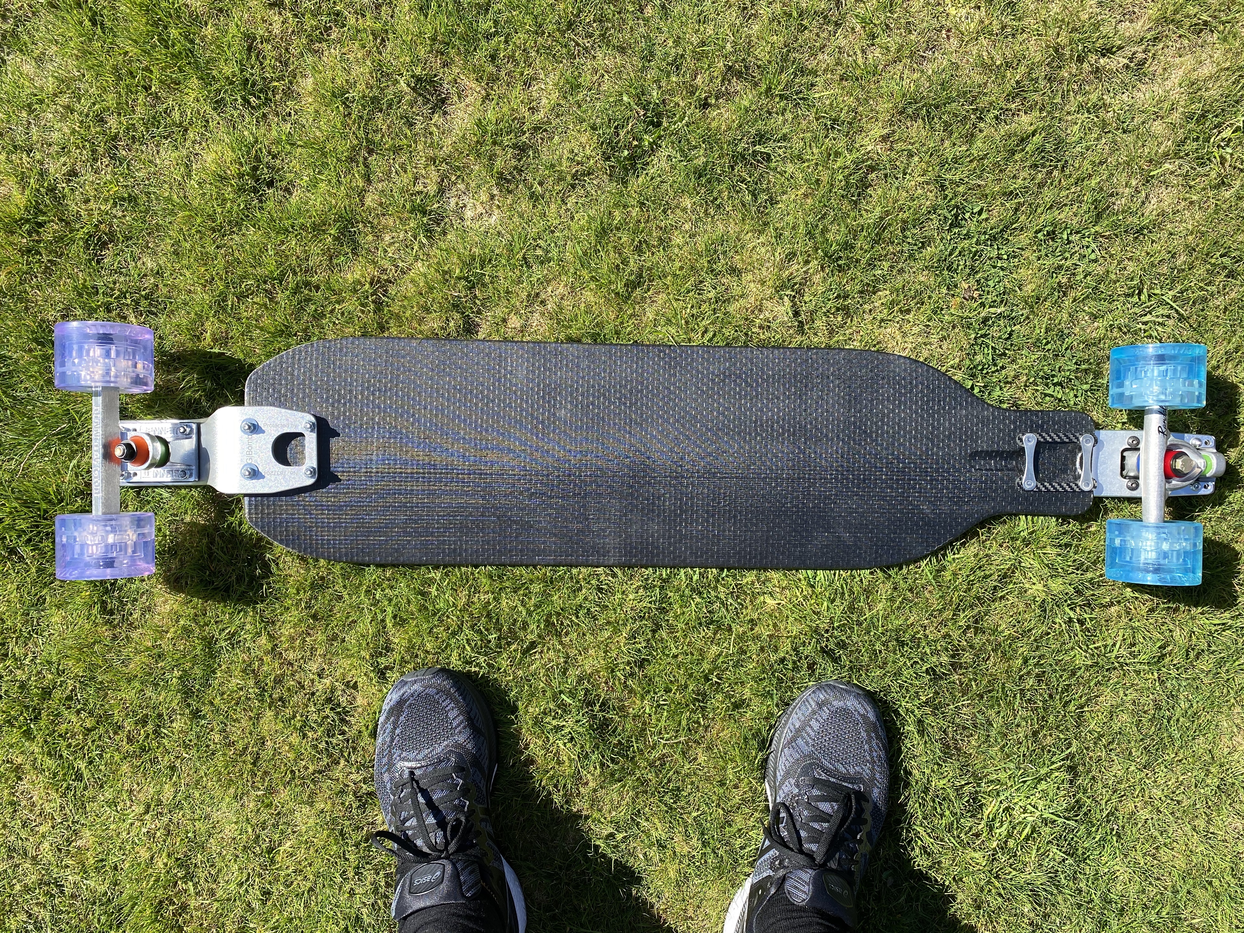

Guys… To use brackets it should look like this.
Also basic design difference is lack of wheel wells which are the main cause of this faliure.
