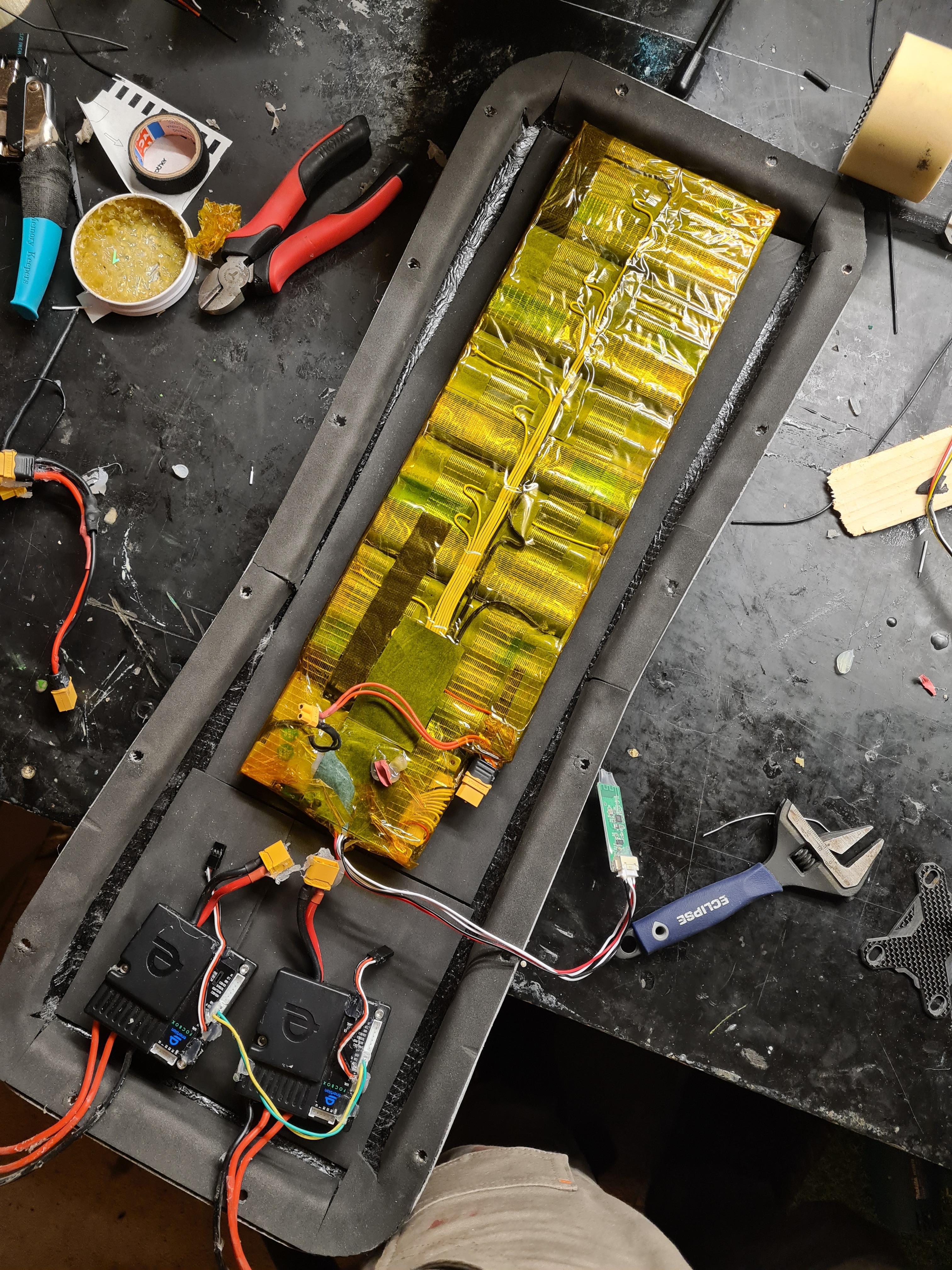

The battery that I pulled out of this one doesn’t look so flash in the new enclosure…
So i’ll save this one for the kicktail and i’ll build a fresh battery for frankenstiff
What range you’ll get with this 12s5p?
I was getting 25-30km out of the 10s4p, so at a guess, i should get somewhere between 40-50km i reckon. Maybe even more.
That’s a super nice range. I’m asking because not sure which route to take. Better looking deck with 12s4p or less trimed along edges but 12s5p? :thinking:
12s4p is a good size dude. I’m only going for 5p cos i’d rather fill this enclosure up with cells instead of packing foam :rofl:

After extensive testing, i’m only getting 30km range out of this pack, at 15wh/km average.
I built an xr parallel pack which should double my range, yet to fully test that tho.
