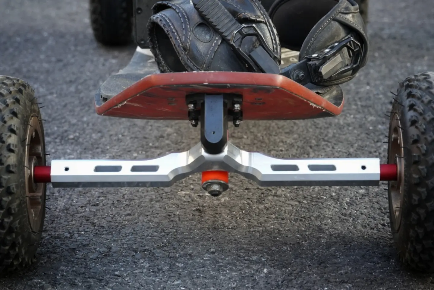

@Ean.esk8 mentioned in a couple threads a new version of the rtkp that hasn’t been shared yet.
@Ean.esk8 would love to see this happen. Current RTKP is already excellent would love to see how you are planning to improve them!
Yes!
I will post the new design next week. :crossed_fingers: Kinpin issue fixed.
kinpin has better clearences now, hanger width down to 310mm (was 330mm)
Could straight-up install on the previous batch RTKP baseplate.
Whoa very interesting
we can flip the hanger right for a lower ride height?
Hmm would take get weird if we did :face_with_monocle:
This is a pretty standard configuration as long as RKPs have existed. The Randall R2 have adjust able rake by flipping the hanger over.
I have no idea if this is applicable to the new rtkp design. It does look as if the new truck has quite a lot of positive rake compared to the last version of the rtkp which was neutral rake (i think?). So if it was possible to flip it, you would probably have a higher bushing stack, and end up with a lot of negative rake.
It’s not even unique to RKP’s anymore. IDEA has it on his SR TKP hangers after i realized SR hangers can be flipped on the bushing seat lol. And having owned a set - absolutely works and is great.
Reverse the hanger will work too, but have to remove the slave kinpin.
Sample in the making.
Aw so if we flip it it will pretty much turn into a standard RKP
Yep, pretty much…but it going to be negative rake if flip over…so less leans.

I thought about this…but it is really hard to match the design. unless make the hanger as hexagon shape.

@Ean.esk8 can you share the ride height measurements on the v1 rtkp and the newest design?
I’d like to know distance from center of axle to deck.
Gen 1RTKP is approx 49.5mm
Gen 2RTKP is approx 62.5mm
