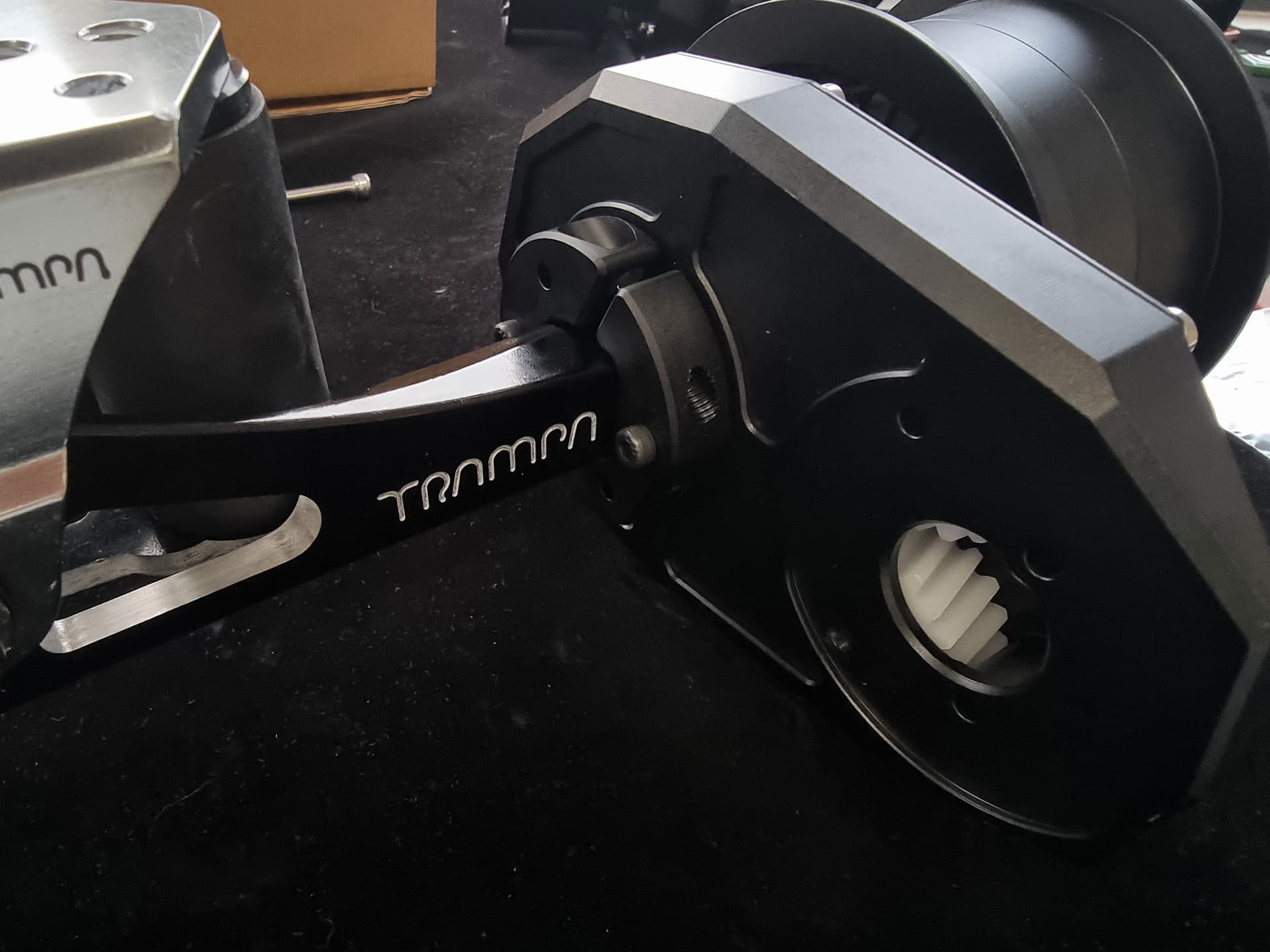

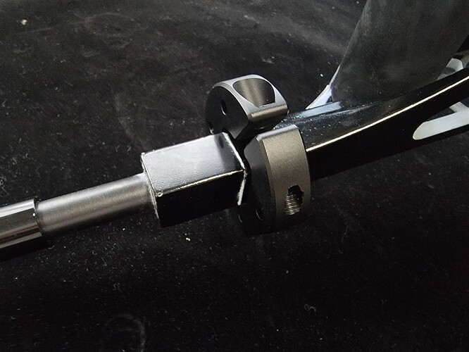

Trampa vertigo clamp & 3DS clamp👌

Interesting to see you’re using that type of clamp design. How did you account for the distortion in the clamp caused by actually actually clamping it when designing the corresponding hole pattern on the gear drive plate? FEA? Trail and error? Oversizing the geardrive holes/ using slots? On my design I avoided this kind of clamp because I was concerned about parallelism related issues so I’m
curious to hear how you solved it.
Love these drives btw, great work!

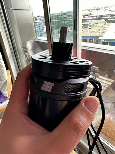

On my setup it was really snug out of box. I had to ease it in. Fb320 v1/2
In the assembly guide, they recommend tightening down the big clamp screw first, then the ones in the circular pattern, around it.
The holes in the circular pattern were pretty normal thru-fit, but I think there would be enough slop there on a precision truck to allow that to compensate for this issue you speak of
