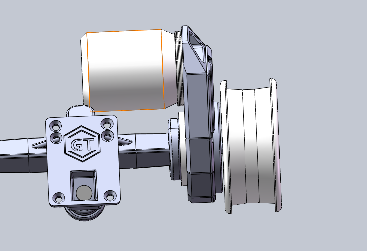

You would need a 3mm or 4mm spacer to make it work.

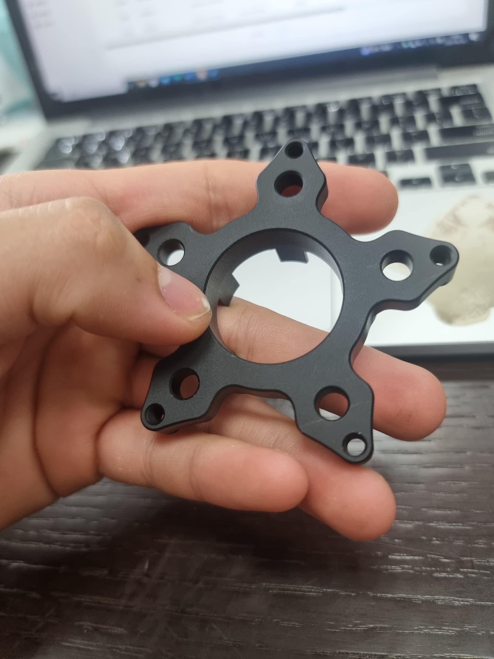

Adaptor fit evolve DKP is coming
Also, trampa wheelplate is in the making.

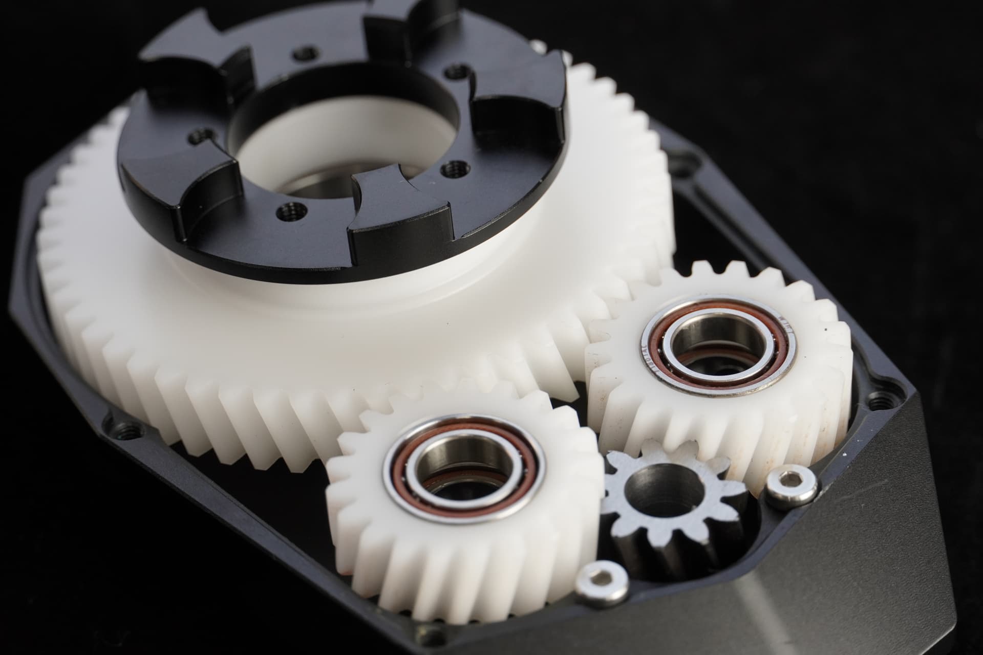

Do these have a thrust bearing for the axial forces because of helical? Or how are those forces adressed?
They use a proper angular contact bearing on the motor pinion
All gears have angular contact bearing to reduce the axial moves.
