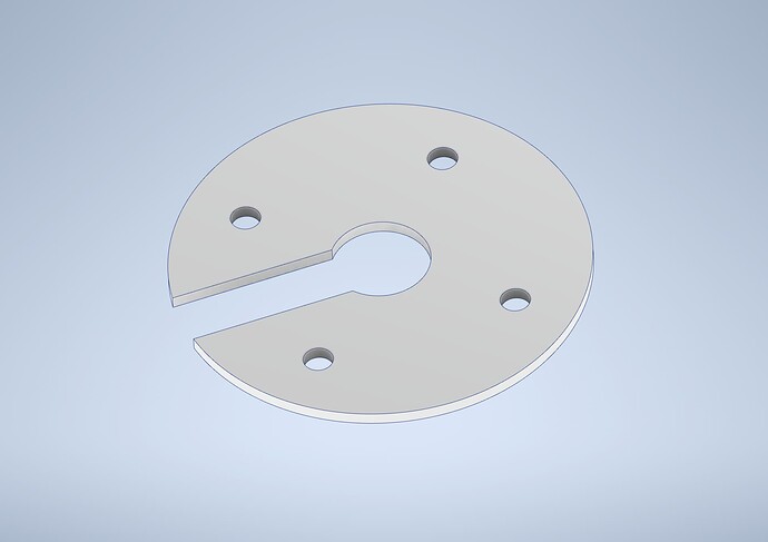

I love the lasered balsa wood. Do you think the spacers would have held up with PETG, ABS or Nylon? I think ABS has a heat deflection temp of close to 100ºC. PETG is around 80º if I recall right
Do you sell these spacers as well? How much would they be.
Yeah I thought about using petg. Glass transition is 85C. I don’t have an enclosure for my printer so I didn’t want to try abs. But then I saw my sheets of birch and decided to try it because it was faster and also doesn’t have a glass transition temp lol.
If you want some out of ABS let me know, I have a roll of bright yellow that would make them super discreet :woozy_face:
I could make a bunch out of aluminum if you wanted something a bit nicer (and that will help conduct heat out of the motor lol)
That would be ideal. What would it cost to make a set?
Let me mock a few up and get back to you tonight, but if i can get enough interest (5 sets or more probably) then i would guess less than $20 shipped lol.
I was just looking at the D shaft on the Flipsky 7070s and wondering whether it would work with the Newbee D shaft gears but it looks like one would need a similar motor plate spacer as what @andoug created as there is a 10mm circular profile before the D shaft begins. Unless the D shape doesn’t run all the way through that gear but I assume it does.
One thing to keep in mind is different motors have a different 10mm length portion. Mine were small, but enough to be an issue. It looks like flipsky has a longer 10mm portion
I could just make them thinner and if you need more spacing, use multiple
I could get them done by carbon fiber. it should be less than $15 for a pair.
Just an update now, i can make the aluminum spacers 2mm thick, at a price of $5 per set, plus whatever a padded envelope to you costs lol. I’d recommend a bit of thermal paste if you really want to make sure the most heat possible is being wicked through, but even without it should be a nice benefit versus a wood spacer lol. If desired, i could also have them made in copper for better thermal conductivity (and maybe even expand it outwards to better function as a heatsink with some “fins” cut into the outer profile, but this would add cost)
I’m guessing these are cut from 2mm sheets? You happen to have 3mm?
I can do 3.2mm thickness (.125"), price would be $6 a set plus shipping. Feel free to shoot me a DM.
