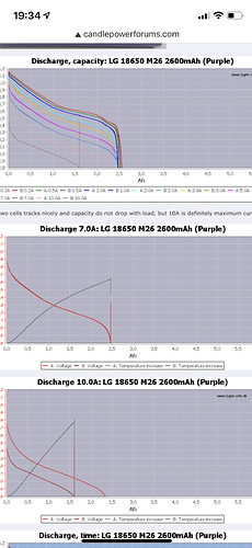

The m26 cells. Keep your expectations low for this. I would recommend based on this a max discharge from this pack of 28 amps. And it’s still gonna sag like crazy.
It’s basically got zero use for diy esk8. It Would be best paired with a hobbywing esc as they draw a max of around 18 amps.
I recommend trying to get rid of it while you potentially can. Not only are the cells crappy, there’s Definitely concerns about the quality of the components and the safety of the assembly.

Samsung lg etc all make a range of batteries. So there’s good and there’s bad for every brand. Some optimized for capacity, some for output. Some are just older generations that just don’t compare with what’s available now
If you’re making 5000 batteries for a scooter that pulls 10A max to a single hub wheel, you don’t need to spend extra on the best cells when a 2p version of the $2/ea cells will do the job.
You can see from the discharge charts above that the closer you get to 10A per cell the worse these will perform. Stick to 2wd for this battery. Somewhere around 25 amps total battery is safe, but it’s gonna feel like a 10S2P 30q pack.
They probably are legit LG cells. The problem is, saying “LG batteries” is like saying “Nissan car”. Could be a GT-R, or a Versa. Nissan makes supercars, and they also make shitboxes. You just got LG Versa cells, not LG GT-R cells. Make sure you know exactly what model of cells you’re getting, not just a brand.
