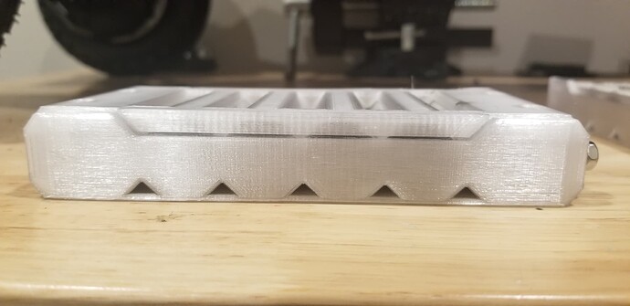

Scaled 101% in both diametral axes for P42A cells
2S2P test print in PETG per the instructions in cults (except only a 0.2 first layer. 0.25 first layer caused issues)
Excellent fit. You can see how close the lid fits by looking at the “v” feature through the vent. There’s basically no gap.
I have no other reference, but when physically shaking them, they only move along their long axis (bc there’s no NESE tabs installed yet)
Starting 2021.12.01 until 2022.01.04

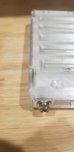

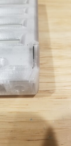

@Agniusm , as said above, I scaled the model at 101% in the diametral axes. Is this level of fit & gap acceptable?
It appears that the 21700 P42A cell length + the foam is slightly bulging the module sideways. It was difficult to get this lid on. What would you suggest?
FYI, I could not make good use of the triangular channels for zip ties. No matter how tight I pull (including with pliers), the full stack up is not rigid. I tried multiple size cable ties, multiple locations. It still allows easy movement. I’ll probably go with strapping tape instead for a low profile fix.
The other option would be one large custom 3D printed ‘washer’ under all fasteners. One plate on top, one on bottom, but I worry about having enough thread engagement and tape is quick.

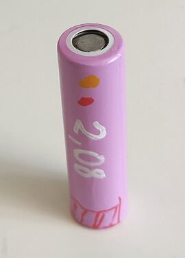

I was wandering if anyone has inspected the cells after using battery for some time? We have here one pack with black marks and i would like to figure out what’s causing it. Some suggested that its from arcing caused by bouncing cells but i cant still believe that they are bouncing, especially in flat orientation, bottom deck mount. Here is the thread: https://forum.esk8.news/t/northern-light-flight-safe-switchblade-with-reverse-mounted-urethane-gear-drives/56826/116?u=agniusm

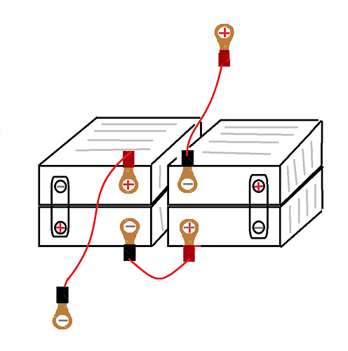

Here is one of my three sections drawn in MS paint

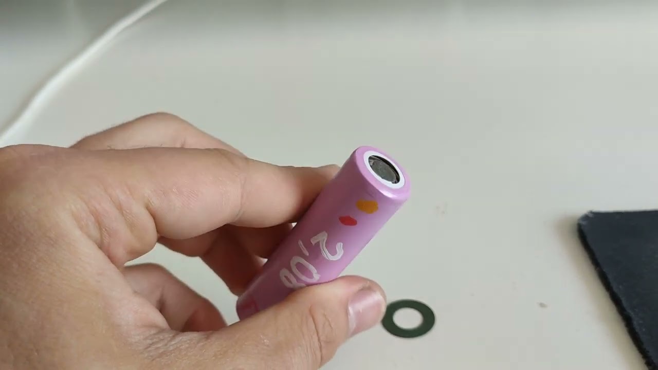

I took cells out of some broken packs and used them in my NESE pack. I grinded the nickel with dremel, I used hard pink tool to remove nickel and then I used this sesame rubber tool to smooth it out even more. Then I cleaned it with alcohol.
If the terminals are deformed, I would discard those cells and maybe only use them in flashlight or something like that.
Cool, thx, I feel much better doing it after hearing that it has been done before.
Do you have any pictures of the cells by any chance?
This is one of the discarded cells because negative bottom got deformed more than I would like. I still use it for other things like flashlights or arduino projects.
