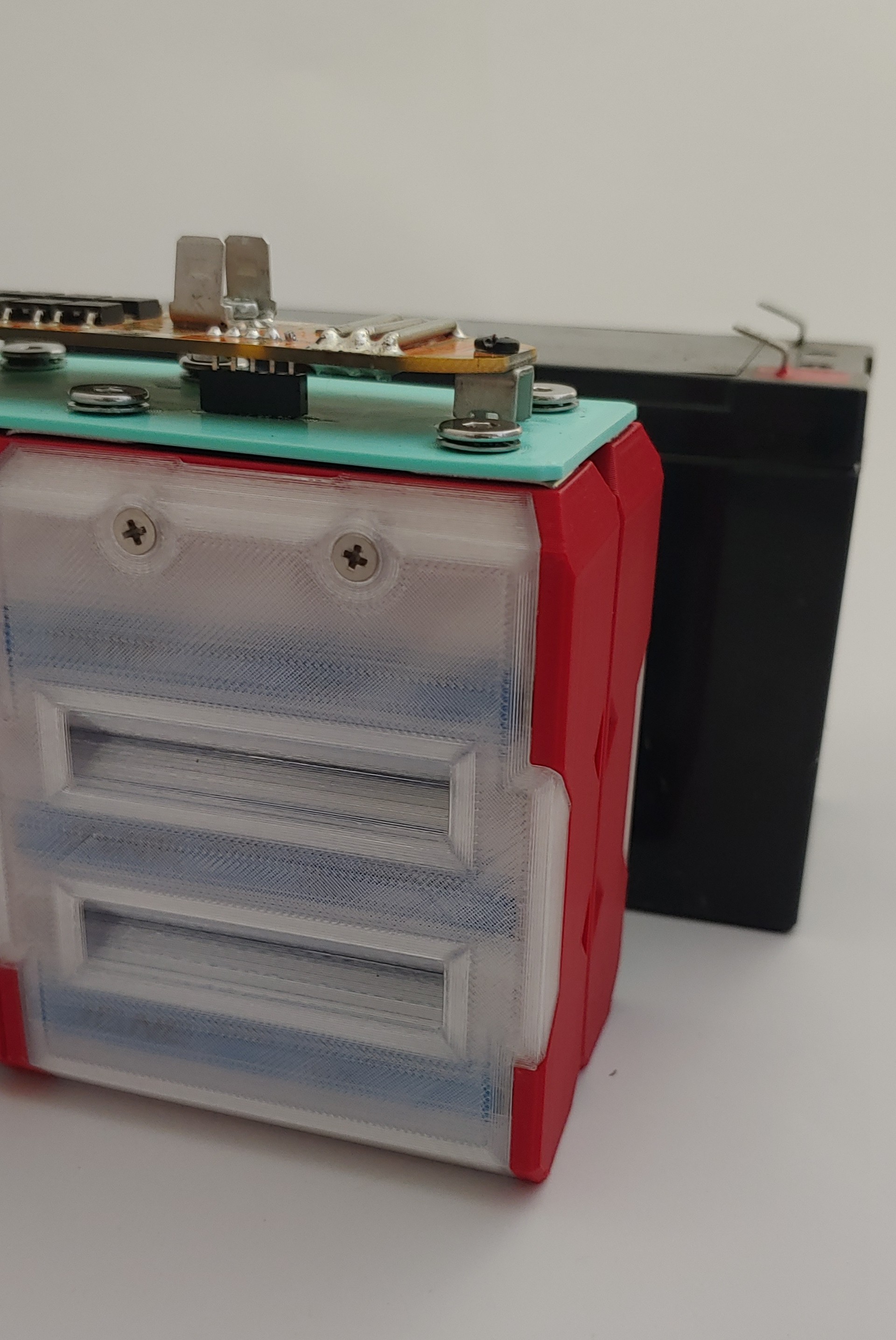

Prototyping 12V 7A VRLA replacement with lifepo4. Fully integrated with no wires. Looks promising. 2000 cycles vs 200. 20A continues. For UPS battery replacements.
(paging @BrassMittens , @rich , @Agniusm)

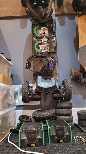

Has anyone tried to make a modular battery pack (even more than NESE already is)?
i.e. a 12s6p pack in a 12s3p + 12s3p setup so that you could remove half the battery for weight savings and better jumping?
As a NESE assembly, I assume you’d need 24x 3p modules. Maybe that’s too many additional connections to qualify as ‘swappable’
Yep. I have swappable 12S3P/12S6P P42A packs on my mountainboard for exactly that reason. They are just bricks of glued and welded together cells along with LLT smart BMS?s in 3D printed cases. The cases bolt to two mounts on the board and put the two packs in parallel. So far they’ve worked out and are still balanced ±0.01V after 500 km worth of jumping.
Thingiverse link to the 3P brick packs and mounts
Not sure what your goal is but you could probably do the same thing with NESE modules if you make custom cases to enclose 12x 3P NESE modules + a BMS. I wouldn’t recommend having connections to put all the cells in parallel as that could take forever to connect/disconnect, and might be annoying if you plan to change the config frequently.
