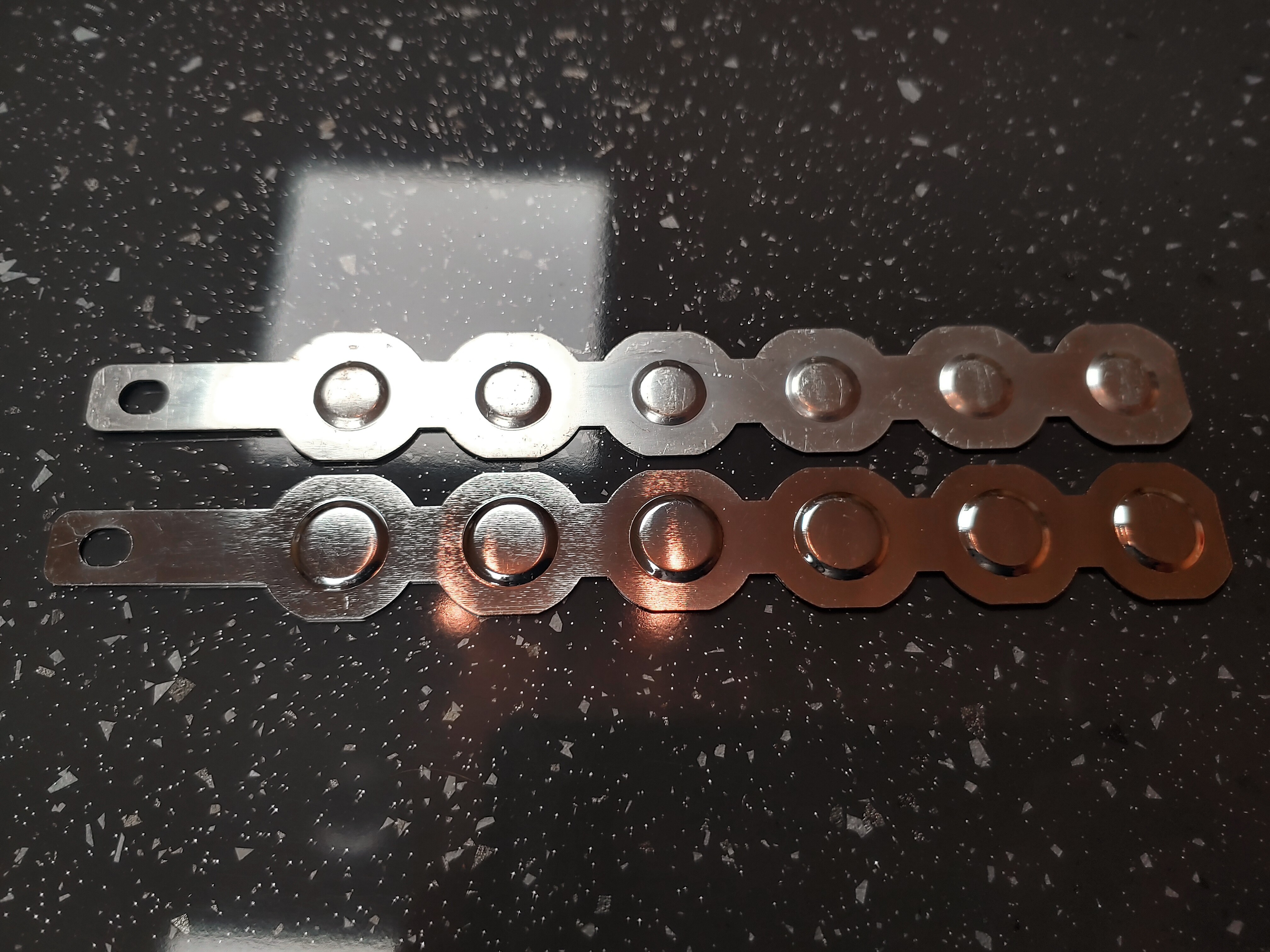

Forgot to mention that with V2 21700 tabs were updated too. Contact are is now larger
Do you know have manu amps, these news bus bars for 26650 can handle ??
80A continues

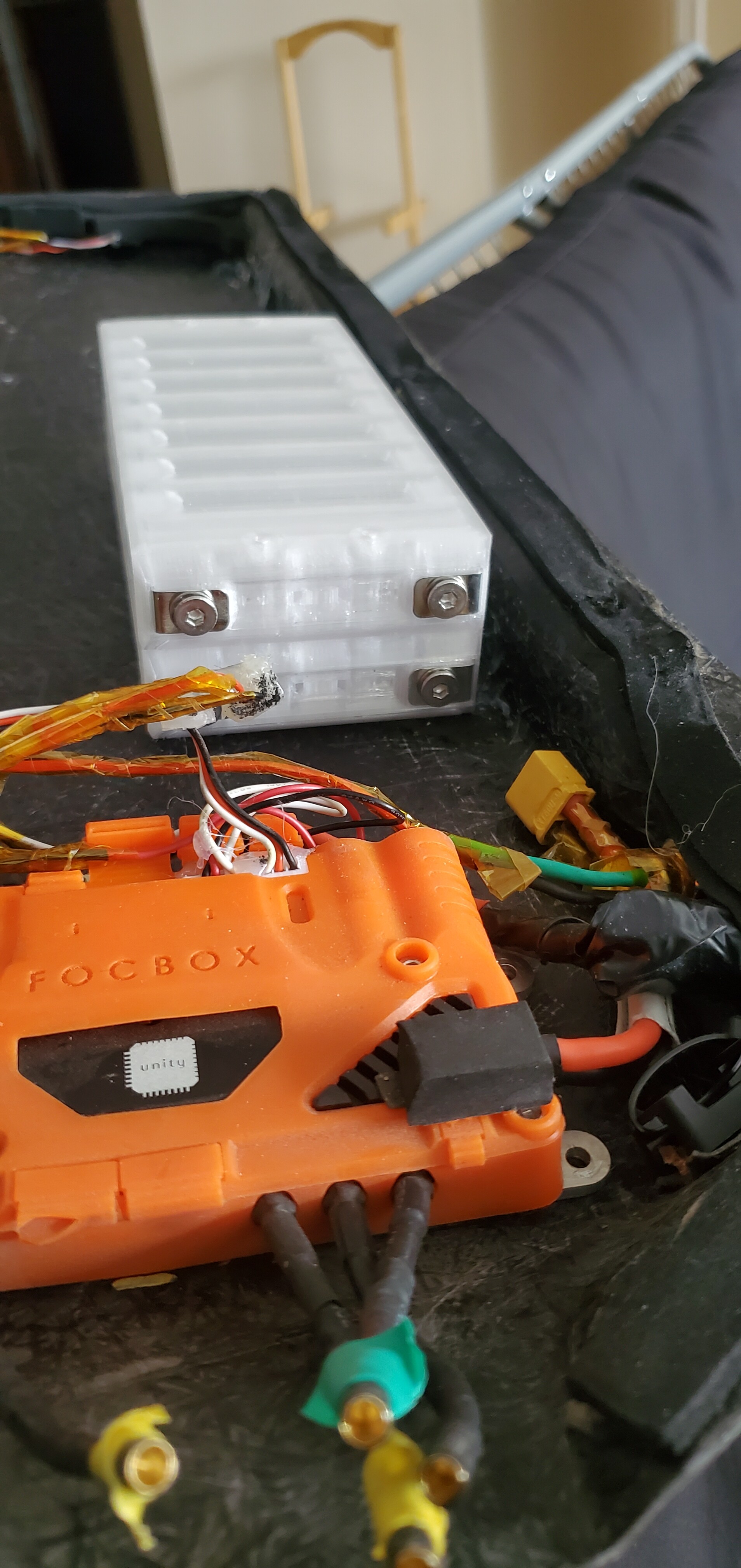

Printed the module for the DieBieMS. The instructions call for the tabs to be 0.6mm, thick copper. Will that be able to handle the current?
