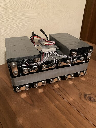

I fit a 12s8p 18650 NESE in my im2050. I have pictures if you want.
nice hint, thanks. yeah please do link me to any pics =D
Idk where it is here so:
oh super nicely done. will the ESC fit in there too?
No, there is about a 5mm gap on each side, 10mm gap front and back, and around 5mm gap on bottom with 10mm space on top. Its tight. I even ran paracord underneath the battery so I could pull it out of the case because with foam all around it was really stuck in there.
The battery has since been replaced with a welded 12s8p P42A that is actually smaller than the NESE 18650. Same configuration. So basically a NESE 18650 and a welded 21700 are around the same size.
