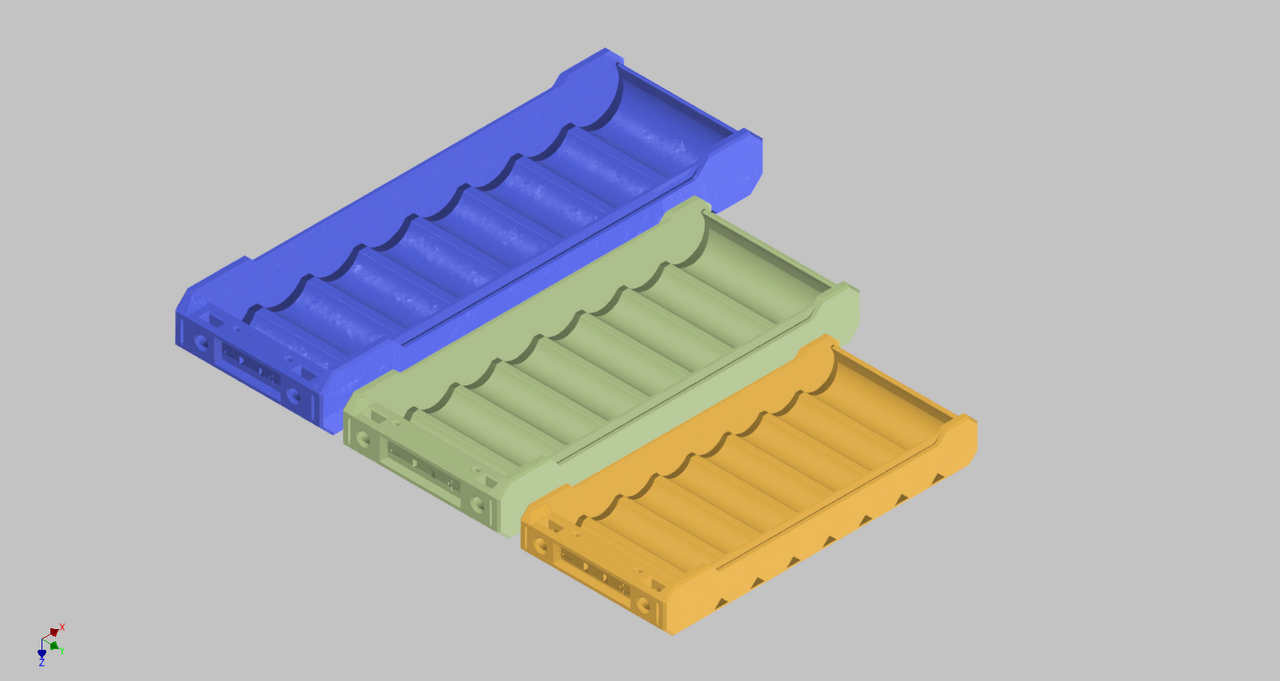

Excited for the 26650 size! It should also be fairly easy to modify the CAD to fit 26800 cells as well right? (Just longer in length). You don’t need to do a whole new product line, I can just print the cases myself
I got some of those QB26800 cells from the group buy recently and this would be perfect for them! Can’t wait for those tabs <3

Yes mate, its simple. When i have them, i can sent you the right width stl’s. My parts are done in quarters then mirrored and all assemblies update on that so its just a matter of entering different length and it all updates, only stl to be exported. 2s job.
