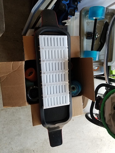

I knew it was going to be tight trying to fit a 12S4P of 21700s inside N.E.S.E. cases for this build. Fortunately with a thick enough fire-retardant gasket just about anything is possible! I still need to clamp everything together and install the stainless steel M4 inserts which finally arrived from AliExpress. I am going to button it up with ten or twelve SS bolts using stacked plastic and anodized fender washers which will help reduce some of the gasket bulge while protecting the gorgeous enclosure. Probably going to want to invest in some risers, but the 110s will get me most of the way there for ground clearance. Wish me luck!

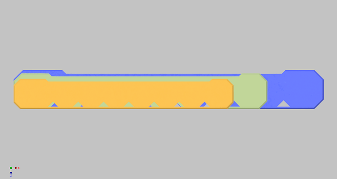

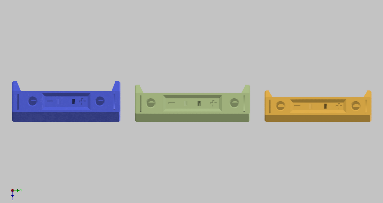

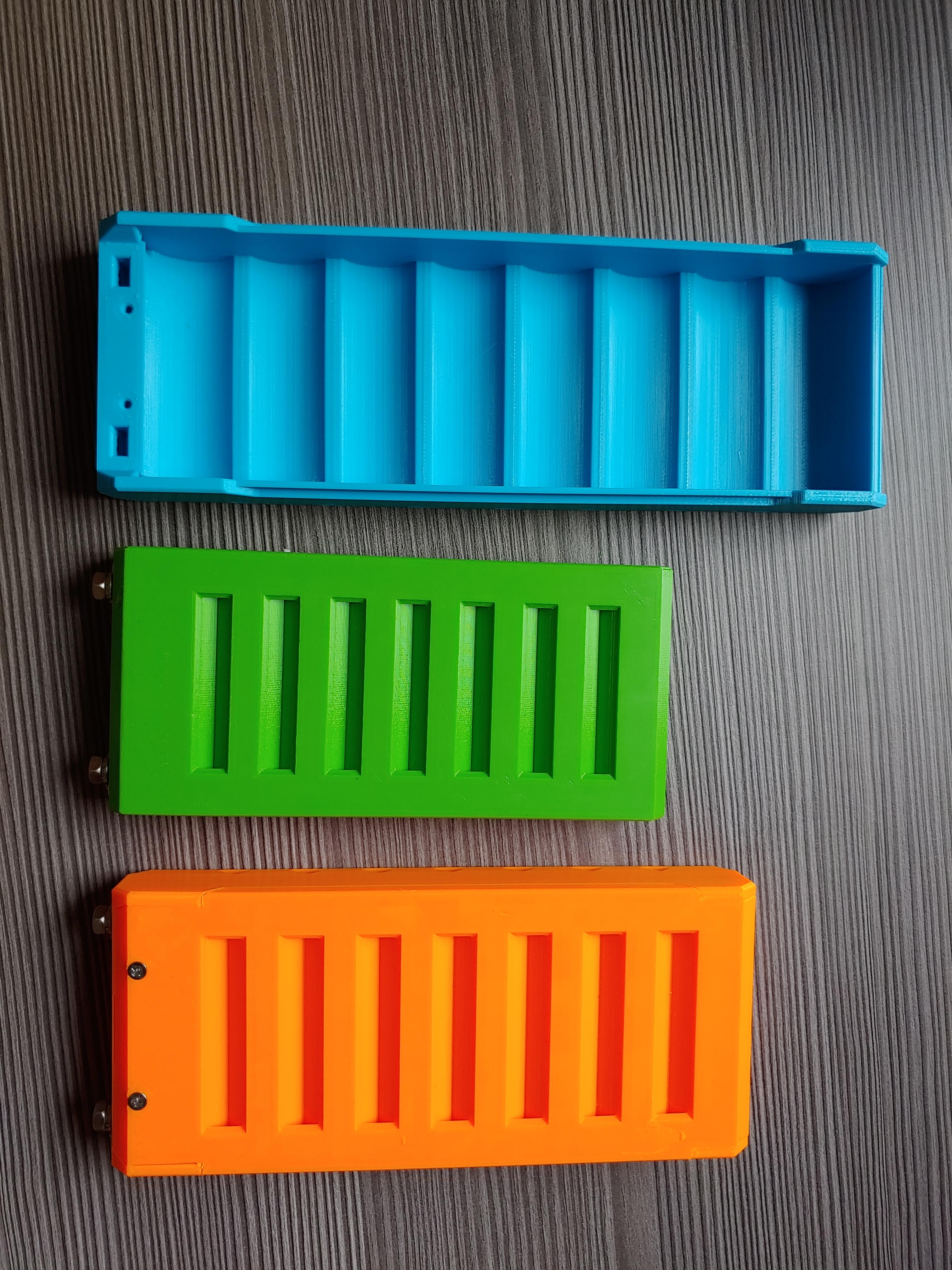

Here are some size comparison between 26650(blue) 21700(green) 18650(orange),
26650 8P is 225mm in length vs 21700 8P 184mm :slight_smile:
Those are 5x 4P+4P and 1x 2S4P. This is the most compact way to make a 12S4P flat pack. You would only need 4x 4P+4P for a 10S battery. The modules are standard 21700 and were printed by Agniusm in Lithuania and I received them in about two weeks in the western US. I ordered 10x 18650 series bus bars for this project but I wanted the option to convert into a stacked pack in case I decide to repurpose the pack for flexy deck so I also ordered 10x 21700 series bus bars. Now I am waiting on a 12S D140 BMS which I plan to wire charge-only to finish the battery.

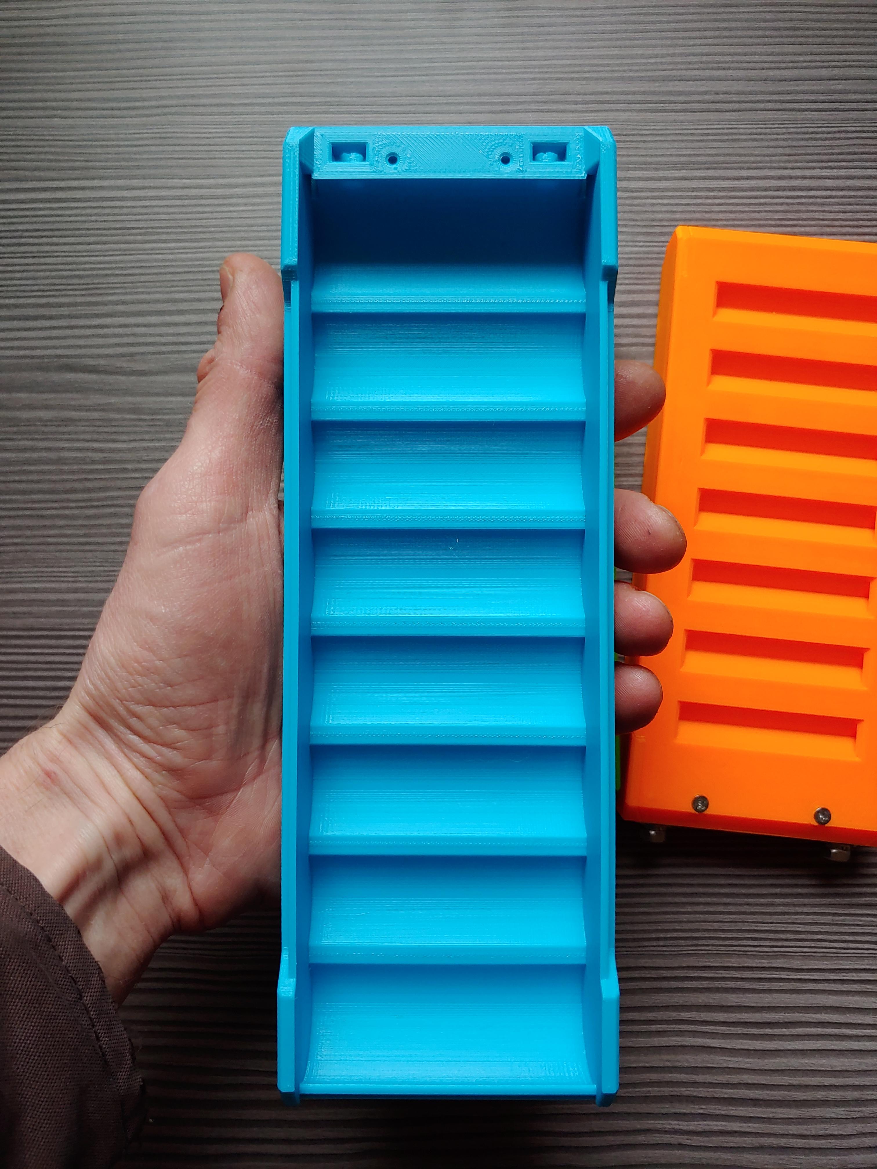

Nice. If you will need any tips on printing give me a shout.
Printed sample
Wait… seeing as these are based around the dimensions of the cells themselves, could one not simply take an existing design for say, the 18650s, and just stretch it XX% of 26/18mm to represent the longer cell of a 26650? (Vs a 18650, where the length is kept the same and the diameter is the variable)

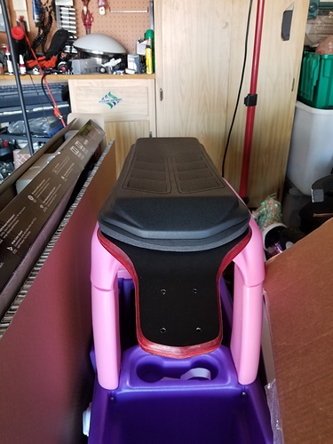

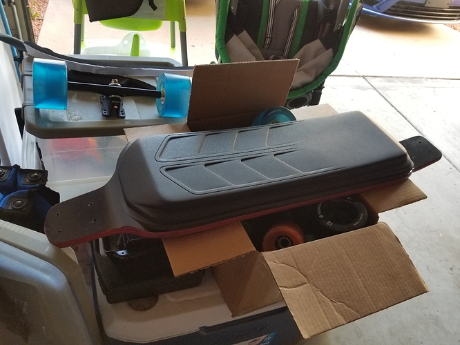

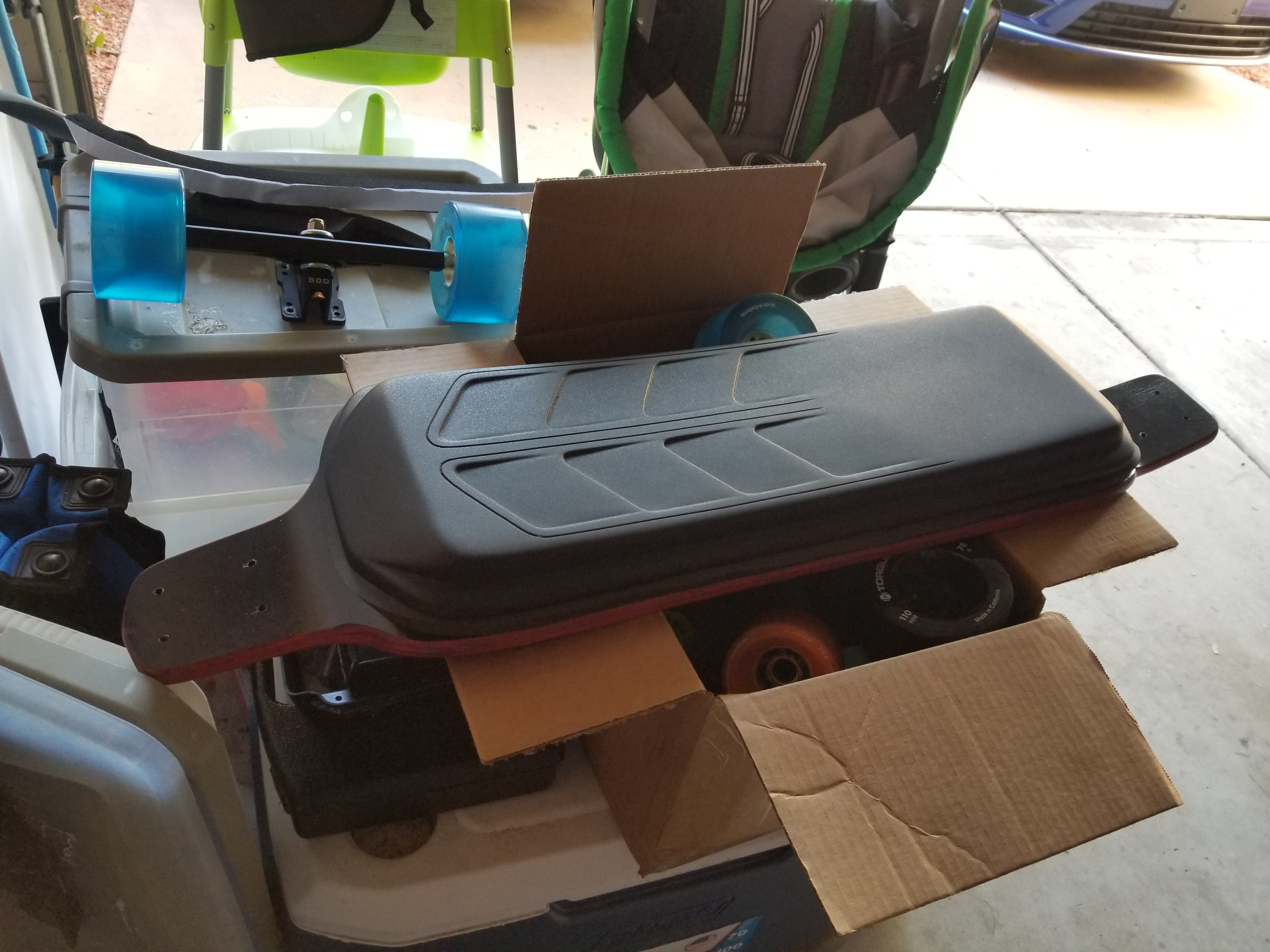

Is this a an evo with the eboosted enclosure? Single stack? I have been wondering whether my 12s4p 21700 build would fit or not, so this answers that question haha. I used mishra’s design so its a little narrower. How much space do you have left over for everything else?
That is a Subsonic Century with the eboosted enclosure (single stack). There is enough room for a reasonably small BMS and two single ESC’s or a dual controller if that is your thing. I am planning to put a Bestech D140 and two v6 neoboxes in there.
You cant just take and scale it. All the holes will go out of proportion. All side thicknesses will increase unnecessarily.
