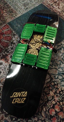

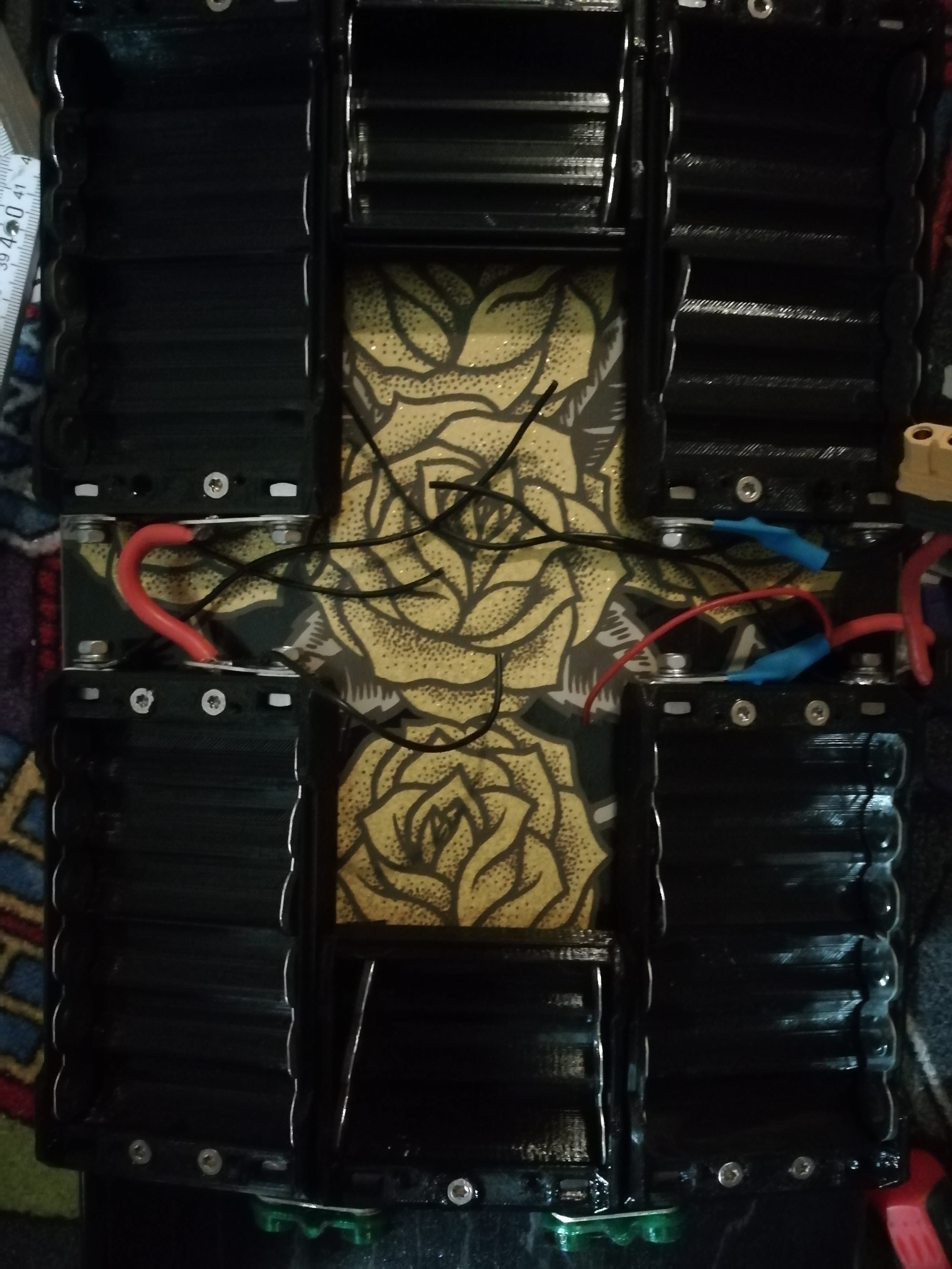

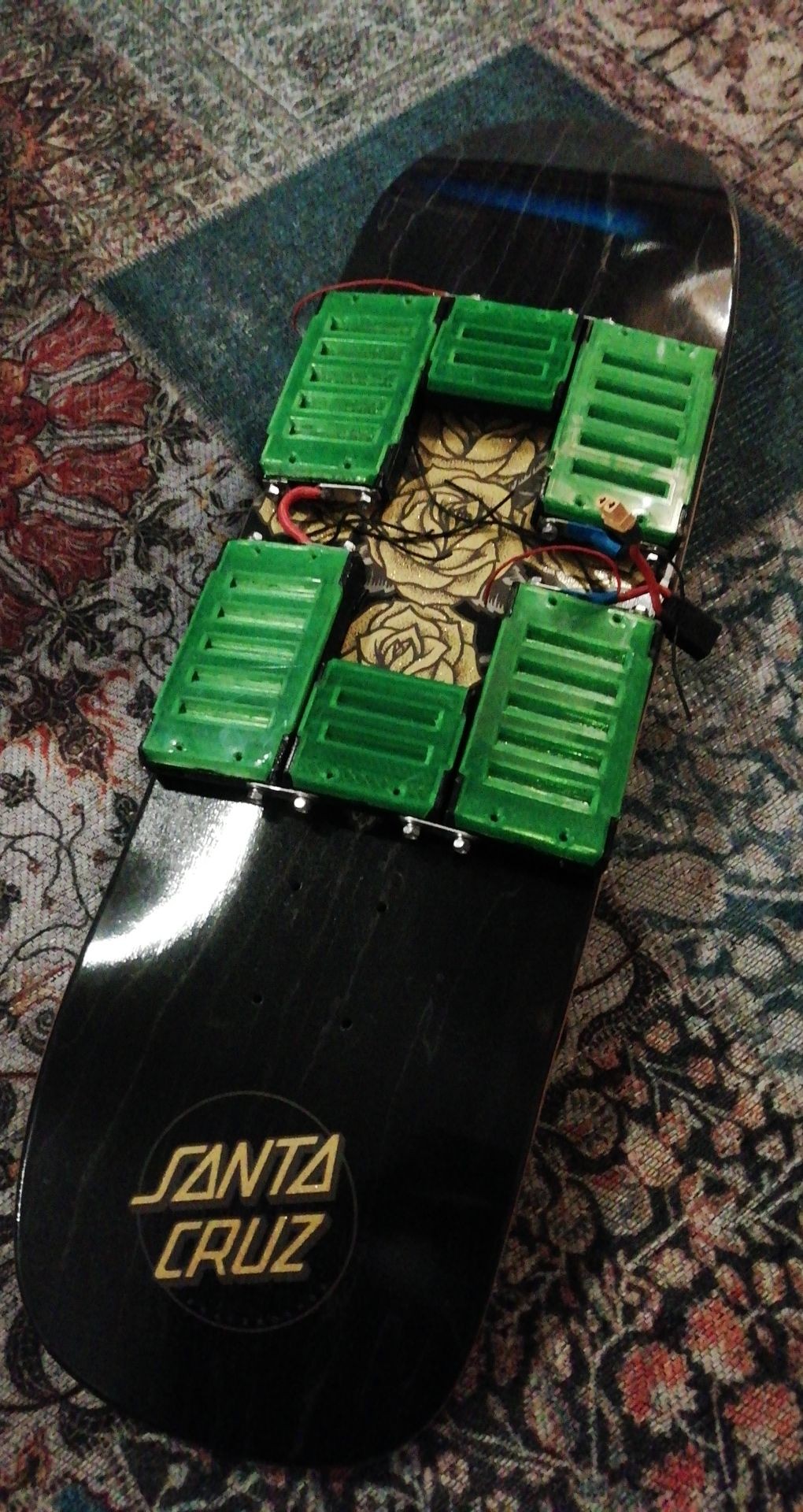

new kind of NESE arrangement on an oldschool street deck:
Me personally went to self welded packs in favor of capacity but since I’m building for someone else I need to do it as safe as possible and for that NESE is my absolute favorite :slight_smile: Gives me a good feeling.

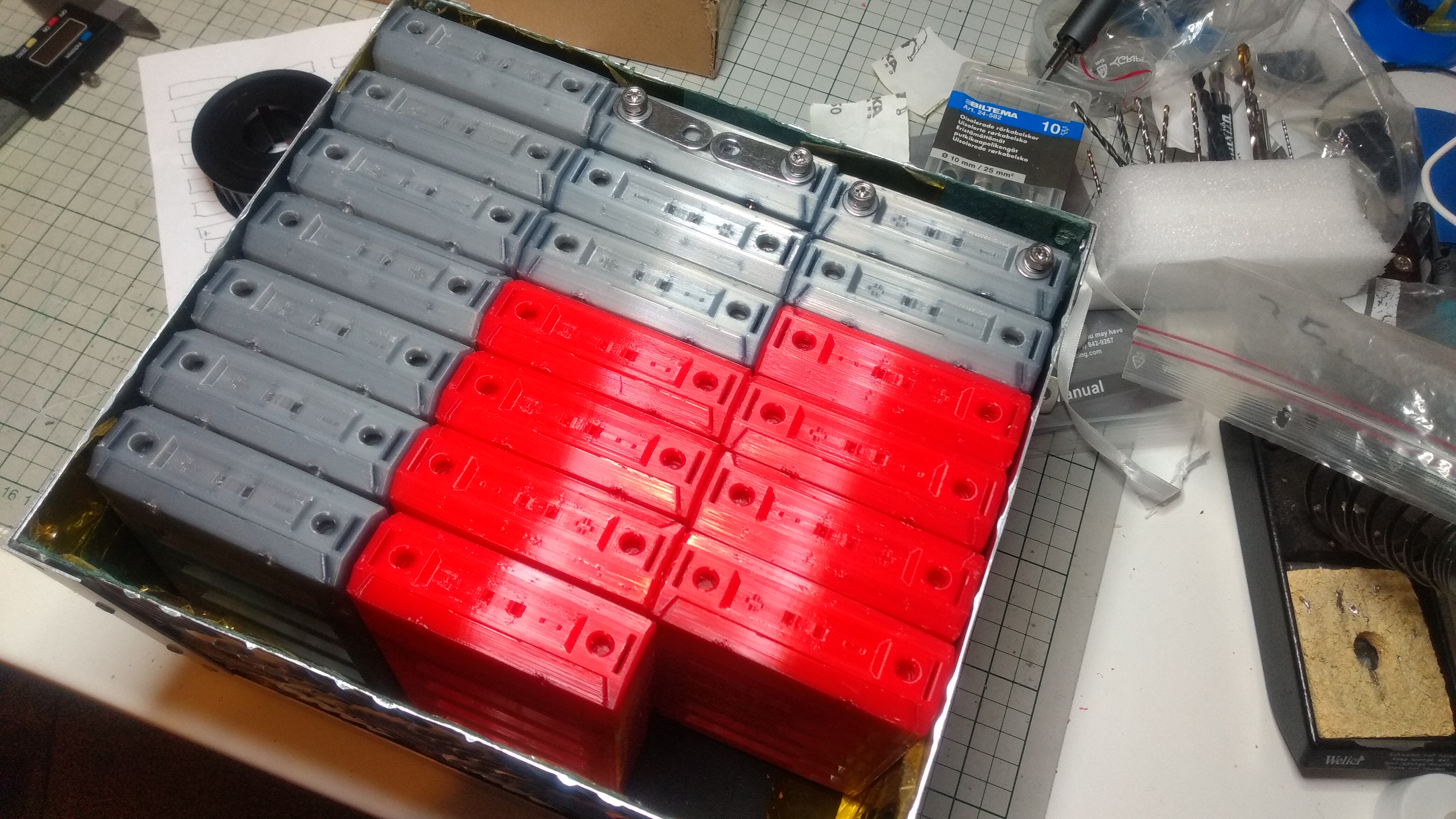

Finally… Almost 20 days of printing. Going to build a 20s6p out of Molicel p42a for my electric gokart. Just ordered the hardware to go with, from the NESE store…
hawt!
My ocd is killing me, print another box for the empty space!
I need the space for the fuse and the 4awg wire going out there. And in the future the empty space will be filled up for a 24s setup.
There has to be some order with colors too, each second red or some sort of simeyrical order :joy:
My OSD is extreme too when it come to that :joy: I literally dig through hundreds of screws just to find identical two for that and this silly project and if i dont i go for fuck sake and my day is ruined :joy:
