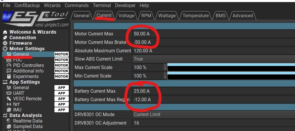

Going for a single drive, got a Flipsky 6374 190kv, with the VESC and motor plus that 2p battery I get 30 mph and 12 mile range. That’s with it being on 30A

30a peak…if u set the “battery” to that ok but set the “motor” to way more for performance. Dont know what that esc is comfortable with.
30 amps to the motor is lackluster. (W that kv n gearing). But no stress on the battery if u set the motor to higher, that’s just stress on esc
What you recommend I set the motor to

When you set up the ESC it detects your motor and estimates a maximum for the motor. A 6374 is usually good for ~70A I think, but I’ll let someone else suggest a safe value for the flipsky because I can’t remember off the top of my head sorry
Ok, I just want the best optimized performance for that ESC and motor

Again, you can set the settings as high as you would like but that will most likely kill the ESC. If you do not want to kill your $100 ESC within the first ride, set the battery amps to 25A, and maybe do 50 motor amps.
Dont know what that esc is capable of. And then u could maybe heatsink it for less chance it’s damaged, if ur within the recommended voltage temp is the only obstacle
Most people want real torque. On hubs I set both motors to 80 amps.
Even if u set the esc to higher battery amps it’s possible you wont be getting there anyway. Actually 30 amps is not much though for the whole vehicle but even then I’ll only hit maybe 50 for seconds and I’m 150lbs and like to race hills and ride fast.

Is that what i should set for the maximum discharge or continuous
Should I stick with 30A then, even with it being on 20A I’m getting a decent speed and mileage

After you run the motor detection, go into the general>current tab and set the circled numbers to what you see in the picture.
For both the motor and VESC
Never mind, thank you
