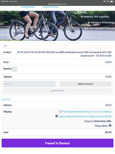

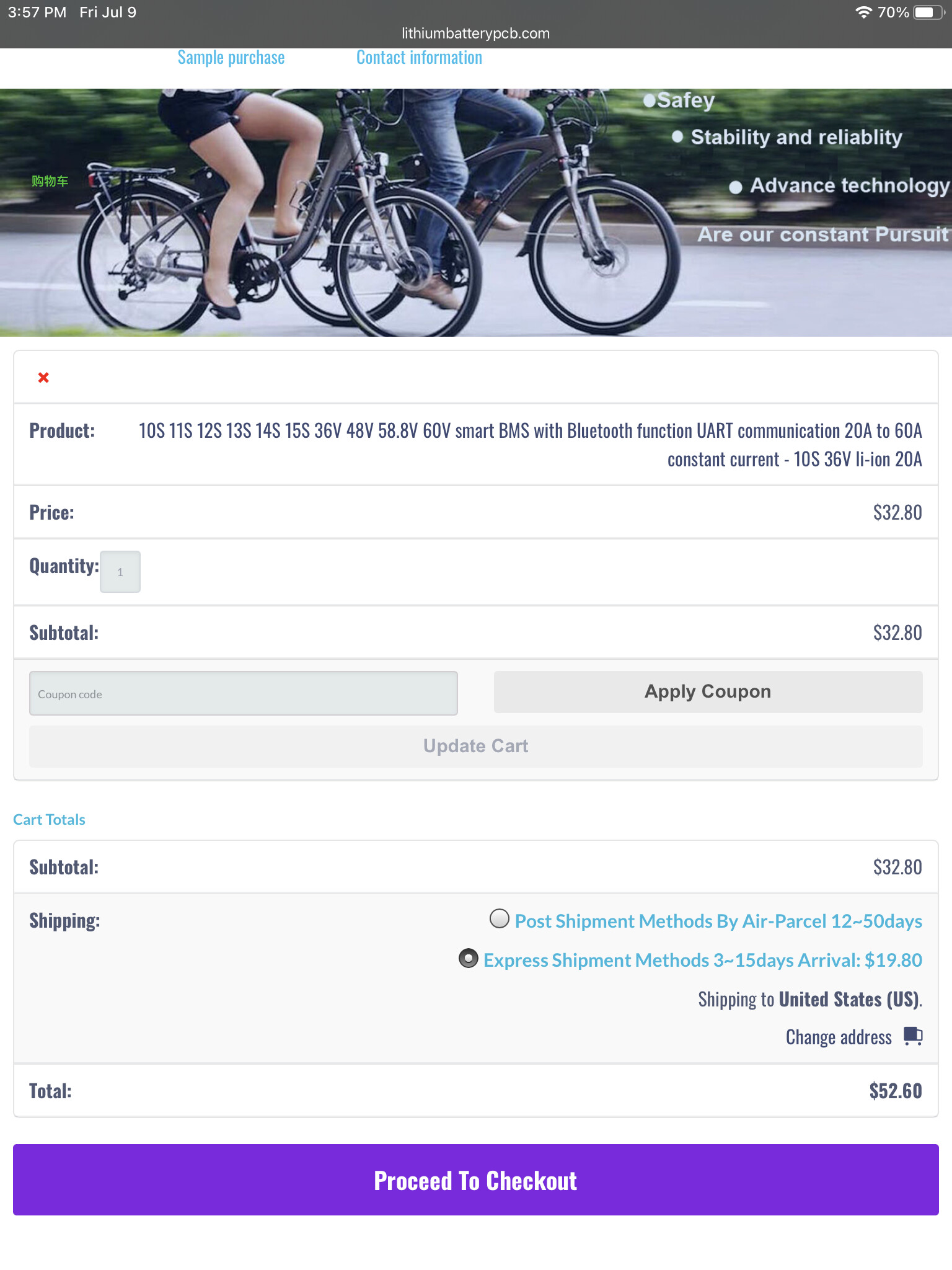

About to get a smart BMS (my last part I need!) anyone know any codes for coupons? Just wondering since the option is there
Make sure to get a lipo BMS if you’re using lipos.
Get the smart BMS that is 10S Li-ion (3.7V), Lipo and LiFePO4 are not the same thing.
@Red_souls The one you have in your cart is correct.
The one that Red_souls has in his cart is correct. I was just making sure Aviator didn’t confuse him into buying a LiFePO4 BMS by saying lipo.
Jesus I can’t read sorry, thought you said incorrect
Yea I knew it was correct, was just asking if anyone knew any coupon codes
I bought mine from AliExpress. Ended up being about $36 with free shipping that arrived in just 12 days.
Huh, I thought you would need a different BMS for lipo and li-ion. I stand corrected.
