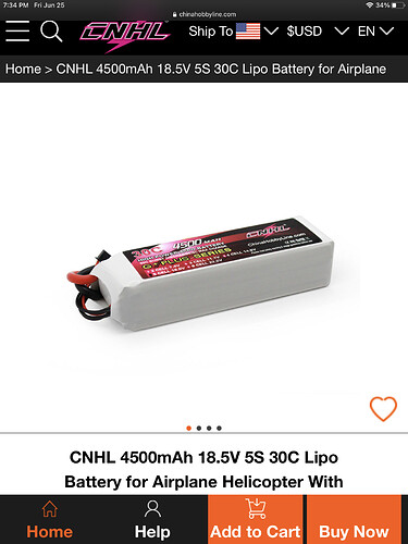

Ok. Which lipos are you going for? and are you in the states?
What are the best lipos and most reliable, yes I live in Illinois.
I linked you to two earlier. pick one of them
Gonna go with two of these which will give me 10s right
yes. 167wh total

Get the BMS too. And you need velcro and 2x 5s balance extendors. you have ebay?
No I don’t
Ok You need 2pcs of these
Find them on google somewhere.
What do those do?
They will go from the lipos to the BMS harness
