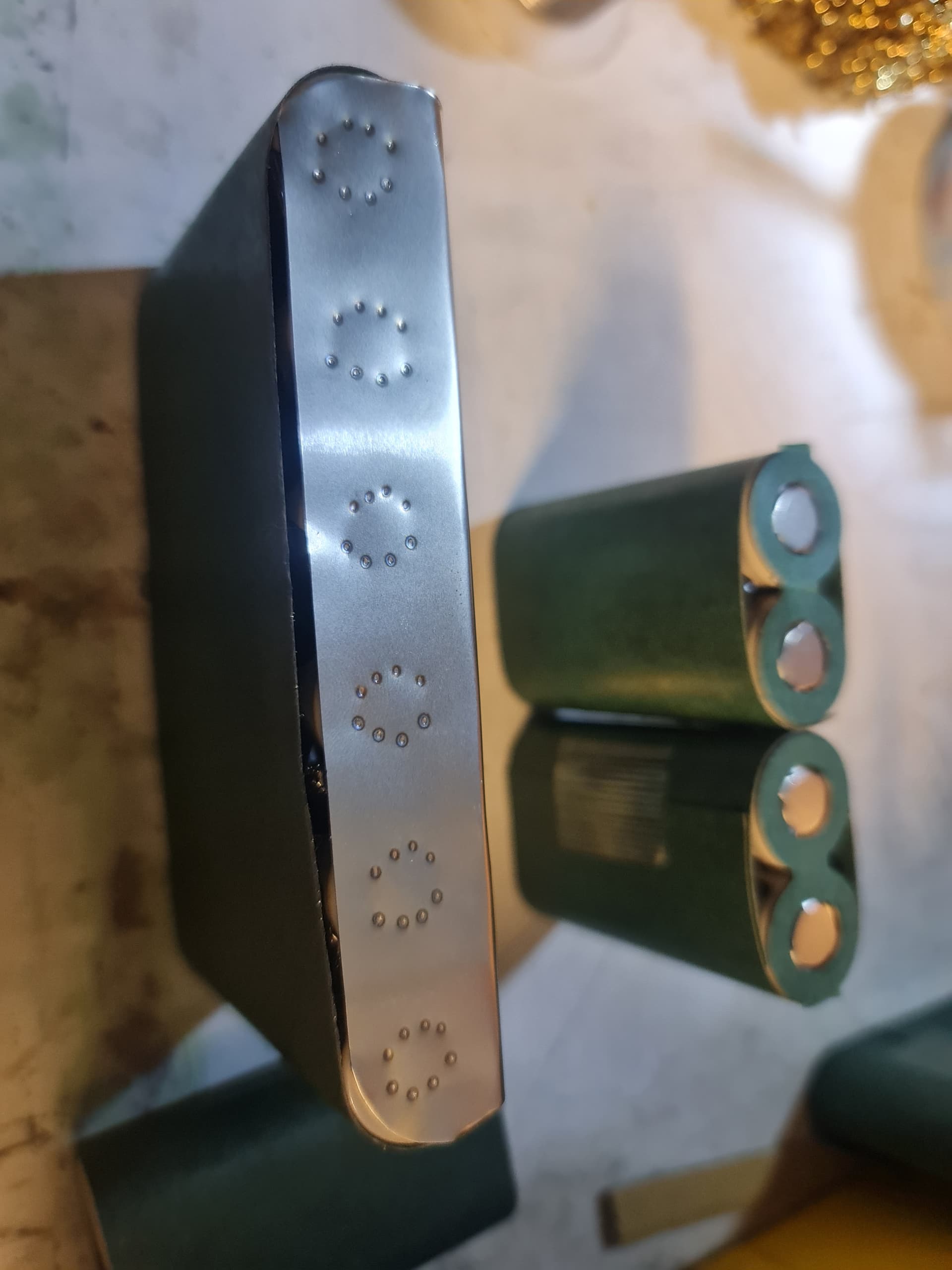

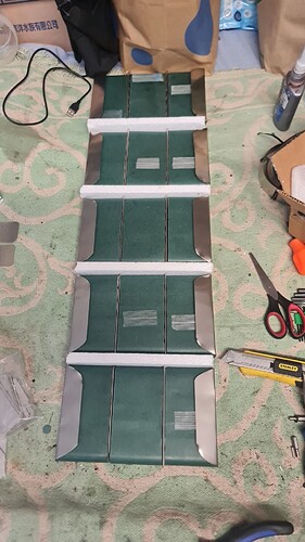

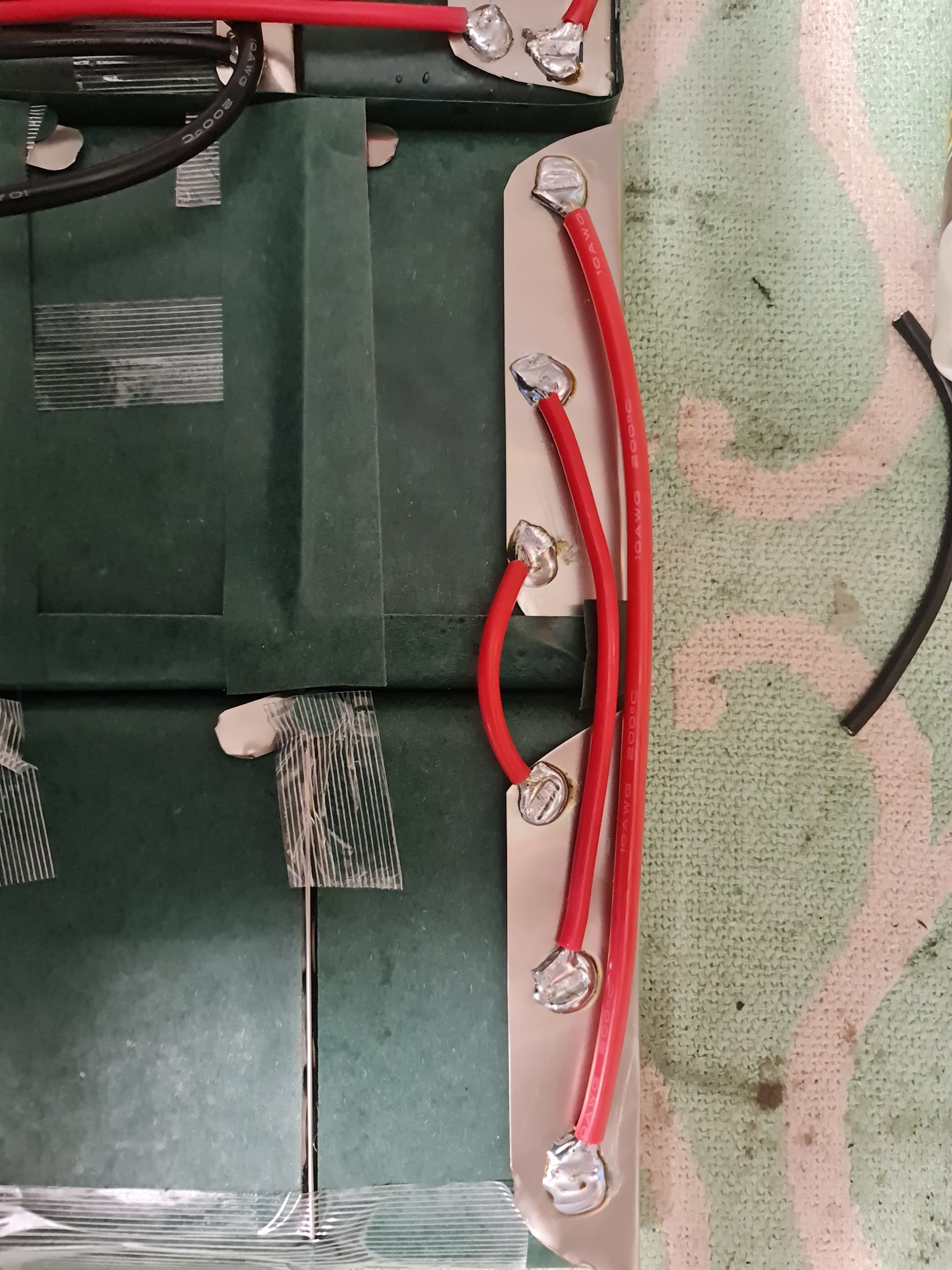

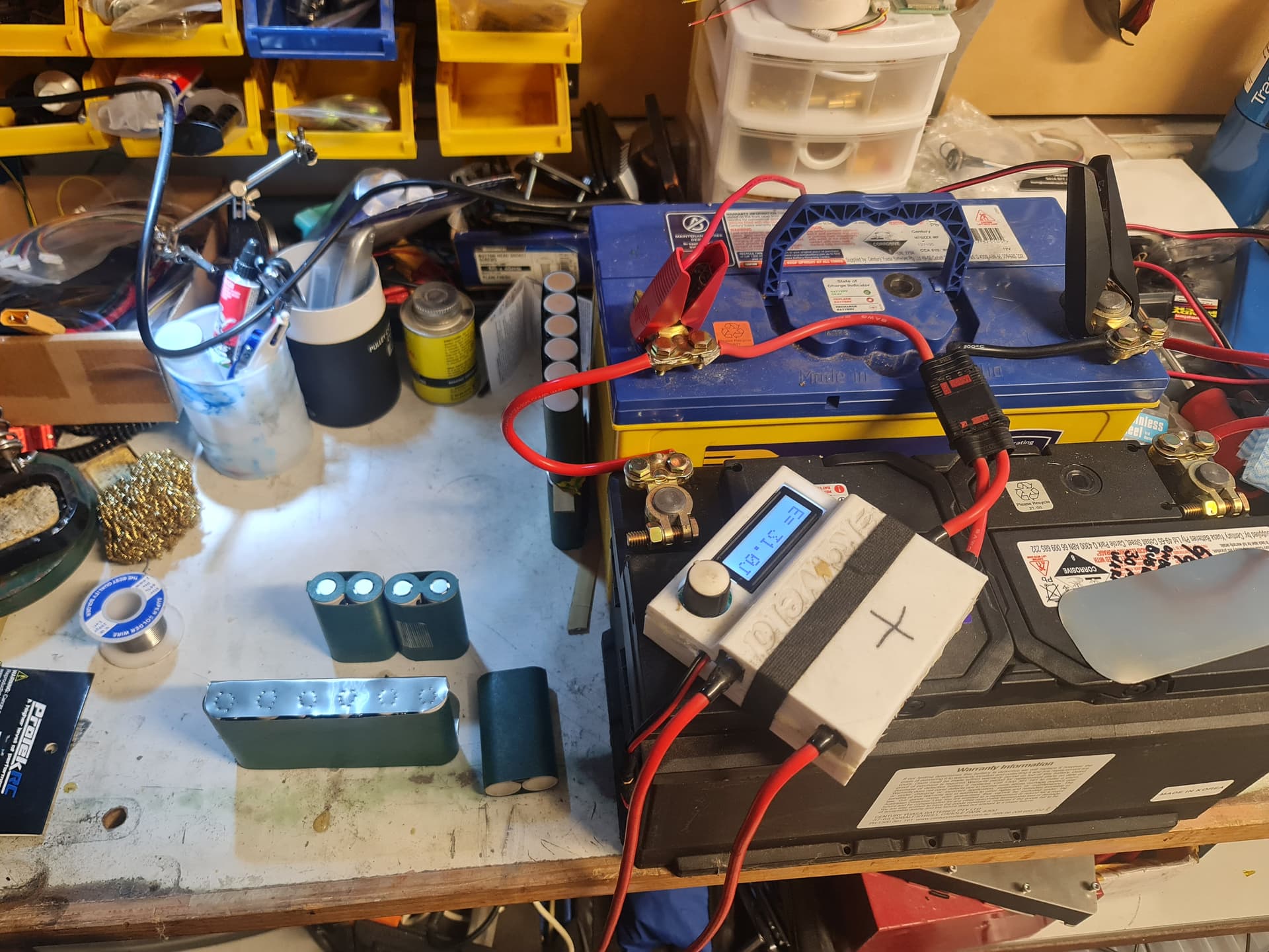

It was a daunting task taking on a 16s6p p45b battery build that must fit in and enclosure that only just squeezes in 96 cells single stack (especially as my only other battery build was a little 10s3p). Thankfully @glyphiks guided me through like a guide dog leading the blind! Thanks heaps for answering all my questions!!!
I definitely made some errors along the way, the biggest was cutting my nickel too big and it going too close to the edge of the cells thereby not leaving much room for unwanted potential shorts!! If i had more space to play with i would have really liked to squeeze a thin strip of rubber between the groups.
My soldering still needs work but even though the joins dont look the best they are strong. A good yank and holding well.

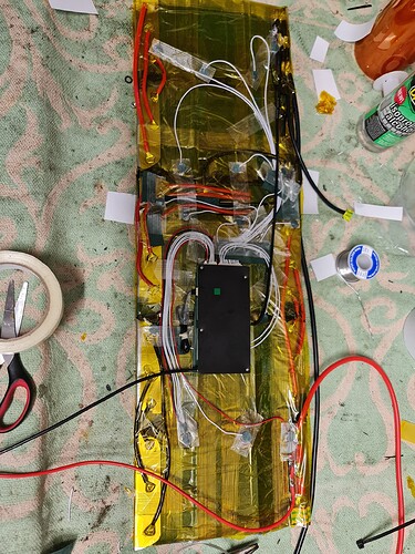

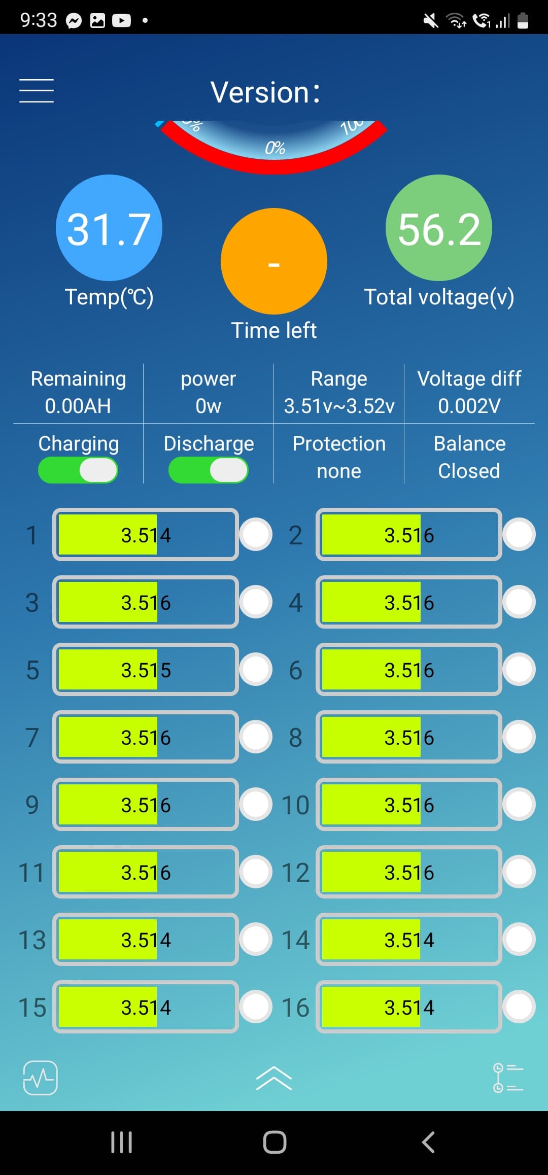

The BMS was a headache and i gave up trying to avoid crossing balance leads. The top of the pack is fairly well protected anyway as the height of bms id above all the cables so friction will be fairly non-existent with balance leads. I still used fish paper where there were cross overs just in case.
All i have left is the QS8 loop key then running off to xt90 plugs at each end.

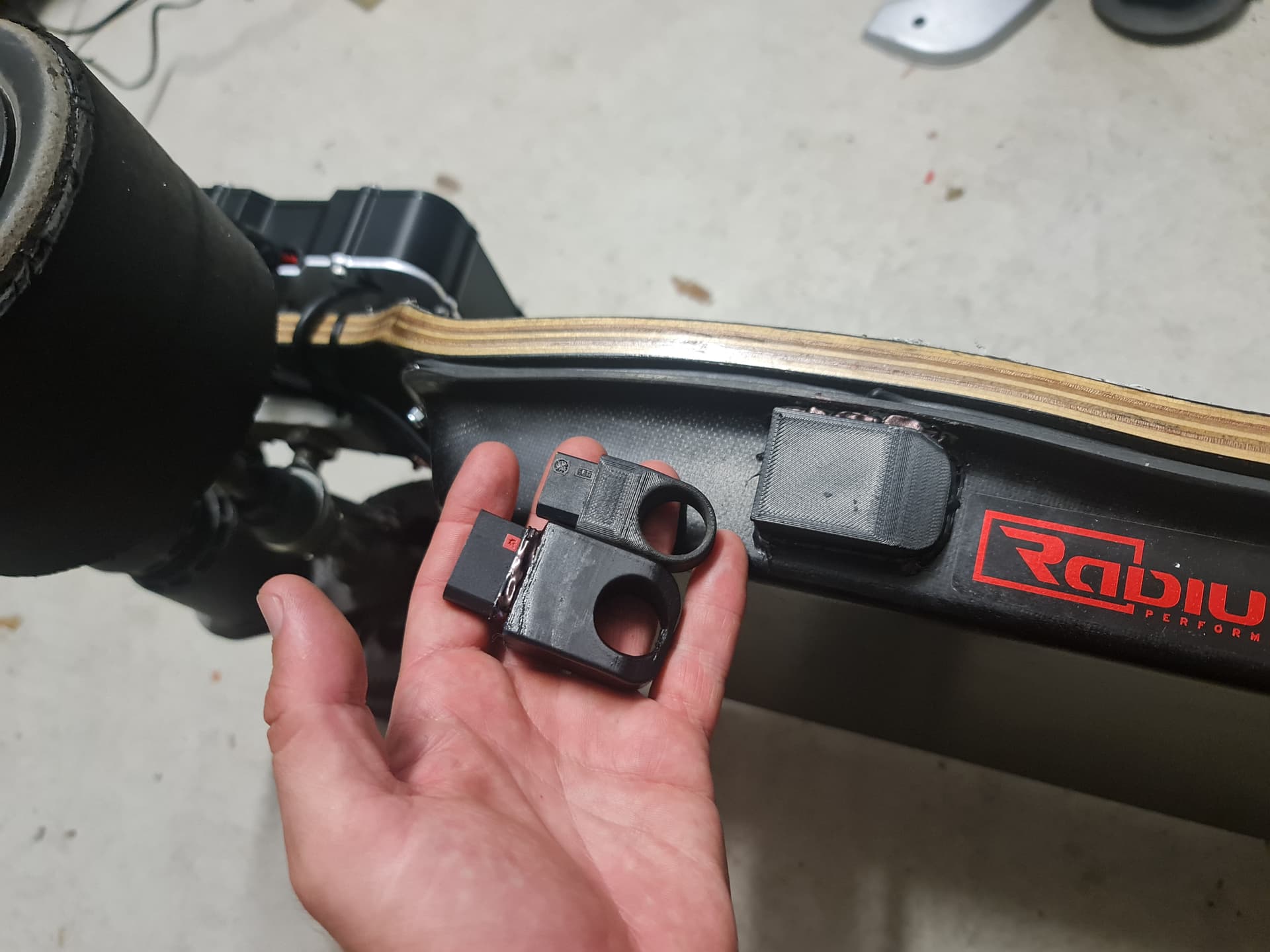

In the end it all came together using the latest vesctool on PC, plugging usb into the non-switch side of the D100s, doing a motor detection of all 4 motors over canbus, doing input setup with remote reciever plugged into the non-switch side and having no metr attached (metr module died at some point mucking around with various combinations).
D75 power button functions correctly. D100s only turns on but I have a QS8 loop key so doesn’t bother me too much. I’ve tried changing app setting on the switch side of ESC to ‘turn off after 30’, ensuring the other side is ‘always on’. The change of app setting never sticks.

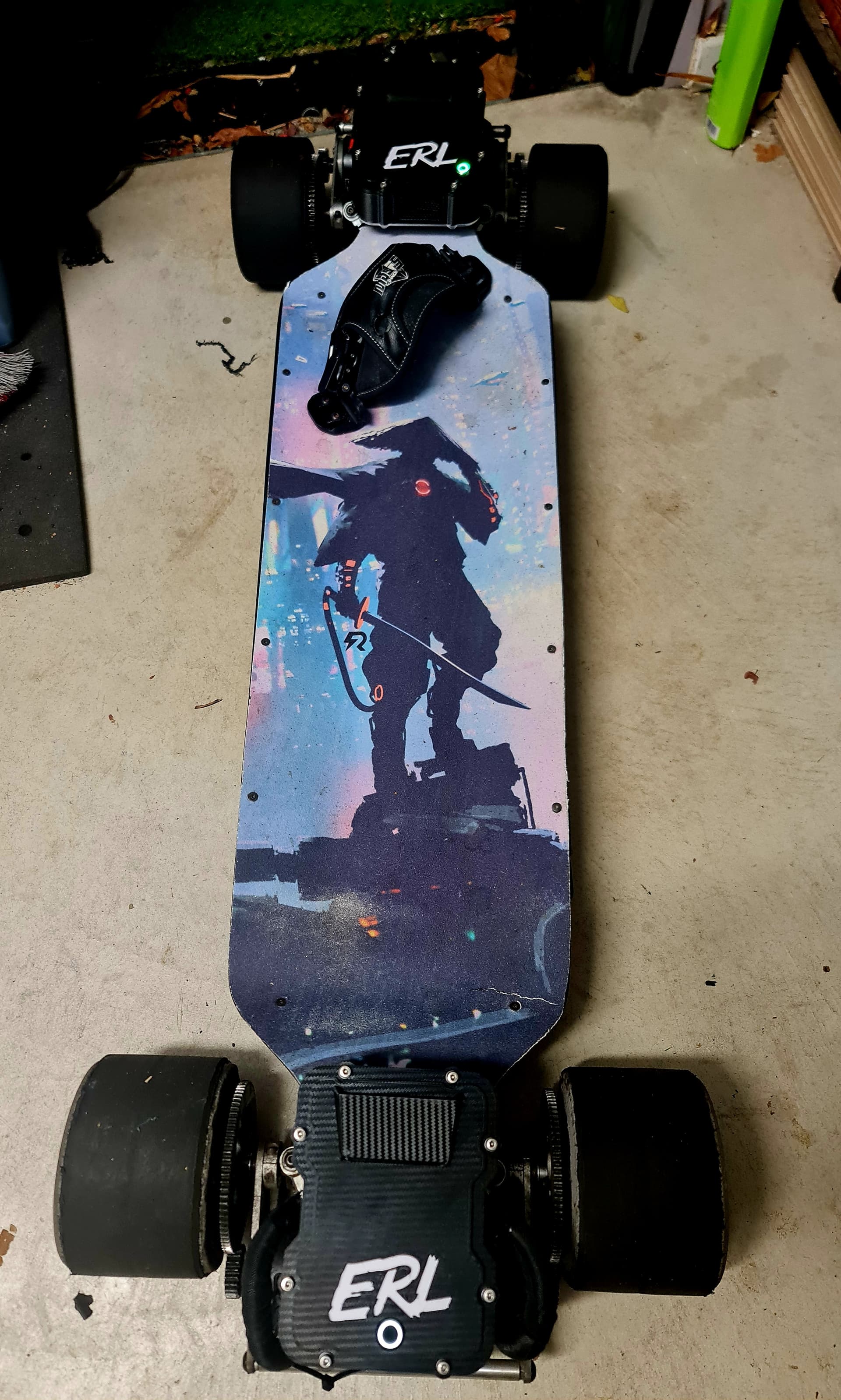

I am very pleased with the new ESC enclosures. Bonnet scoop with a mesh opening at rear for plenty of air flow. Boxes are raised off deck with aluminum baseplate so acts as a heatsink as thermal tape used to adhere esc to plate.

Went out last night to test the new setup and didn’t die so that’s a positive. My board didn’t catch on fire and I didn’t crash so win win!
I had a few front motor screams and cutouts after several laps of T racing so I’m thinking when things get warm something isnt’t happy. Overall I was pleased with the first test run as I was hitting mid 13’s on T racing with my 22/78 gearing (about 80kph) and zero throttle expo. I think once I change to 18/78 and bump up throttle expo this thing will be hard to manage!
