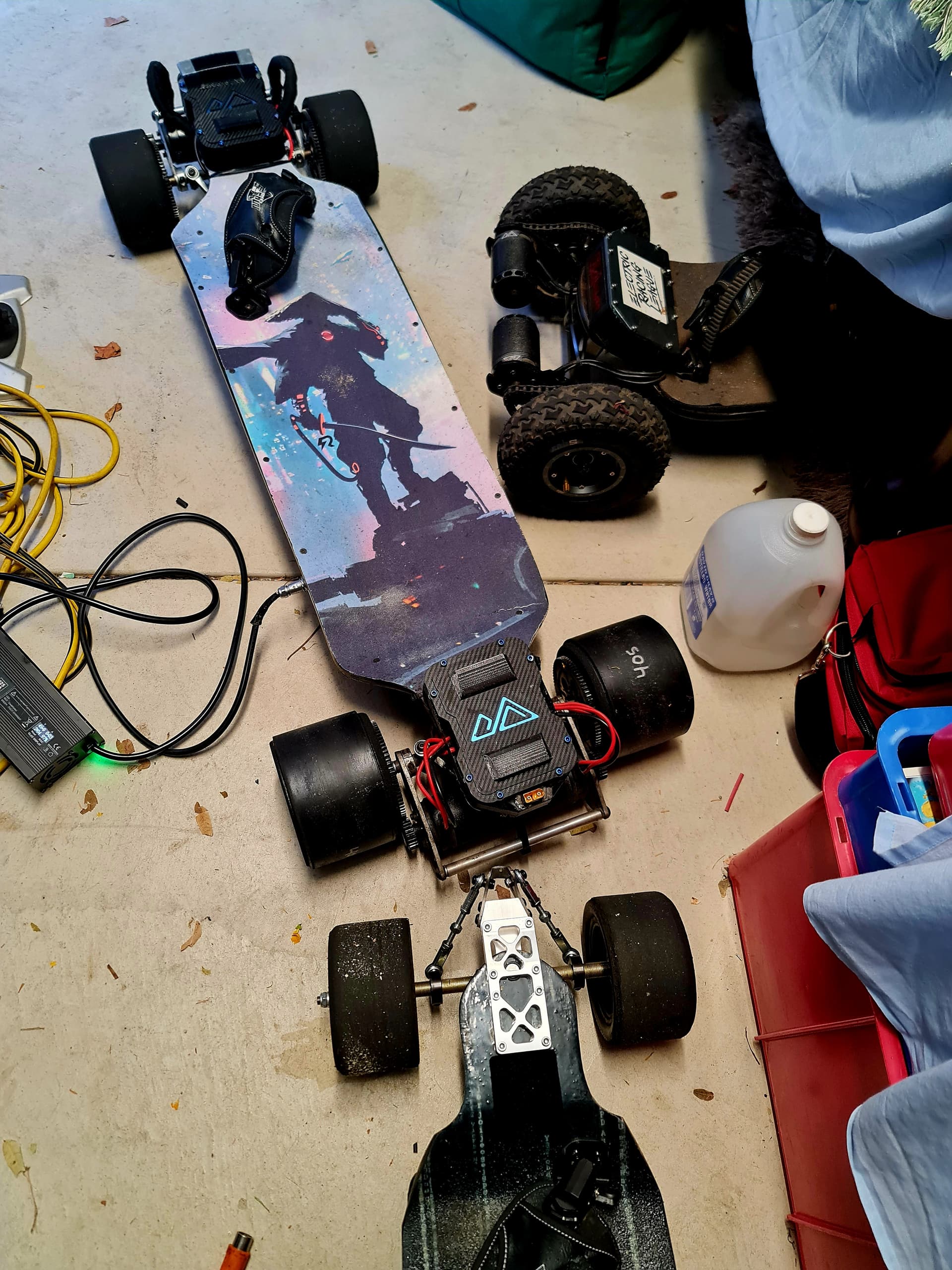

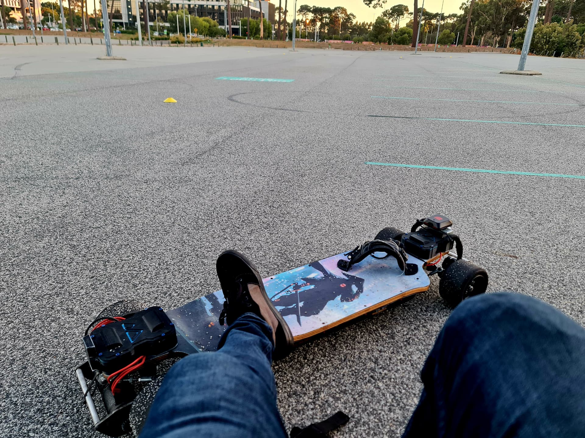

Got me some wide boys for the rear of my Semendeed and instantly paid off. Wiped over 1 sec a lap off the I2S Chicago circuit and move into 4th :relaxed: Eying off a podium with Mario Chacon 1.3sec ahead. Still a bit of work to do!
@Tasventouras is closing in on the top runners in T Race too now he’s getting used to his BRPs. I think he’ll start putting pressure on me on I2S Chicago once he’s happy with his T Race progress.
Niiice you got them new proto 4 inch wide boys. That Chicago track looks a bit tougher to setup.

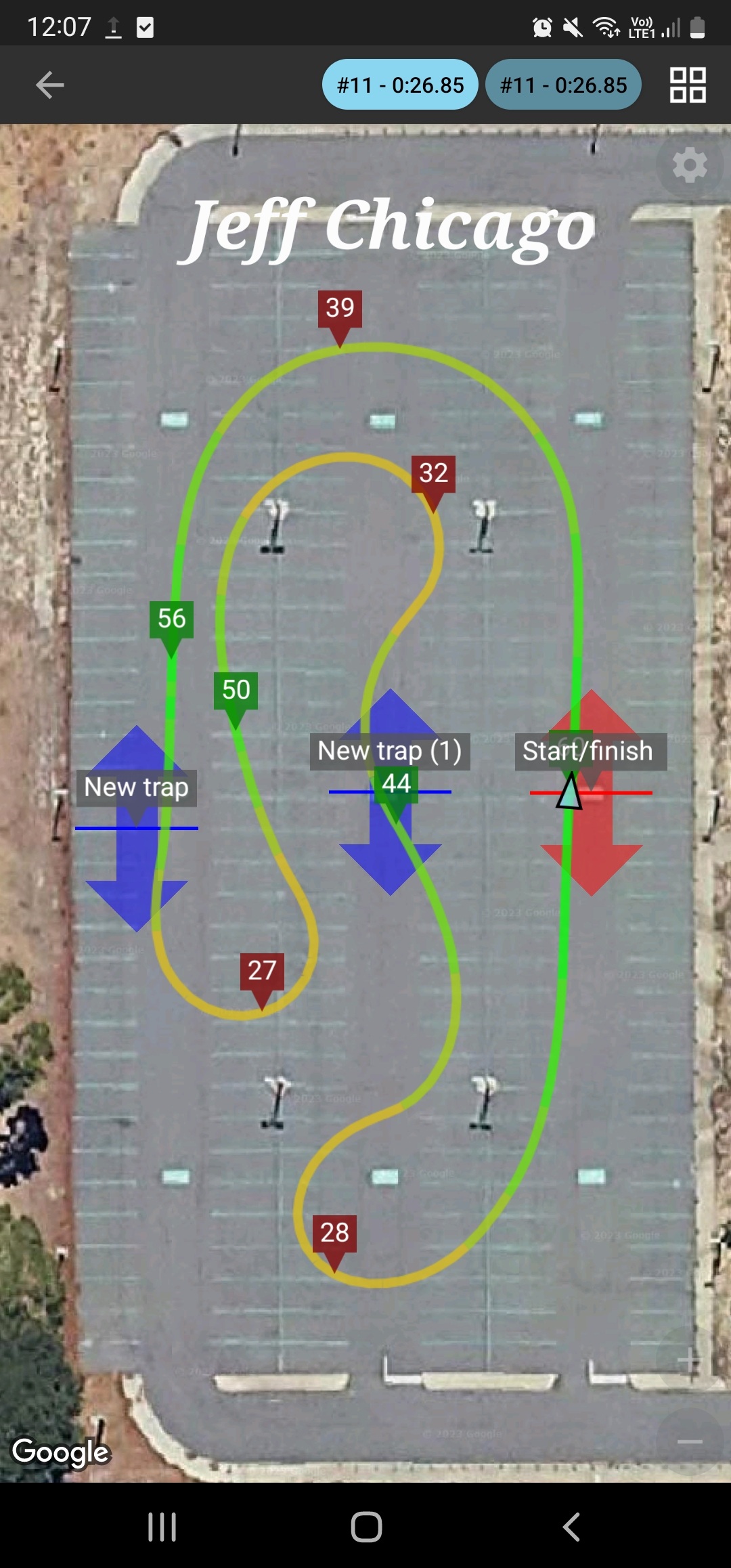

Yeah much tougher to setup but we have it painted so now it’s done we just put markers down. Originally took an hour to mark out with four of us.
The 4inch tyres are good on this track but slow me down on T Racing! Harder to get around tight bends.
Oh snap painted lol. Where you find a spot to paint!?
I also heard from Mario the 4 inch wheels are bit tougher to warm up?
Just a big carpark. Dotted it out with paint. Security didnt seem to care.

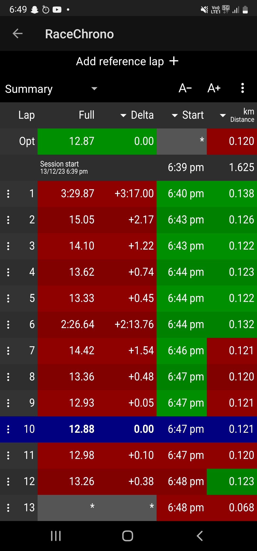

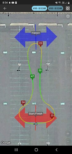

Tas’s recent rise to the top of the T Race charts got me to make a few tweaks to the Semendeed to have another crack at getting the top spot back. Loostened bushings and upped motor amps in the rear a tad, and went with a 10% throttle expo on the new puck FW.
Pretty bloody stoked to crack the 13 second barrier and did it three times in a row! Still haven’t quite got the all time fastest 1 lap held by Mario Chacon, but very close.

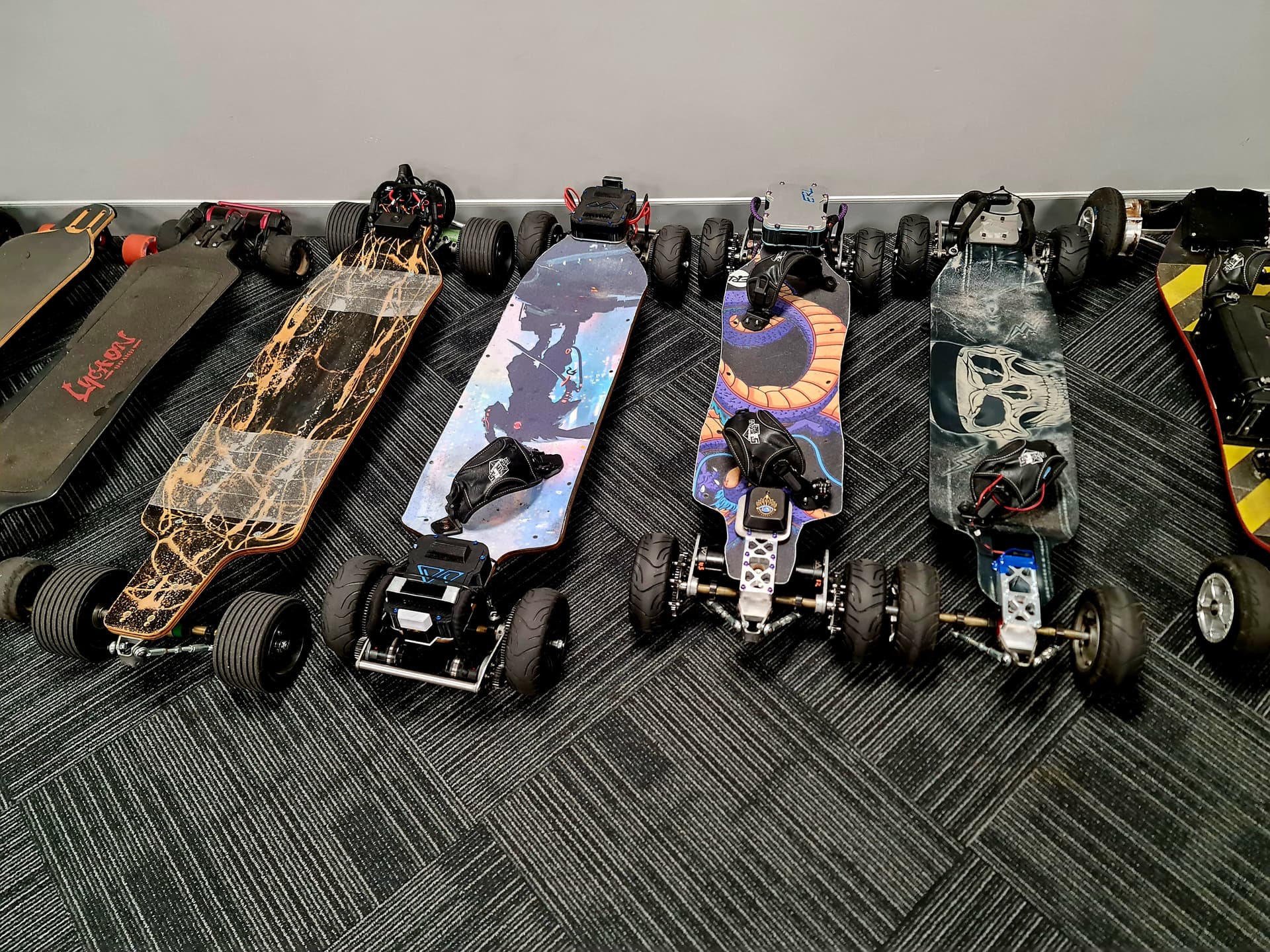

Some fast boards getting around and some up and coming racers improving each session :blush:.

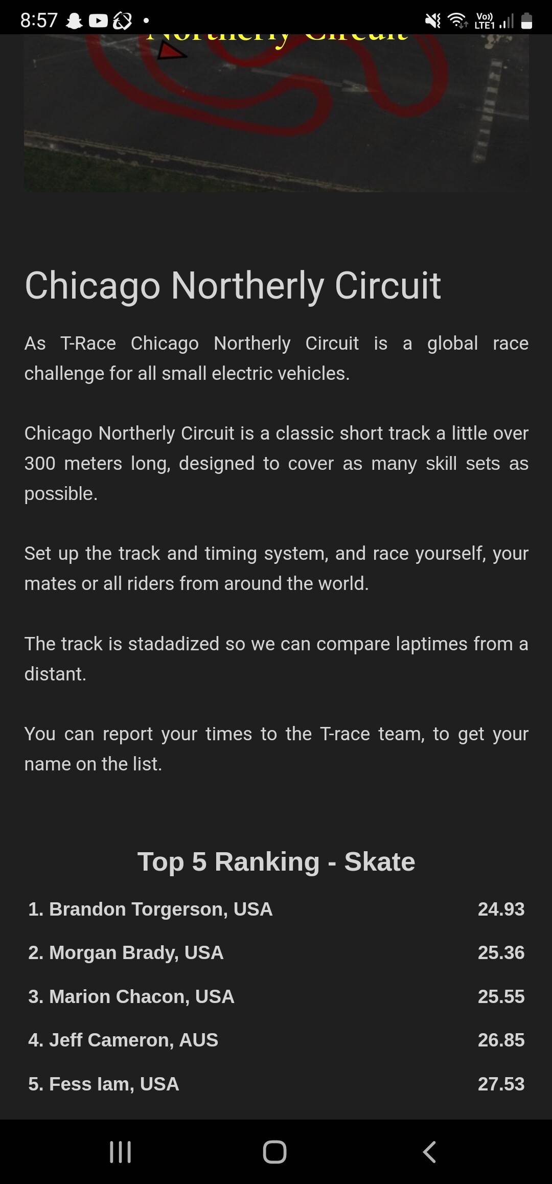

The next goal is to break into the 25s on Chicago Northerly circuit (unless Tas gets back in front of me T Racing tomorrow night!).

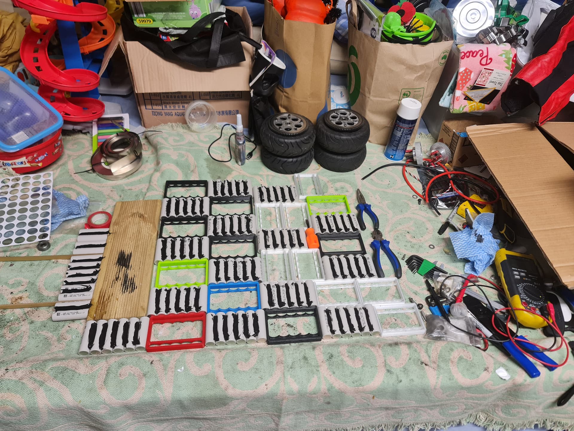

Looking at doing a battery re-build for my racer as after a near 12 months thrashing my battery the voltage is starting to reduce. Got hold of some p45b cells from local battery builder Marsen Energy so I’m going to build myself a replacement battery. Question is, what configuration? Stick to my reliable 12s8p config or go to 16s6p?

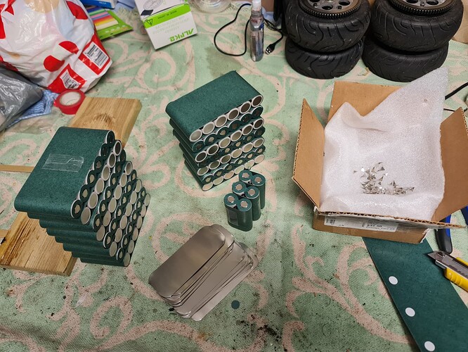

16s6p Molicel p45b underway. My silicone job is less than desirable but got covered in fish paper anyway to hide my sins haha.
Nickel is cut and welding will commence over the weekend. It’s my second battery build so I’m pretty nervous but keen to get it done. Have run everything by @glyphiks which has put my mind at ease somewhat so thanks for that!
I’ll be running a single QS8 loop key this time so ESCs are powered at the same time. I never had an issue with two loops keys previously but it’s easier anyway. D100s and D75 have power buttons too so :crossed_fingers: i can get them cooperating over canbus.

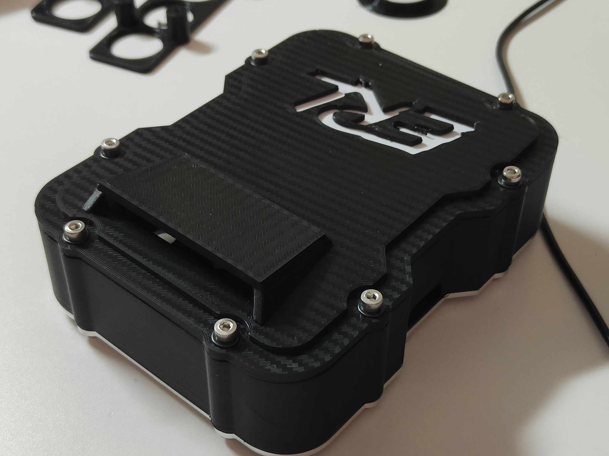

I’ve also had my esc boxs redesigned with the help of @Tasventouras and his contacts. Bonnet scoop at front of box and rear of box will have a mesh cutout to allow air to escape. It will also be raised with an aluminum base so it acts as a heat sink for the esc with fresh air passing underneath it.
Im hopeful this will allow me to push the limits of these escs. I’m also very hopeful the 205kv Radium Reachers will hold up to the higher voltage and not thermal throttle too early in races :crossed_fingers::crossed_fingers::crossed_fingers:
