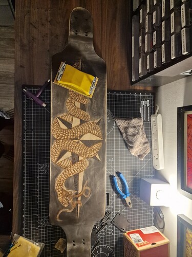

I was hoping to have a finished deck for show but life got in the way this evening. Since I promised an update, here is Nagini in all her beauty so far:
I’m super stoked with how it’s coming along. It is exactly what I had envisioned!
As you can see, I sanded down the back and re-stained it. It is much more uniform now.
I got sloppy with the surface prep on the front side though because I was too excited to see it come together, so there are some blotchy patches I’ll need to sand off and re stain. I’m hoping I can get away with just redoing small sections without there being any disparity in colour or surface finish to the bits I am not going to sand…
Some of the stain leaked into the pyrography so I’ve had to file it down in those areas and will need to reburn some sections. This shouldn’t take too long.

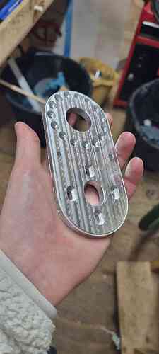

Excuses aside, I’m back to provide you with more Nagini content. I’m currently getting my custom motor mounts machined by a friend I made at a meeting up in the land of the Scots, and I’m SUPER excited to have these in my hands. Here’s a progress pic:

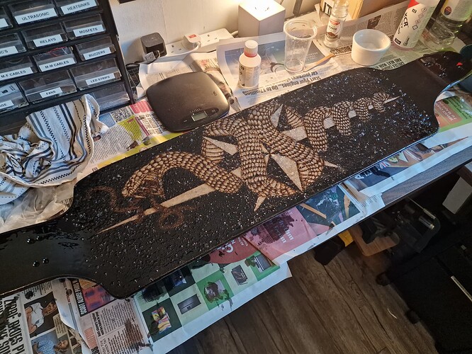

This was a nightmare. I hope it turns out okay, Imade so many mistakes with the resin. Its my first time using epoxy so I was quite nervous but I thought I had it all planned out until it came to the pour.
I mixed up 200g of resin, thinking it would be just enough to cover the top surface of the deck. I had clingfilm on my weighing scales to prevent them getting epoxied but unfortunately it was messing with the readings and I accidentally added about 5g too much resin, so I compensated with an extra 2g of hardener.
I poured all of the resin onto the board because I was worried about it getting too hot in the cup. That was my second mistake. I used way too much and it started to drip down the sides and create little icicles.
That, and the fact I had slighlty screwed up the proportions meant the resin was runnier than expected and took about 15 mins to get tacky instead of 8. Because I hadnt warmed up the deck, it started to form pits or bubbles. I tried removing them with a blowtorch but all it was doing was burning the deck, so I switched to a heat gun but that was just blowing the resin around. Instead, i kept brushing back and forth until it was tacky enough to stop the bubbles forming.
Where I had brushed the icicles away, lots of resin got onto the other side of the deck (the top surface) and I realsied it would create an uneven surface and when it came to coating that side properly it would look shit. I didn’t have the option of sanding it away either because that would ruin the pyrography and stain, so instead I quickly fashioned together a stand for the board with a piece of pallet wood and some screws. This allowed me to tip the deck over so I could quickly mix up more resin and coat the other side.
I mixed up 100g, this time without the clingiflm on the scales so it was correct, and carefully turned the deck over. By this point, more icicles were forming and had become quite tacky. As I was trying to brush them flat, brush hairs were getting stuck to the tacky coat and I had to remove them from the board.
I poured the 100g over the top surface of the deck which again, was slightly too much and was too runny and creating drips. I smoothed over the semi-cured sections that had bled onto the surface with the second batch, and spent about half an hour going back and forth with the brush, removing drips and ensuring an even coat. It’s not perfect but about as good as I think it’s going to get.
I realised that I was low on resin and didnt have enough to do a second coat as I had planned, so I wanted to put the frit on at this stage. I had 100g of fine frit and 25g medium frit. I poured the medium frit into a small bowl, and salt bae-style trickled it onto the deck. It was really uneven, so i used one of my brushes to try to redistribute it.
I then found that the 25g medium frit wasn’t going to provide enough grip so I emptied out a plastic pepper grinder from the kitchen, filled it with the fine frit and started to apply it. Unfortunately the grinder was crap at letting the frit pass through so i poured it into a small bowl and employed salt bae’s technique once again. This worked quite well, but in order to ensure an even distributuon I had to use about 25g of fine frit. I then took the brush to it to distribute. Lots of frit was coming off onto the brush, but enough remained on the deck to provide grip.
Long story short, I spent about an hour and a half panicking, and it felt like a total shit show. However it will be the end result once cured that determines if I’ve managed to pull it off or not.
