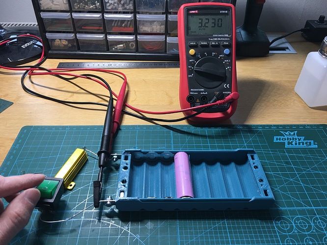

I did a few experiments to find out what wire gauge would be appropriate. I have an assorted collection of diodes that I have actually never used. I found out they have wires of various diameters, which came in handy now. :slight_smile:
Using a single Samsung 30Q (charged to 3.8V initially and 3.6V when done with experimenting), I tested how the wires will behave under 10A current and under a short circuit. I was looking for gauge that withstands the 10A reliably but at the same it pops as quickly as possible in case of a short.
I used a 0.33 Ohm 50W resistor as load. At 3.8V, this would produce ~11.5A (going gradually towards 10A as the battery looses charge).
I first tested a very thin resistor wire (0.34mm / 28 AWG). No chance to withstand 10A with that one. It popped immediately.
Next, I tried a 0.44mm / 25 AWG wire. First, I used about 3 cm of the wire and that one burned pretty quickly at 10A. Then I realized that I would need a much shorter fuse wire in the NESE, so I tried again with ~0.5 cm wire. That one stood up to 10A just fine:
I then tested a short circuit with the same setup. I took this experiment to my balcony, just in case. :slight_smile:
Success! It popped immediately. (Note the wire that shorts the switch directly to the NESE module, bypassing the load resistor.)
Next, I tested the short circuit with 0.50mm / 24 AWG wire to find out if it’s also useable:
It still managed to break the circuit quickly. This wasn’t so convincing though since the fuse wire didn’t pop but rather it desoldered itself from the bigger wire. It would have probably still popped if given a little more time. Anyway, I liked the way the 25 AWG wire handled the short much better so I went with it for the NESE.
Here’s testing the fused NESE with ~10A discharge.
About 30 secs of 10A continuous and nothing happened. (Only the load resistor got really hot. :)) Good!
Time to test the short circuit:
And the fuse wire popped straight away, exactly as expected.
I may need to repeat the experiment with a little more current. So far it looks promising though. The only problem is that the fused tabs are a bit fiddly to make. Should get better with some practice.
What do you guys think about this? Can you see any issues?

Here’s another iteration of my experiments.
Thanks for the tip, @Agniusm. I tried something along those lines. Instead of kapton and double sided tape, I used fishpaper rings, including the centers. They already have the correct shape. No need to cut anything. Plus, the fact that the centers are separated from the rings actually comes in handy – the ring nicely surrounds the button on the tab and the center then covers the button. :ok_hand:
I just had to trim the sides of the rings so that I have somewhere to solder on.
This came out much cleaner than the previous version. Soldering on the tabs is pretty painful but I’m getting the hang of it.
Testing the fit:
I inserted the cell into each of the four slots one by one and measured the voltage at the NESE module terminals to make sure the cell has a good contact. It looked good.
I then went ahead and repeated my 0.33 Ohm load resistor test four times, one for each slot. This should discharge about 10A.
I did 10 seconds on each of the first three slots and 20 seconds on the last slot. All was good. Nothing was getting hot except for the load resistor.
I’m thinking of building a small 6S4P battery pack in this way and use it with a 40A limit for a bit and see if it works.

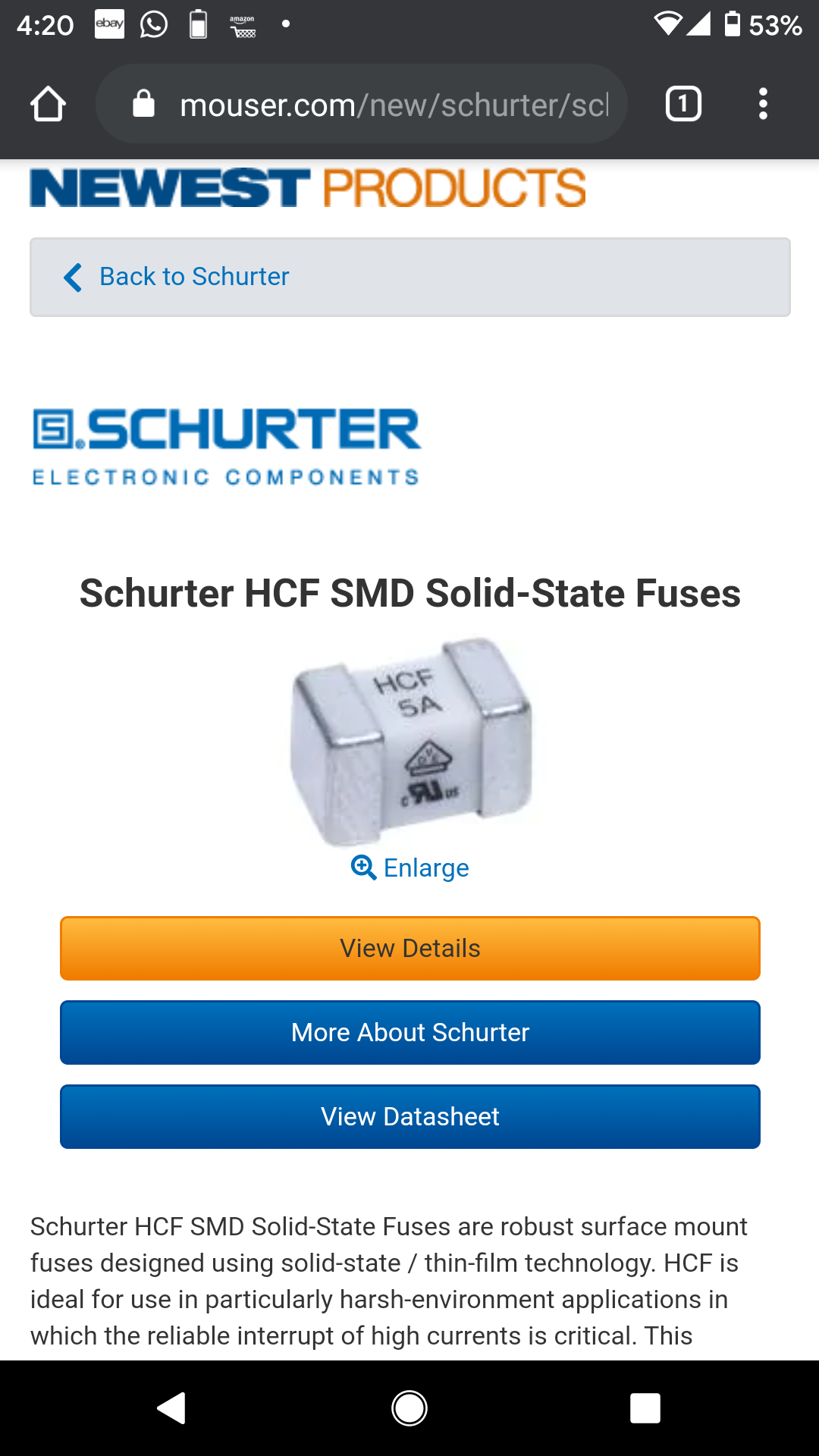

Would SMD fuses be any good instead of the glass fuses since space is a concern? Maybe something like this?
https://www.mouser.com/ProductDetail/Bourns/SF-1206HV10M-2
The length is only 3.2mm. Saves 7mm compared to the 3x10mm glass fuse.

Same size? The glass fuse is 10mm long. The SMD fuse is 3.2mm long. That’s quite a bit of a difference. Sure, the SMD fuses are more expensive but $0.6/pc I’d still consider acceptable. I suppose the most common NESE flat pack would be 12S4P with 6 pieces of 4P+4P modules. With SMD fuses, you’d save a little over 4cm on the length compared to the glass fuses, which is significant. Seems worth the extra money to me. Also, cheaper SMD fuses can probably be found. I just linked the first thing I came by.

This is a great design. Do you have a link for those fuse?
I did a little more searching for SMD fuses. This one is below $0.30/pc in bulks: https://www.mouser.com/ProductDetail/Schurter/3413032822?qs=tk5EcTX4n4wzBBF6MzsMfw%3D%3D
This one is about the same price, but even smaller – 0603 package / 1.6mm length – but it’s rated a bit too low:
https://www.mouser.com/ProductDetail/Bel-Fuse/0686F8000-01?qs=HXFqYaX1Q2xPwOwhLFPgJQ%3D%3D
I think nyou need to find some in this form factor. Otherwise those flat smd can’t be easily integrated?

True, I didn’t think of that. Would stacking a bunch of thin SMD fuses on top of each other be any good? That would make them parallel so if N fuses are used in this way, I supposed you’d want to reduce the current rating by the factor of N.
