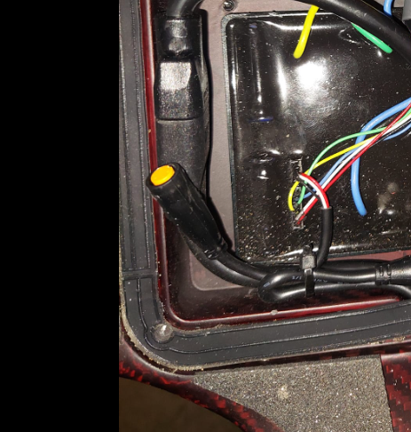

They changed it with the carbon super. Now the calibration is done through the remote settings. And the vesc is filled with silicone with no port. I’ve heard of people soldering connections to get into it but I’d rather just put a reliable controller in it.
I’d say if you don’t want the hassle to remove the silicone and potentially solder some wires just order a reliable dual controller and be done with it. Xenith, Stormcore, Trampa HD60 and MakerX are the best ones I can list from the top of my head. MakerX V4 and the HD60 are the smallest if you have space contraints.
For remotes, there are a lot of people who swear by the FlipSky VX1 Pro, but a Puck from Hoyt would be a top reliable choice too. Personally I use a Trampa Wand without issues so far, but there are some people out there who claim that it has “some” reliability issues (none that I can confirm though).
The VX2 you mentioned on the other hand is a complete crapshoot and I wouldn’t trust that thing at all. Every other day there pops up another thread or complaint about connection issues with those things. Absolute shitshow.
Eovan boards are really solid otherwise, and you will save a lot of money if you don’t start building from the ground up. Trust me, It only gets more expensive from here on out. :smiley:
This is the wire they use for plugging into the vesc. “XLR 3.0” that i cant find anywhere, might just solder a new plug
