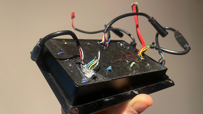

any way to salvage this heatsink from the potted esc? or is this entire thing trash
what are you trying to do with the board ?
throw a stormcore in there, wondering if i can reuse the heatsink
Where there is a will, there is a way. I believe @Arzamenable has successfully removed that potting compound before?
