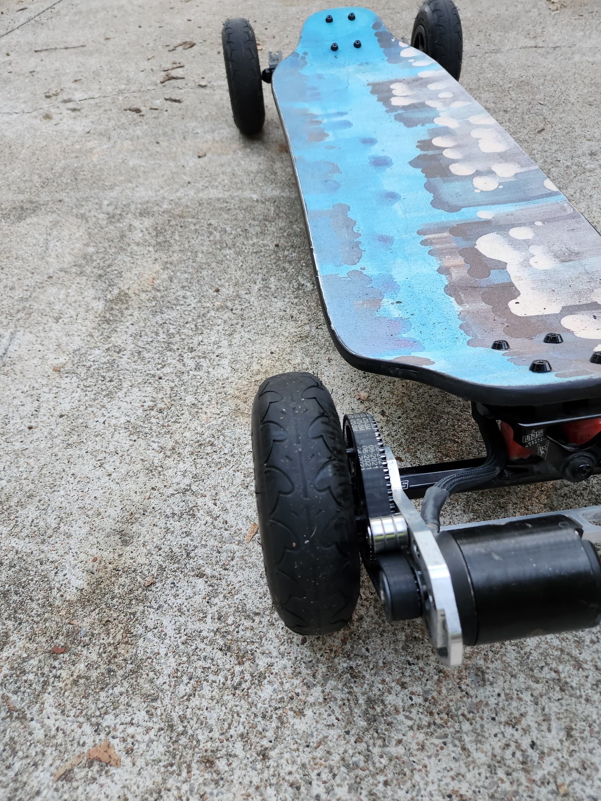

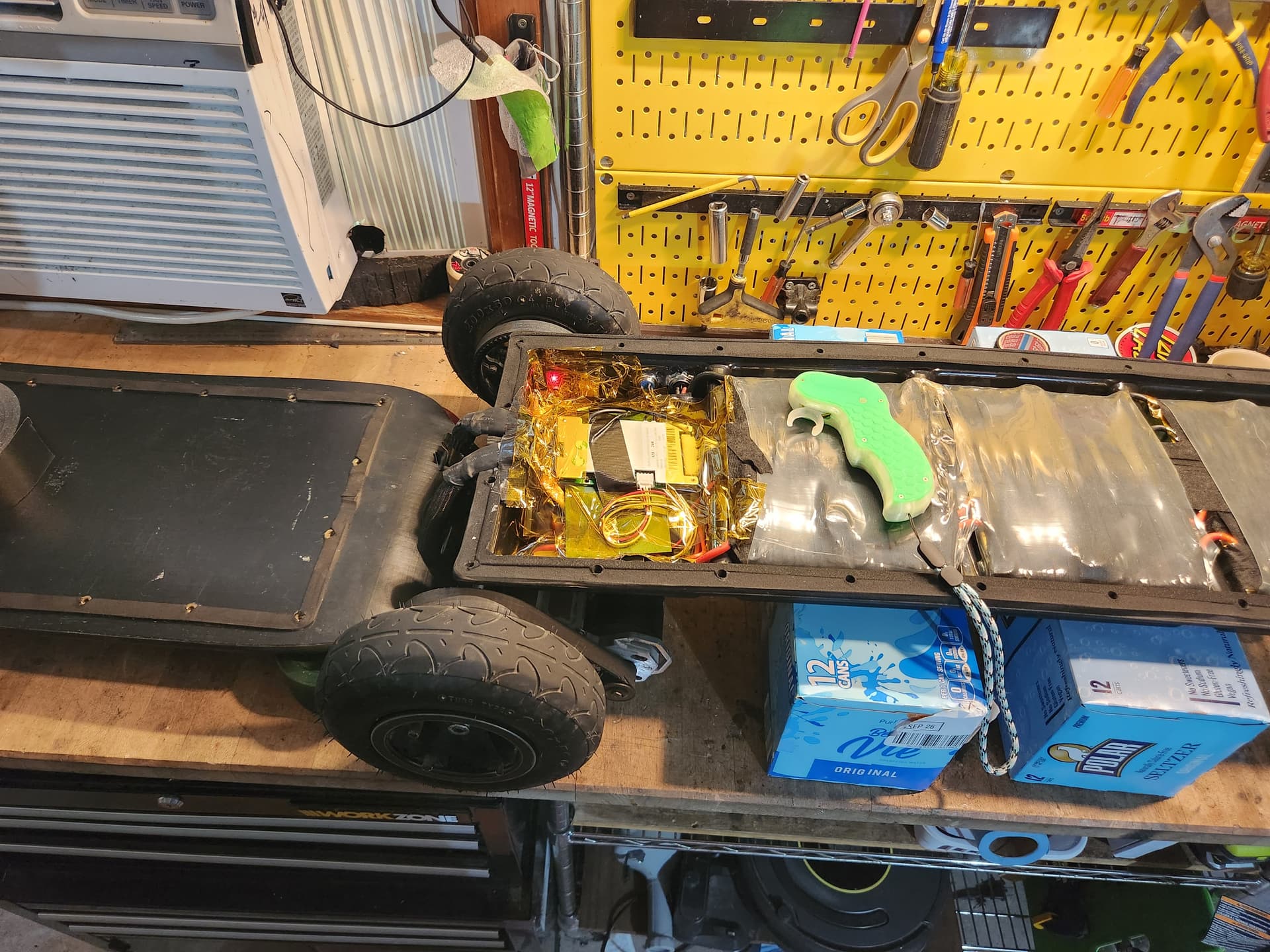

Last night in the process of messing with stuff I had unbolted the enclosure.
It did not move because I have butyl tape and foam gasket around it…
When I went in the garage this morning it had dropped and I thought that was funny…

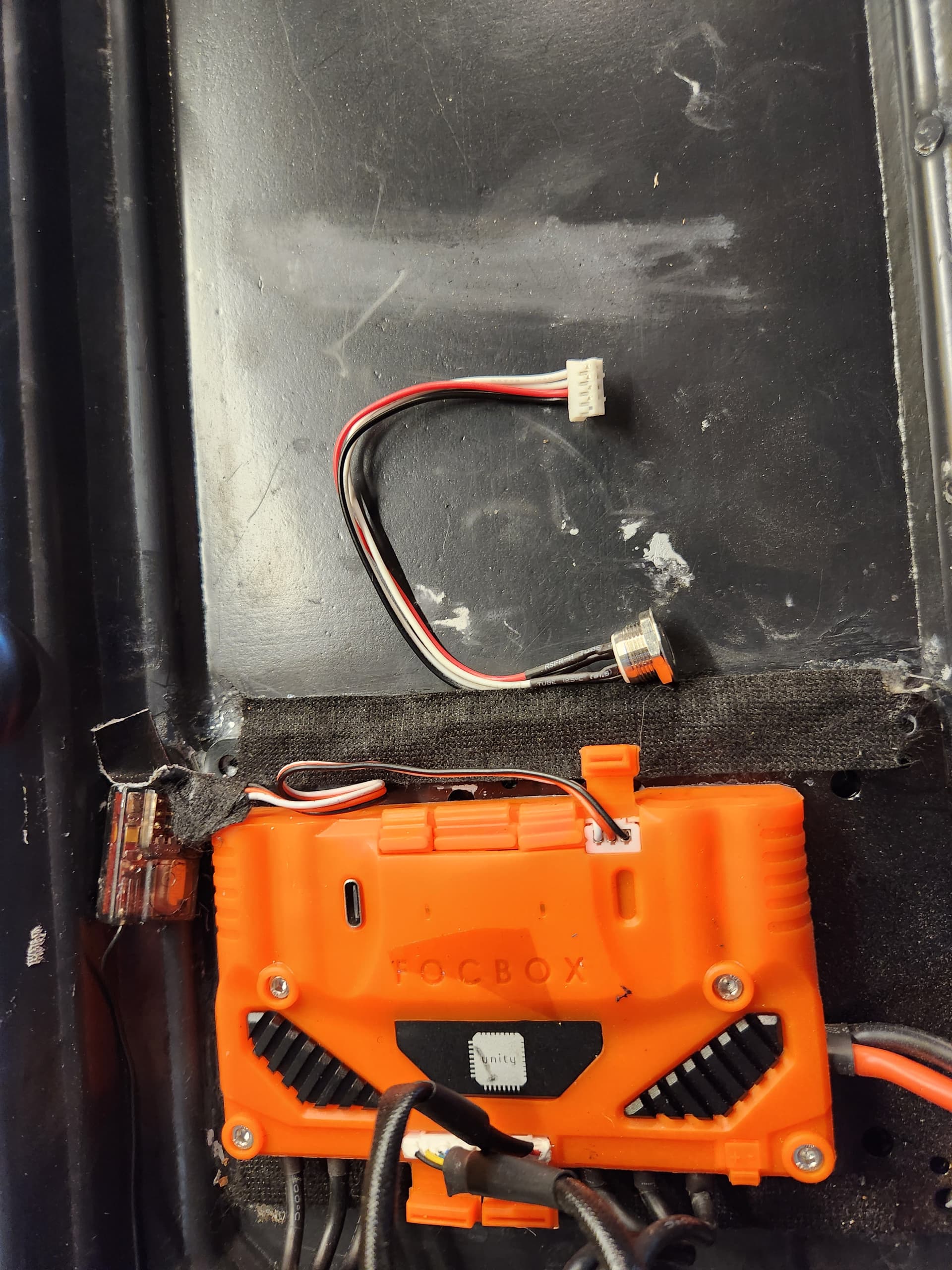

I decided to add a power button to the Khymera…
It seems like one of the hardest ones to roll to start…

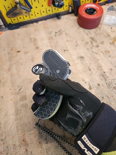

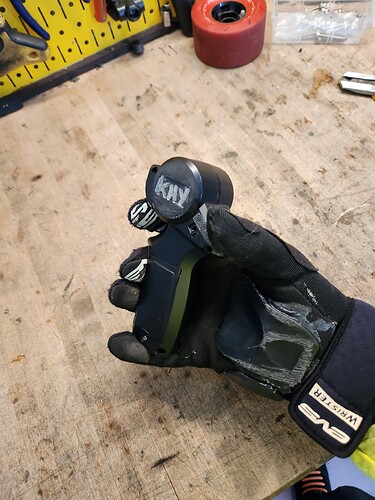

And finally I added the Z-mote receiver.
So the Khymera is back together and I am about to go ride it.
And to make sure I have more work to do Z-mote #2 showed up today.
Yey.
I went and did 11 miles on my lunch break.
And all was good.
The wheels ran well without any major vibration or wobbles.
So a great first impression.
And the remote was also good.
It felt super familiar.
Holding it is a bit different because I hold the mini in a weird way.
I used my long finger gloves to see how that would work since winter is coming and it was good.
So I am pretty sure I am sold on it.

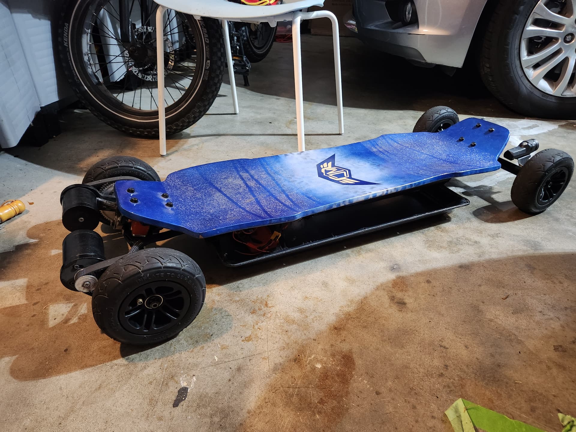

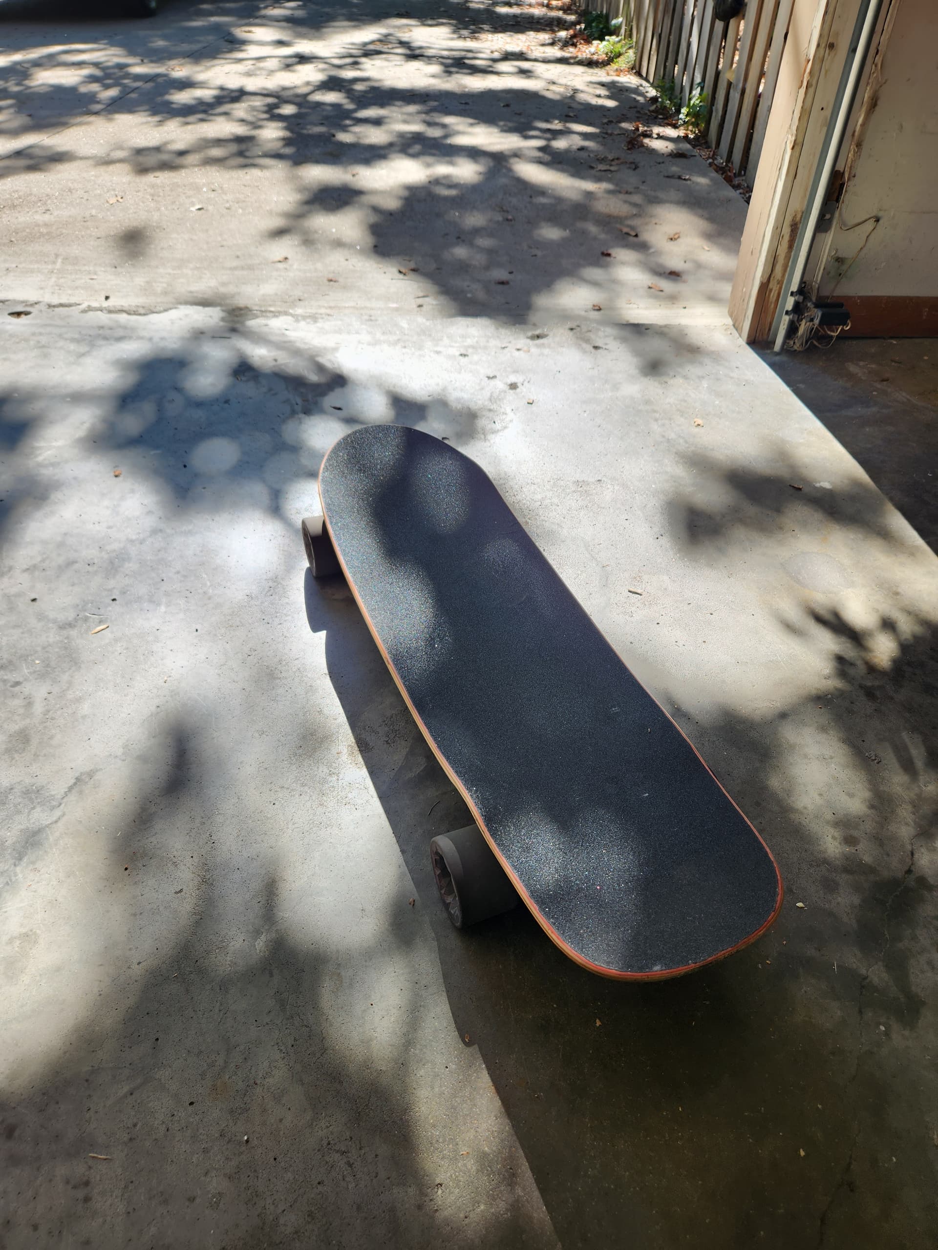

So this afternoon I broke out the Gravel Flux for school pick up.
20220928_151642_1
This is after fixing the BN drives the other day.
So let’s everyone hold hands and sing cumbaya and hope they stay together.
They sound good to me. And lke always, they feel great.

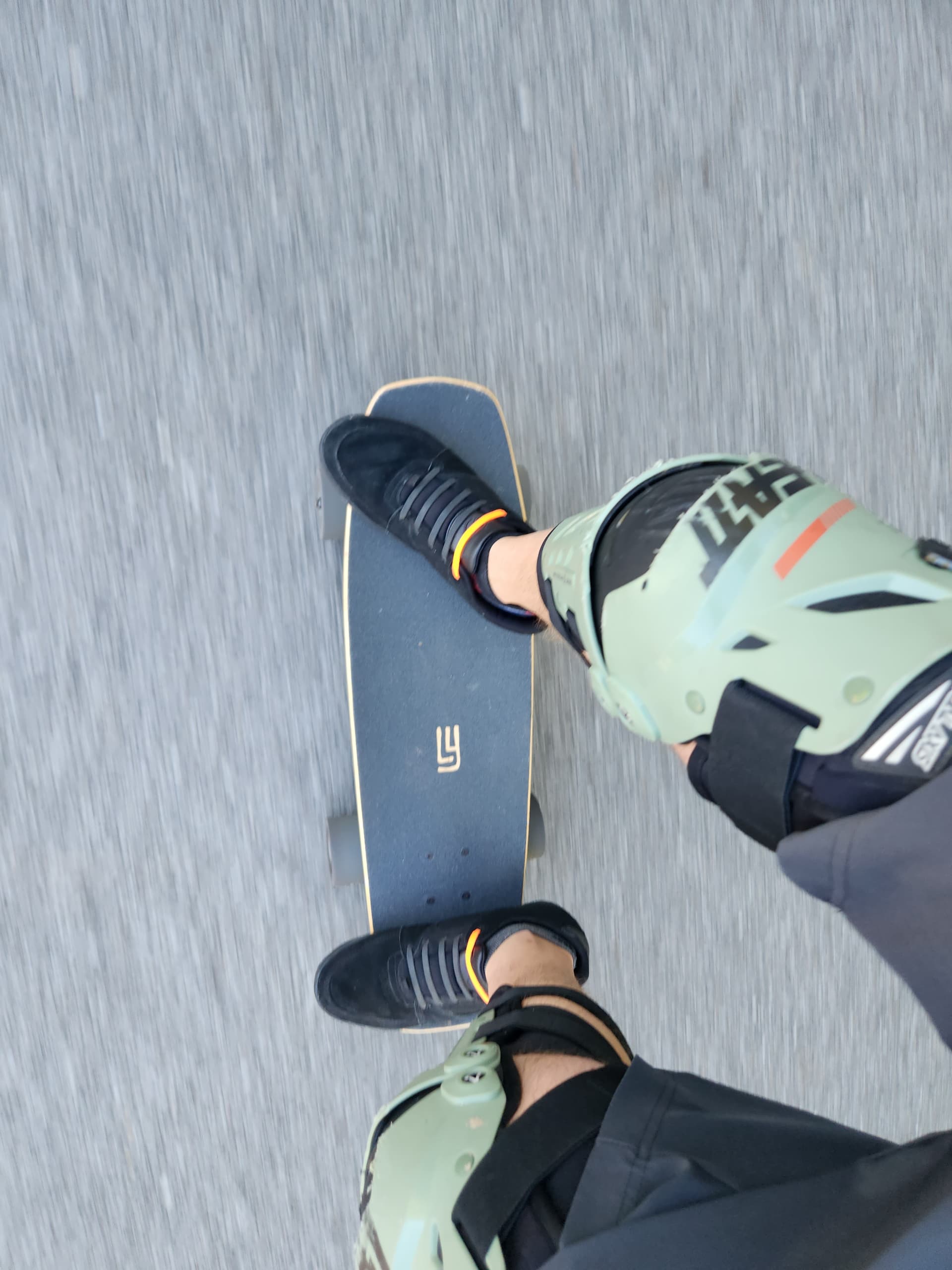

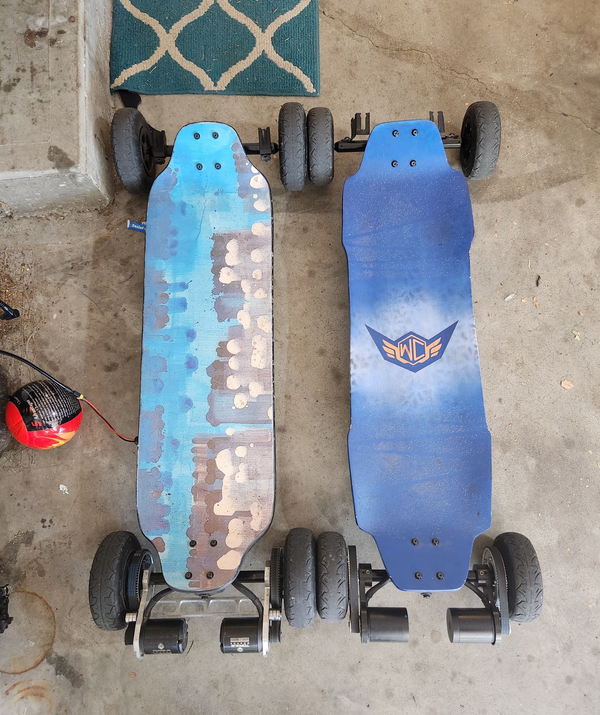

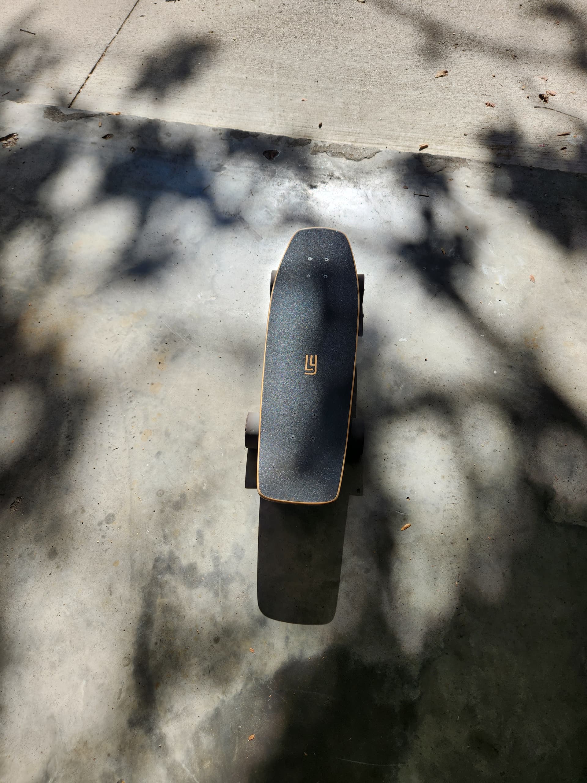

After getting home I rode up the block a tiny bit on the Dinghy and then the Rally Cat.
And boy.
Those are two very different boards…
Also funny to go from the giant ass Flux to the tiny ass Dinghy…

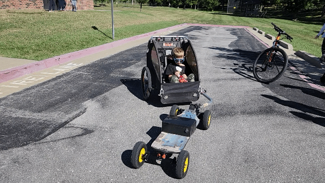

After work I was alone with the little dude and I wanted to get take out.
And I pondered driving. But then I realized I could ride.
So I get the Gravel Flux out and put him in the trailer
And I go up the block and remember to check my battery…
And I was at 43 volts…
So I made a U-turn.
And we went on 2 wheels like a normie…
It works. And it was a fun ride. And we enjoyed the super nice evening.

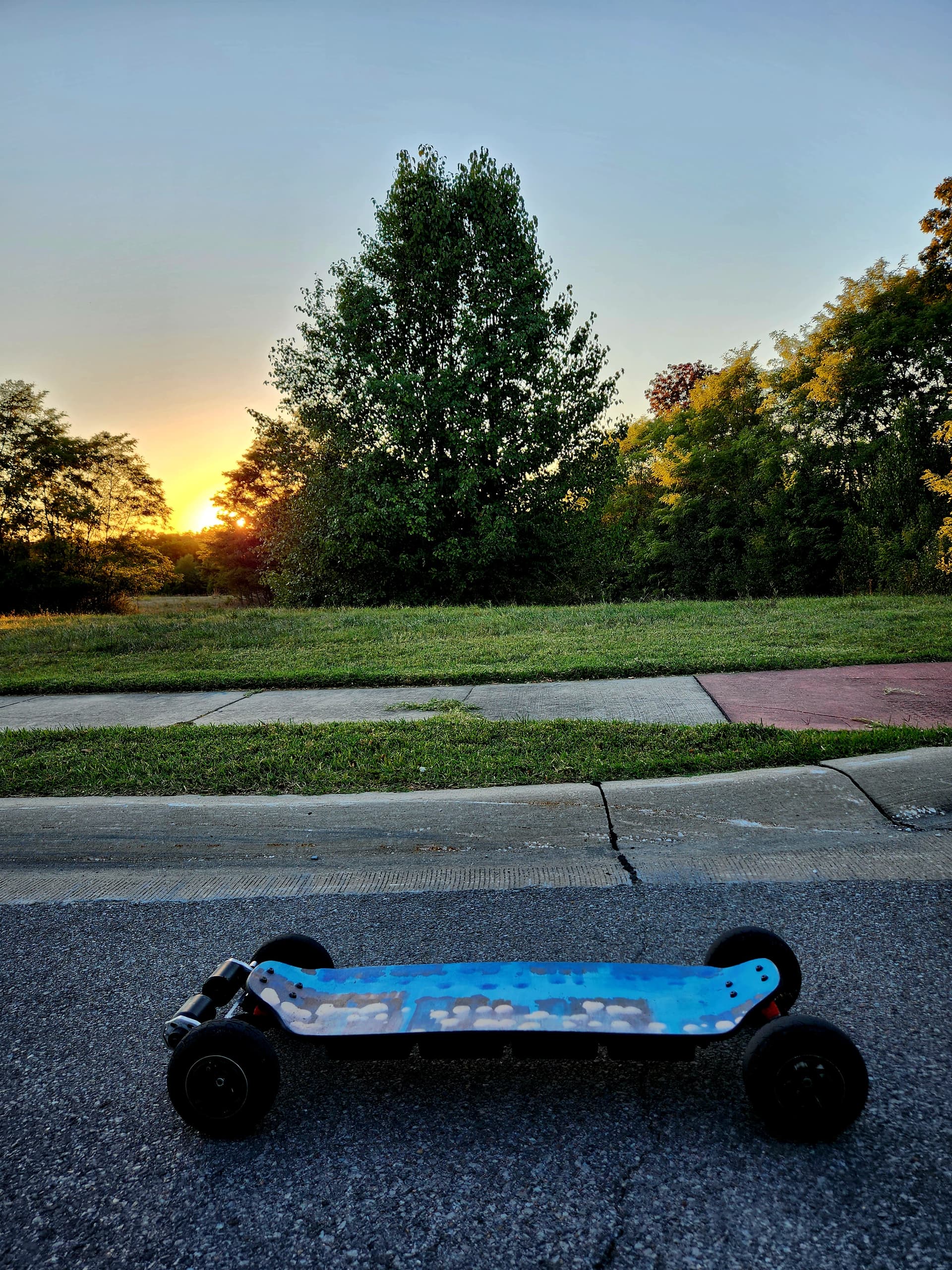

Another 12 miles on the Khymera.
And all was good.
Sweet.

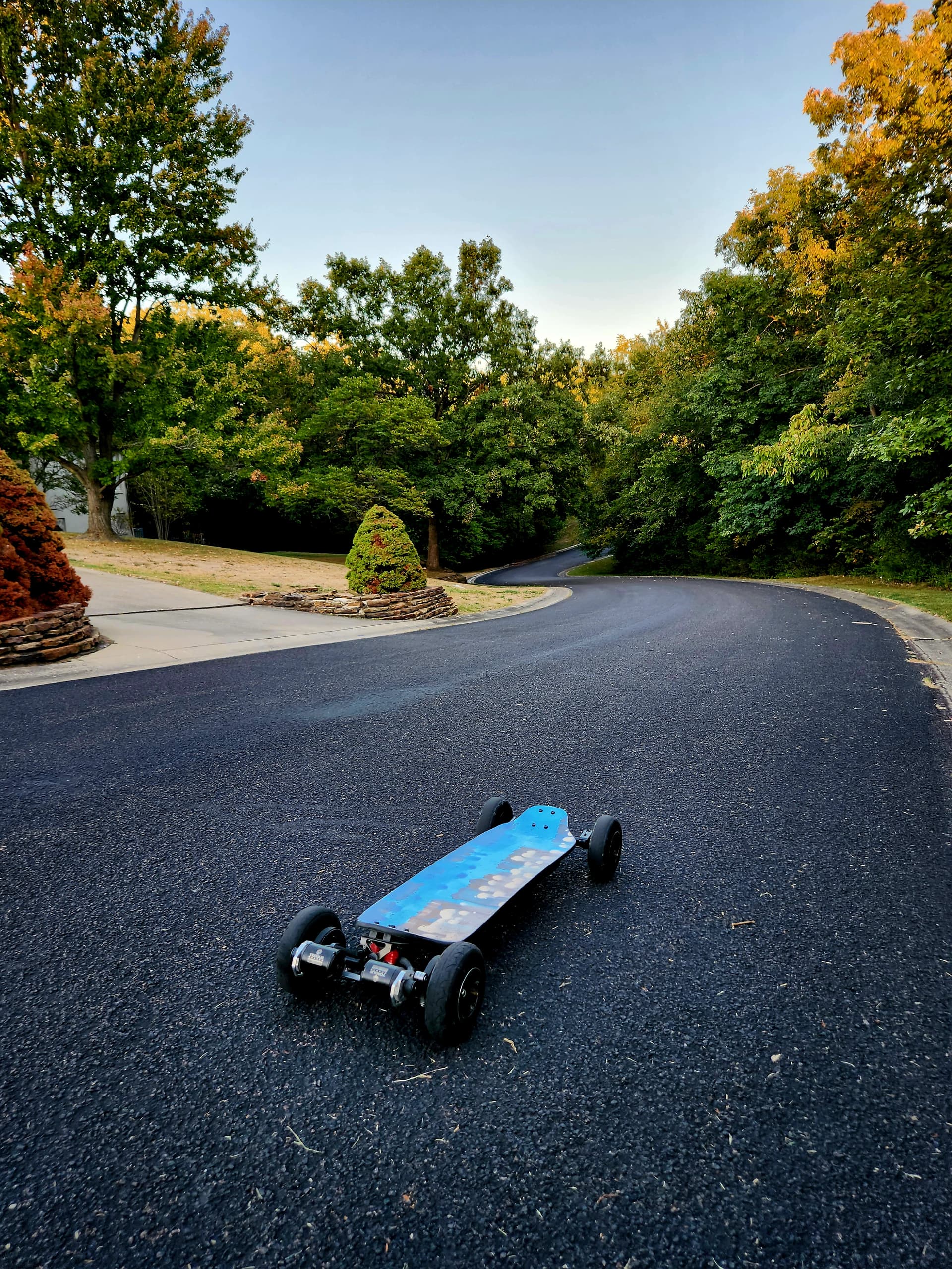

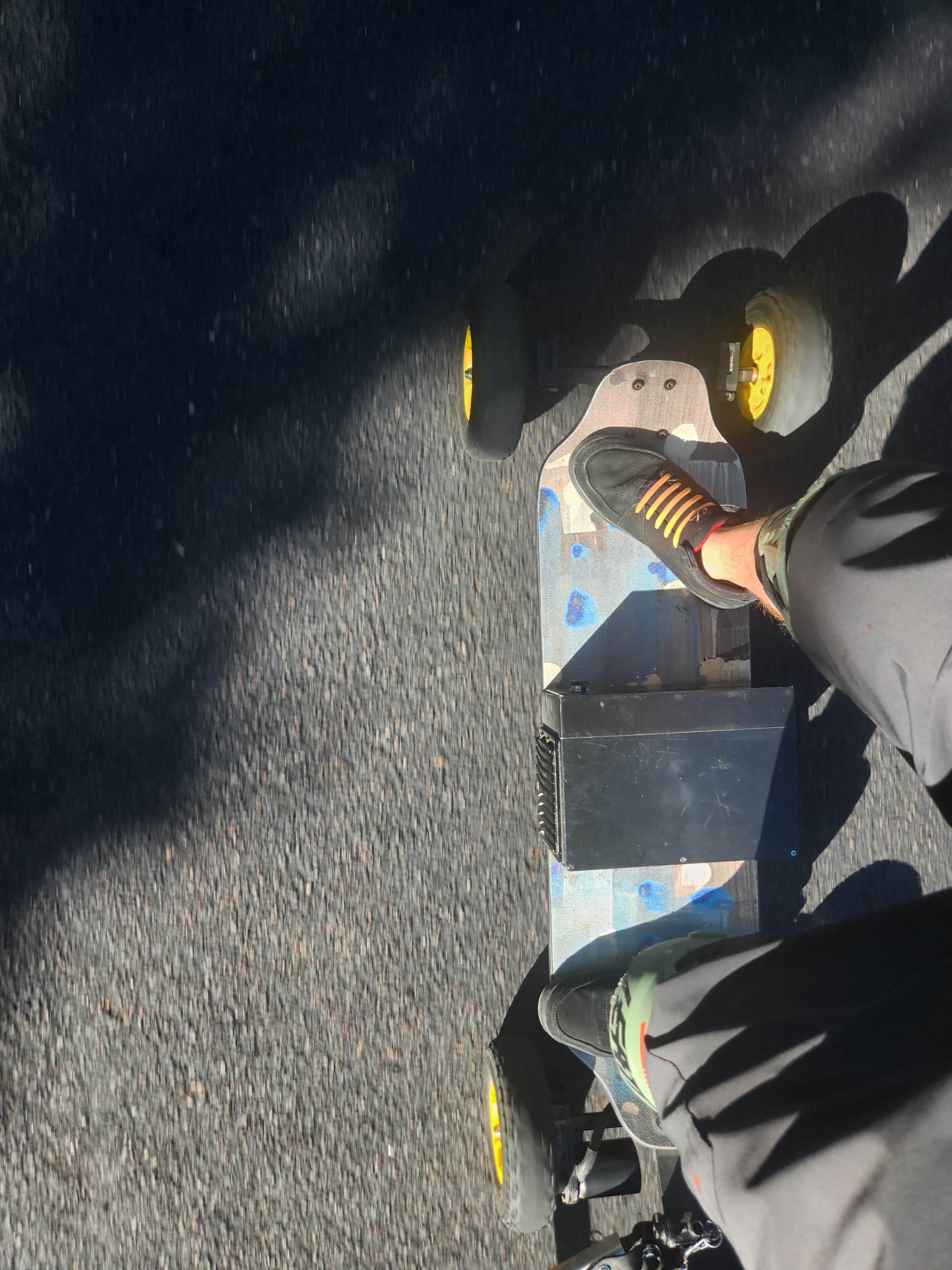

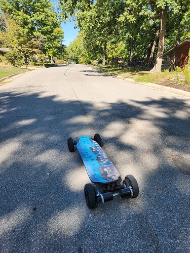

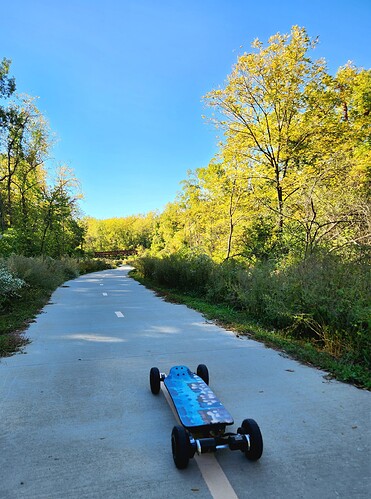

I took the Gravel Flux out for 9 miles this morning and it was all good.
First morning ride with my neighbor Benji I think.
65 and sunny. So yeah.
The BN drive held up though this Ride.
So let’s keep our fingers crossed.

What are the gear ratio, Kv, wheel diameter on:
  • the easiest to roll start
  • the hardest to roll start
:question:
So,
these are both on Unities.
The Gravel Flux seems really easy.
I just pick up the side and give a back wheel a good spin.
it is 4.8-1 - 140kV on 225 mm
The Khymera seemed to be the hardest.
it is 18/72(4-1) - 190kV on 175 mm

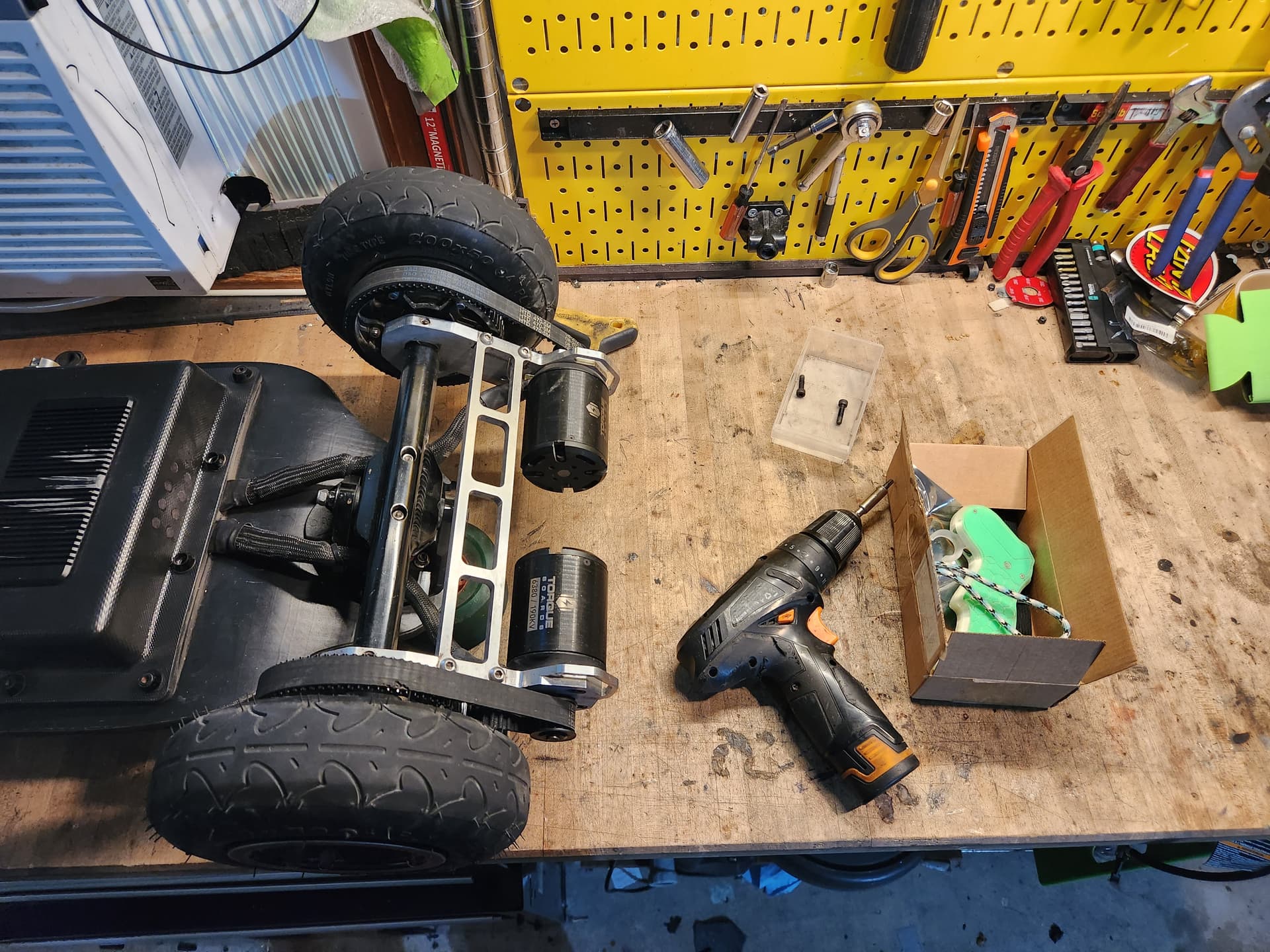

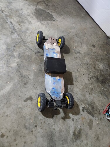

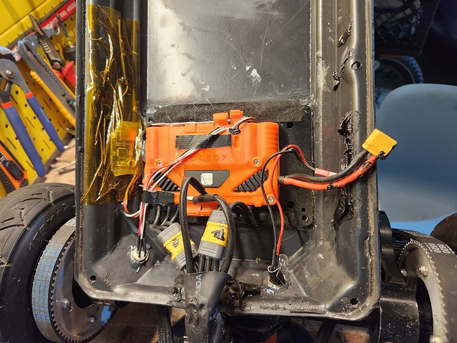

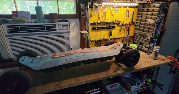

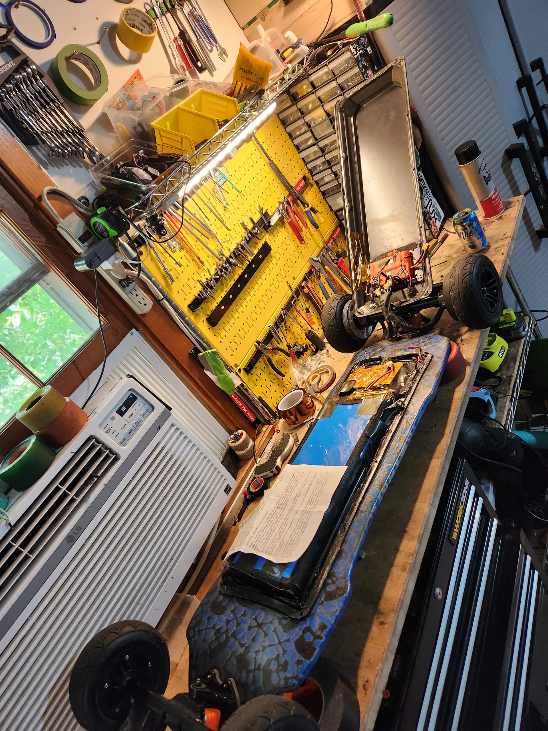

On the bench tonight is the Flux.
I’m going from 16/72 to 15/72…
Guessing from about 40 to 37…
I used to run 14/72… So.
Maybe the 15 is the spot.
Sometimes I wish it punched more…
I can always go back.

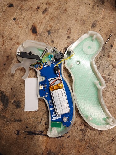

The more grandiose part of tonights plan is to install the Z-mote receiver.
But that may get pushed to later…
We will see.
Welp.
I made decent headway last night.
I did. Not get the remote installed. But I did go to bed before 1. So I feel like I did the right thing.

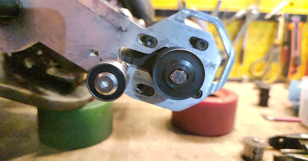

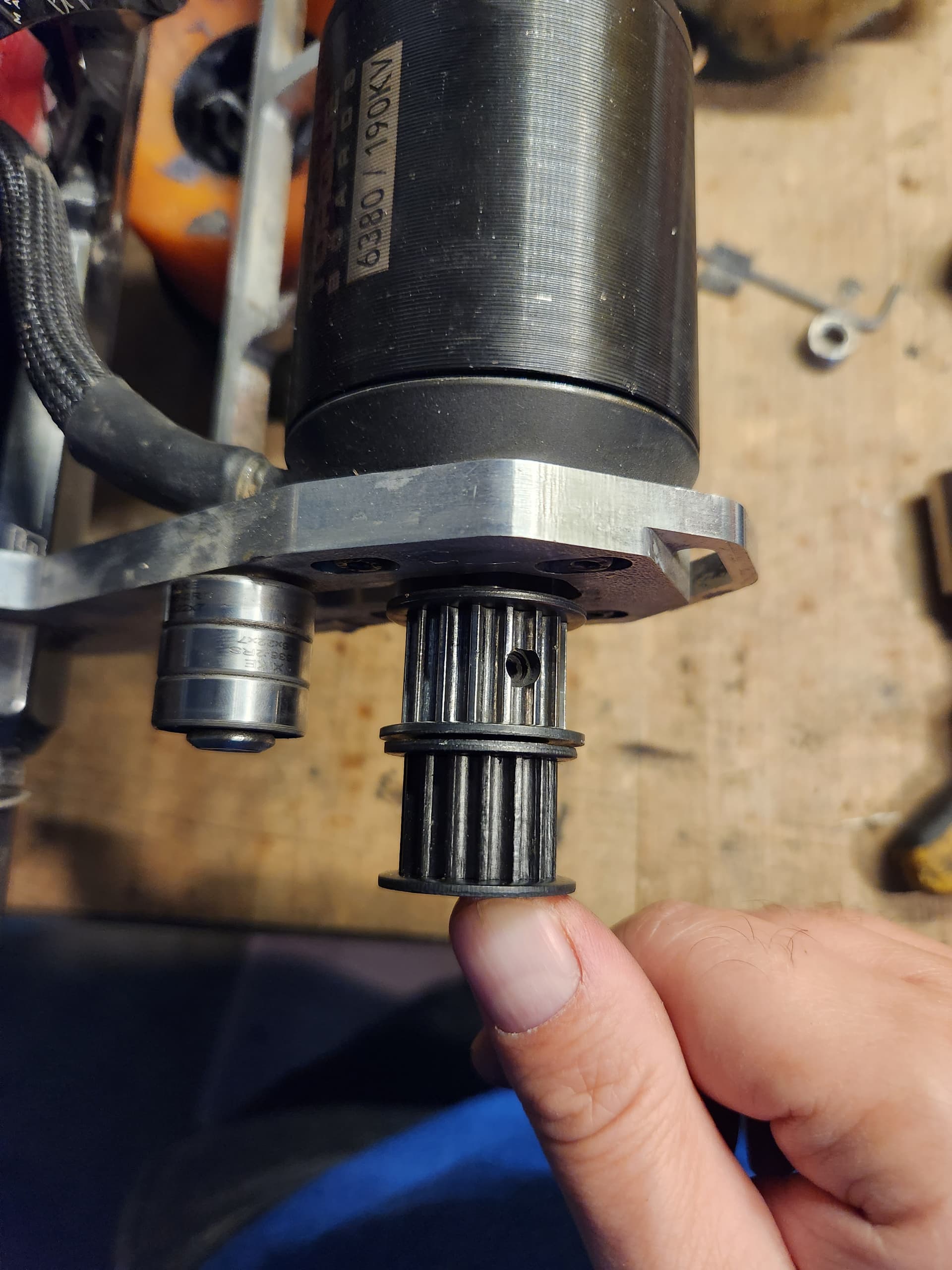

I got the 15tooth pulleys on.
It was mostly straight forward…
I have had some real epic battles with pulleys in my days.
But on the Flux they are set up far enough away from the motor mounts that I can get the gear puller in there no problem.
So getting them off and new ones on was easy.
However on wheel #2 something seemed funny when I was doing the belt tension.
And this is a new one for me.
I had a pulley that was way off center…
Here is the good one.
Here is the bad one…
–It’s always something–
But no biggie…

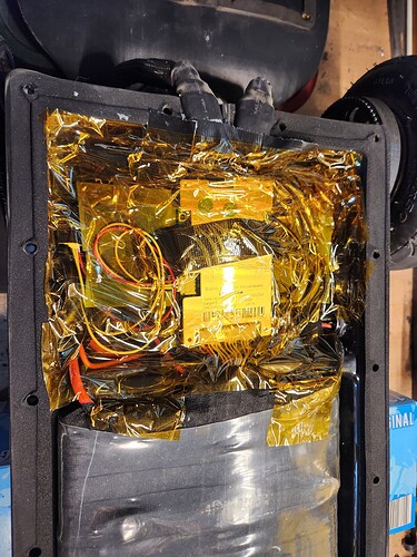

I also got the battery installed In the Z-mote #2 so I just need to get the receiver installed now…
Will go do that here in a second.

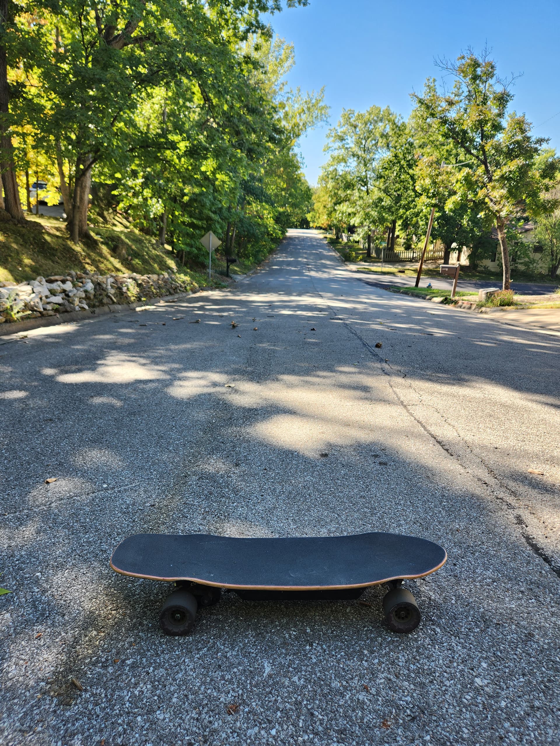

But ok, I put the Z-mote receiver in the same spot the Mini used to be.
Taped it all back.
And the Flux is back to life.
I went and took it out around the neighborhood for an 8 miler.
And it felt pretty pretty solid.
The remote once again just worked.
I don’t know if it is possible to change remotes and have a more seamless experience than what I am feeling with my mini’s and the Z-mote.
But I am at a total of 31 miles between the two remotes.

I think I may have had another bad pulley…
Not sure till tomorrow.
I took the pulley out.
And put a used one on that I think is ok.
I am letting the loctite sit. So I have not tried it yet.

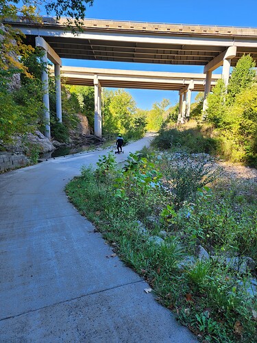

So I had a new record ride today.
35 miles in one go on the Flux.
Previous was 31miles on my old Flux pack .
Turns out that is about all I will get out of my 12s9p

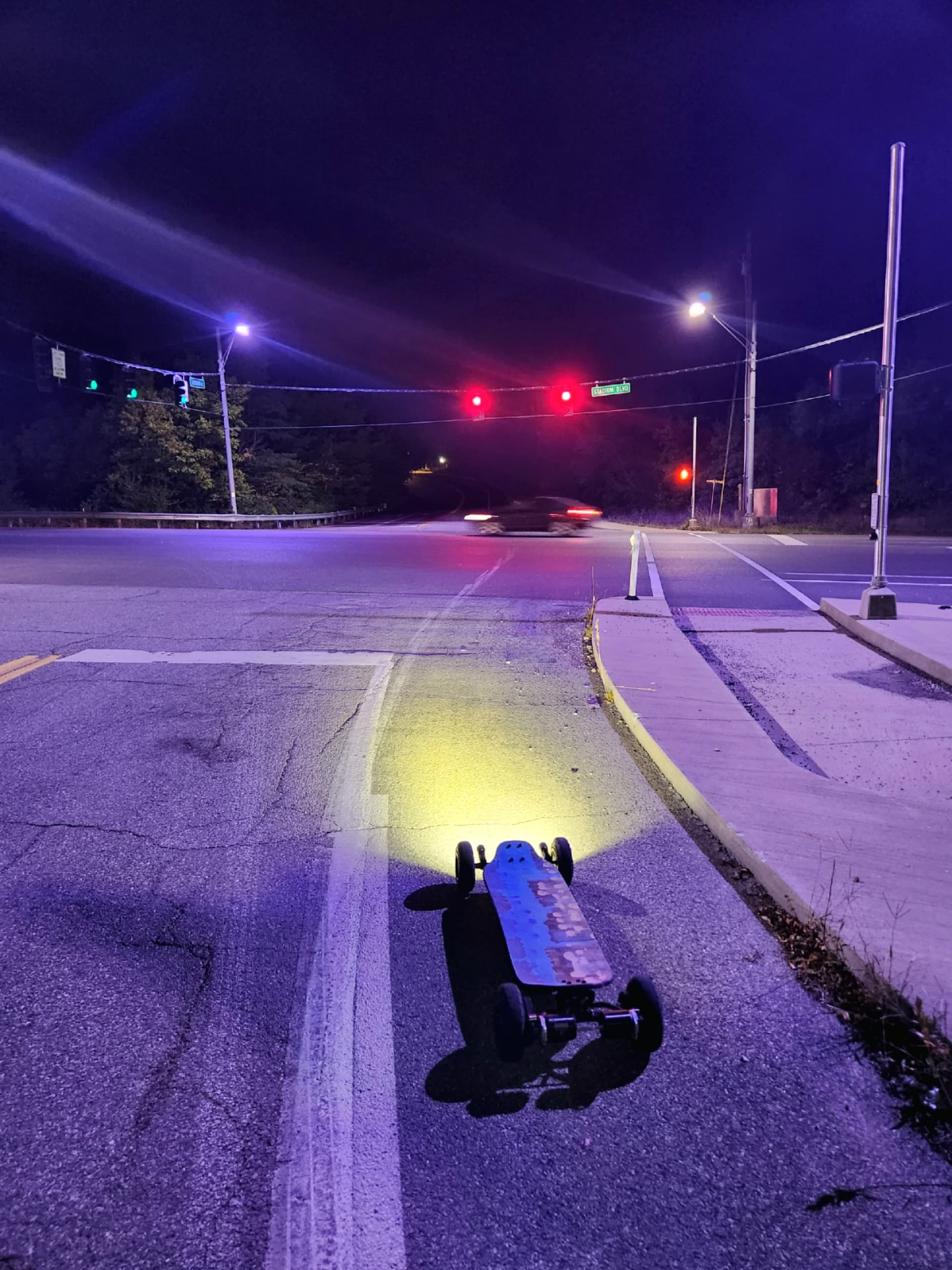

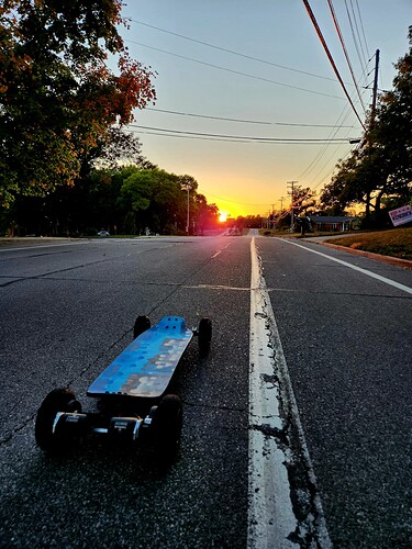

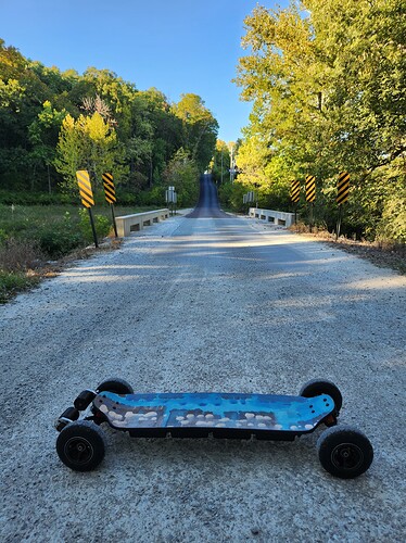

I went and did a 20 mile night ride on the Flux.
Benji rode for about 10 miles.
The Flux ran really well.
Ended up at 45.9 volts
It’s nice to go that far and not catch a whiff of battery sag…
So with that ride I’m at over 50 miles today!!!
