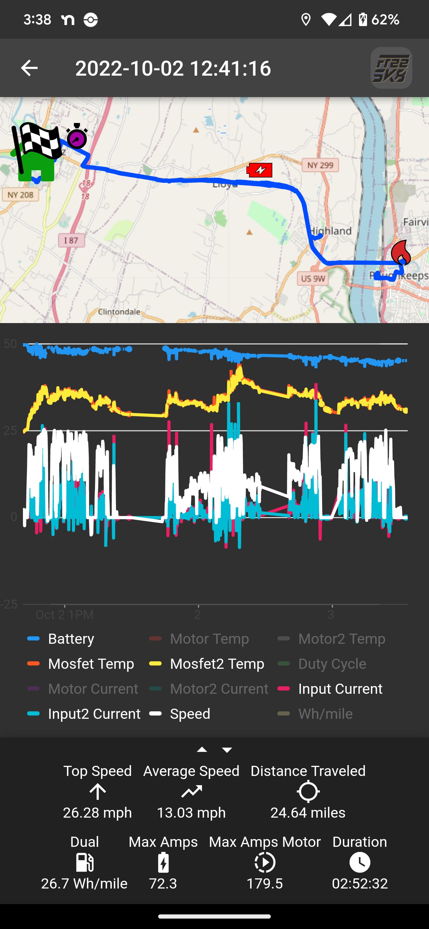

How fast do you ride? Here’s a ride log of my 12s8p tm3 cell (super similar cell performance to the BAK cells)
Ended right around 50% battery

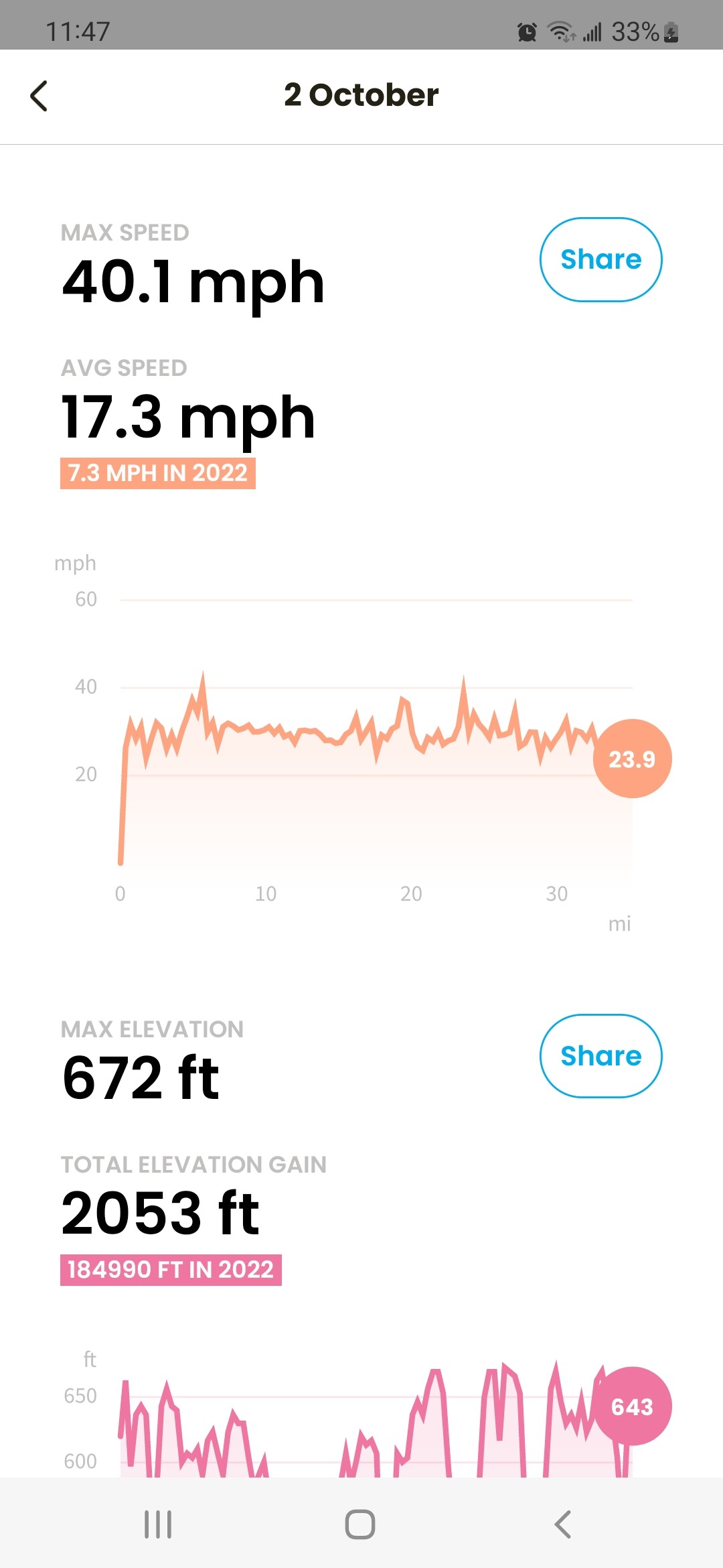

I am running 23.64 so I can;t even get accurate WH/Mile. but that 27 you show there is dreamy to me.
I think when I did have that info, I was usually in the low 40s.
Best I can do is the relive data… Which is yoi know whatever…
I sure did not hit 40 miles…

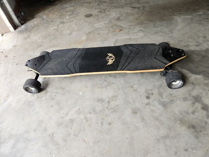

So for my lunch break I took out the Llama.
And it feels like it has really been a minute since I last rode it.
Last time I went to take it out it was also a lunch break and the power switch on the Mini remote had crapped out and I did not get out on it.
That may have been the drop that started rbr the Z-mote craze…
I also keep meaning to try the MAD wheels on the Llama and it is odd how time passes and other stuff comes up.
But the fact is that I really look more to the street carvers when I think about riding.
There is definitely a more dangerous vibe going with the thane boards. Especially this one since it’s actually fast and powerful.
I definitely don’t want to ride thane at night time anymore.
But today was great.
I did 16.3 miles. Which is about all I can get out of this 12s4p 40T Pack. Ended up at 41.5 volts. I was only at 49.5 starting…
While chasing freshies in my favorite neighborhood I found a tiny block of super fresh freshies.
And the 110s really shine in all their glory.
I am charging it back up so maybe it gets another go later with the MAD wheels on.

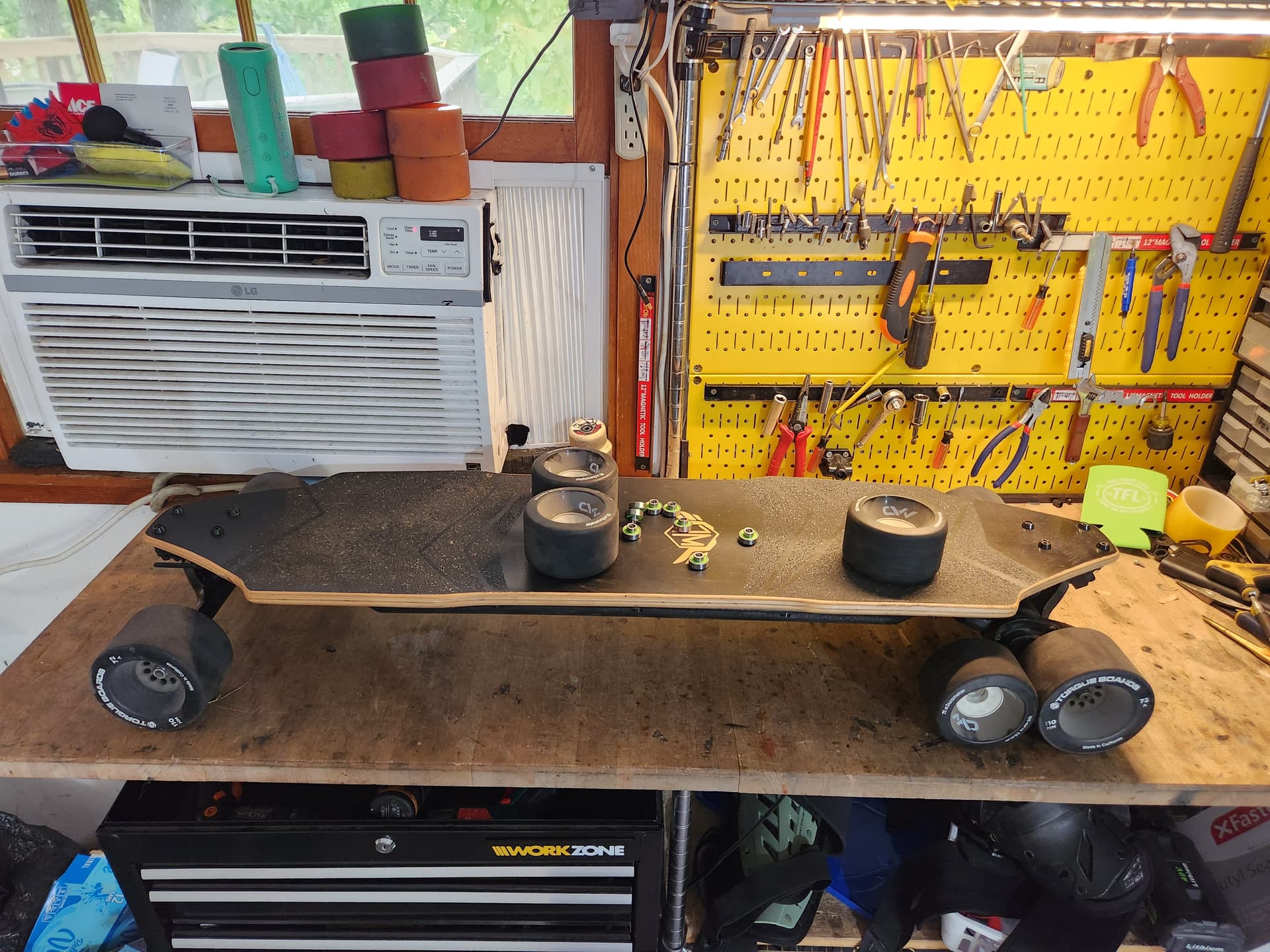

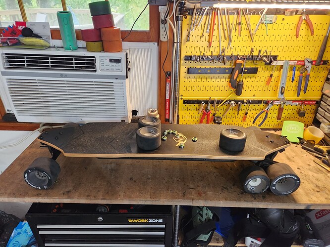

I can go ahead and say the TB 110s are going on the shelf.
And the MAD 101s will be staying on the Llama.
I did 11 miles around the neighborhood on my lunch break.
I didn’t venture far because rain was coming and it did cut my ride short.
I am not saying the MAD wheels are better than the 110s.
That is too hard to say.
They both shine in ways, and are certainly quite different in my opinion.
But for the Llama the MADs were the winner…
I might glide around on the 110s here and there, since it’s super easy to change the wheels with the BN drives.
But for now it’s MADness time.
The board ends up a bit lighter.
The board ends up a bit lower.
I am getting more torque so now it’s super punchy.
Got lucky there, since it’s not easy to change gearing with the BN drives…
The MADs also do way better on the old chip and seal. Which I have around my neighborhood and all around town.
It’s a non issue with pneumatics. But it’s tricky on thane.
the MADs do a great job on it both as far as grip and dampening.
On freshies I do notice the harmonics still.
It is just something that is there and it is different and it is not really an issue.
And at speed it goes away.
And on the Llama they felt really smooth and connected on the freshies.

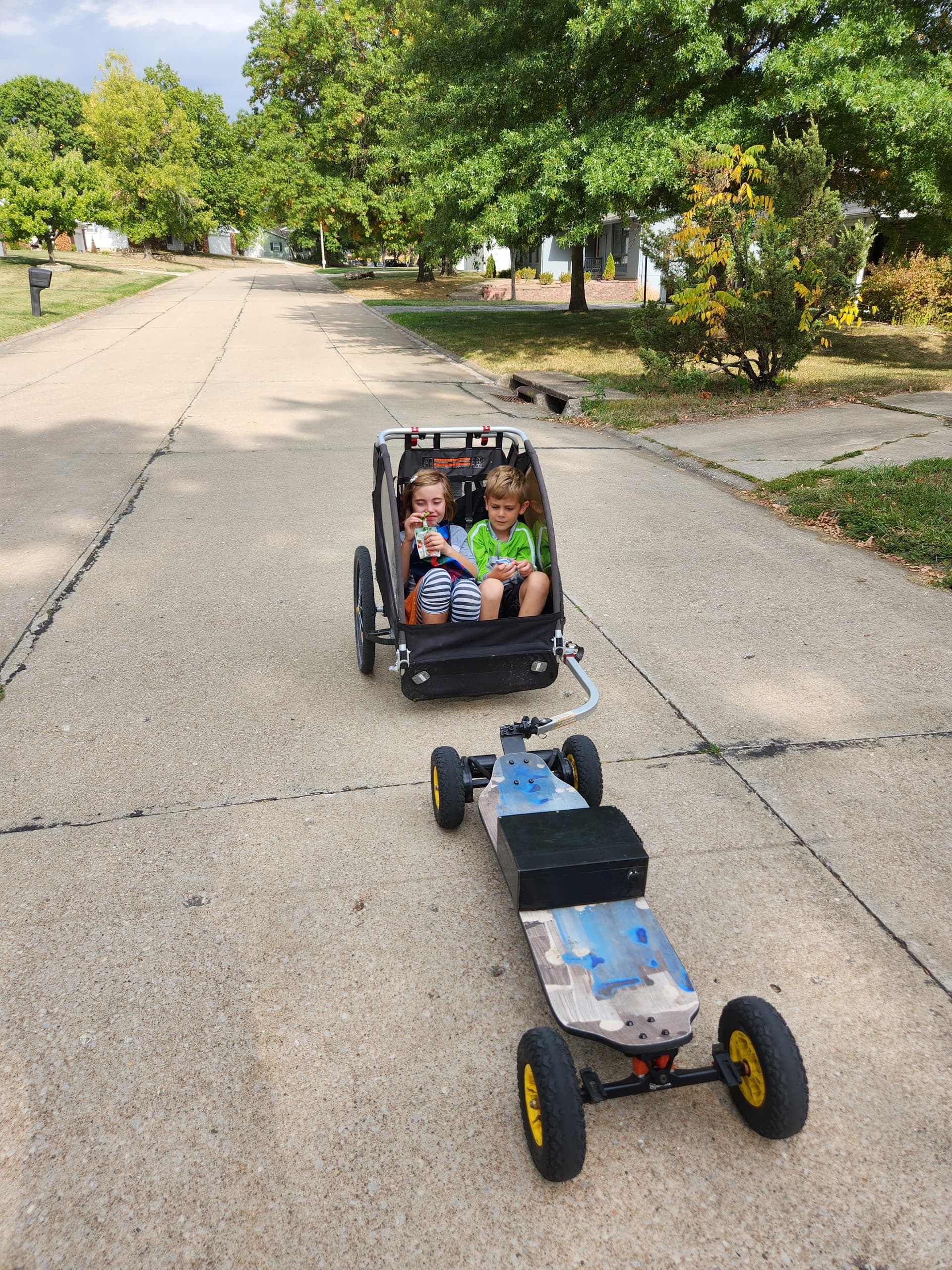

So I decided to take the Gravel Flux to tow the trailer to go get take out.
The place is 1.7 miles away and a 5 minute drive.
The trip all together took 1:15 and I wandered for 9.5 miles.
Fall colors are popping.
The little dude was really engaged on this ride sitting up feeling it the whole time.
We went to pick up Italian.
And took up a whole parking space.
Little dude brought his tiny skateboard to ride around and “do tricks”
It sprinkled on the way back and with the gravel Flux that is a non issue.
