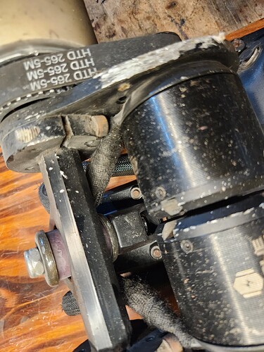

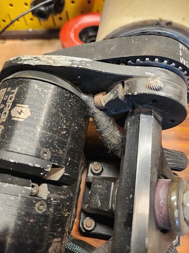

Looks like not having a wire sheath and heat shrink there gives you a bit more space…
I ground my truck clamps some…but it is still super tight…
I feel like it’s gonna wear through the silicone and short, so I’ve been watching it pretty carefully.
I would at least wrap some tesa tape on there.
That is what I put on the Omakase
And after watching the video of the clicking I got annoyed so I am back on the bench.
And new theory.
I don’t think it’s the hub…
It is clicking without it being there.
So maybe a bearing on the drive?
That’s probably a good idea actually. It would be nicer if the clamps were sloped down there to accommodate this. Iirc someone else did that for theirs.

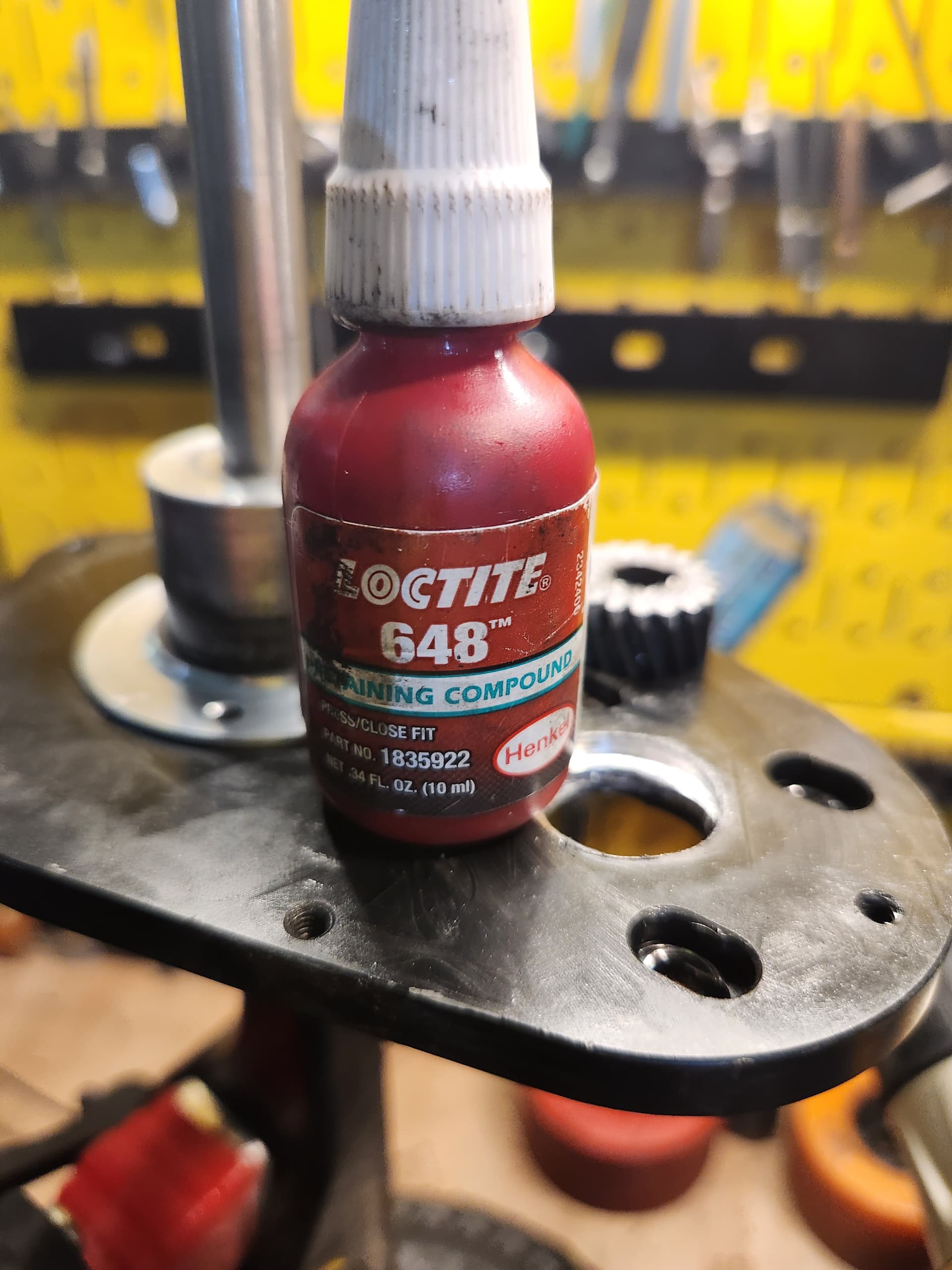

Do you remember if and what color loctite you used when you installed these originally?
Oh but off course.
I used the recommended green 648.
Because you know.
I was told bad shit could happen if the pinion comes loose…
Lol.
:smile: indeed, but seems not THAT bad. You do ride a lot and I think this is a product of the micro vibrations that exist in all gear drives but are much amplified in drives with steel on steel gears. MOAR LOCTITE! :ocean:
Check that big bearing in the gear box cover, it’s possible some shavings made their way in there and that’s what could be causing the clicking

When my motor pinion got loose it fucked up both the motor bearing and that housing bearing. I had to replace half of my drivetrain, but for a year of maintenance its not the end of the world
