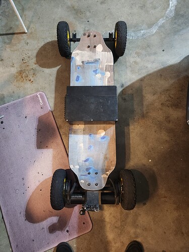

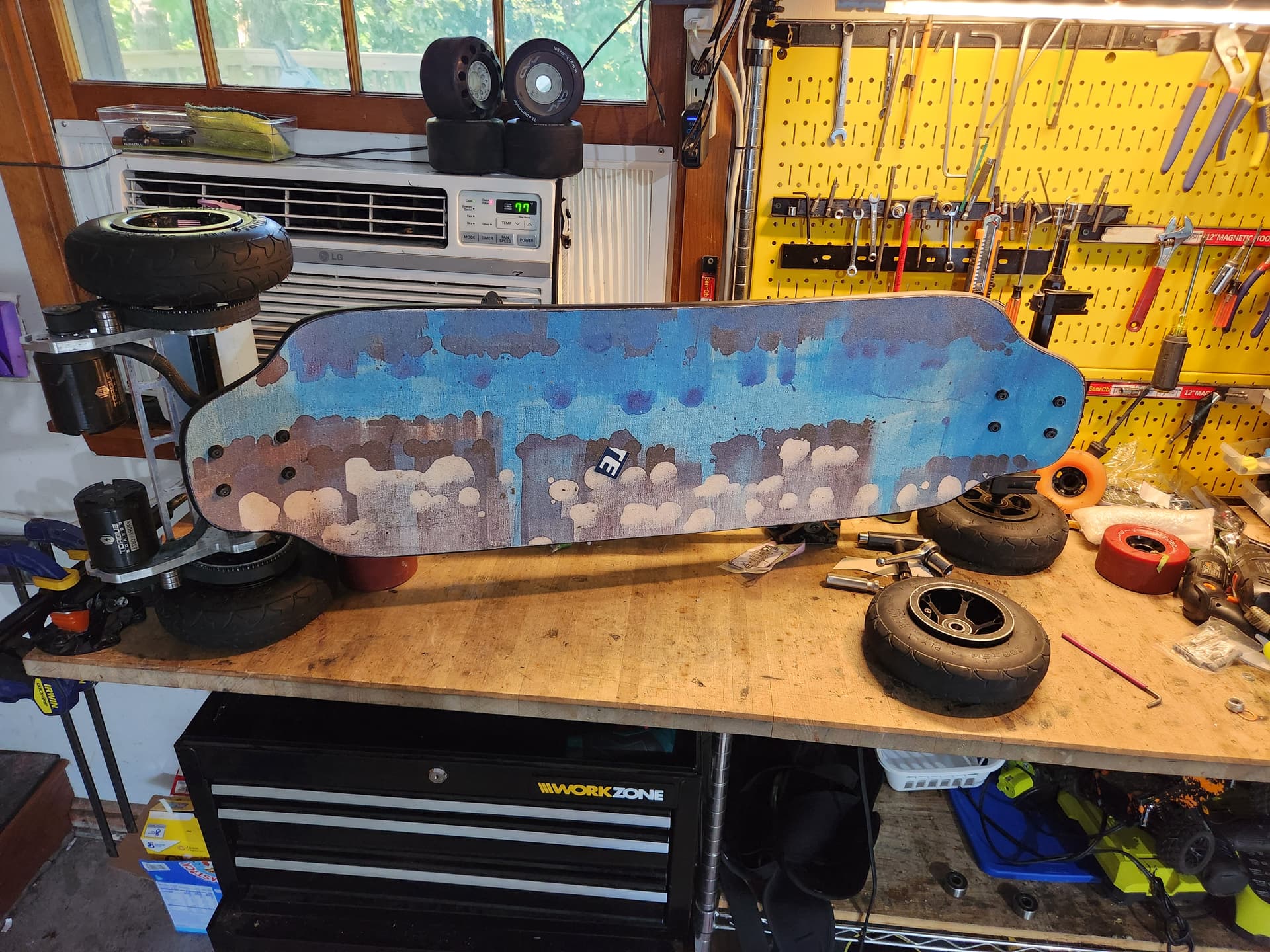

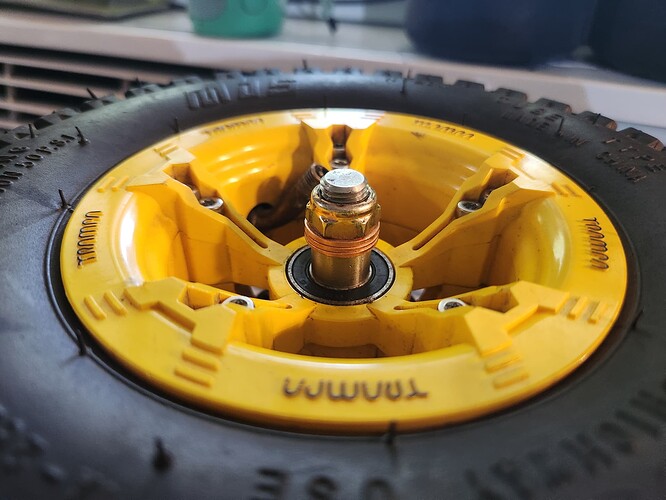

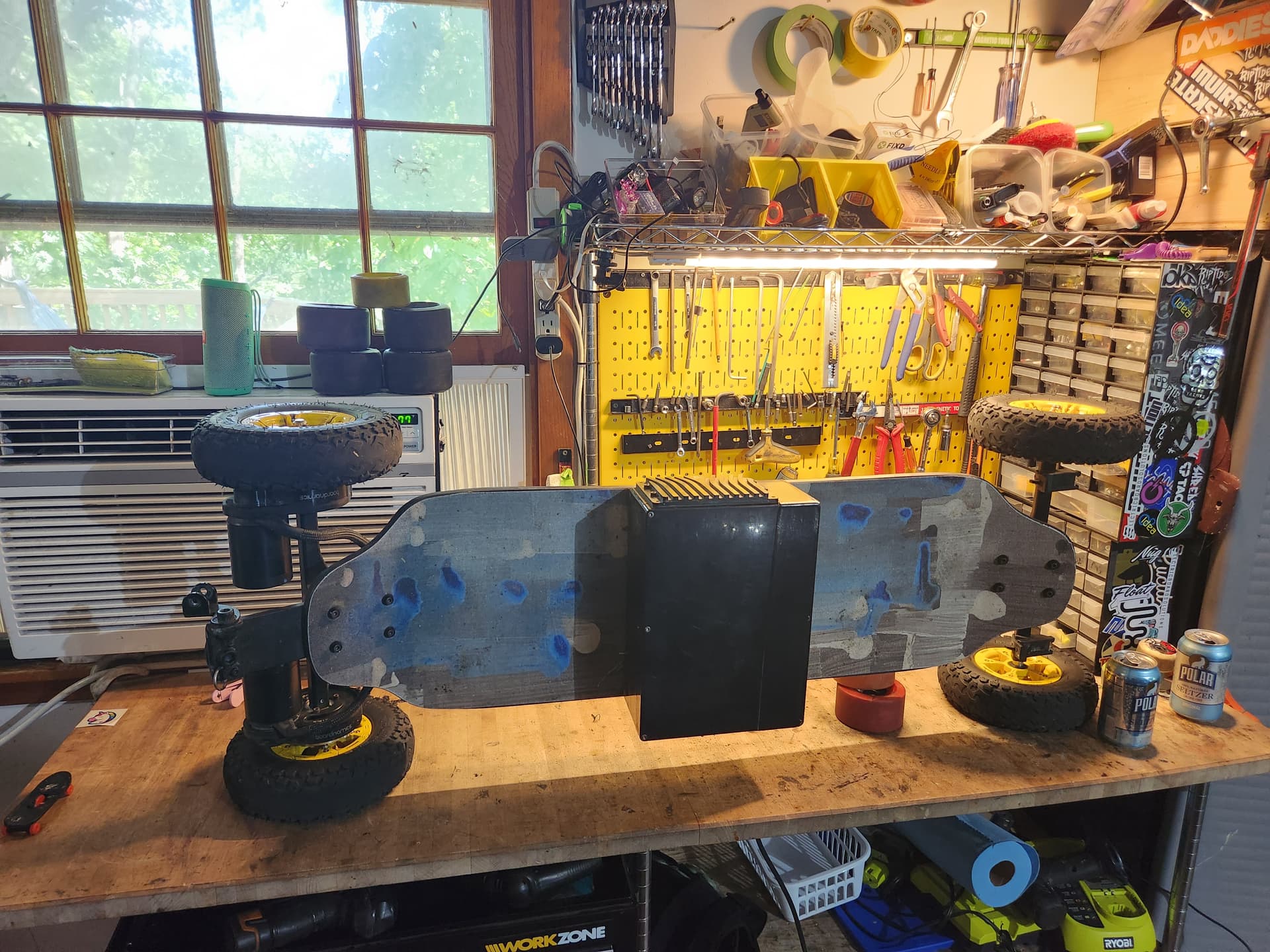

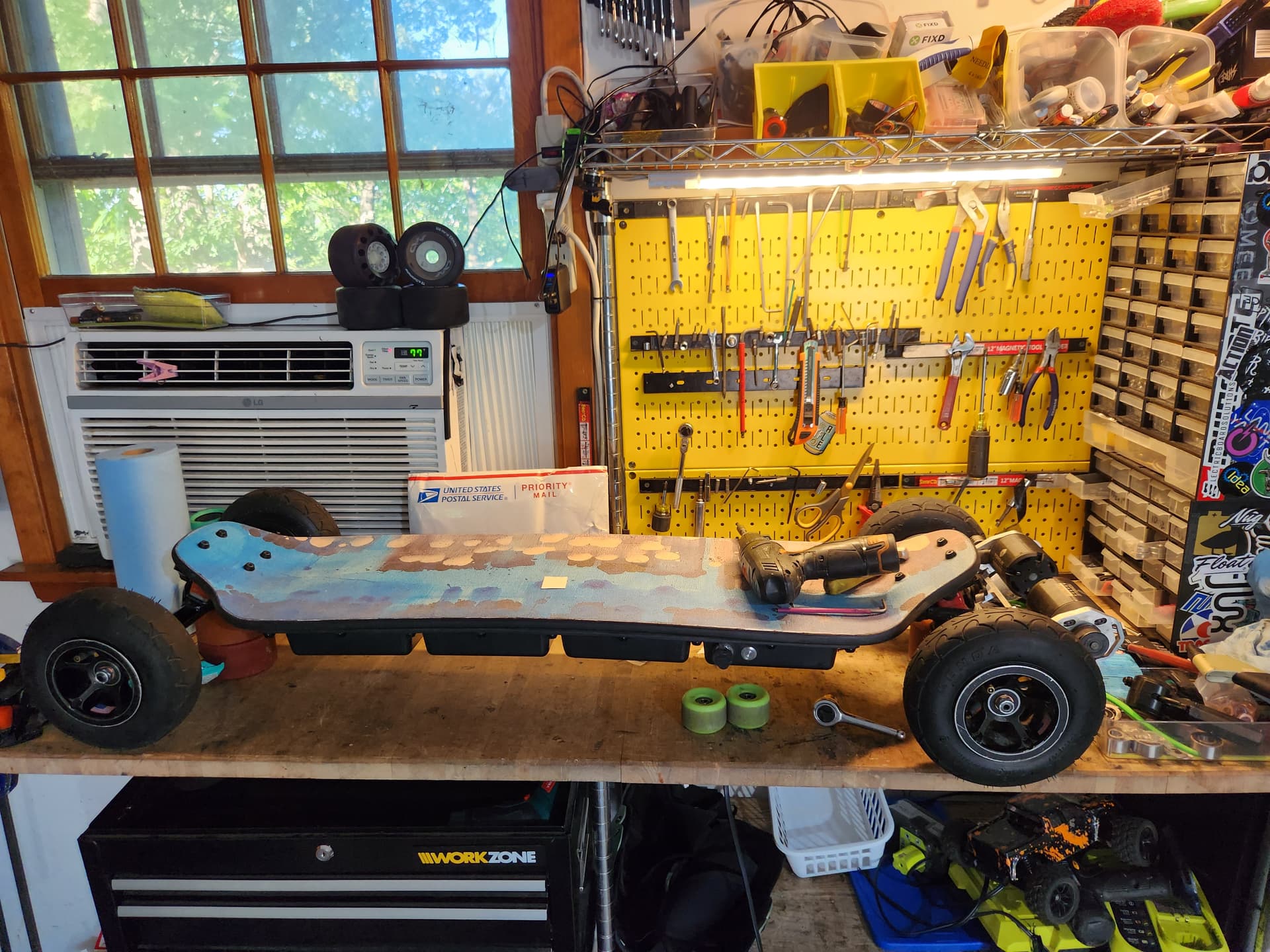

I got the Flux on the bench and will tinker a bit instead.
So. Yep.

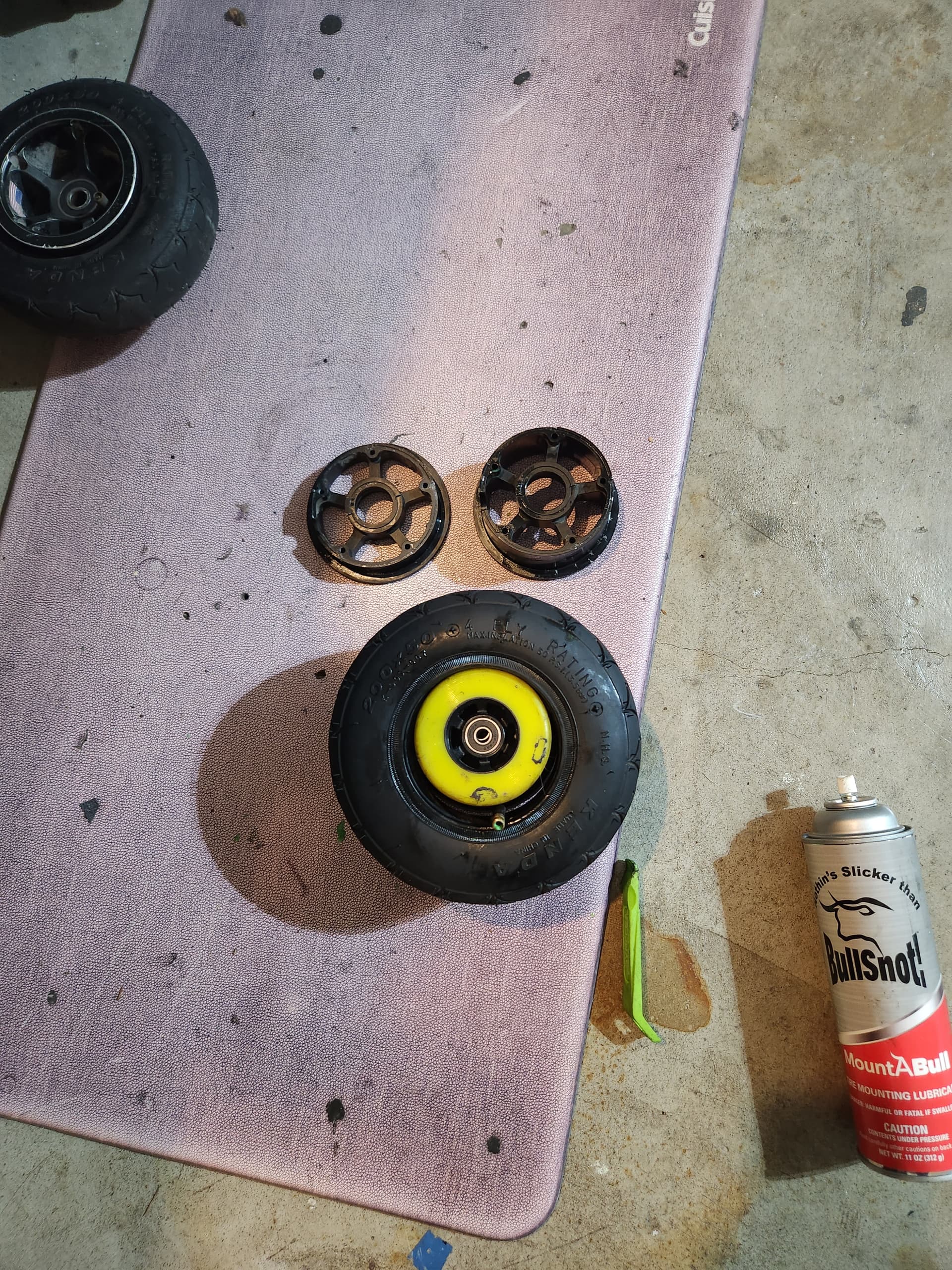

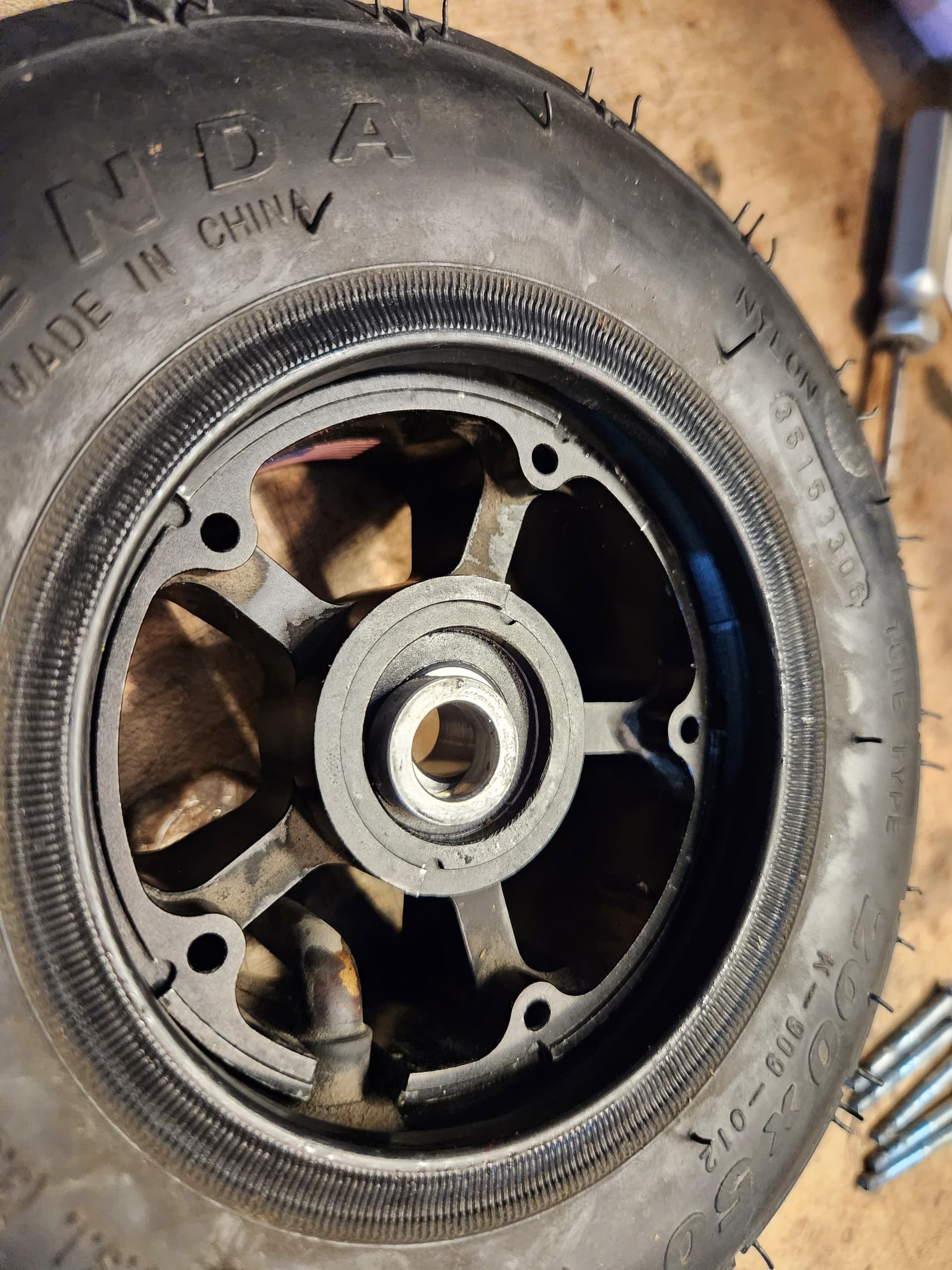

Funny how you forget some things…

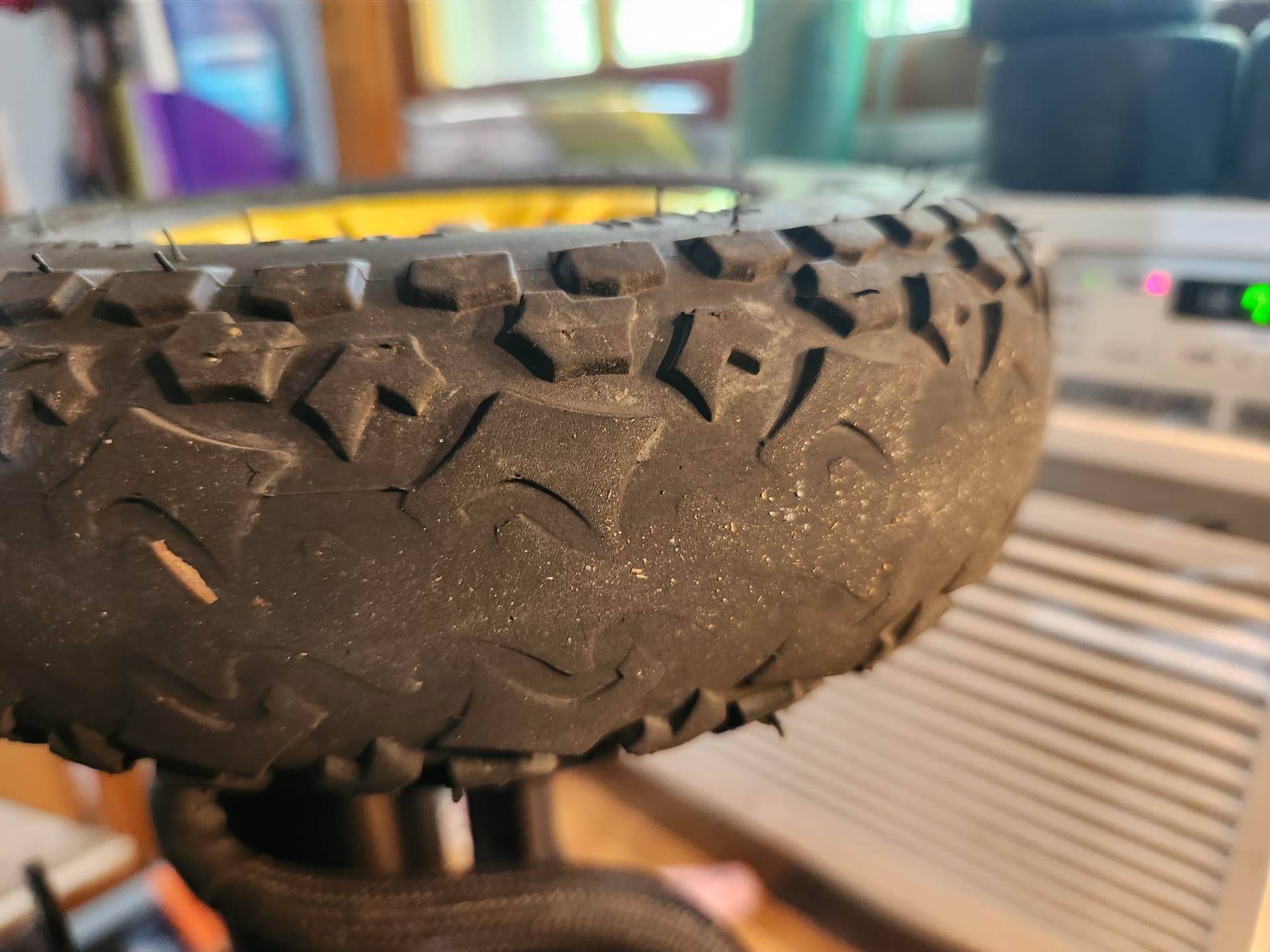

Halfway through lunch break…

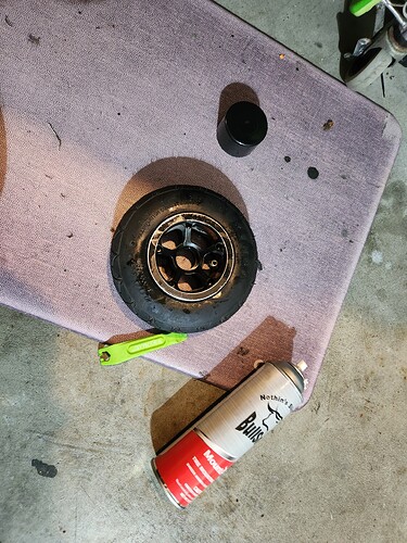

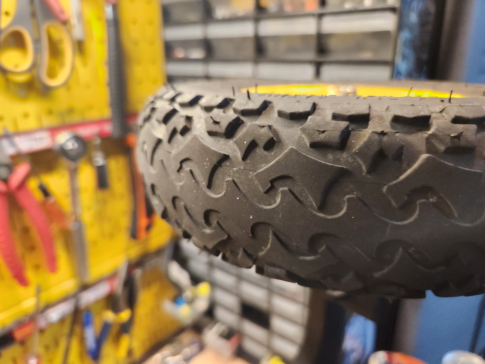

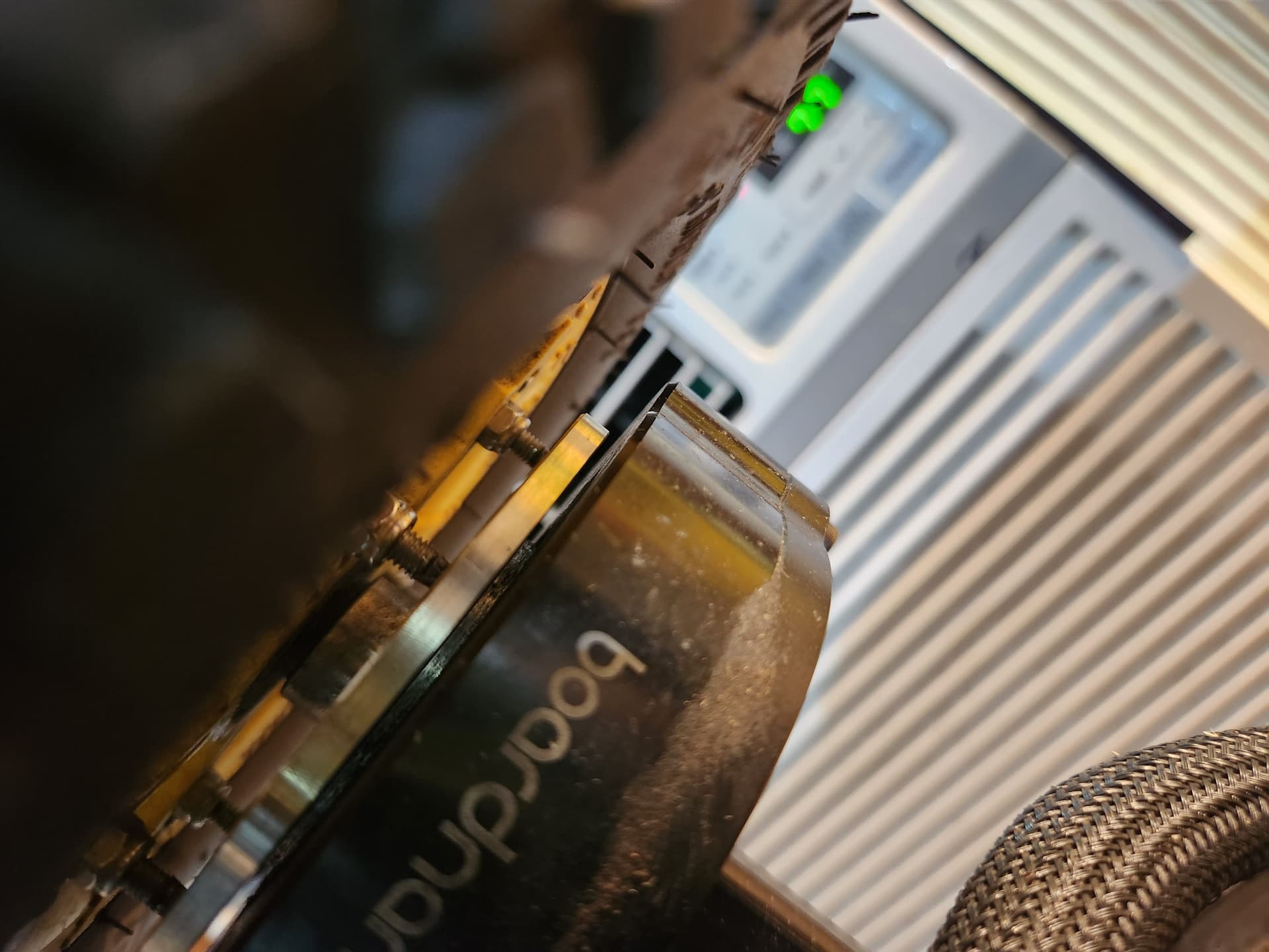

Only one tire off…
It is super hard to take Kendas off of the Hellcat wides…
I seriously think I had an easier time changing my onewheel GT tire…
Holy bananas…
Putting the bearings back in was not super easy either…
Long story short. One hour… Half way done with one hub…

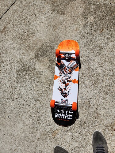

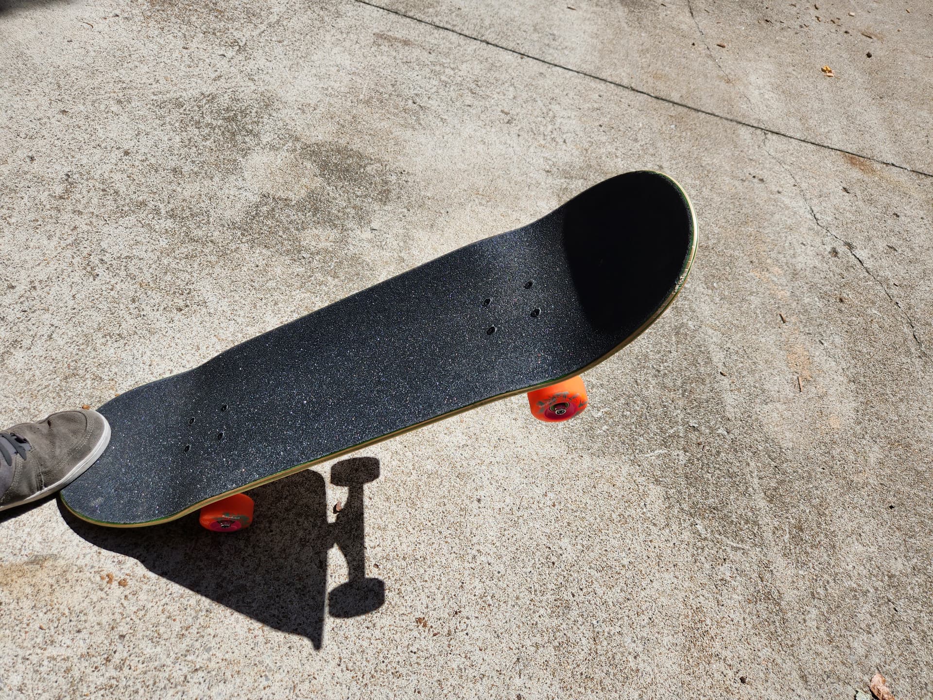

As I am battling the Flux I get a nice distraction in the mail.

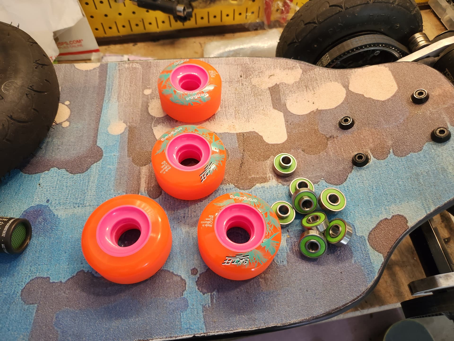

Shinny new wheels for my regular board.
I had gotten a new complete a while back and it seemed horrible to push.
I have not taken it to the park yet…
But I could not stand the super hard 55 mm wheels I had gotten…
So I got these juicy 62 mm Orangatan Skiffs
And oh my. What a difference it made.
The regular board will maybe get a bit of action now.
And seems like I will get by without more risers…
Ha.

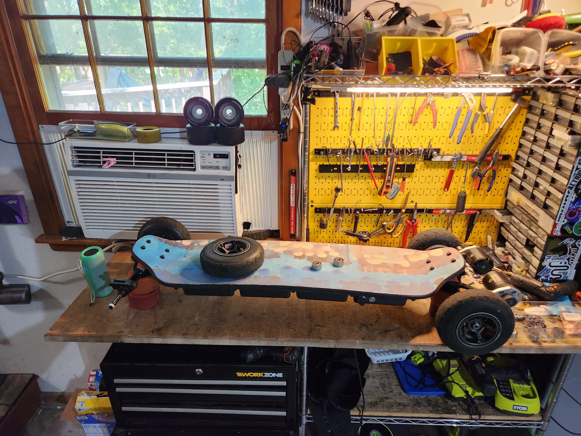

The rear Kenda slipped right off…
And voila…
Half way done with the Flux…
Makes me wish I had an arbor press…
Wow.
This was a particularly interesting example of me underestimating how long something would take.
What an adventure.
I got the other half done…
Well.

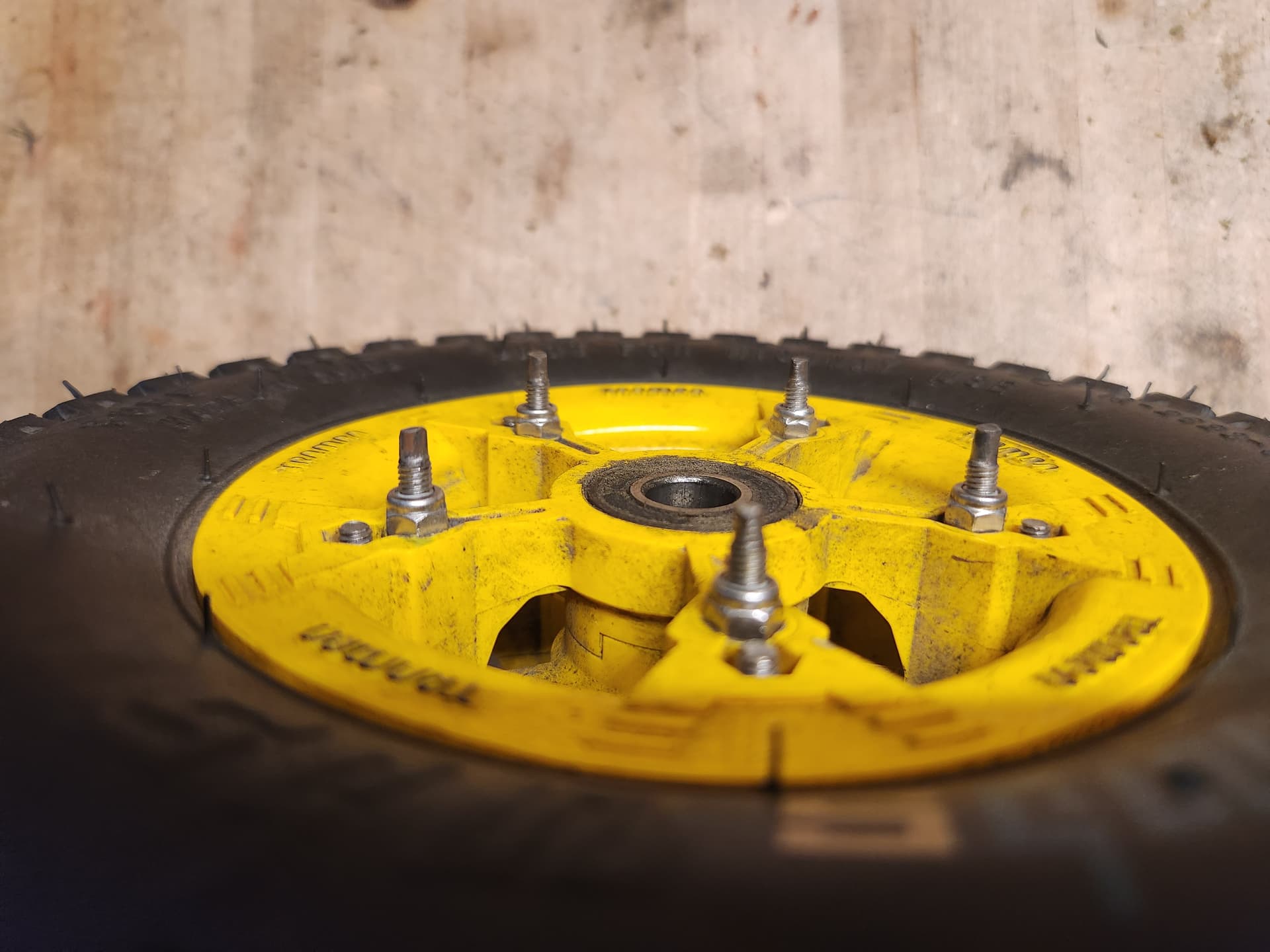

I didn’t change the bearings on the rear hub…
They were not moving and sounded ok…

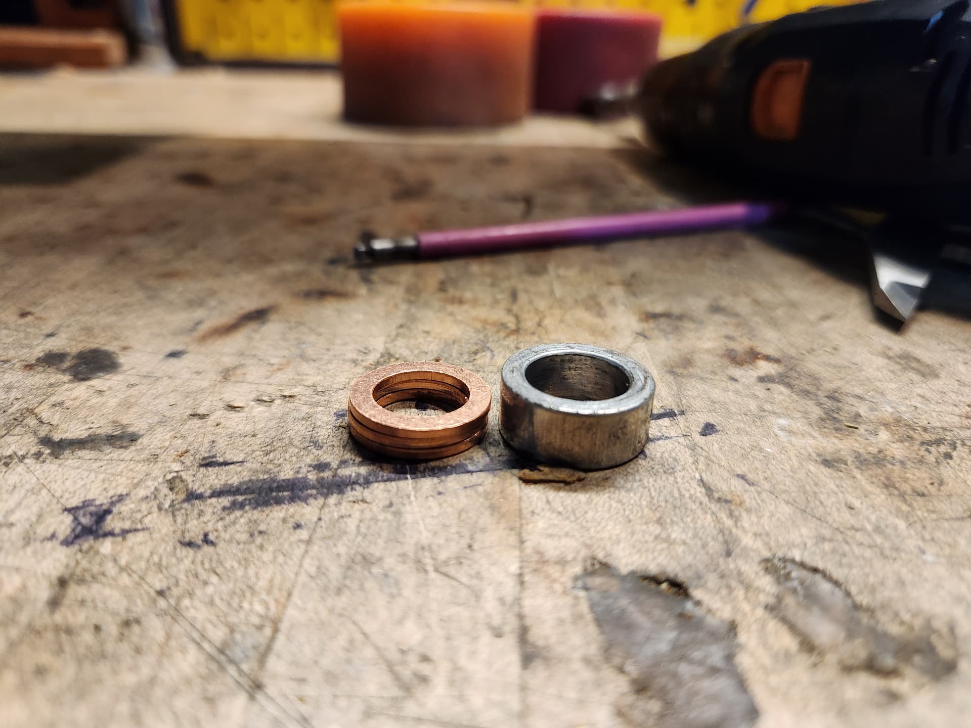

As an added bonus I took the other front hub apart again because I forgot the inner spacer…
Which may be the reason the bearings had failed even…
I only had 3 of four going…
All better now.

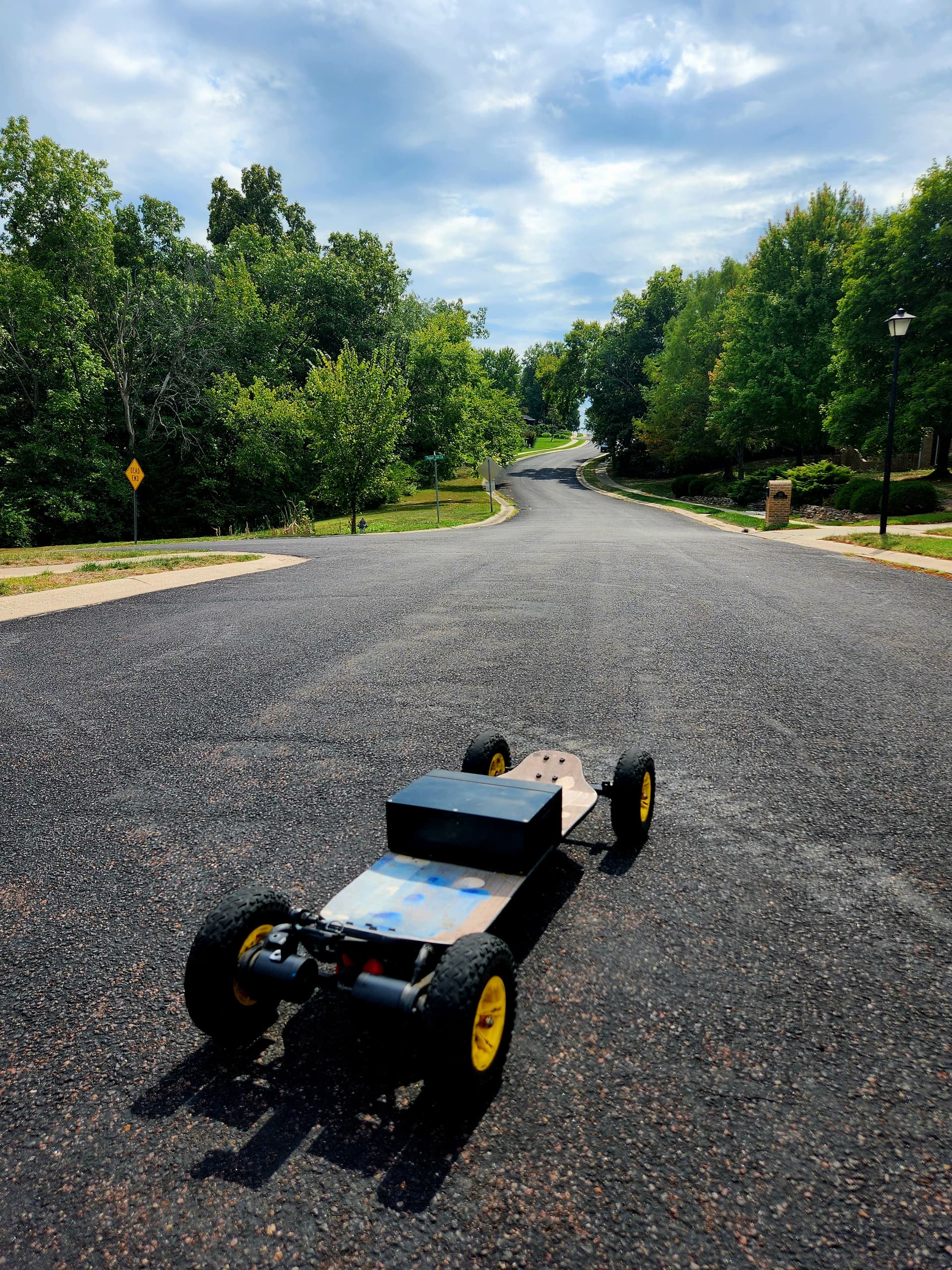

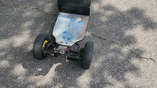

I did a little rip around the neighborhood in the ATV Ditch Life this morning.
And it warmed up pretty good out there so I am going to hang out in the Garage.

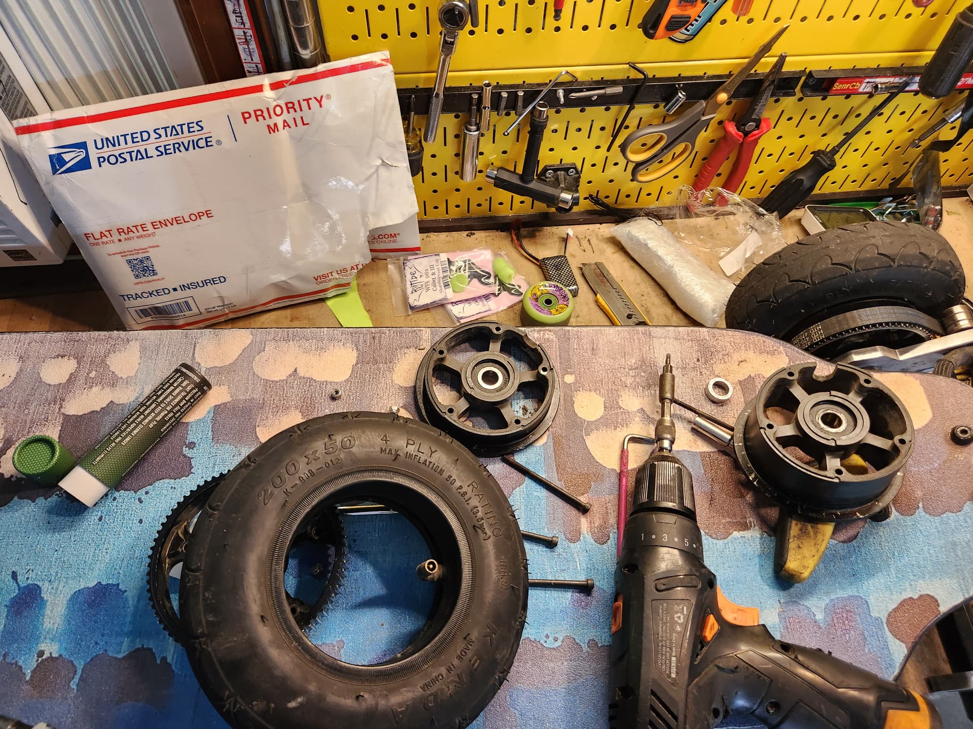

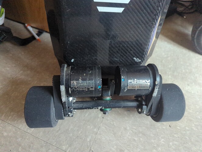

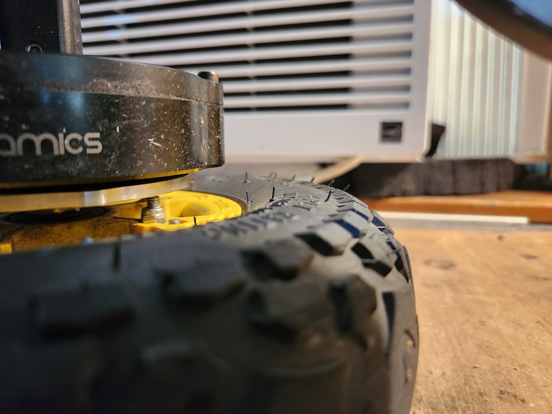

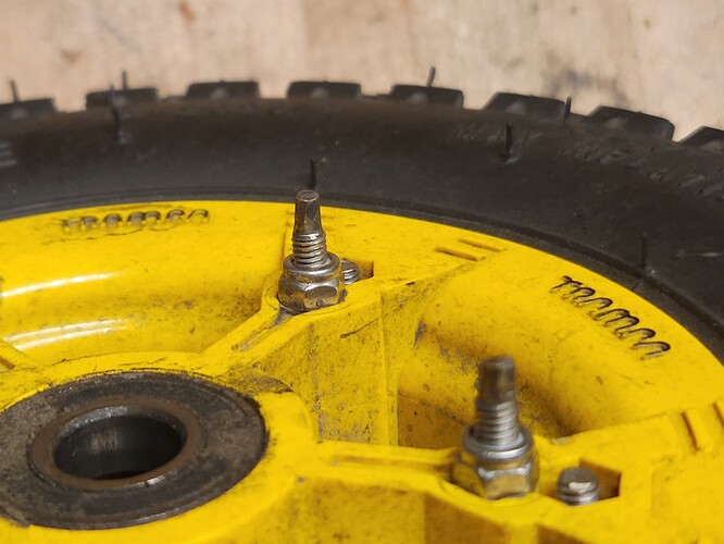

On the bench today is the Gravel Flux.

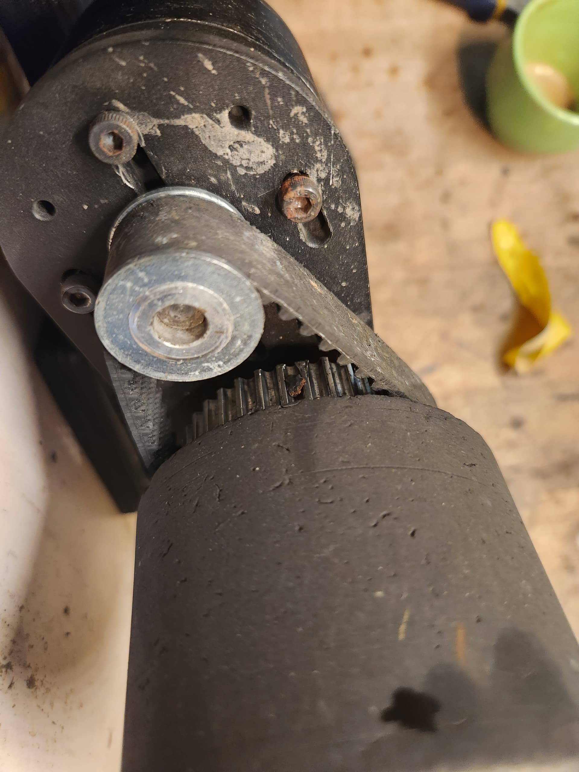

I’m putting the back tires in the front.

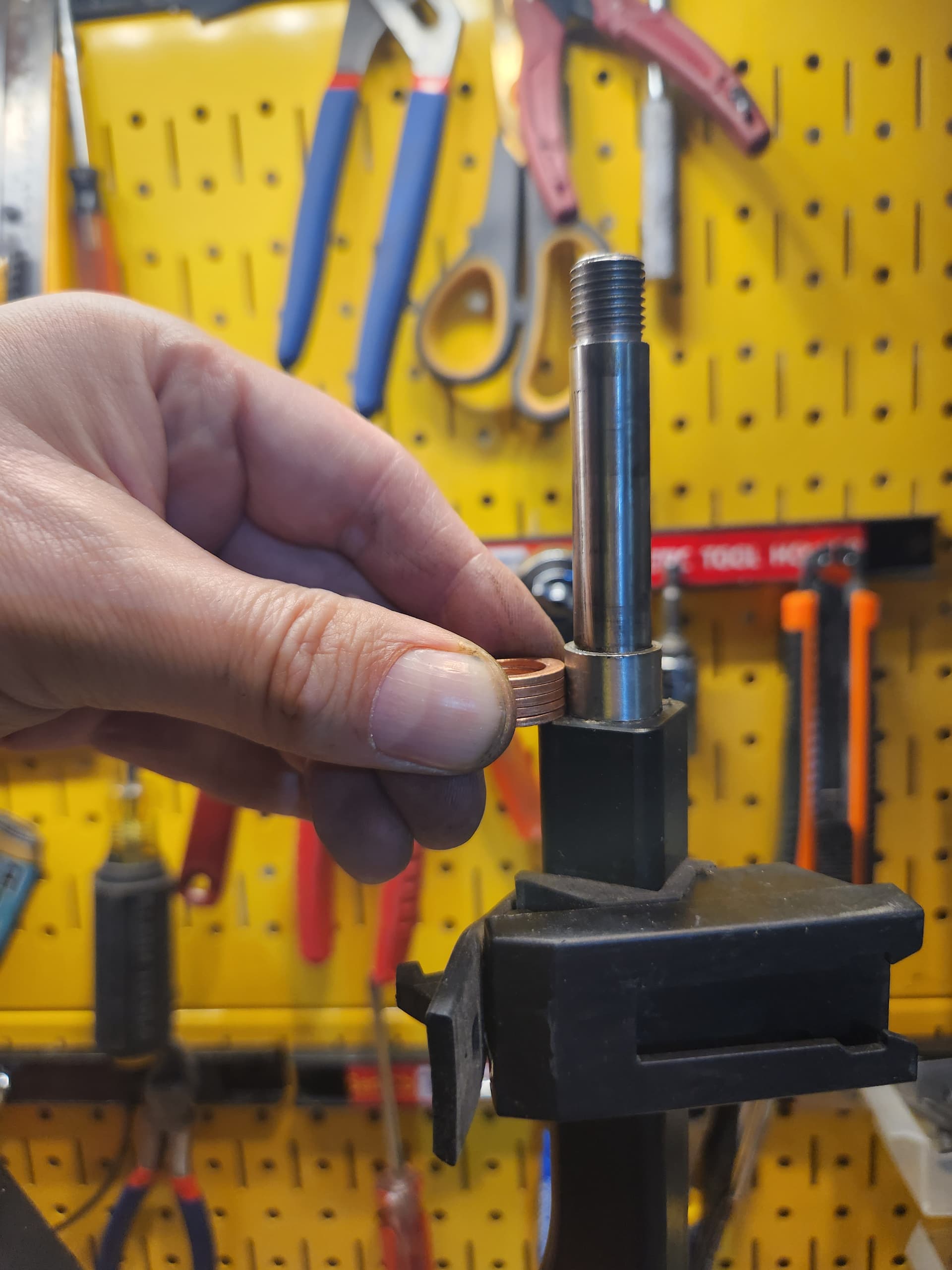

And I am also going to dick around with the gear drive adapter and make the hub go closer to the adapter and Shorten up the bolts.
I wonder if that will make my mystery clicking noise go away.
I wonder if this will all be pretty straightforward or if it will be a roller coaster like the Flux was the other day…

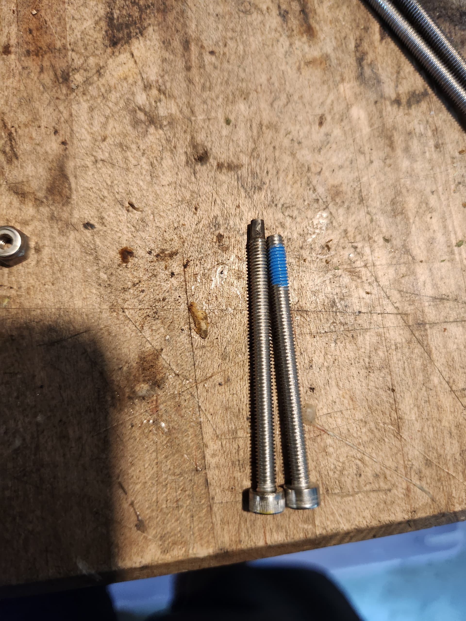

Pretty wild to see how much the posts wore out.
This is a good sign.
I might have the right length bolts without having to cut the old ones…
How about them apples…
Already halfway through.
All good so far…
Just changing spacing.
Will the second half go as well?
And whoop there it is. Back in business.
That is how it should always go…

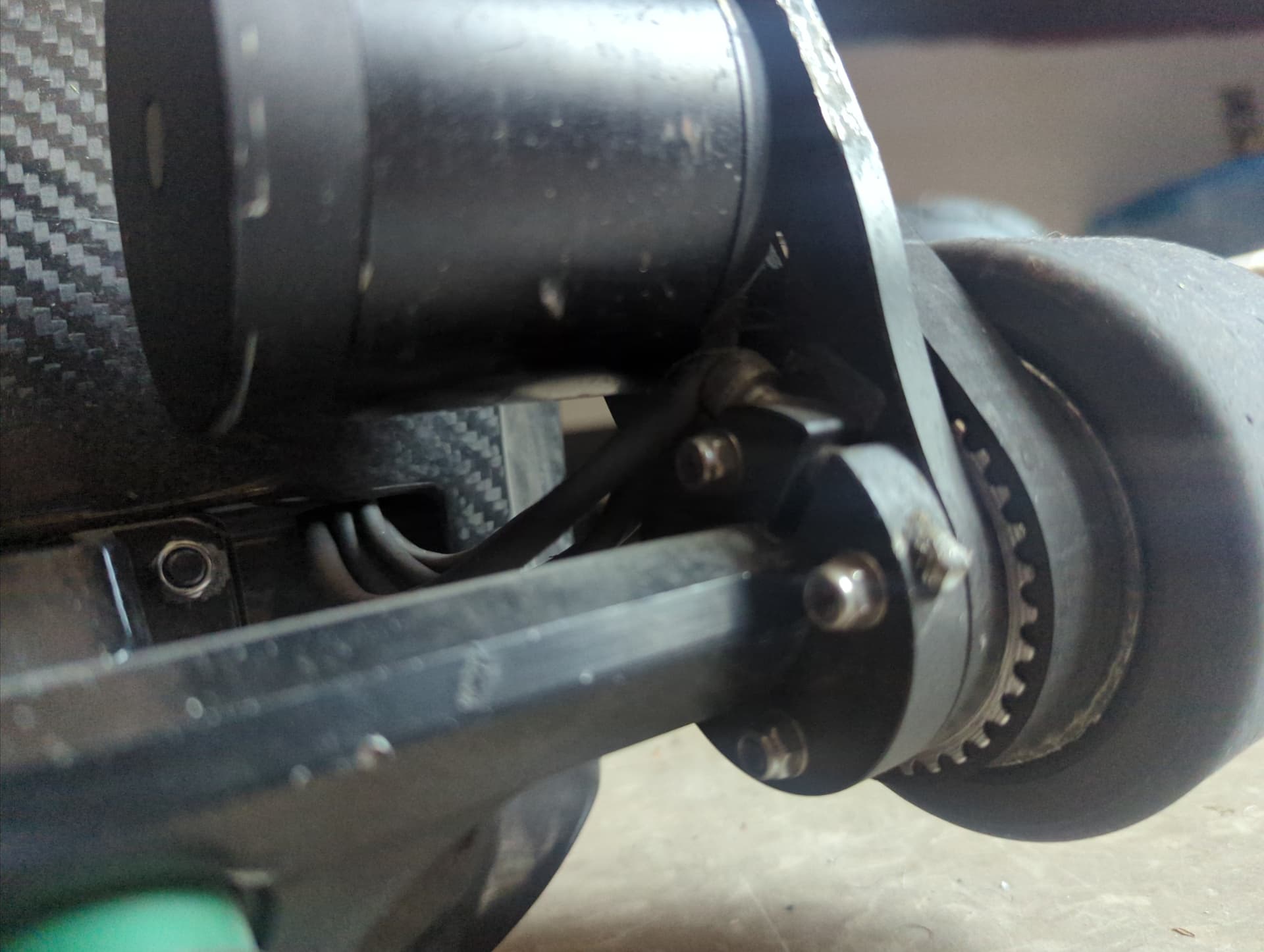

Tell me about it
200 miles. Looks way worse than my 2k mile geardrives.
Hey Evan can you show me how your motor cables look on this set up? Are they super squeezed?
Yes.

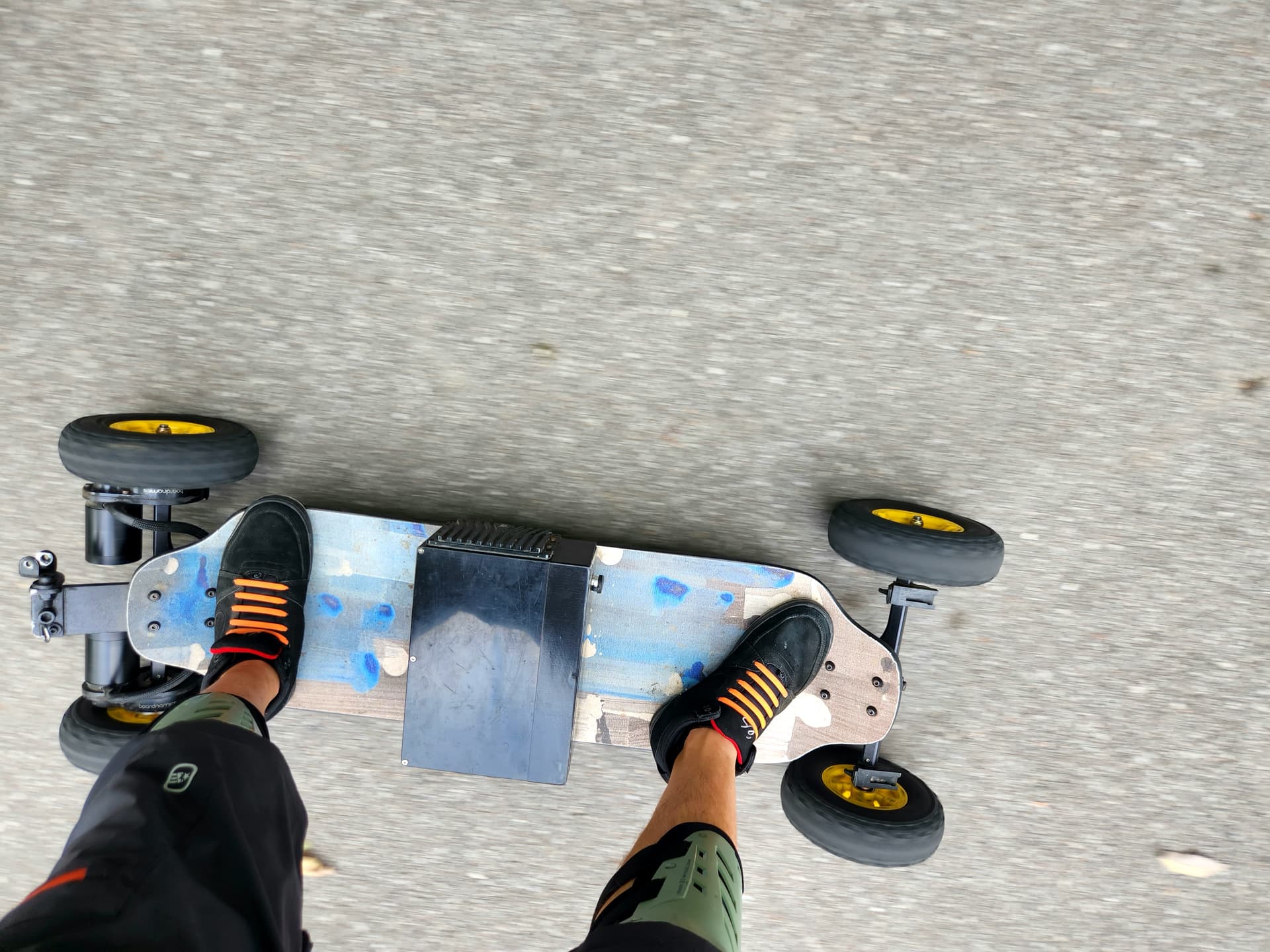

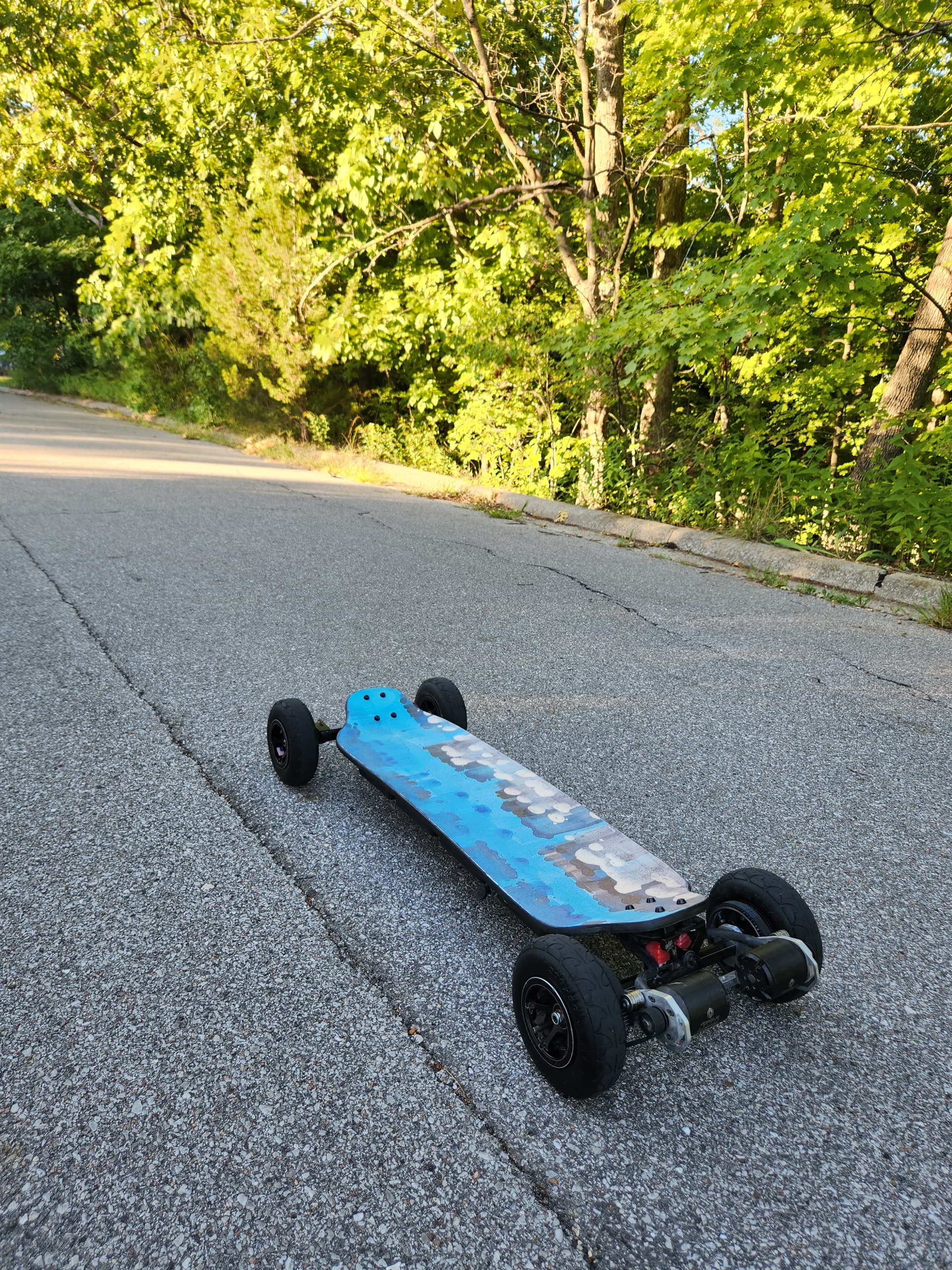

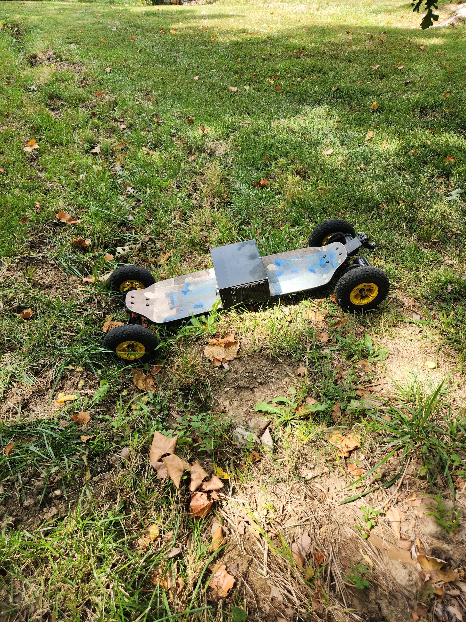

So I went and did 6 miles around the neighborhood.
And hot diggity dog.
I love this board.
Also lucky I saw this little ditch before it was too late!
So yey for that.
However one of the things I had hoped is that moving things around would make the weird clicking go away, but I had no such luck.
I think it’s fine.
Feels fine…
It has sounded like this since I got these drives and I have taken them apart and redone them…
And did this and it is still there.
It really feels like it runs fine.
But the clicking is annoying…
