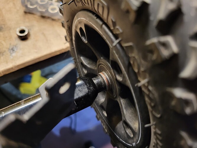

So I move the trucks over and here come the Esk8 god’s to say not so fast…
and yep, you guessed it. Wheel bite with the MBS 9 inch tires…
it is a good thing I had just ordered 6 more of them for this set up…
So I go on to ponder life and think of how I can move the wheels out further.
and I could not think of any cheap solutions…
So.
I decided to slap 8s on there.
and wow. so puny…
but I actually like the look better.
and have a theory it will turn a bit better… not sure.
but for now we move ahead.

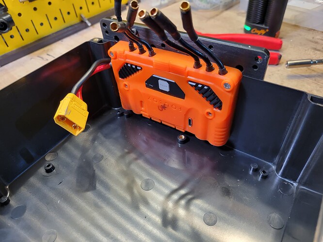

my old beat up battle hardened Flipsky 6384s that I battle hardened. they still come up sensored.
I cut the Junction box to mount the Infinysink on the outside like I did with the Haero.
So I got a little weird with mounting the enclosure and routing the wires.
I decided to use the inserts that were already on the Flux Deck.
2 on either side of the deck so 4 holding the enclosure and double sided tape.
Then I sent it and punched a bunch of holes through the deck.
with these long ass wires and handling them a bunch I kept worrying about messing up the sensor wires…
I ran detection a bunch of times through the build before buttoning things up to see how it came up.
so far so good…
So I continued to get weird and put a sheet of abs to cover the wires on the bottom…
I covered the hole with Butyl Tape.
I hope this thing is sufficiently water resistant.
and I crammed it all in there… I do want to put a layer of two of heat shrink around the battery so I will pop that out a bit later and retape it better.
still coming up sensored!!!

it was not gonna work with Fivestar Hubs and the MBS 9s…
so I took the gamble and ordered the Phatlads hoping the offset would move the tires out far enough…
well.
they are going to work.
I did not know this… but the bearing seat on the Phatlads is narrower than on the MBS hubs… so I can get some speed rings in the axle…
so this maybe 5mm and the offset was enough.
So I am stoked…
I wanted 9s to just roll over everything.
I have not decided if I want to put on the MBS 9s or the 9Inch mudpluggers…
I think I am leaning towards the MBS…
I wonder which ones would do better on gravel.
