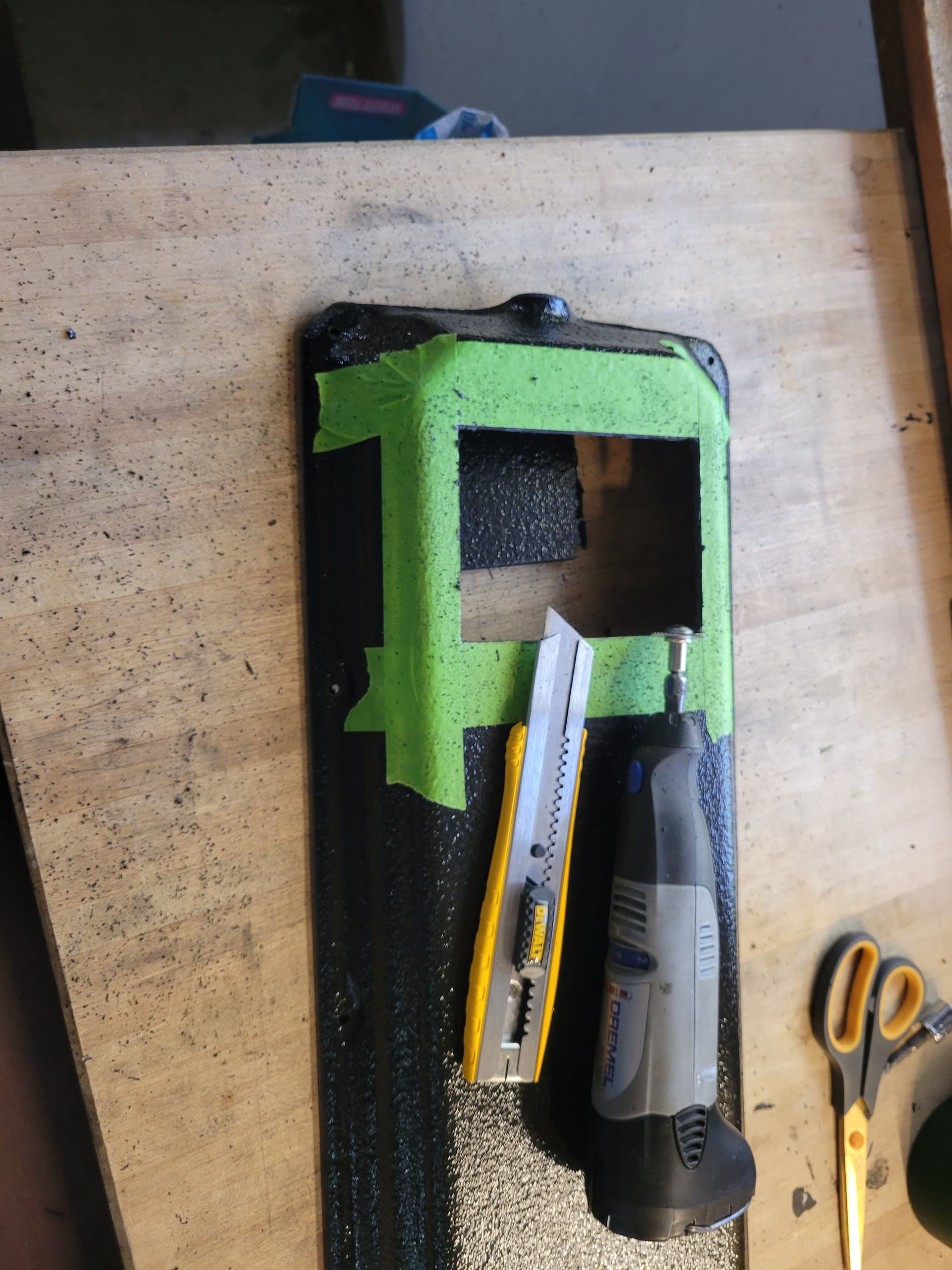

cut the enclosure and installed the heat sink.

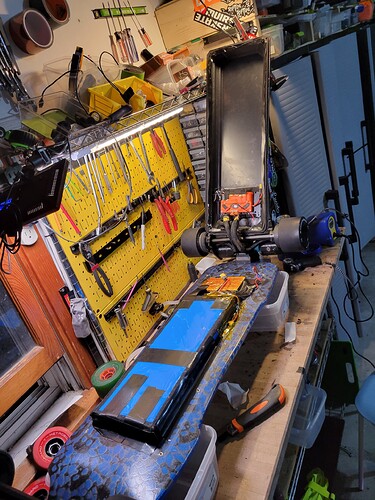

Then later on I extended the phase wires and assembled the drive train.
So it is really really close now…
just gotta put it together.

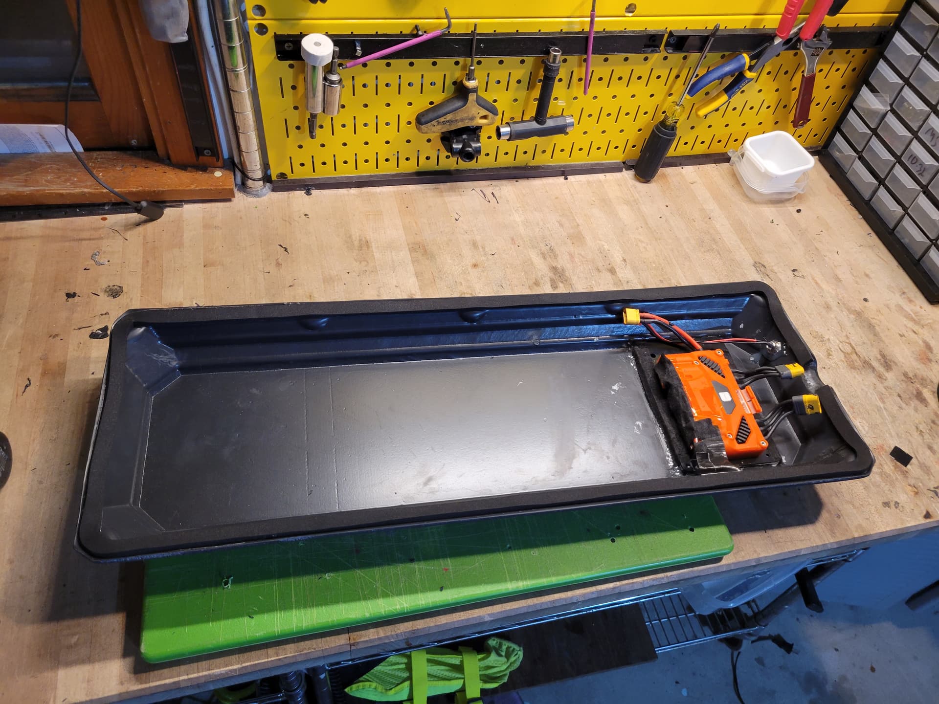

Khymera deck and Killshot enclosure( new thicker abs)
BN adjustable baseplates and 270mm hangers.
TB 110s.
12s4p 40T of Duck Batteries PCB with Ltt smart BMS.
Unity running 23.64, on Infinity sink.

this new thicker abs enclosure was nice to work with…
I don’t expect I will break the bolt holes like I have so many times in the past.
I really like using the Infinity sink as well.
I just glued it to the enclosure.
I like how the Unity is so solid on there.
so unity is on the enclosure. and battery is on the deck…
made it work…
as always had some funny hic ups on assembly.
first I had extended the phase wires. and had routed them in the riptide tunnell riser.
when I ran the wizard it would not pick up the sensors…
so I took the wires out of the riser and they detected fine…
but then the wires were too long…
so I had to shorten them.
so when I slapped it back together I put the hanger back upside down and was to the point of bolting the enclosure before seeing the motors were to close to the deck…
so came apart again.
so I kind of put this together 3 time last night…
well. 3rd time was the charm and I took it out and it ran well.
