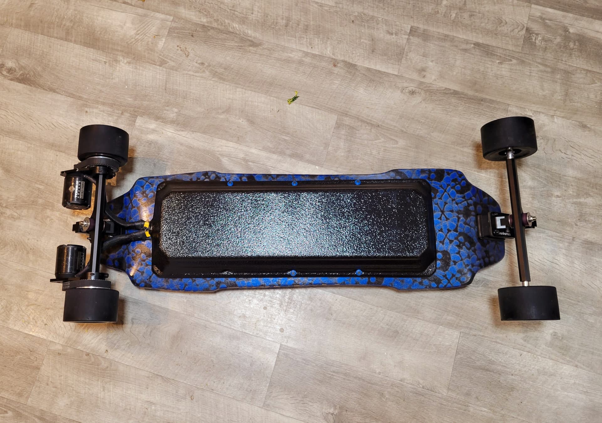

got a mock up of the Khymera going.
happy with the Lucid.

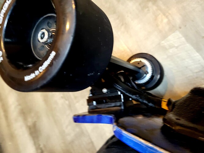

I got hella risers going to avoid wheel bite…
could probably be a bit lower but I think I will rock these.
I think it will sit higher than then Llama which is pretty tall…
as usual something super annoying creeped up.
I will need to extend the motor phase wires…
too short “need 2 or 3 more inches”…
Huge bummer on the wheel bite. What part of the deck would need to be trimmed to reduce bite. I’m assuming it’s just the front wheels that are biting?

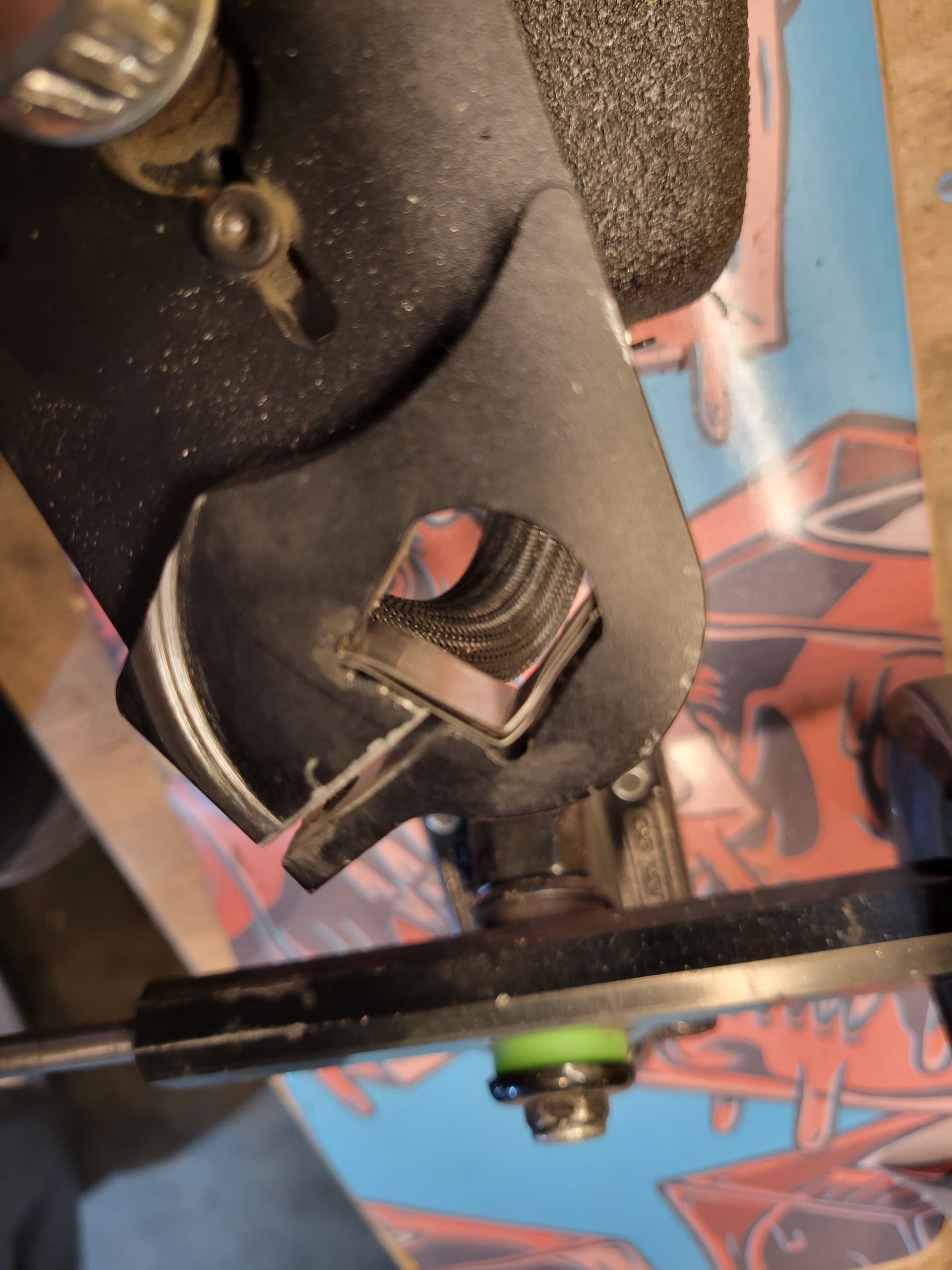

as I am tightening up the last mount I break the bolt…
so let’s start from scratch with the boardnamics mounts…
I love DIY…
oh.
yeah.
this is not the first time I have done this exact bolt break…
You need some 12.9 bolts in your life :wink:
I just can’t believe I did it a second time.
it takes some doing…
Yeah I’ve done that a couple times. With enough patience and a good thin drill bit, you can potentially get it out haha.
but all good.
Omakase is back together.
just a bit of time down the drain.

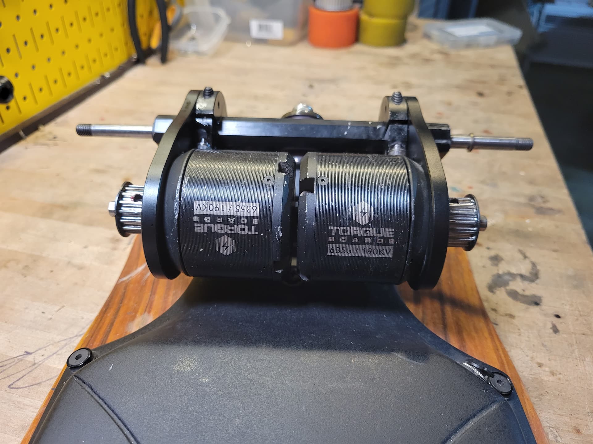

The Boardnamics mounts are more stout…
very similar size.
motors may fit a bit closer to the ground but it is pretty similar.
I hope I dont have issue with the motor wires.
that is pretty sketchy…
also can’t really move the motors much back and forth because the wires are in the way.
by a miracle I had the right size belts…
here is a bunch more pictures of me putting it together…
if I have another go with these mount I will definitely file the clamp down a little bit where the motor wires hit…
wish I had though of that earlier
