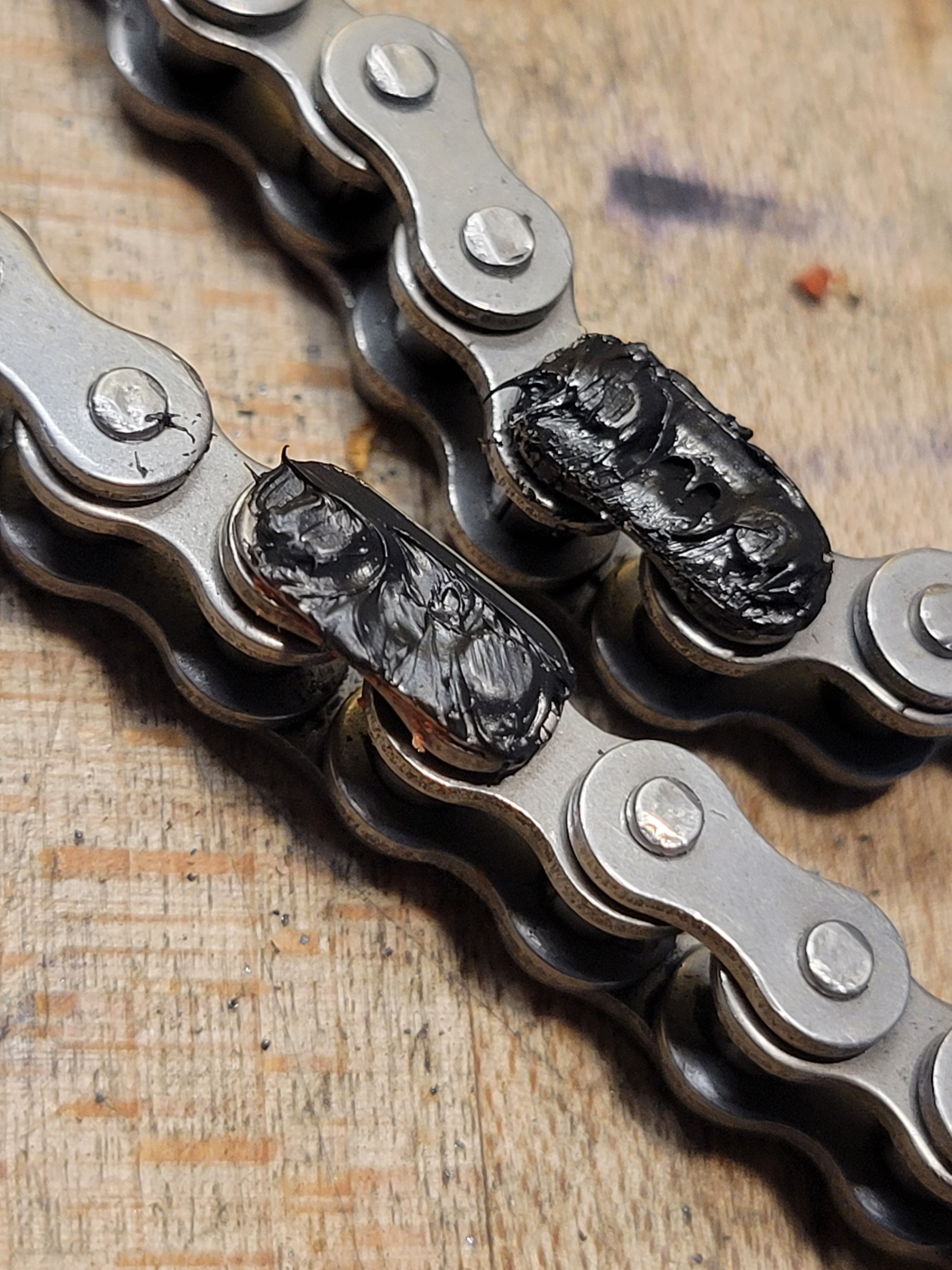

these chains are breaking my balls…
this is now the 3rd break of a master link for no obvious reason…

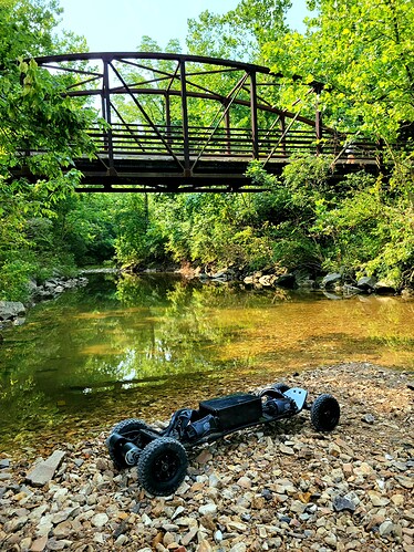

day 2 of heel bindings.
it was fun while it lasted.
today I did fall.
thankfully a gentle mellow fall.
I was creeping slowly towards the creek…
hit some deep sand.
stopped suddenly and lost my balance.
and just fell back on my butt …

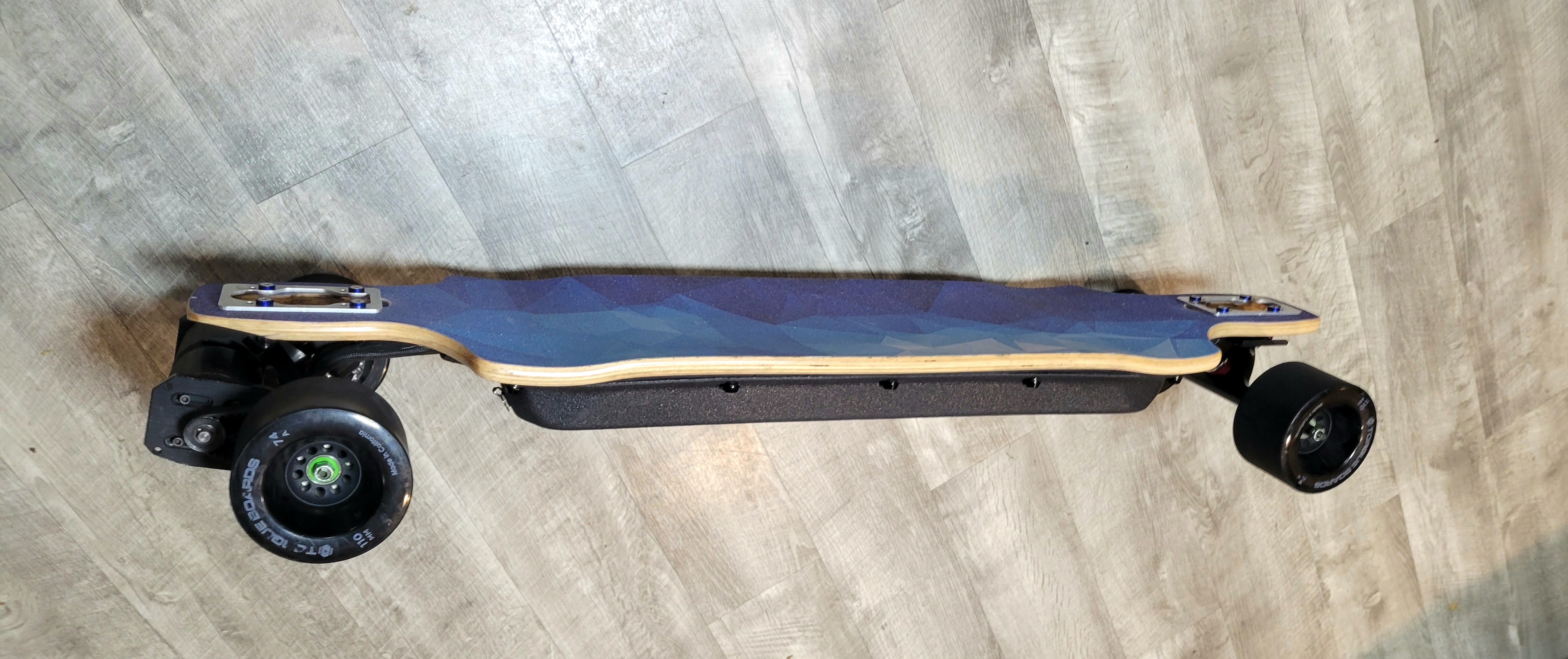

The Paradigm comes back to life as the Loaner.
These are all parts I had around.
Just needed to bring them together.
DB Paradigm 41 deck.
Psychotiller Argonaut enclosure.
TB 218s with BN 220 hanger in the back.
10S4P 30Q pack.
Flipsky 6.6 Dual Plus.
Flipsky 6384 190kV motors I just took off the Demonseed.
14/40 BN Mounts and pulleys.
TB 110 74a.
I think at 10s it can still get to 30mph.
It was nice to just slap parts together.
the build went fast.
I had to repair a crack on the edge of the enclosure and used JB weld plastic bonder and a piece of abs. turned out good.
and off course truck bed liner.
this one got every thing taped to the deck which is what I have been doing more lately it seems.
and a layer of butyl tape around the edges because I am a fan now.

What size are your chains?
#25H

going to try silicone on the master link of the chains.
