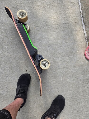

The other day when I change the motor pulley, I forgot to put the nut back on the truck.
So as soon as I start riding My back will rolled off.
I decided to try and ride home with no nut…
On the half mile home the wheel only came off twice…
Definitely a proud moment…

He is on his little esk8 and I took the Nicky to match his vibe…
So freaking cool.
We hit the nice pavement road, and then rolled on the sidewalk to the school.
20250515_204237(1)
Then we skated around the parking lot.
He tried to go down the curb and I tried to grind the curb!!!
