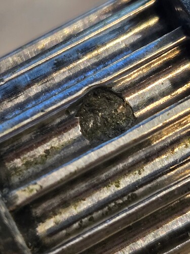

So I had to put the Demonseed on the bench to get the back drive apart.
It’s always something…
Luckily Minor and the we got to celebrate two successful pulley extractions.
I just sat down after realizing I have to take the motor mounts apart to get these motors out…
All motor mounts should have slots out the back to just slide the motors out…

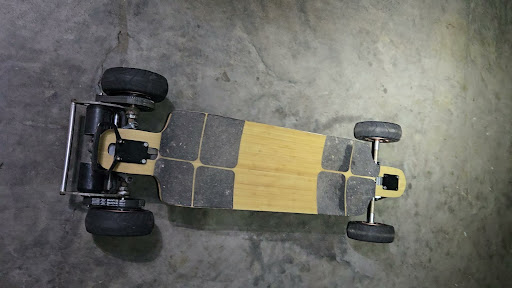

Ok. So I wanted to distract myself with something more mellow this morning.
My buddy Daniel printed a new set of sticky feet for the GT
It’s definitely time for the Ignite padded grip tape to go.
I do love this stuff…
Unfortunately as I peeled it off the bottom layer of adhesive stayed on…
This has got to be one of the biggest pains in the ass in the world.
But I set through a meeting and slowly peeled it off and got it all done.
Then we just had a little bit of double-sided tape.
Daniel eyeballed it and made the template. And after a couple iterations it’s a perfect fit.
I don’t know how long this sticky feet stuff lasts.
But immediate first impressions are so good.
It looks cool.
It’s easy to work with.
And when you stand on it you really few glued to the board!!!
