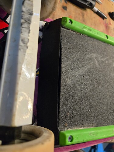

Going back to earlier this past weekend, I changed the Grip tape on the ION Drive V1.
I thought it was really gorgeous how it came…
But I wanted some padded grip tape on here!!!
I love the Ignite padded grip tape from 1wheelparts… It’s awesome.
The Hummie Deck is quite stiff, so I wanted some dampening, which the 4mm cushion does well.
The deck is also a smidge narrow. So my back toe hangs out…
I tend to do this on most boards…
The edge felt sharp.
And the padded grip tape take that pressure point off
And the grip on this stuff when it’s new is supreme…
Taking off the little hexagons sucked …
At some point I broke out the heat gun… And off course managed to fuck up the coating on the deck…
This is why we can’t have nice things…
I wanted to make a design similar to what I have on the Demonseed.
The only difficult part with this pad a grip tape is cutting the sides.
To get them smooth I take the side of the board and then sanded them with the Dremel
I’m totally stoked on how I came out both the way it looks and the way it feels.
Sweet!

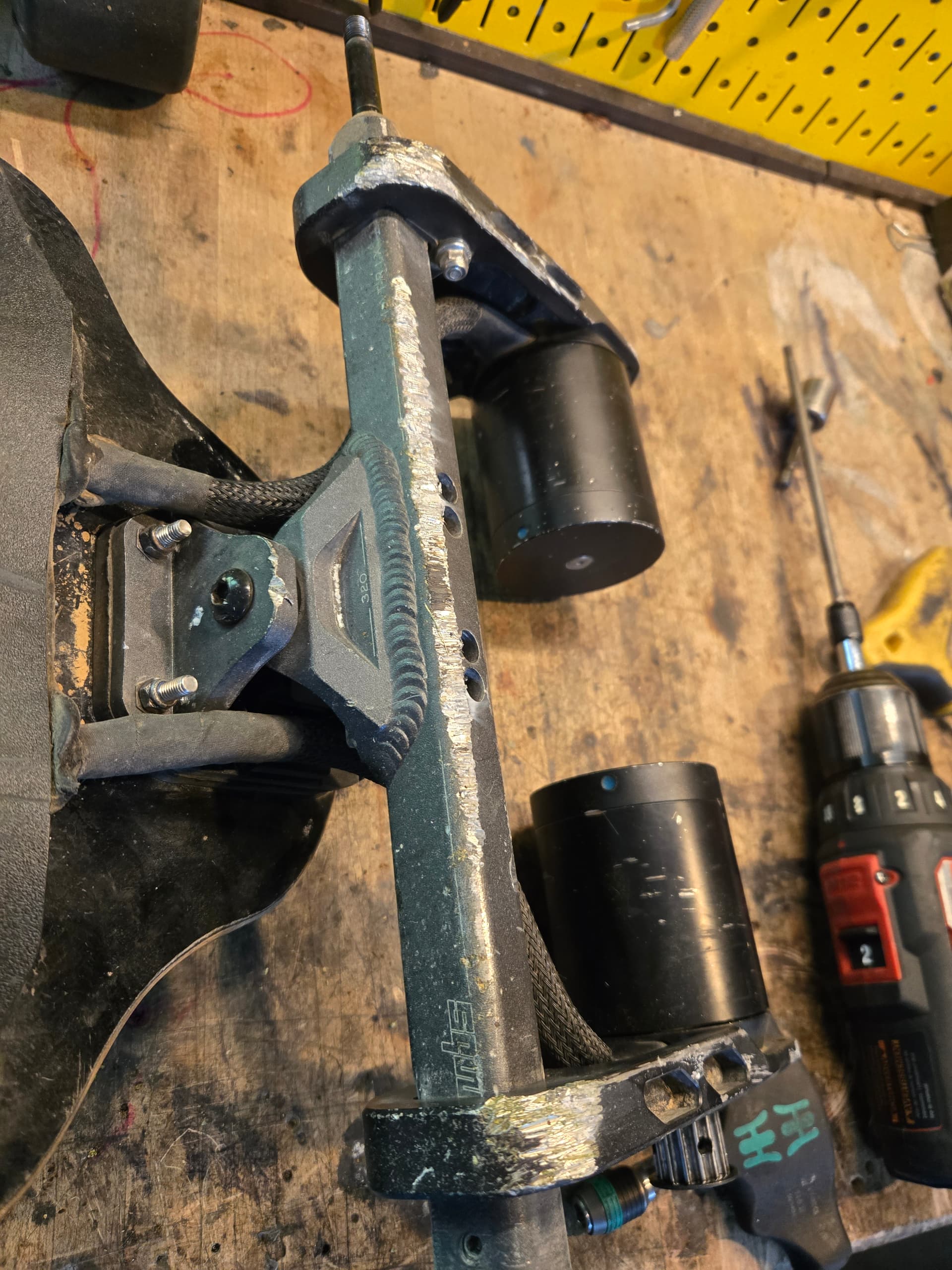

I got to some successful tinkering today!!!
The Newbee drives from Evan arrived.
So I put the Box Turtle on the bench.
Pulled out the enclosure and ripped out the motors.
Slapping the drives on went super smoothly.
The hardest part was peeling the Butyl tape off…
I didn’t take many pictures of the process apparently…
But here we go.
The Box Turtle is back.
Now with Newbee 4GS and Flipsky 6384 190kV.
