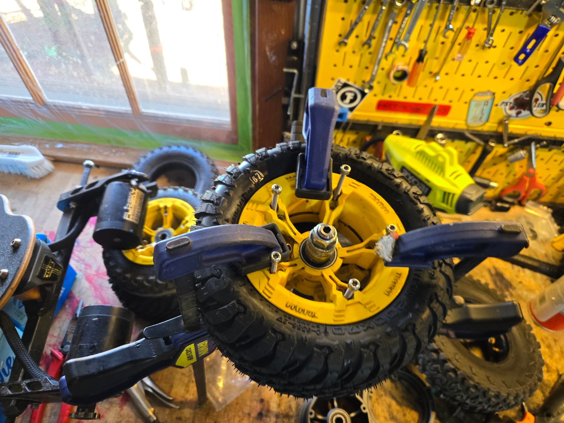

The incorrect tube of choice was the 200x50…
The bigger tubes were not going to fly.
And even with clamps I was not going to get these tires to work on the Phatladz…
So in comes the DIY is a disease moment…
Because now I need to take the wheels off the Gravel Flux which had been buttonned up so nicely…
I suppose It’s worth mentioning sometimes it pays to be a hoarder. Because I had a whole extra set up I could take wheels from to make this work.

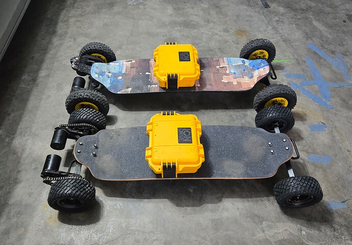

Doesn’t seem like that big of a difference…
I also had to use clamps to make the MBS wheels work. But it was definitely doable… And I felt like I had no chance with the Phatladz…
I need to also get a picture next to the Mudpluggers. But these things are cool.
The Gravel Flux is back together with the wheels it had in the first place… So I suppose they are meant to be here.
These wide ass tires look really wild to me!!!

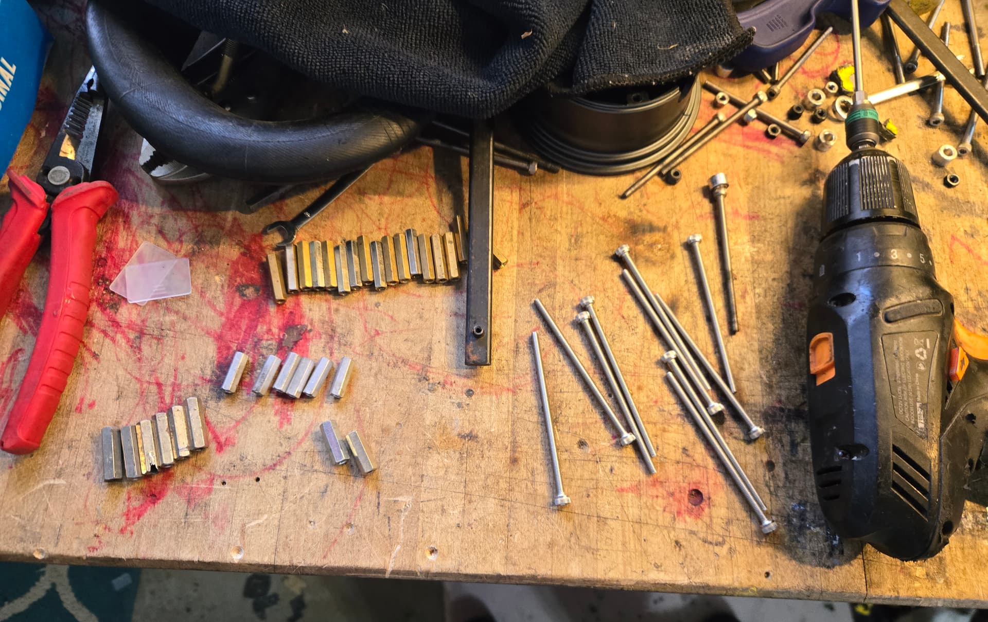

I had to dig through my standoff stash to get the chain sprockets far enough from the wheel…
Definitely a consideration with these tires. They stick way out.
These tires look so cool…
The look alone makes me happy.
I didn’t have any issues on my first rides. And really only rode them on smooth roads.
But they seem good.
