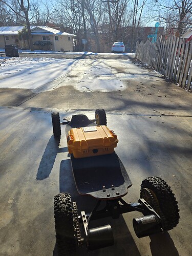

After getting home from school drop off It didn’t actually seem super horribly cold outside, even though it actually was but I decided you know what let’s go and ride this freaking thing…
I have not done the ABS plate on the bottom… And I don’t super want to get the tape covering the wires wet…
But the roads were mostly dry.
So I gave the Dualitys 7 quarter Turns in the back.
5 quarter Turns in the front, and carried it to the street.
And what a joy!!!
What a great first impression!!!
These trucks are just so easy and playful.
And I just throw them side to side and the board dips and slashes so hard.
I was able to do U Turns on my road both ways so easily!!!
Dualitys are the only trucks I can do that so well besides DKP…
The chains felt solid and sounded great. Will be even better with a little bit of wax added.
Now the deck was really interesting.
I think I’m going to like it.
I really do.
it’s really totally familiar to the Flux but it has this delightful pocket for the back foot that’s really nice and the concave on the front might be just right so I think I think it’s going to be good.

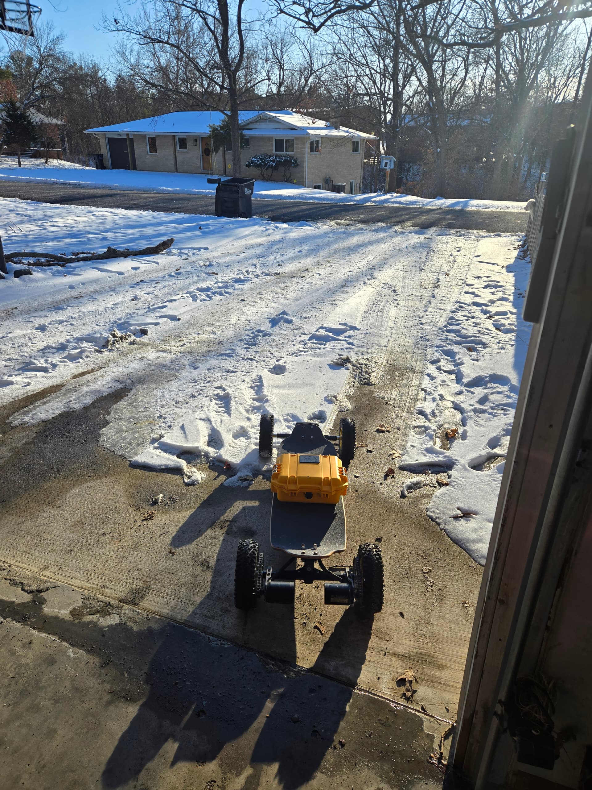

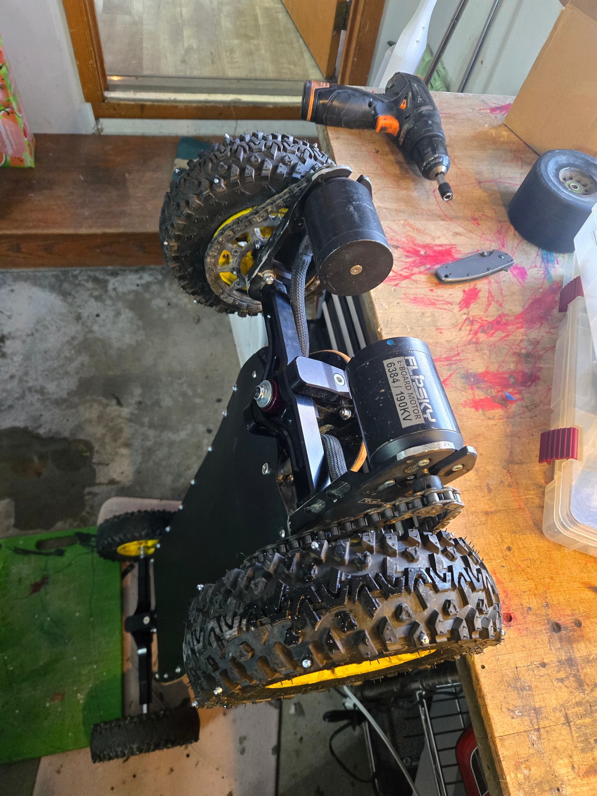

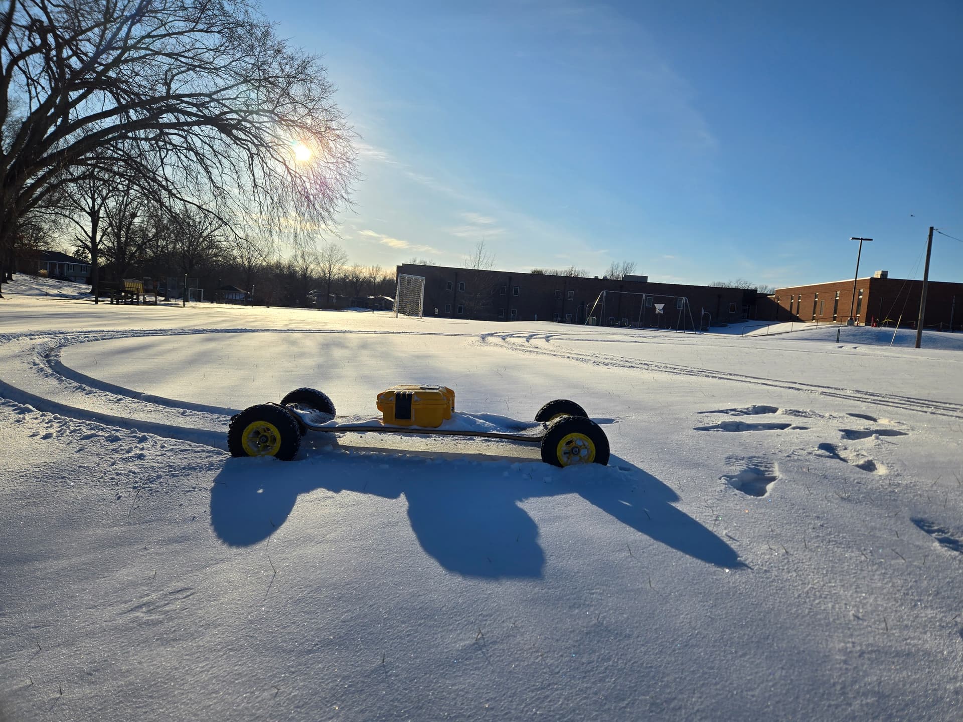

So looks like last time I was here, a week ago, I went on the kinda Mayden voyage on the Almost a Flux.
Today I had a more proper mayden voyage, because I am really done with it, and I was ready to take it out in the snow.
I added studs to the back tires…
Then I bundled up and took off around the neighborhood.
Some roads were clear.
Some roads had packed snow which was really fun.
And I went over to the school to ride on the Grass.
And it’s just about little enough snow that my board got around fine.
I wonder if today was the coldest temperature I have ridden in…
But I had fun going slow, and doing miniature drifts.
Totally stoked I siked myself to get out.

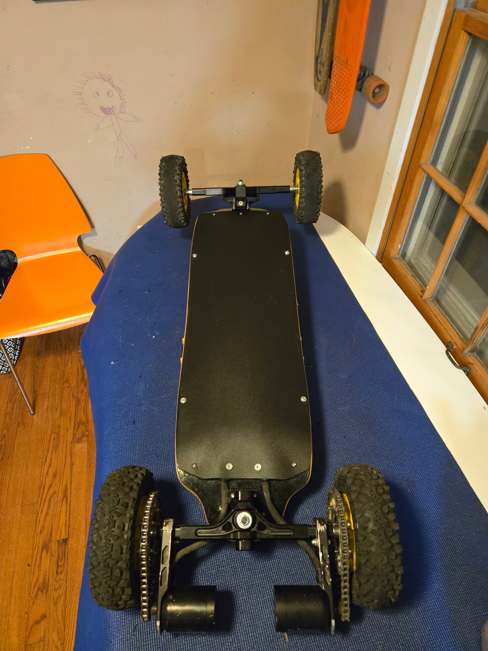

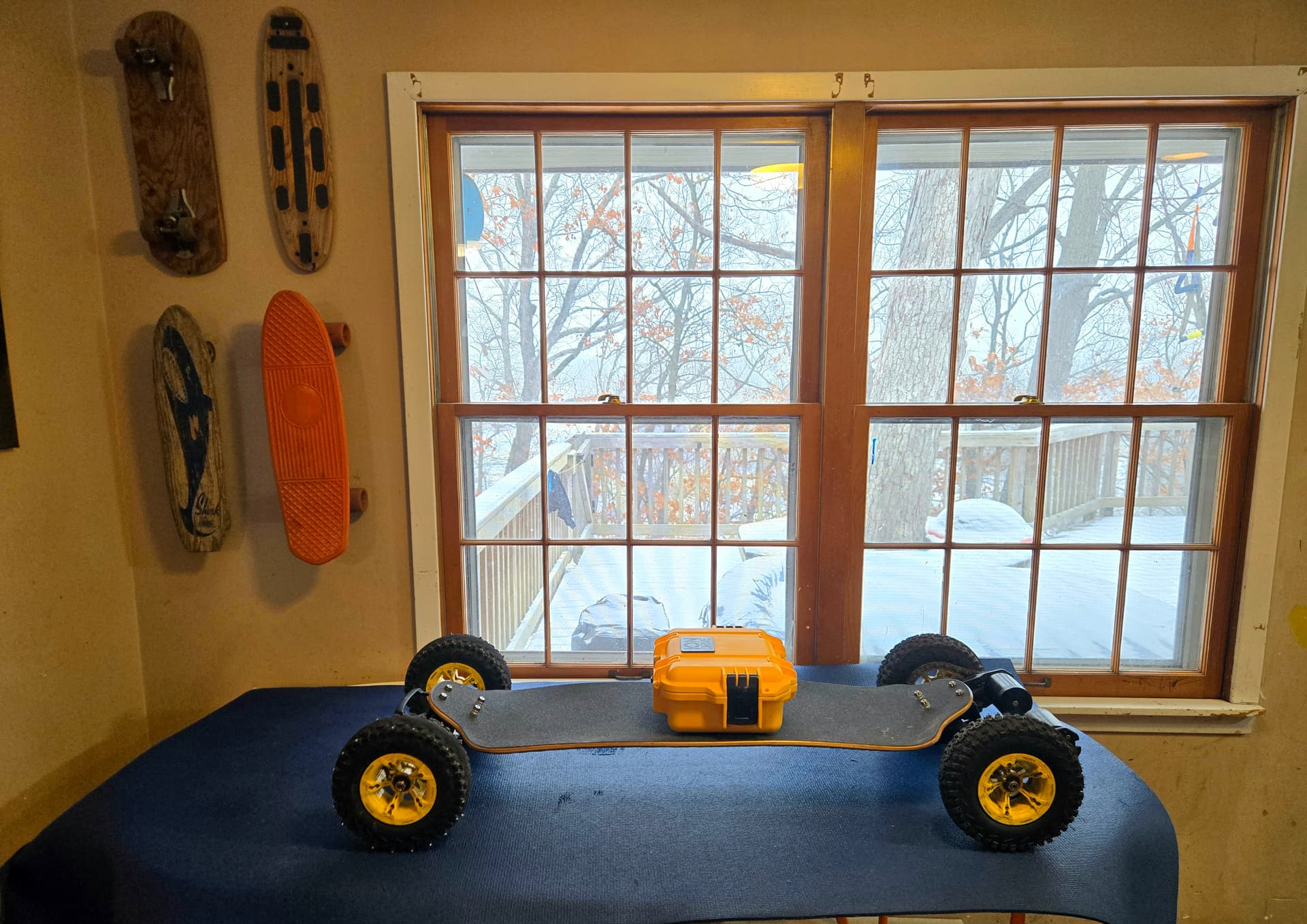

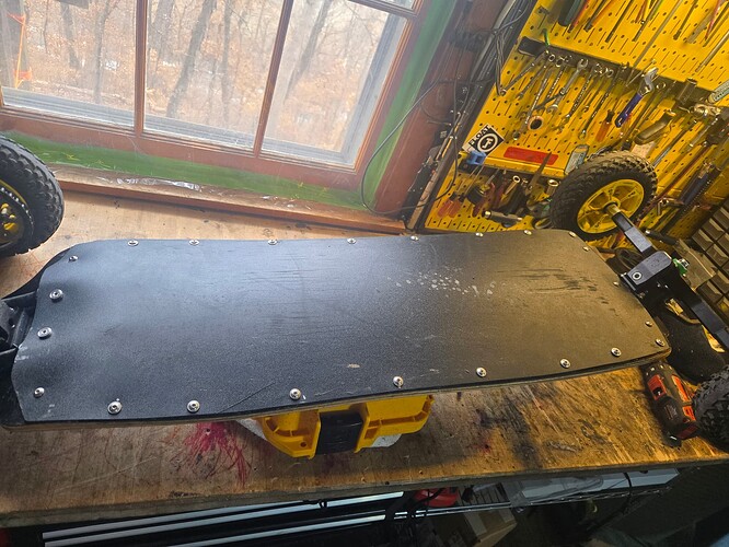

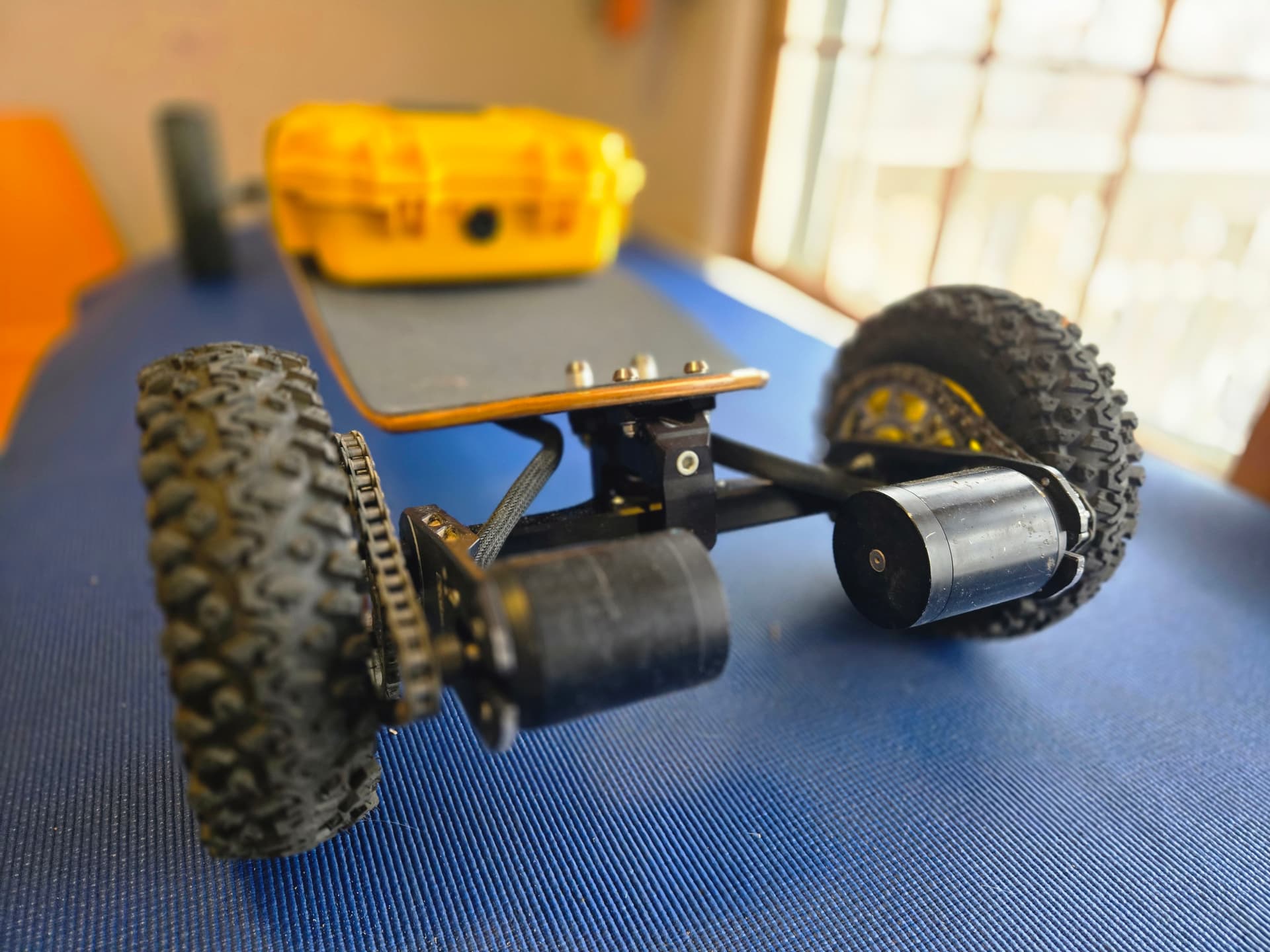

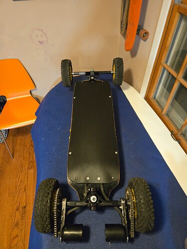

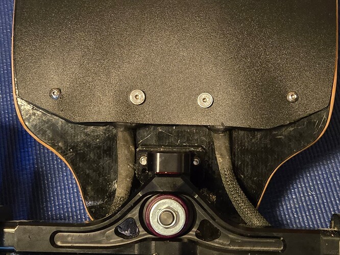

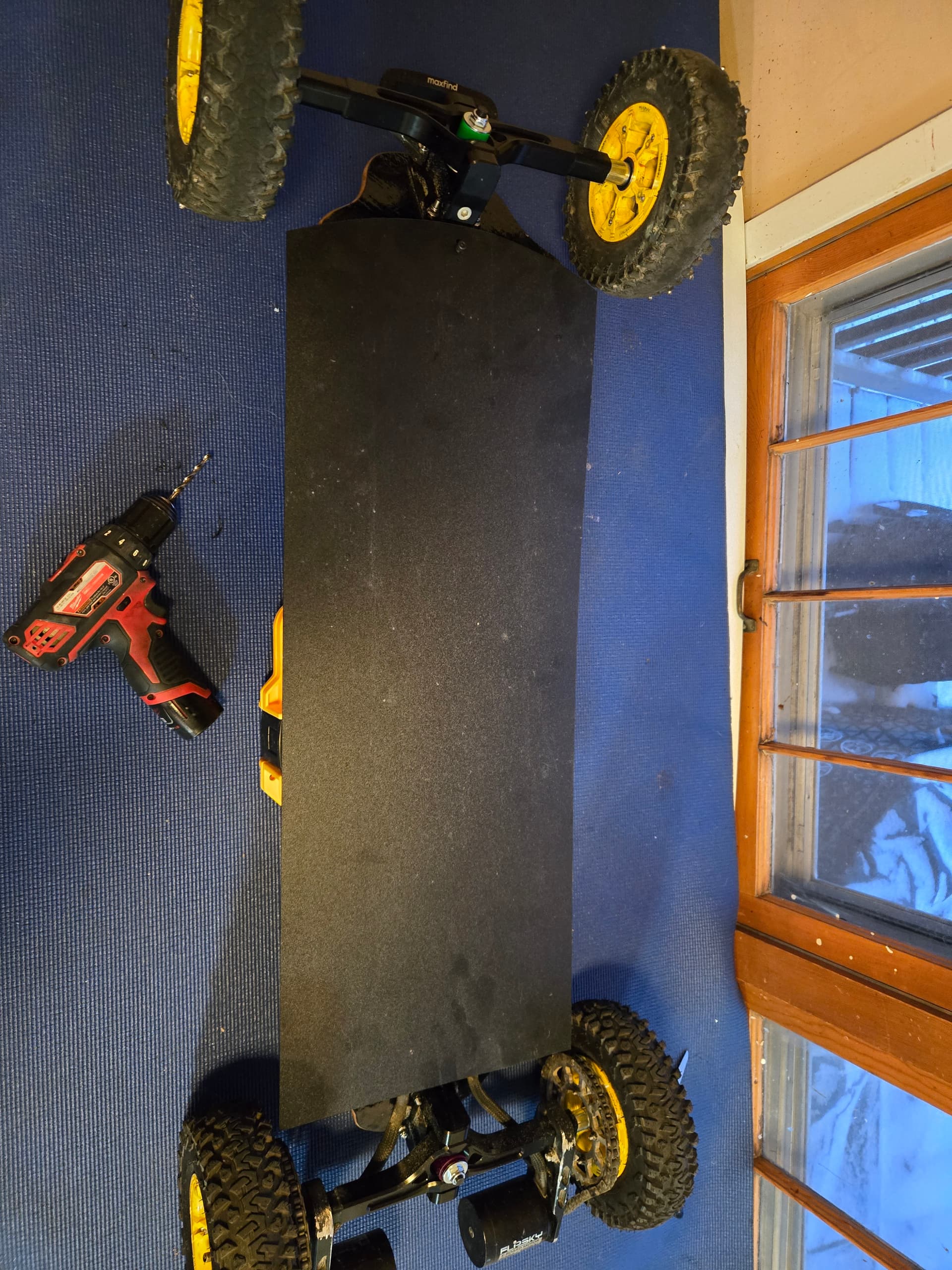

Finishing up the A-A-Flux took a weird detour.
This has got to be one of the most DIY is a disease moment I’ve had here.

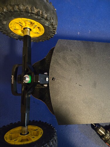

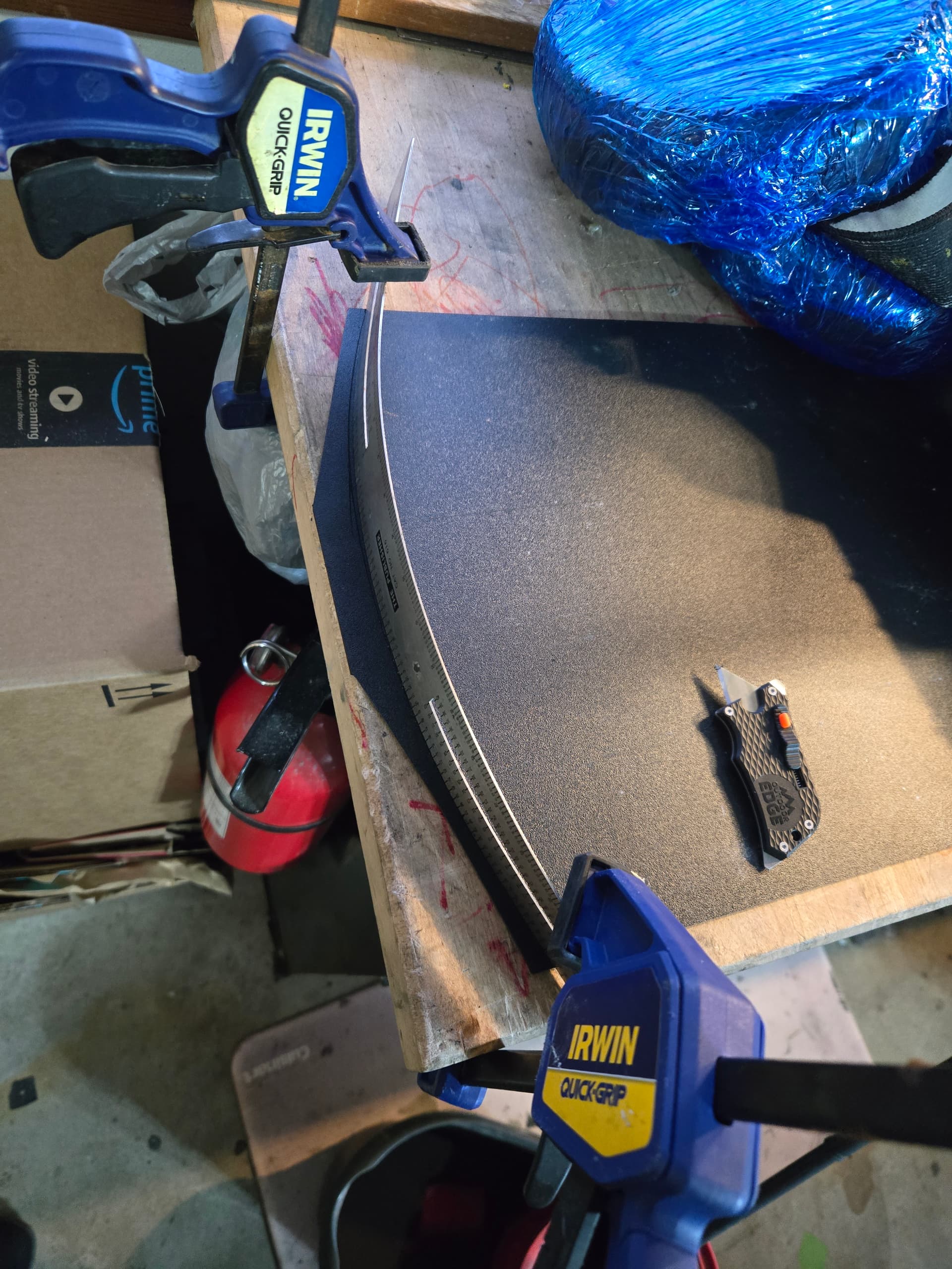

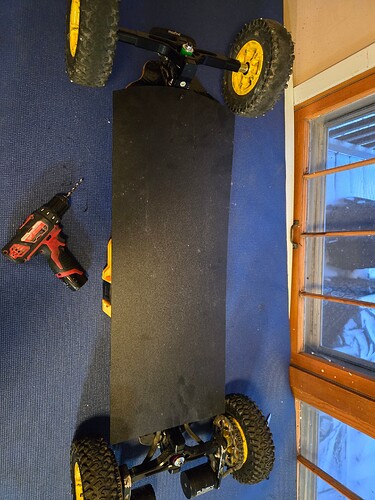

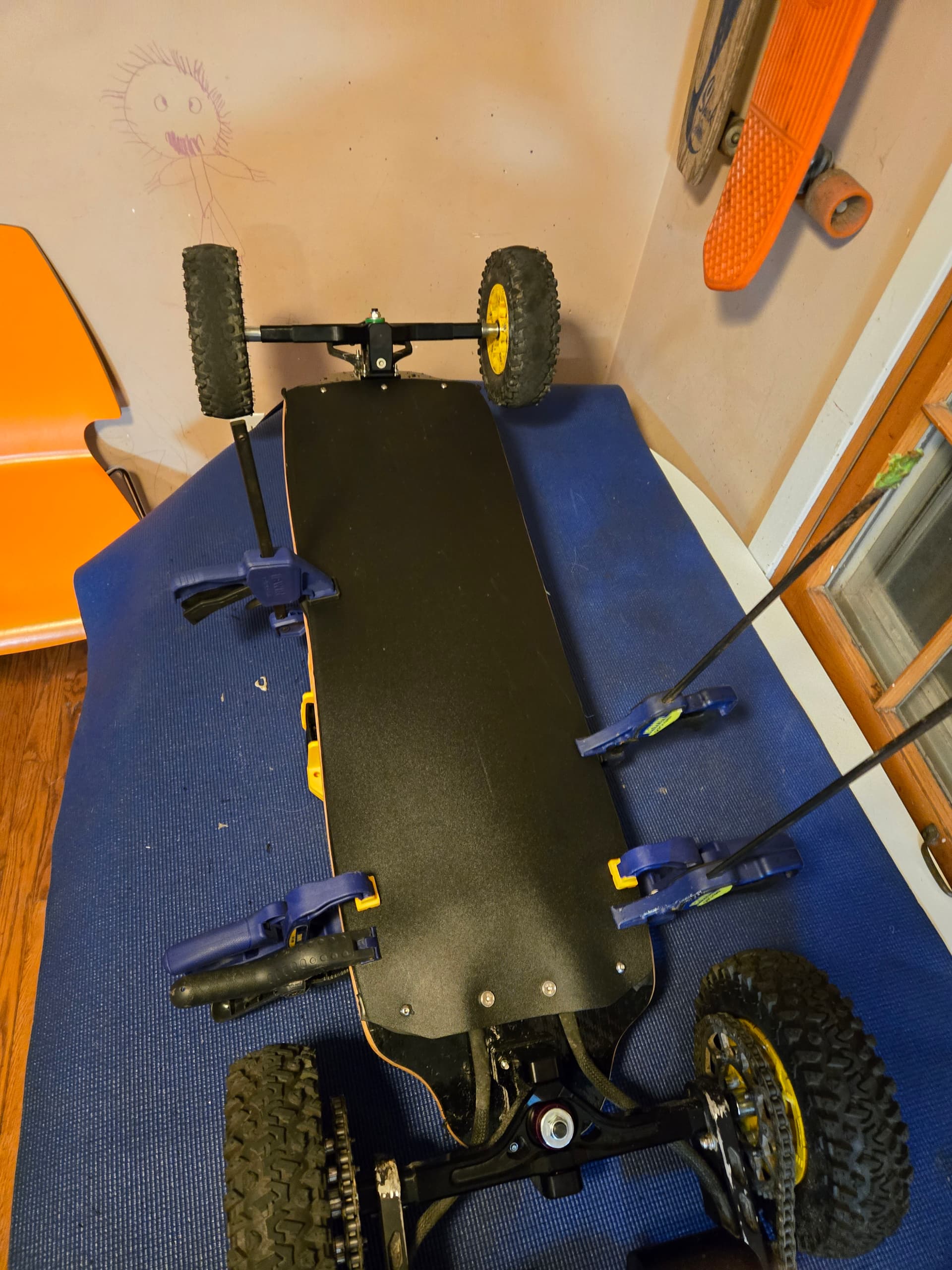

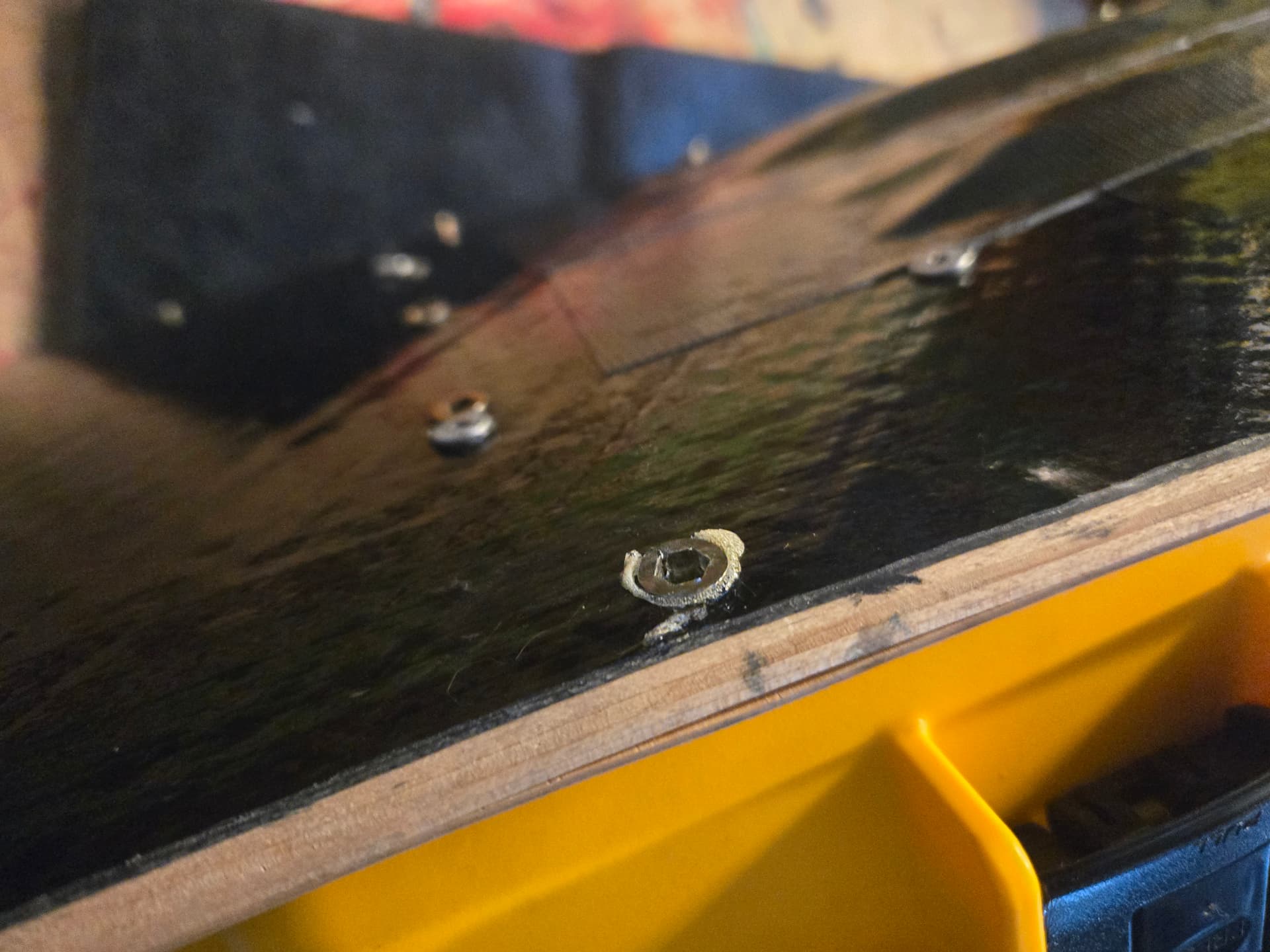

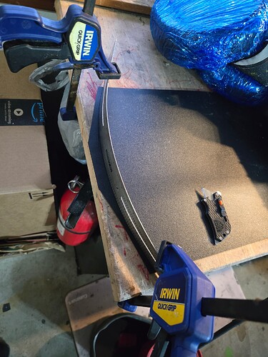

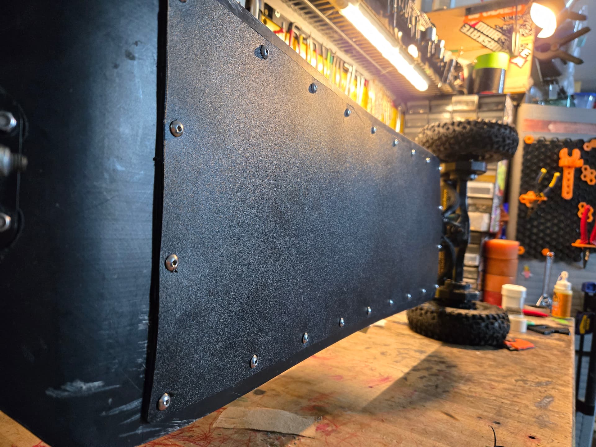

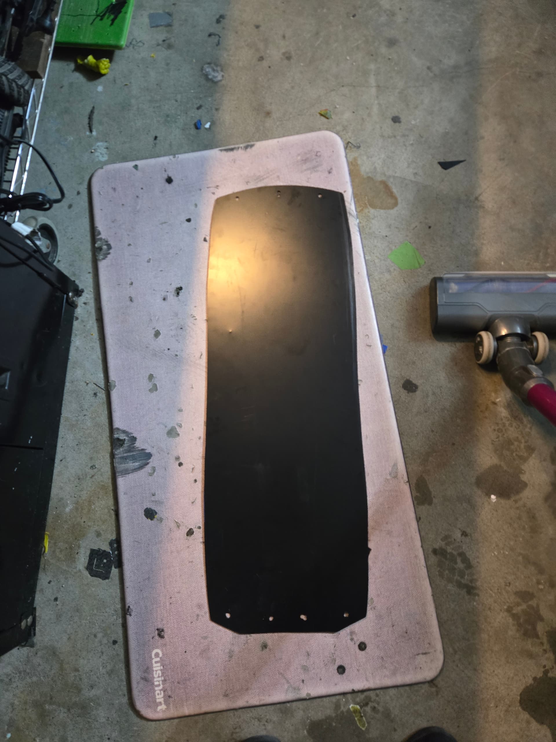

All I wanted to do was put an ABS sheet on the bottom to protect the cables.
All I was going to do was the exact same thing I just did on the gravel flux and use the existing inserts to bolt the ABS sheet down to.
It was nice.
I had just done it.
Seems simple enough.

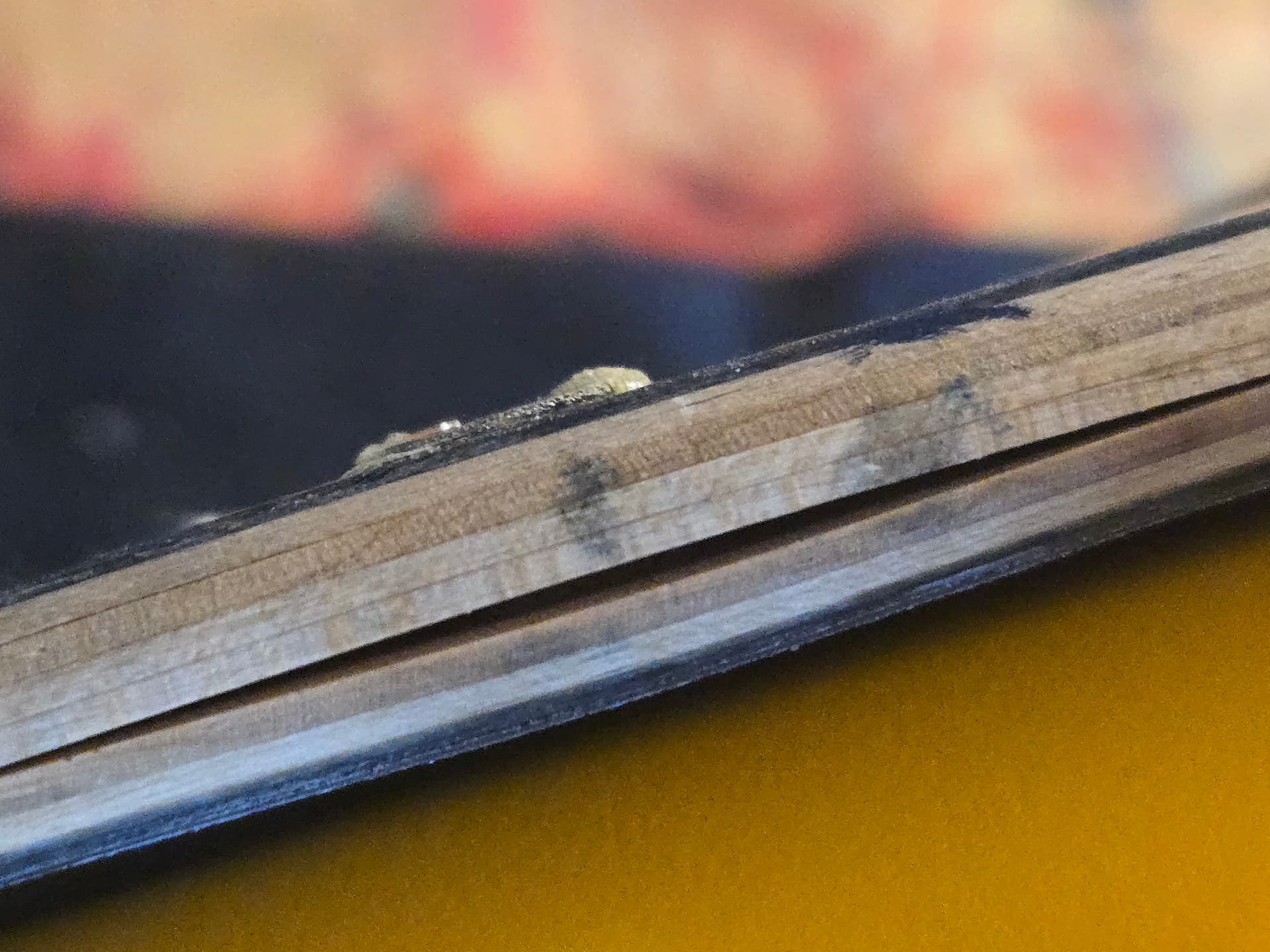

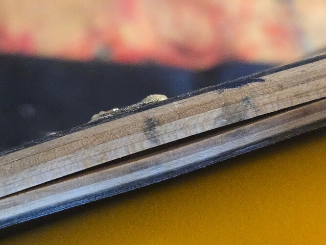

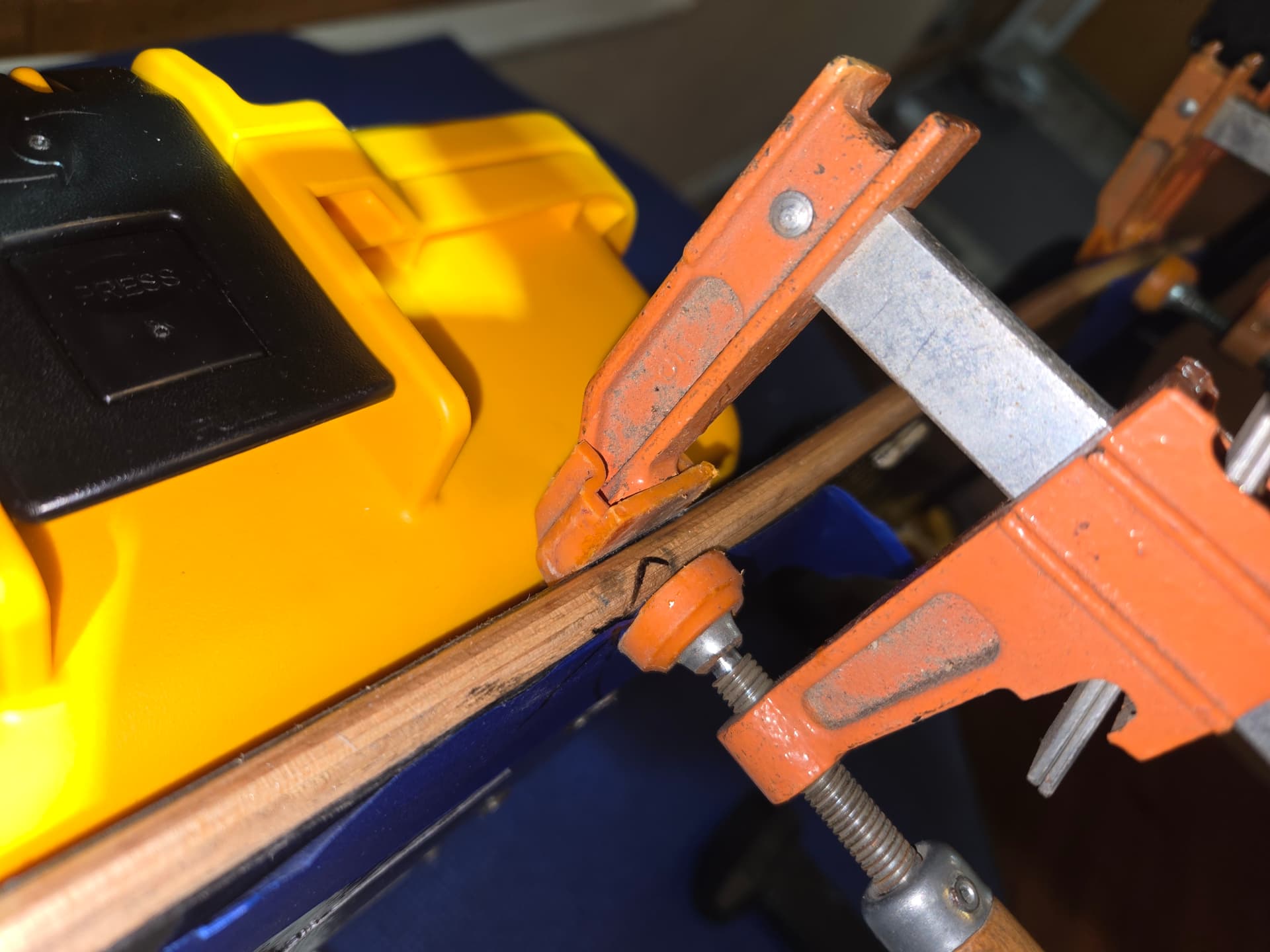

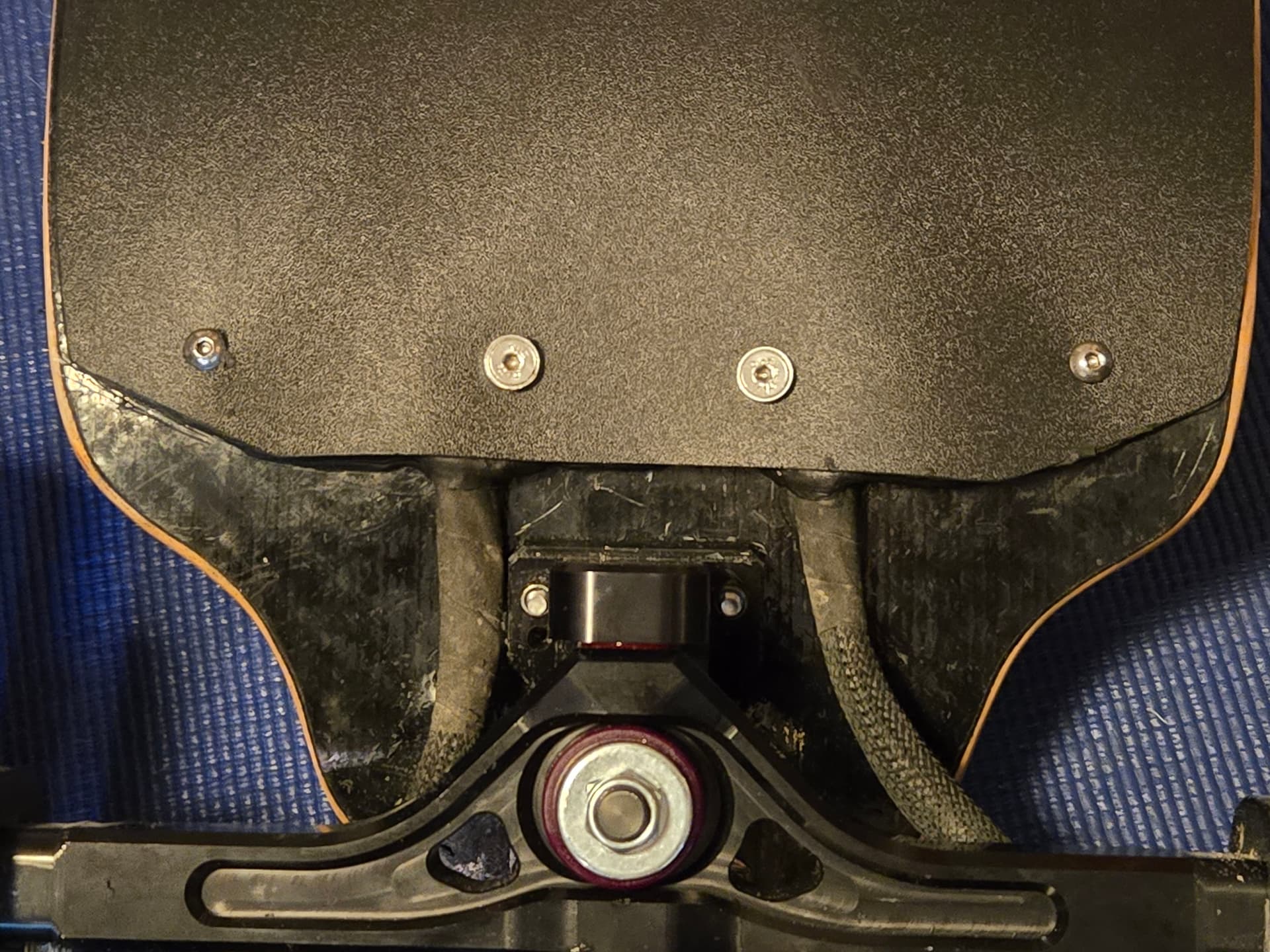

Well the lacroix deck had insert holes but no inserts.
I tried one of my inserts and it was a perfect fit.
So I decided to just send it and put those inserts all around.
These are obviously not the inserts they use because on the side most of the holes were too shallow and I managed to actually split the deck open and several places.
Are you fucking kidding me.
Seriously.
I didn’t even notice for days either.
Soooo. Yeah.
I had to back out the inserts and epoxy the deck back together…
I bet no one would have called that one…

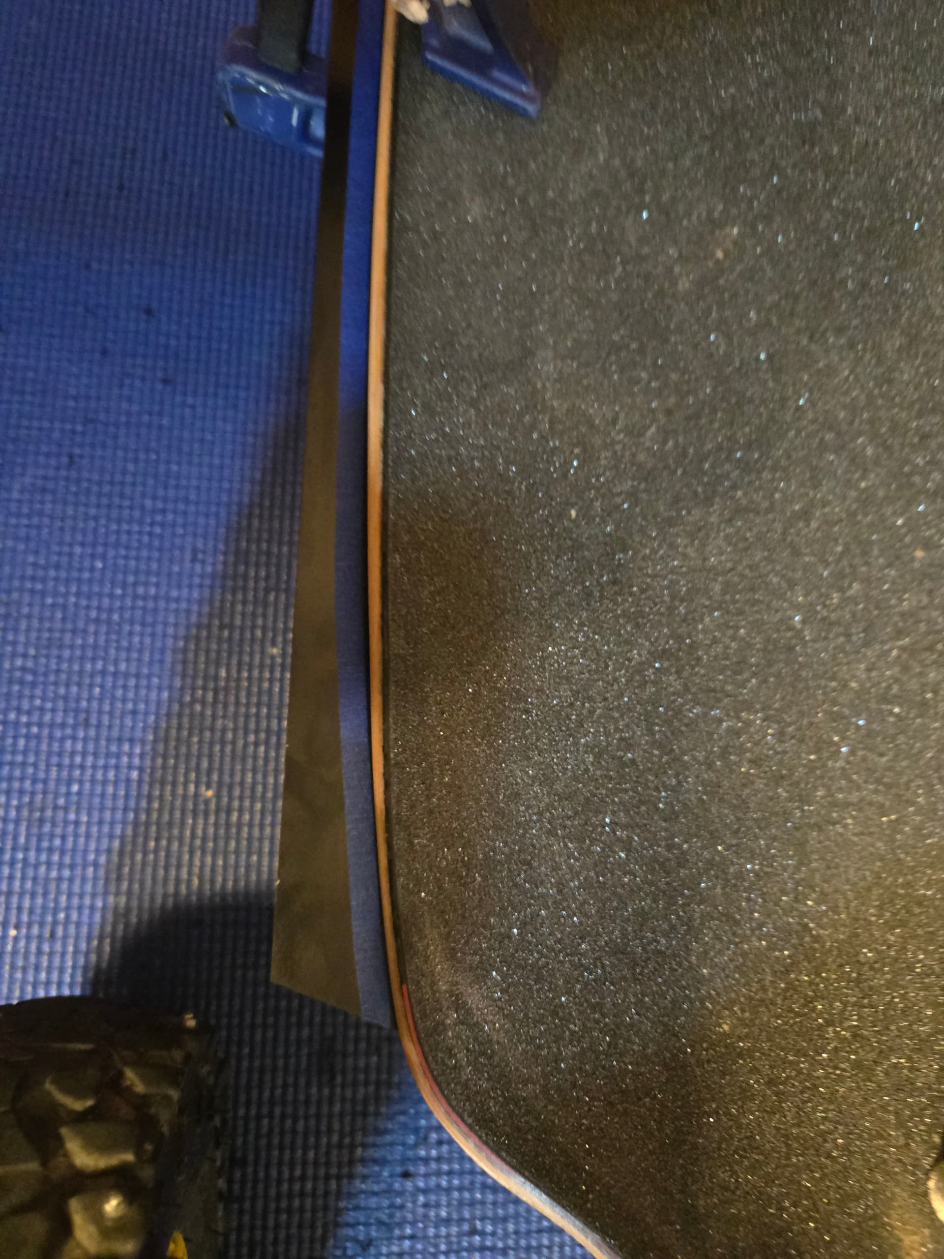

Then I got to sand and stain the side which is kind of nice.

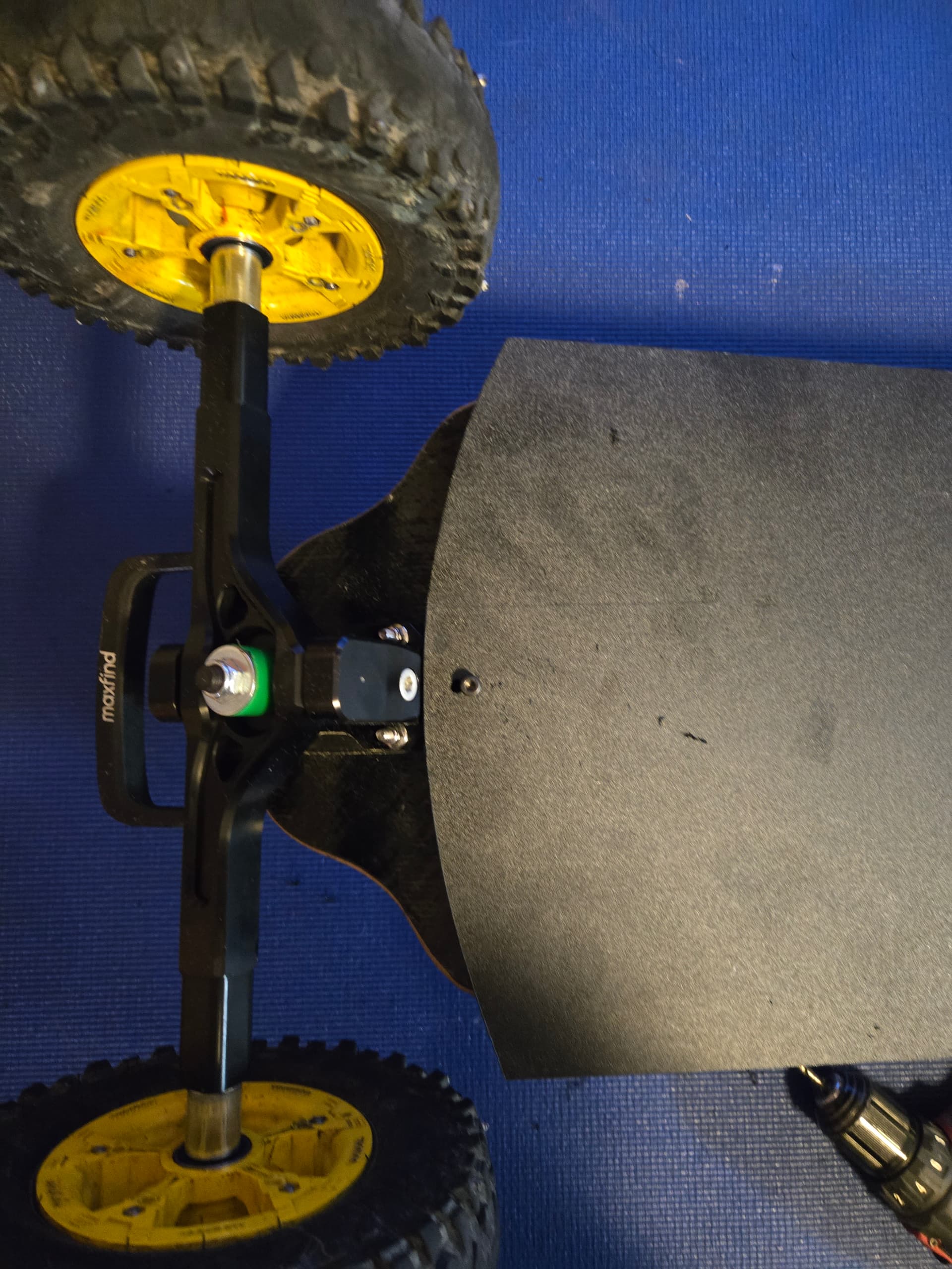

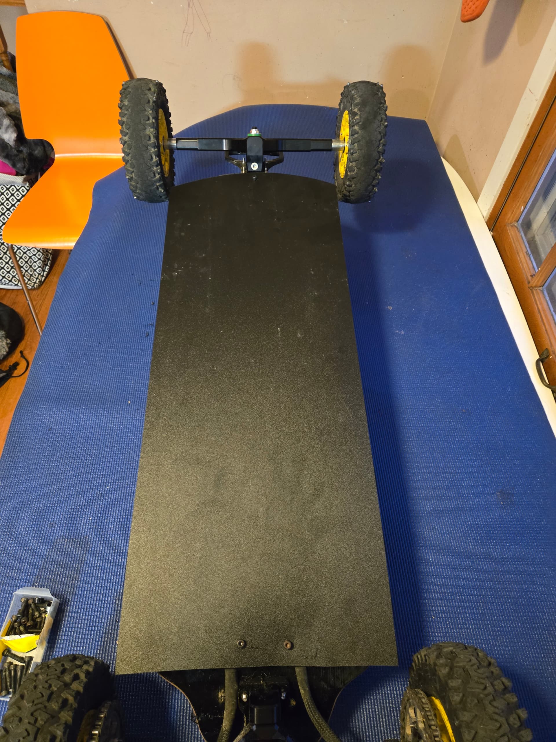

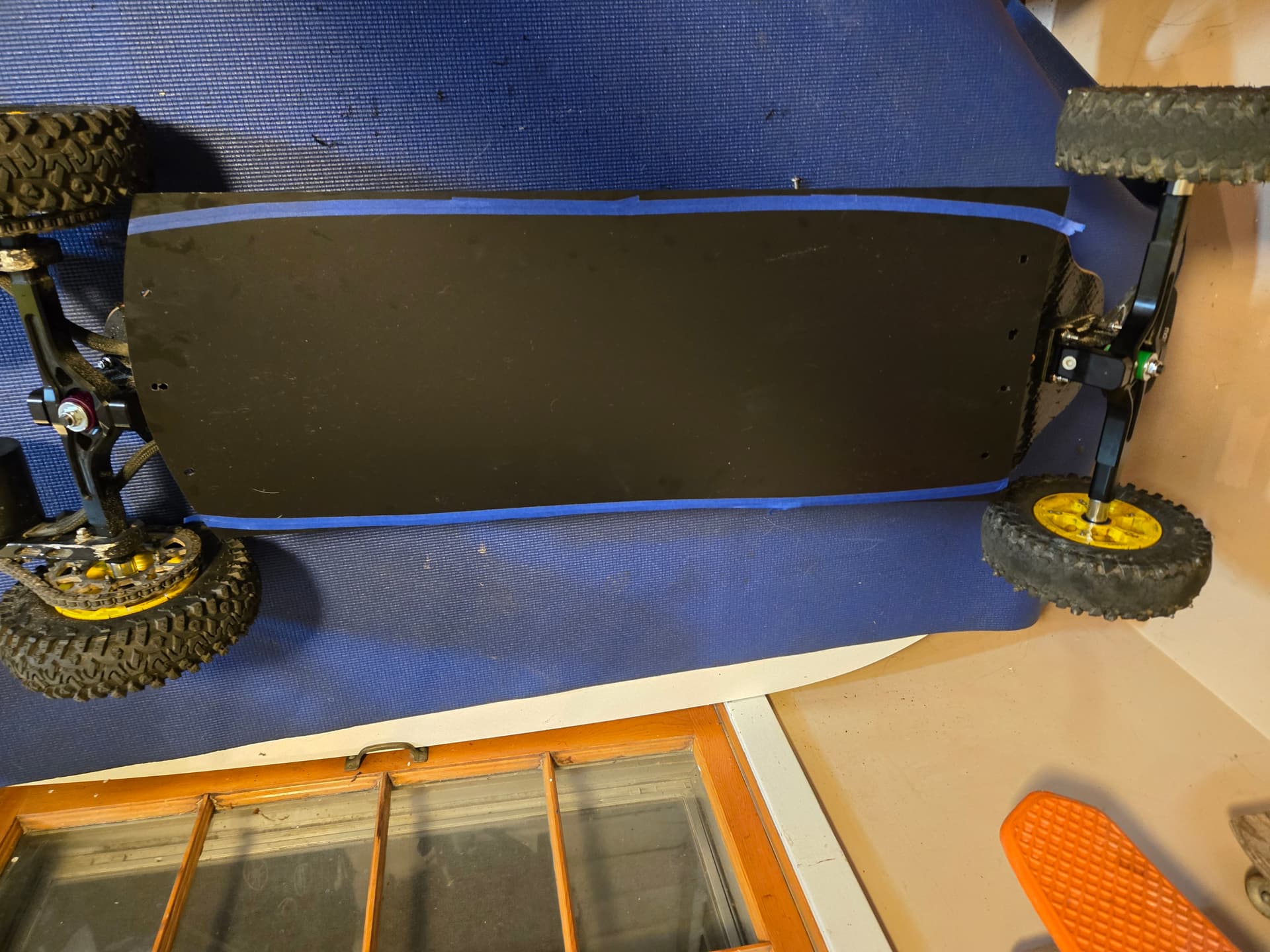

So after a ton of extra work, I was back to the original point where I just needed to put an ABS sheet on the bottom to protect the cables.
Not using the inserts on the side actually made this easier.
I just signed up the bolts on the top and the bottom.
Then I flipped it over and over and marked itwith tape.
And ended up with the general shape.

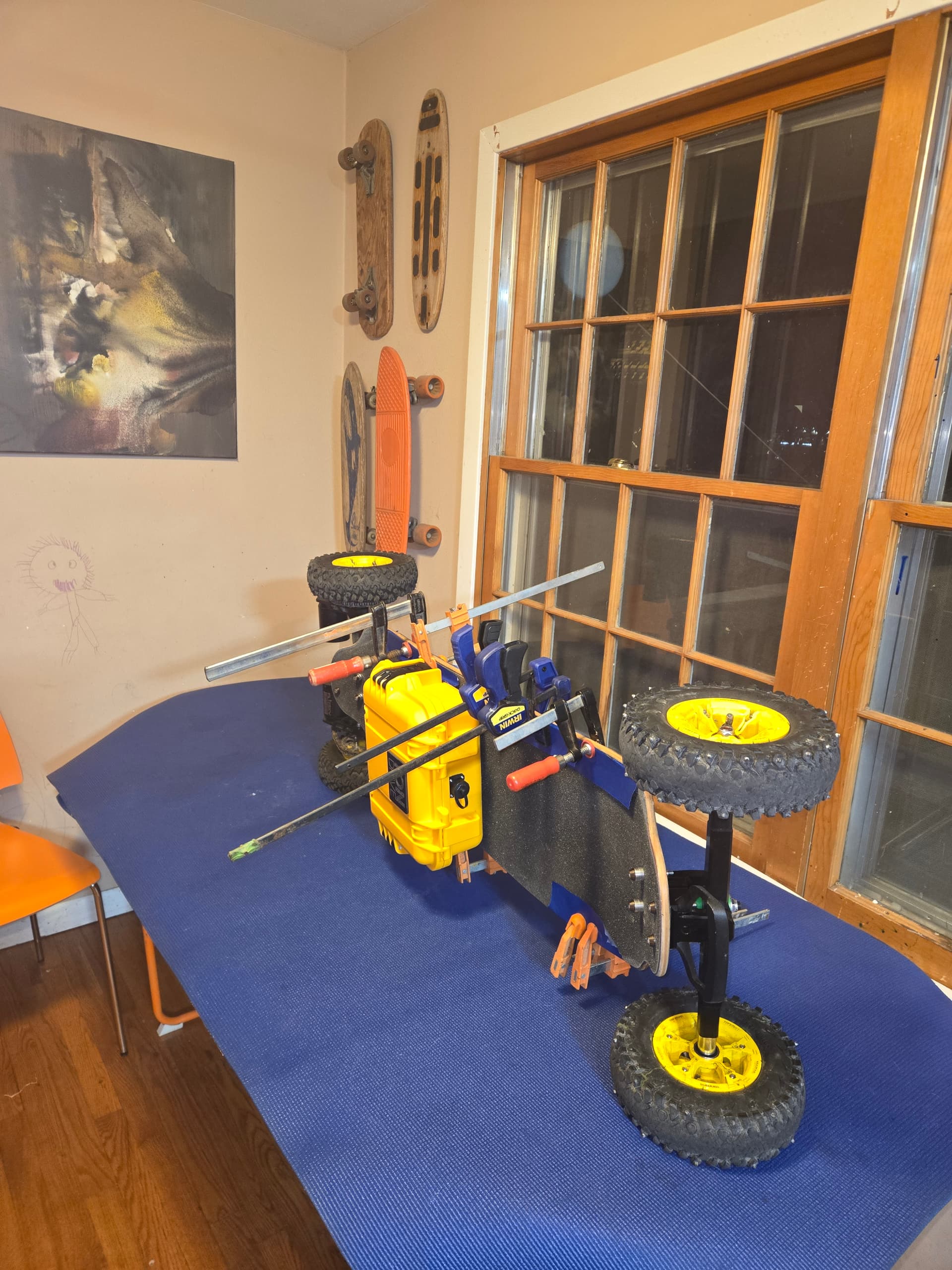

Then it was time for the butyl tape to do its magic.
Then I laid it on I clamord the butyl down and started bolting the top and the bottom.
That day I only had 4 of the self tapping screws…
I got more and put them everywhere.
I actually ordered some different wood screws from Amazon to put on here because these have hex heads that stick out too much.

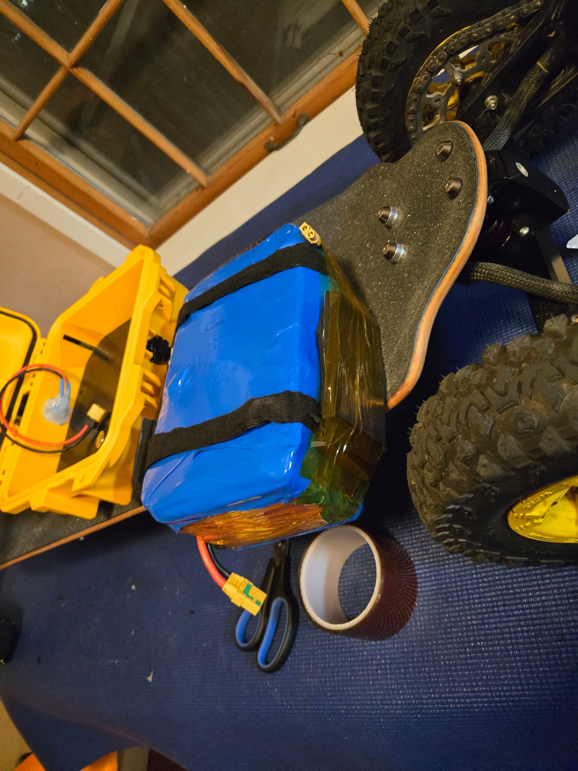

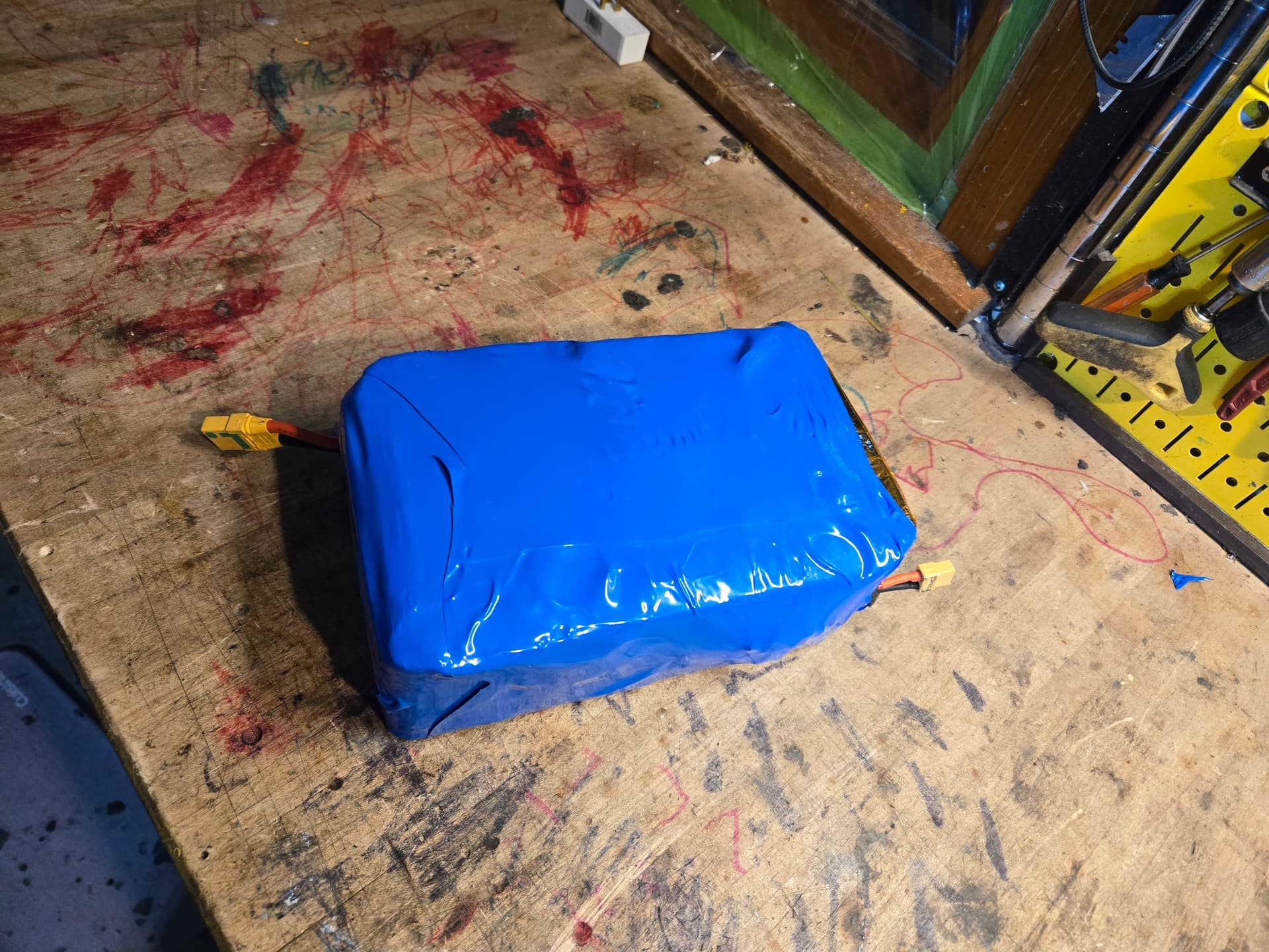

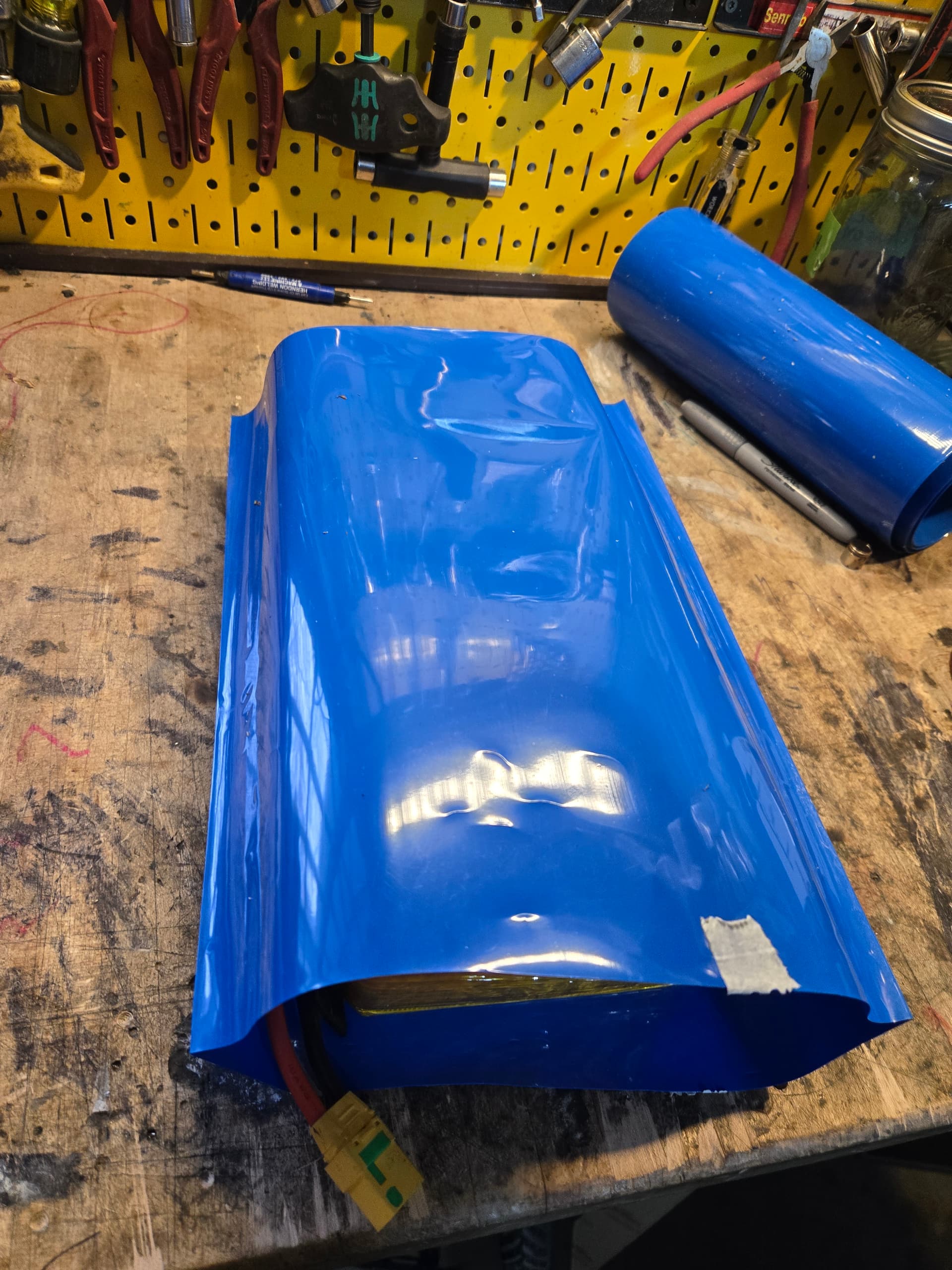

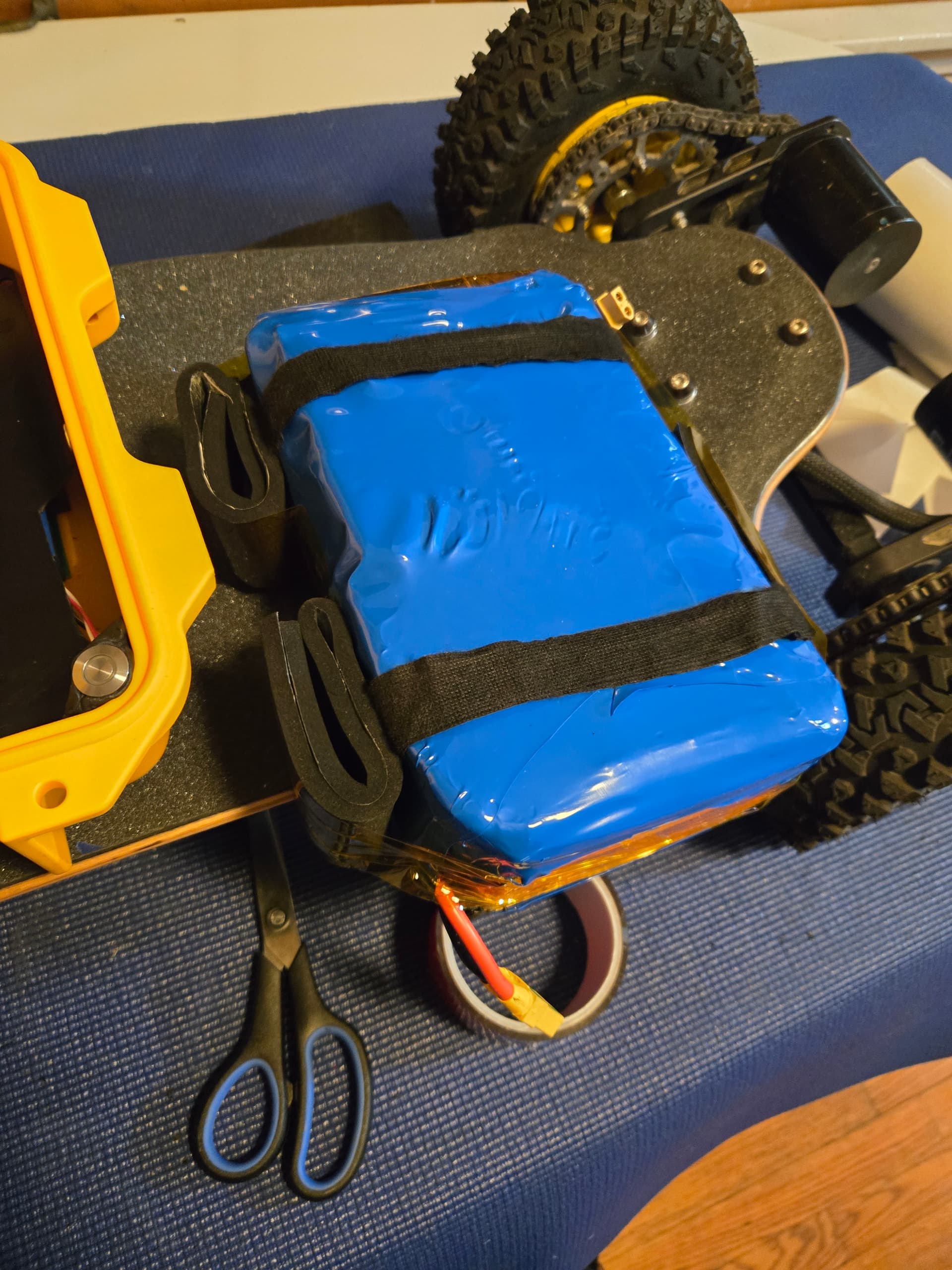

And for the final touches on the AaFlux (I will eventually settle on a name/nickname)
I wanted to redo shrink wrap on the battery. And tape some bumpers to it, to keep it in place in the box.

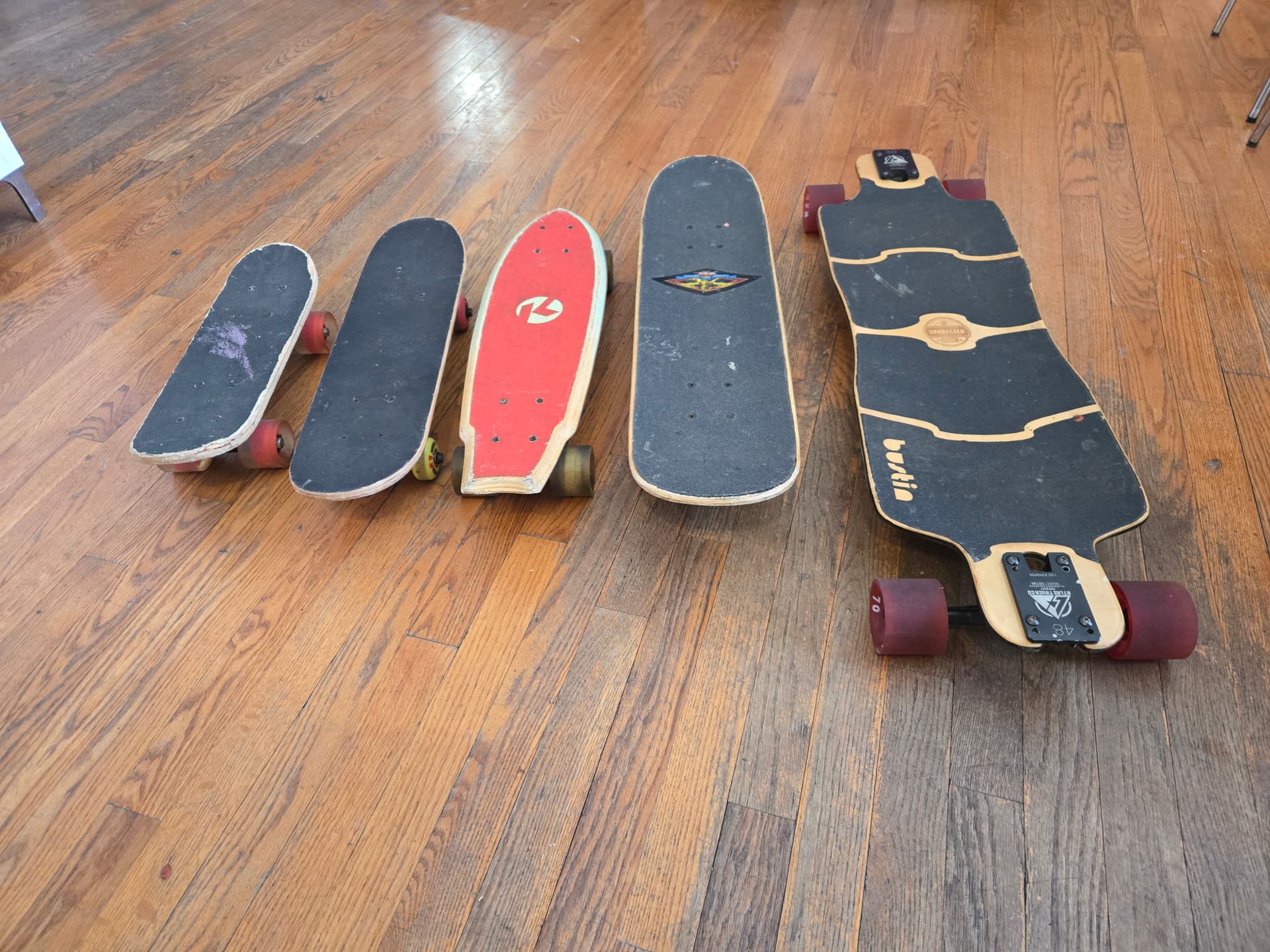

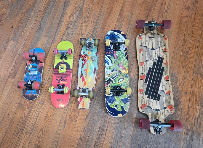

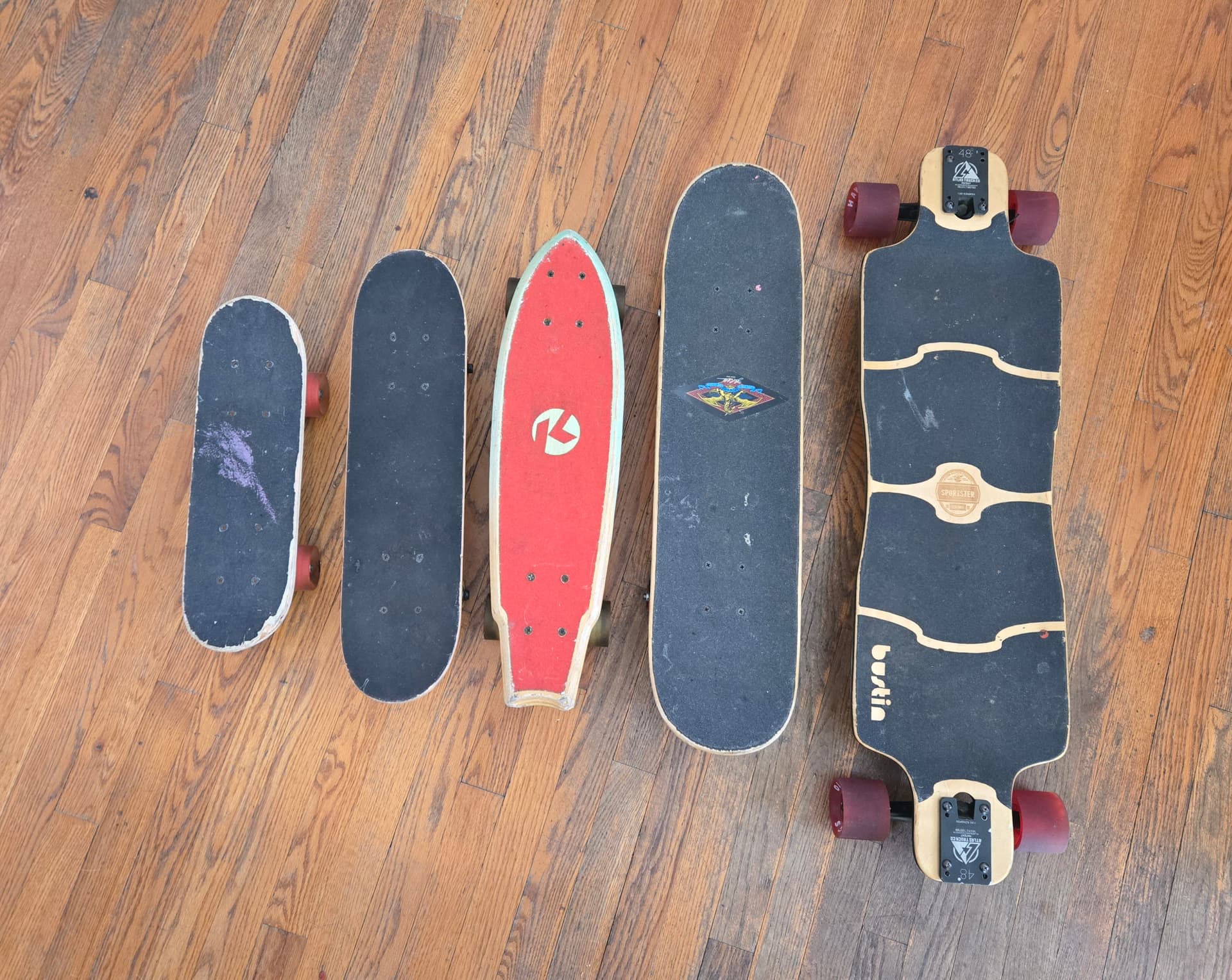

Might seem like an odd question but did you get her something you would want to ride?
I find a lot of parents buying a skateboard or a penny board for their kids which is usually better optimized for other things. Buying a solid quality longboard that YOU like does 2 things
1: makes it easier and more appealing for your kid to try just riding.
2: even if they don’t use it, you have a nice new longboard.
Didn’t think of it that way. No, I got her a shitty board from Big 5. Might have to try that out and get her a longboard.
I have all kinds of analog setups around the house, and lots of kids boards.
Finding something that’s the right size and actually turns is a big deal.
And the turning parts hard to do because most of the trucks on these toy boards are hot garbage…
And something else to consider and this is easy for us because our house is already destroyed.
But there it’s always a skateboard around inside the house that they can stand on, or onewheel these days.
So the access is always there. It might be close to a railing and they’ll just jump on and play around and become more comfortable with it.

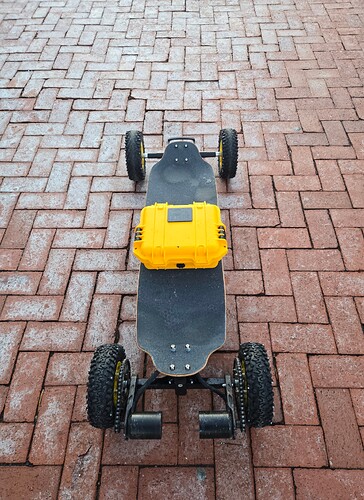

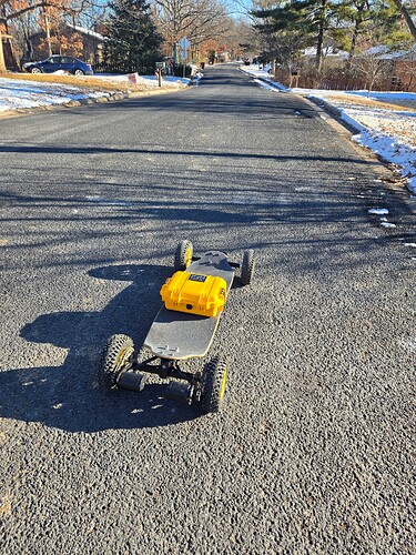

It’s was Saturday February 22nd.
And yesterday we got above freezing after an entire week of winter hellscape!!!

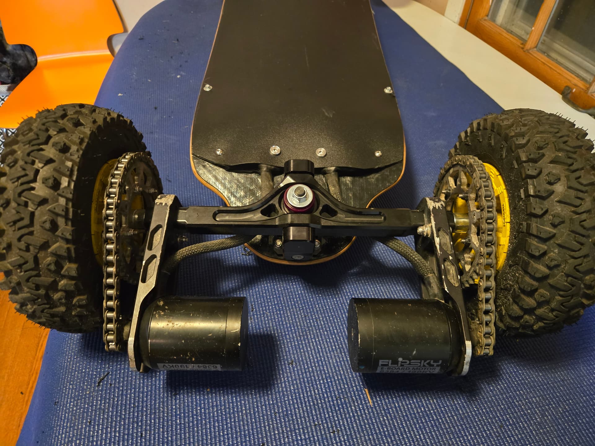

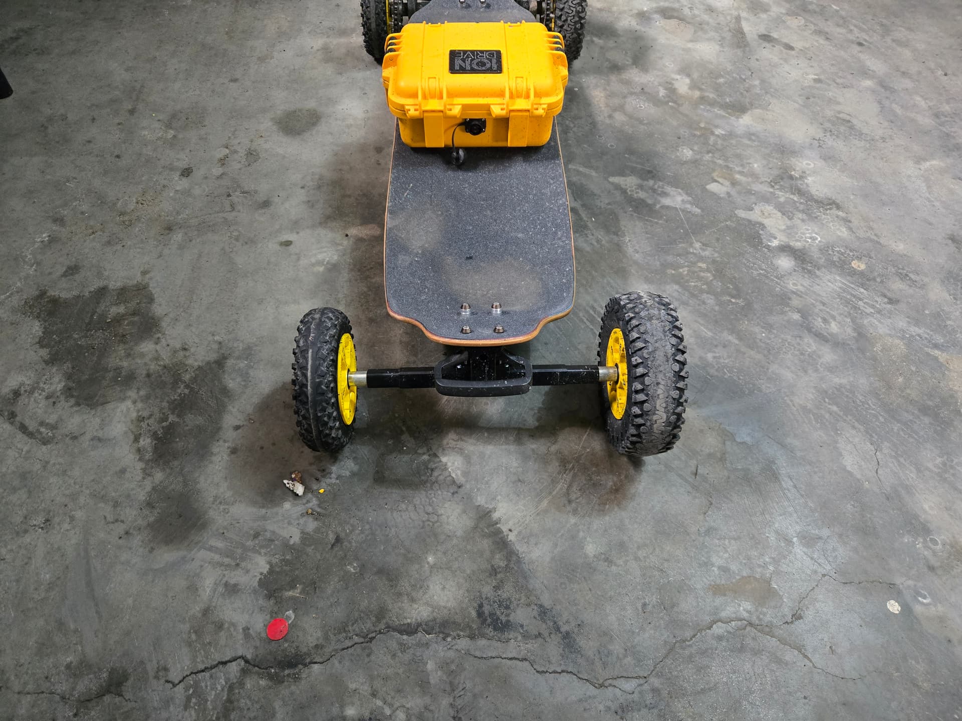

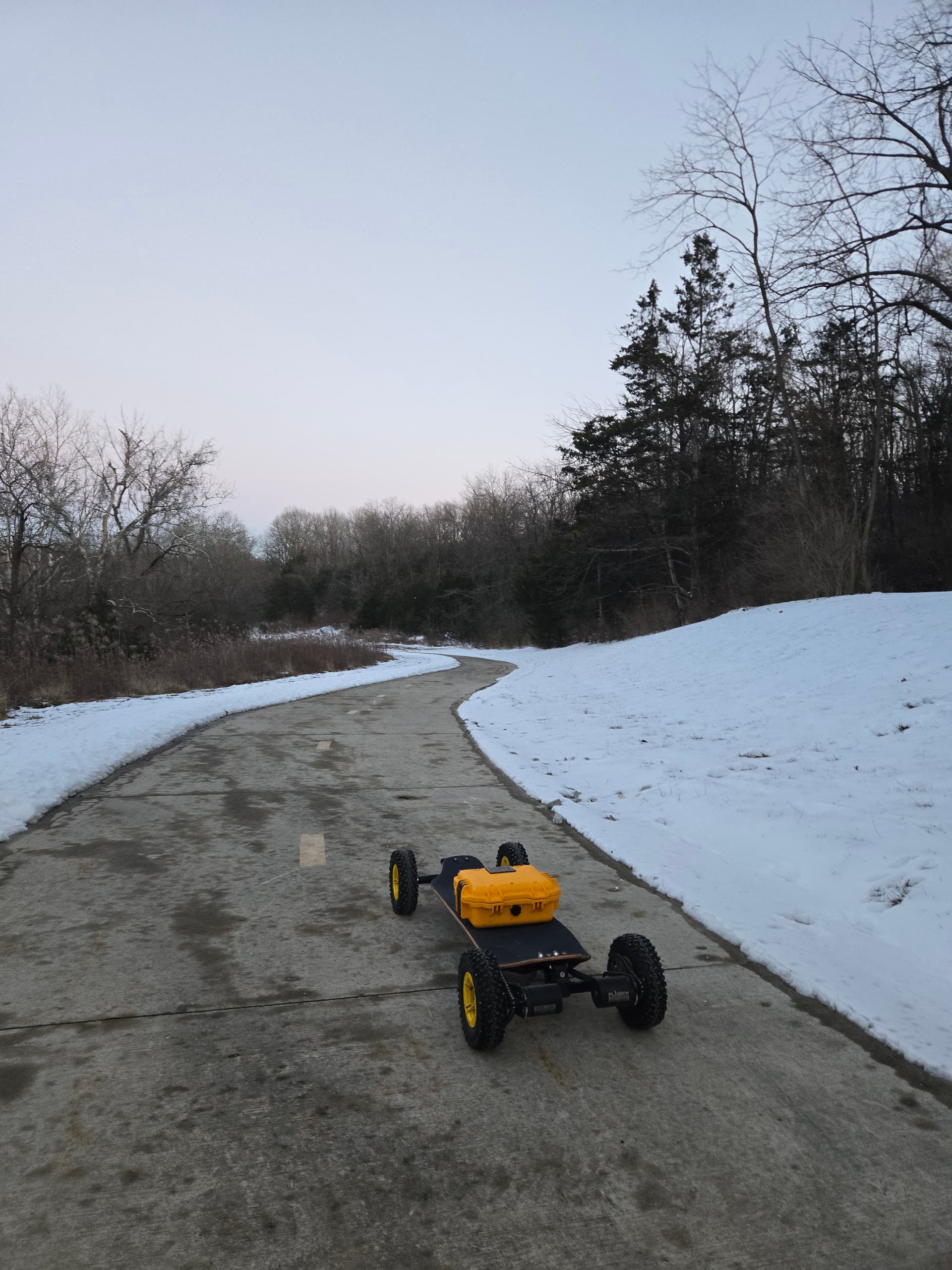

I went on a 7.5 miles ride on the Almost a Flux, and it was glorious.
I feel like I had not gone on a real ride outside of the neighborhood in so long.
I am really stoked on this setup. It turned out really good. The deck is nice, The trucks are magical, The chains work great. Pumped.
I had never gone down these to stairs on esk8 before.
With the chains I don’t really have to worry about damaging gear drive so it’s cool.
I did have to bottom out and kind of slide through the first step.
The cold might be gone but the salt is going to be here for a while.
It was so good getting out.
I love electric skateboards!!!

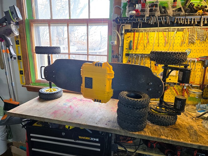

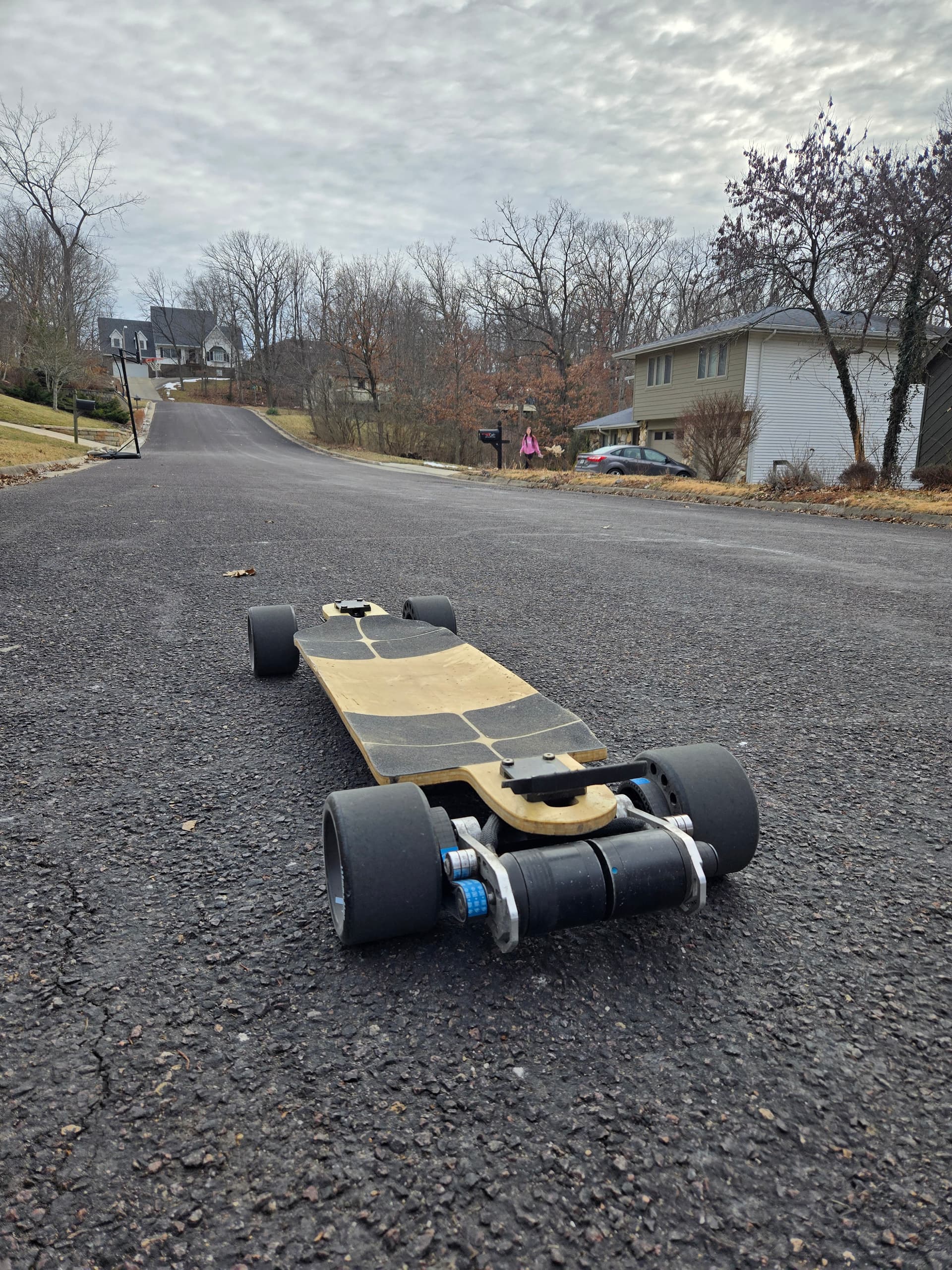

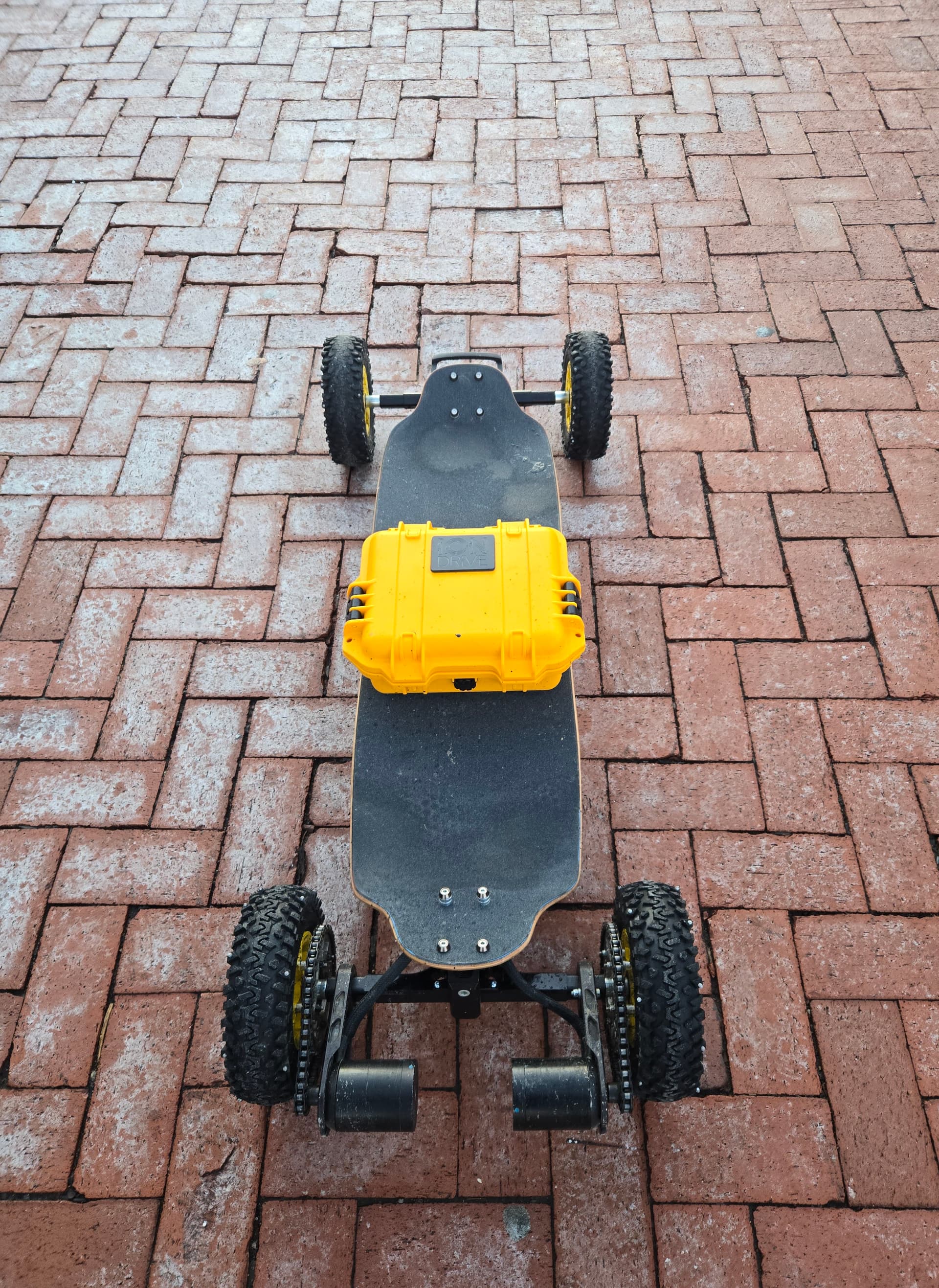

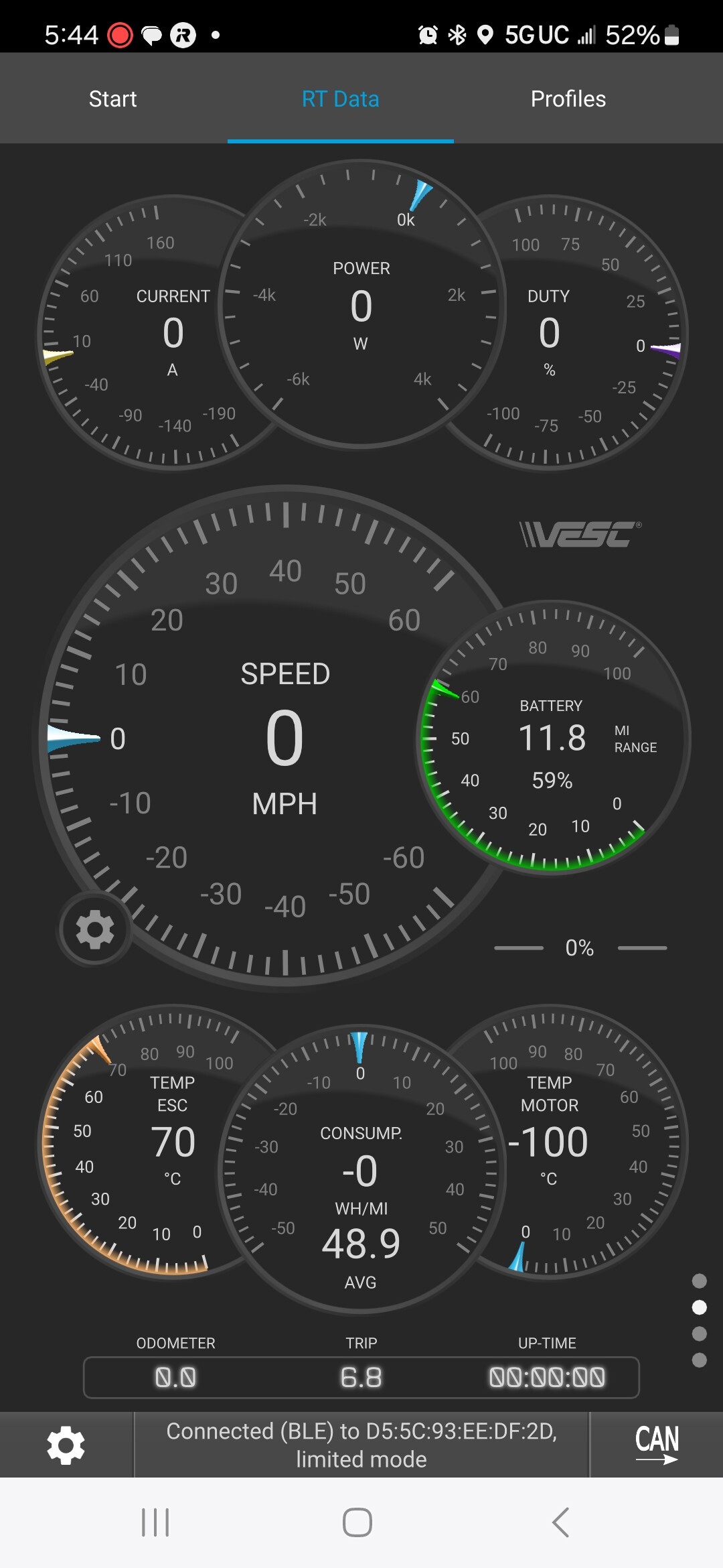

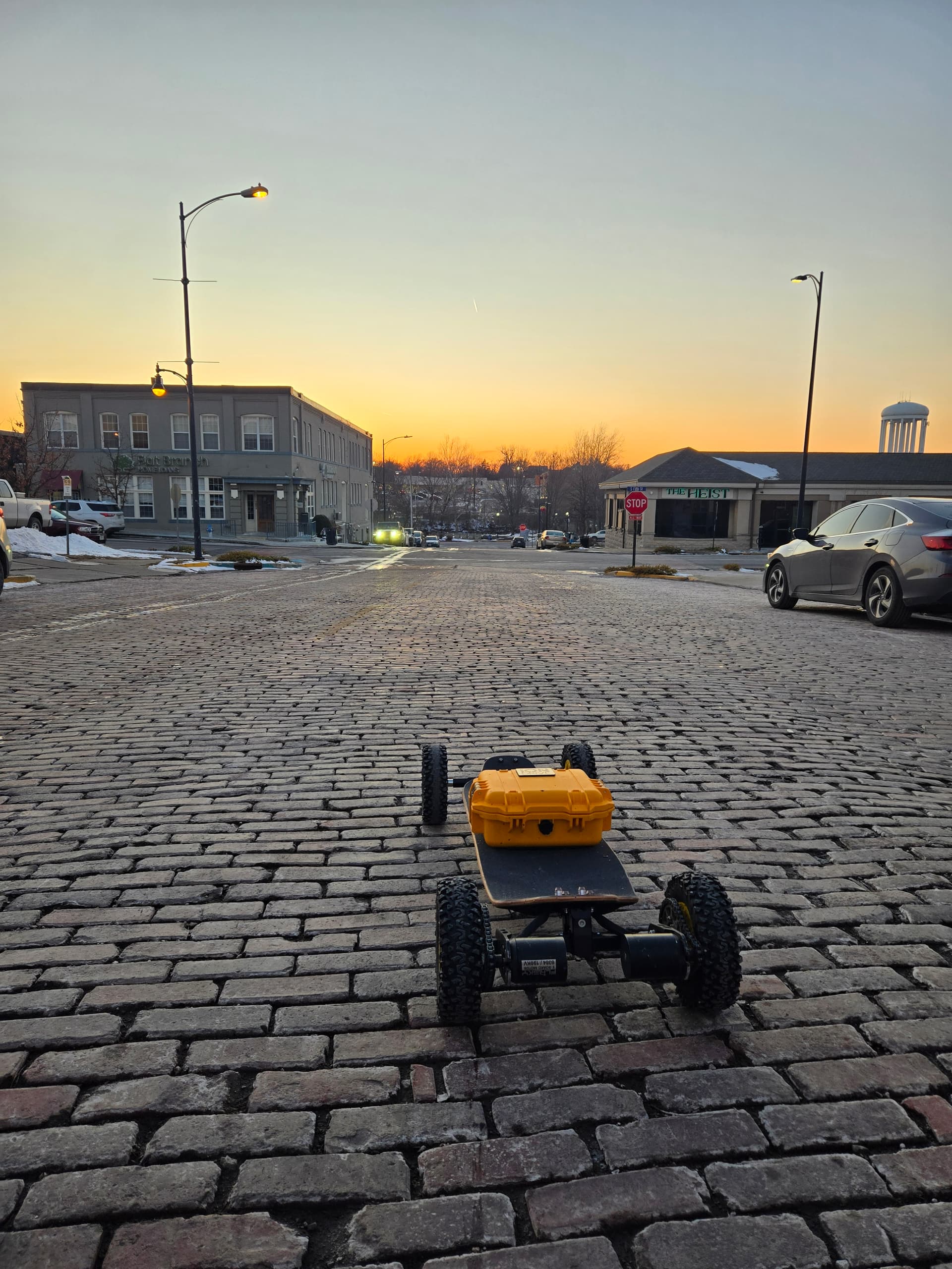

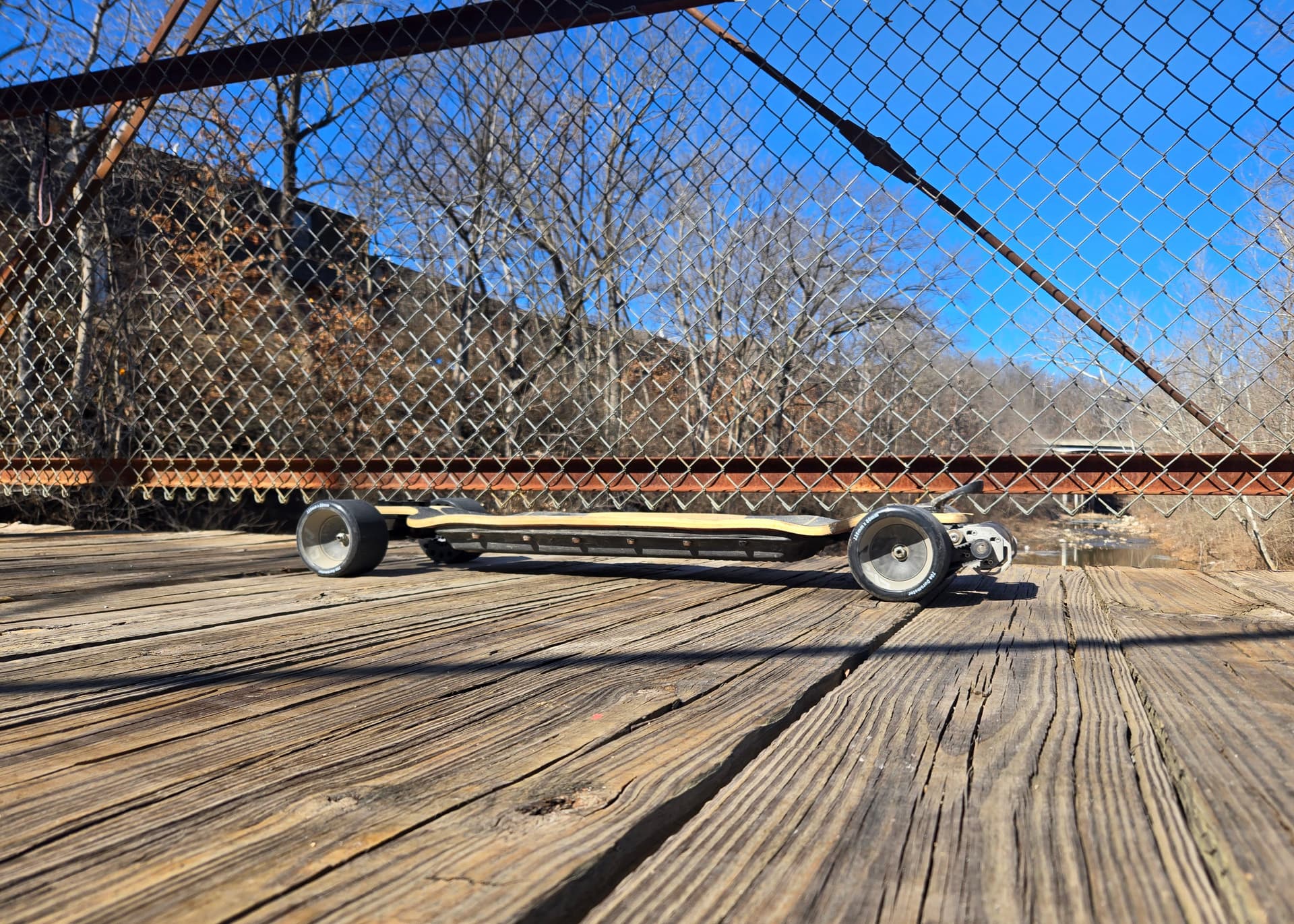

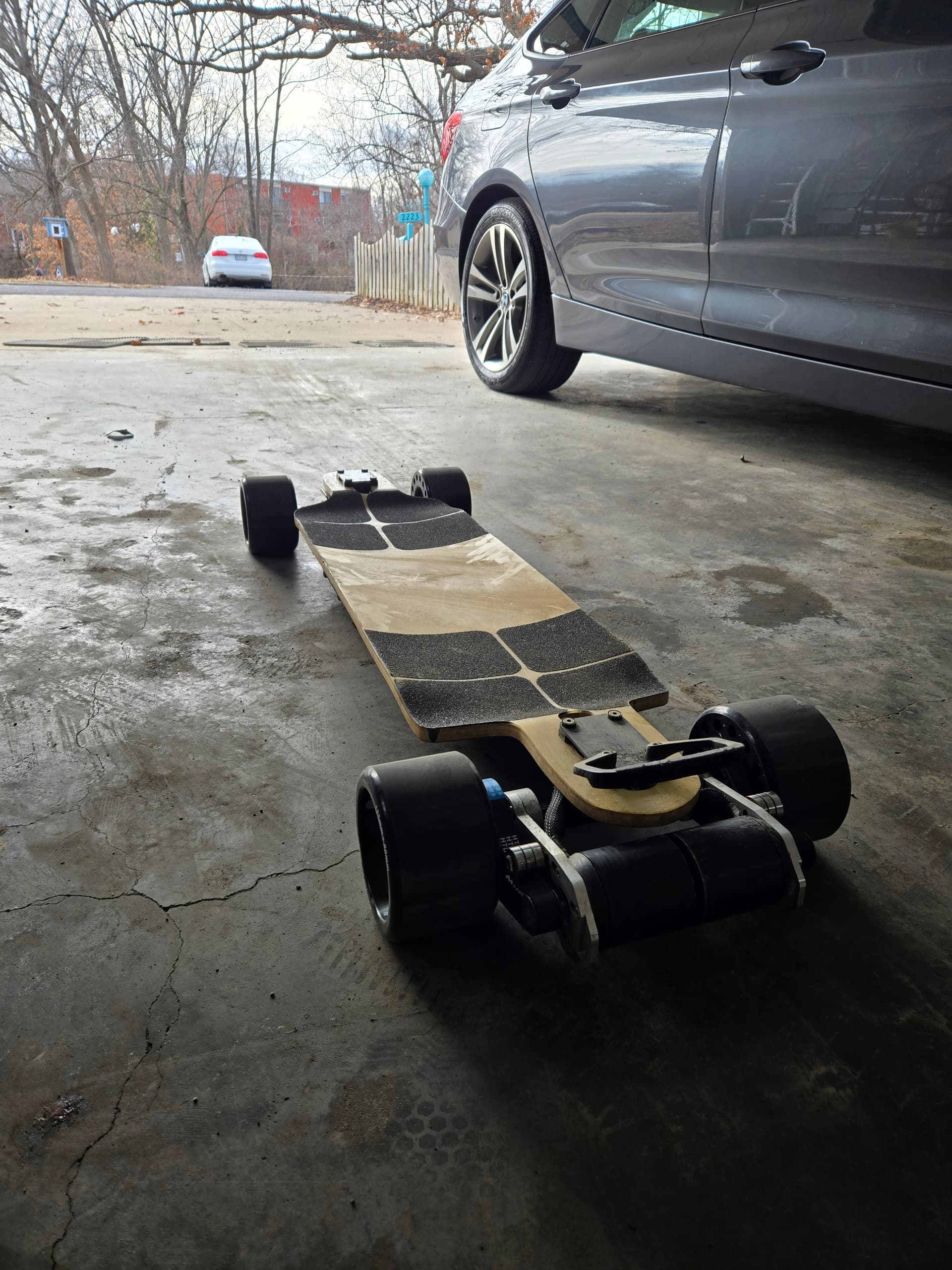

But I start getting soggy performance from hitting 80c on the Unity.
Turns out the gearing here is no good for 9 inch tires…
Torque felt fine… So I did not really notice.
But after putting my info in the Calculator I realized I had fucked up.
Why I didn’t check the calculator before is a total mystery.
So something has to happen to this board already…

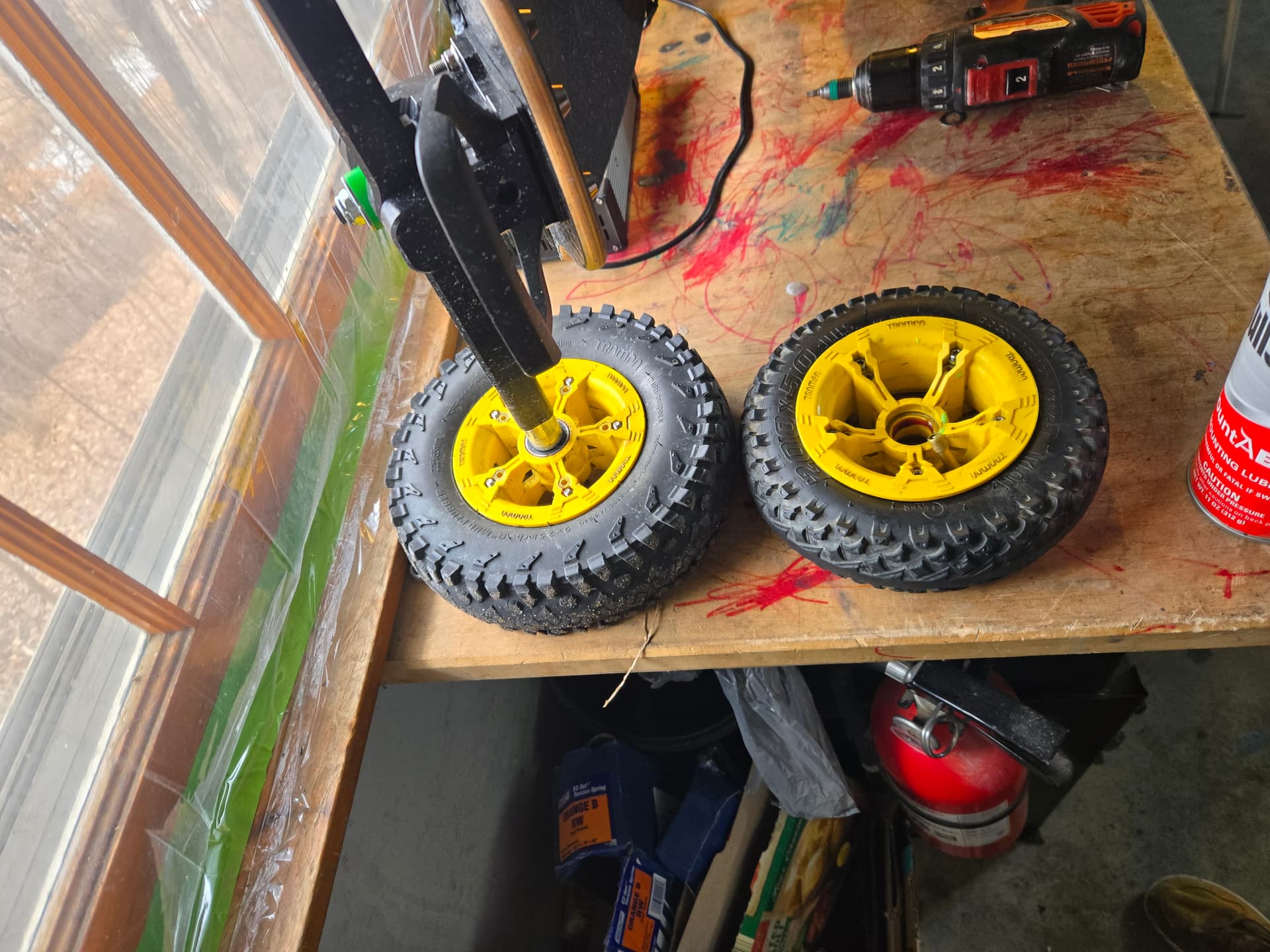

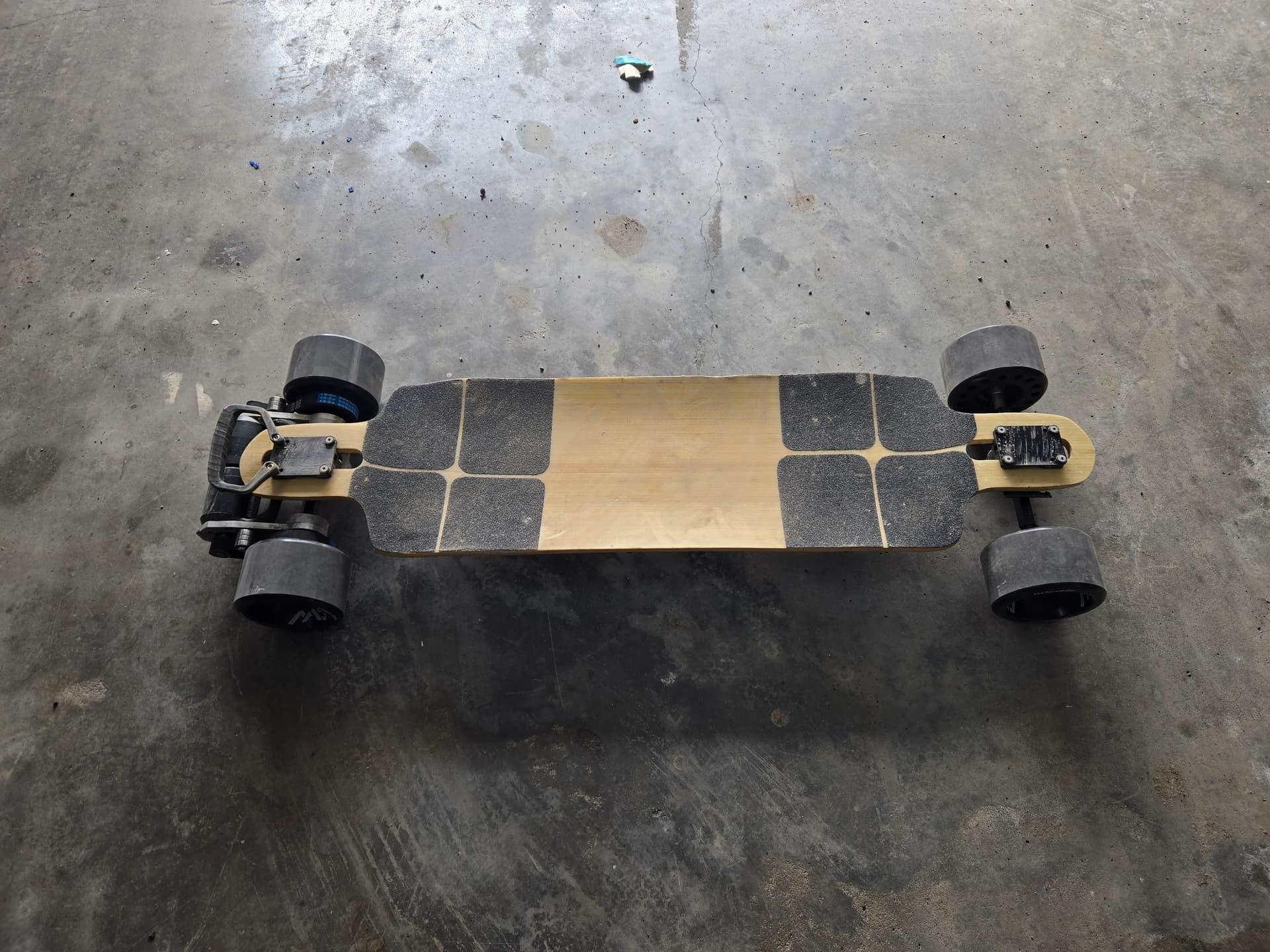

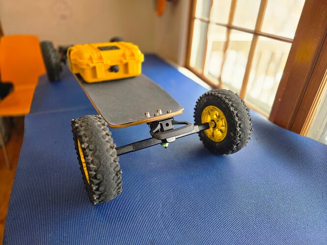

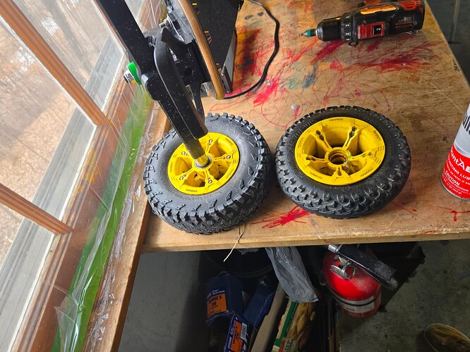

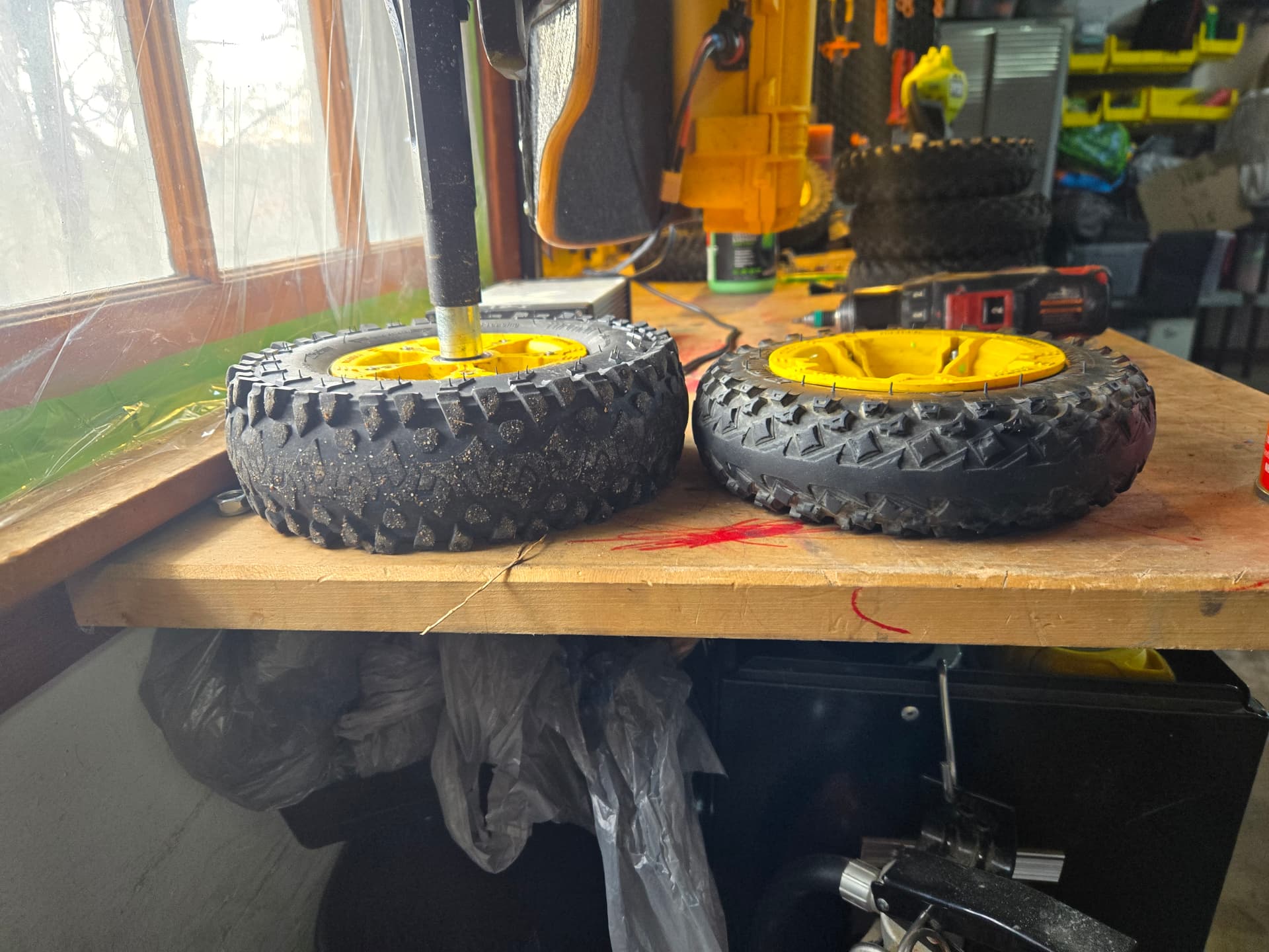

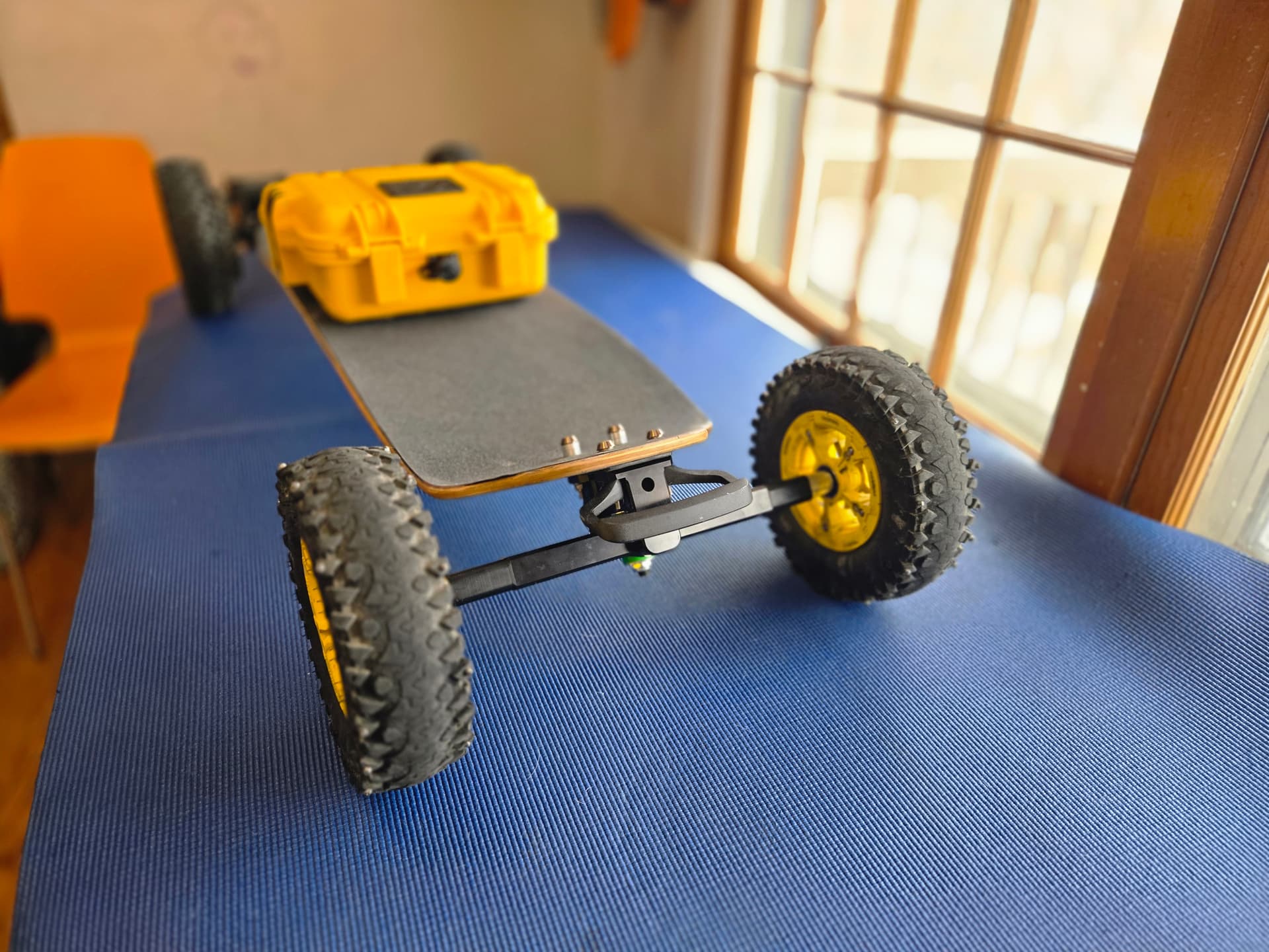

Since my first little ride on this board I was curious about putting on 8-in tires.
It’s hard for me not to gravitate towards a lower setup…
Closer to the ground just feels good.
So I decided to slap to 8 in hobbies on here.
They are a really stark difference from the nine inch mud pluggers
And they look funny in these hubs.
I ordered a new wider 200x70 tires from MBS and they will be here soon.
I am totally annoyed with the look with the little skinny tires.
Put the ride feels totally nice.
I’m sure I’ll be happier with the look and with the MBS tires.
@Evwan LaCroix looks sick with them.
So much for ground clearance though I guess I can kiss that goodbye for now.
Sometime in the near future I’ll order at larger set of Fackos chains so I ca run the nine inch tires on here.

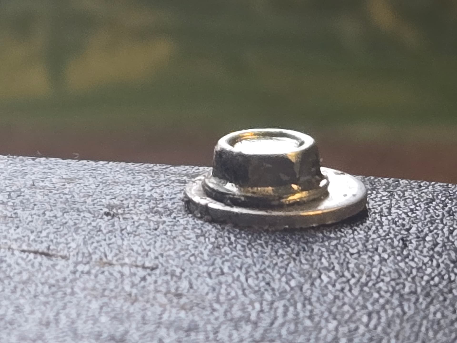

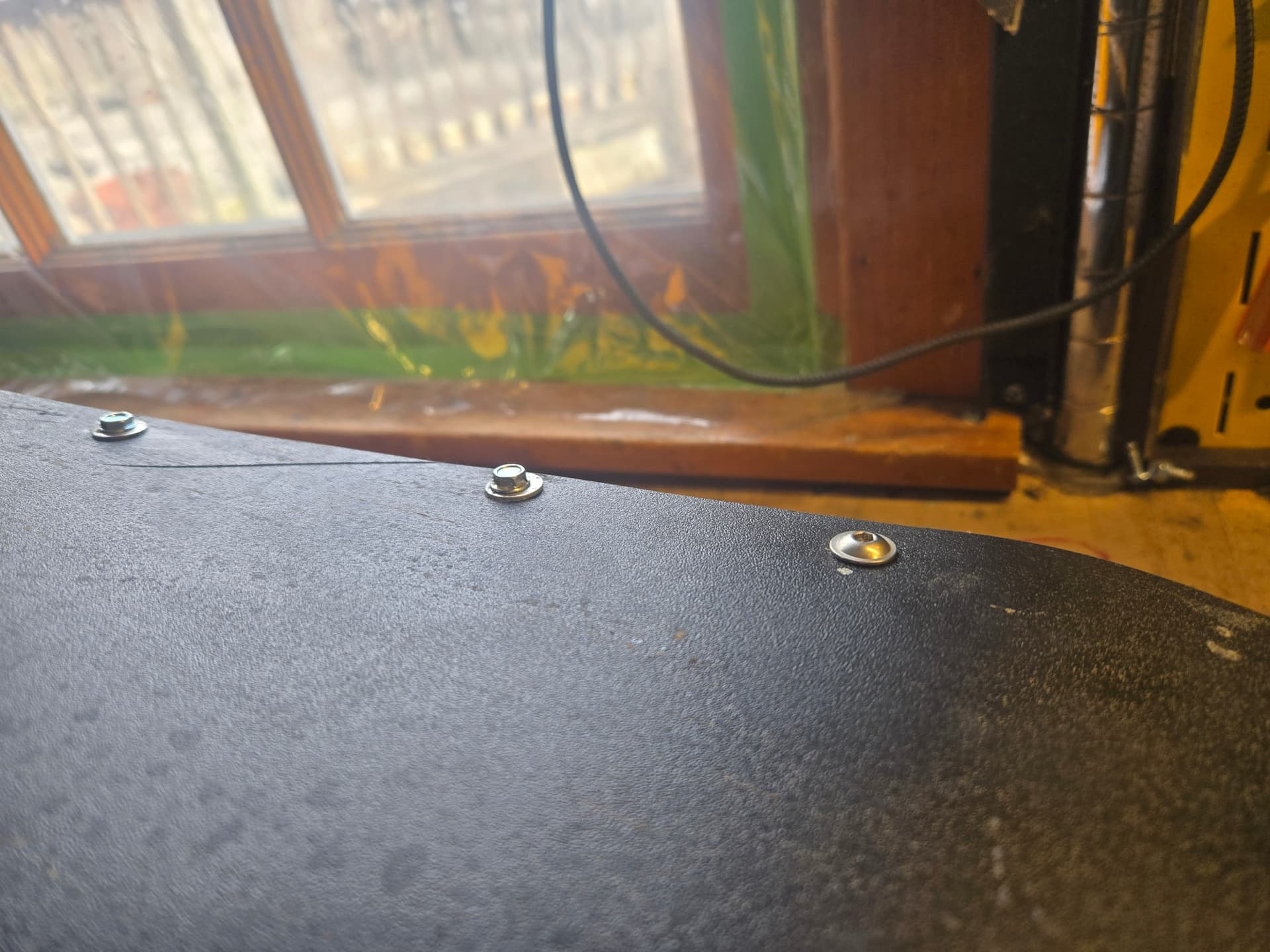

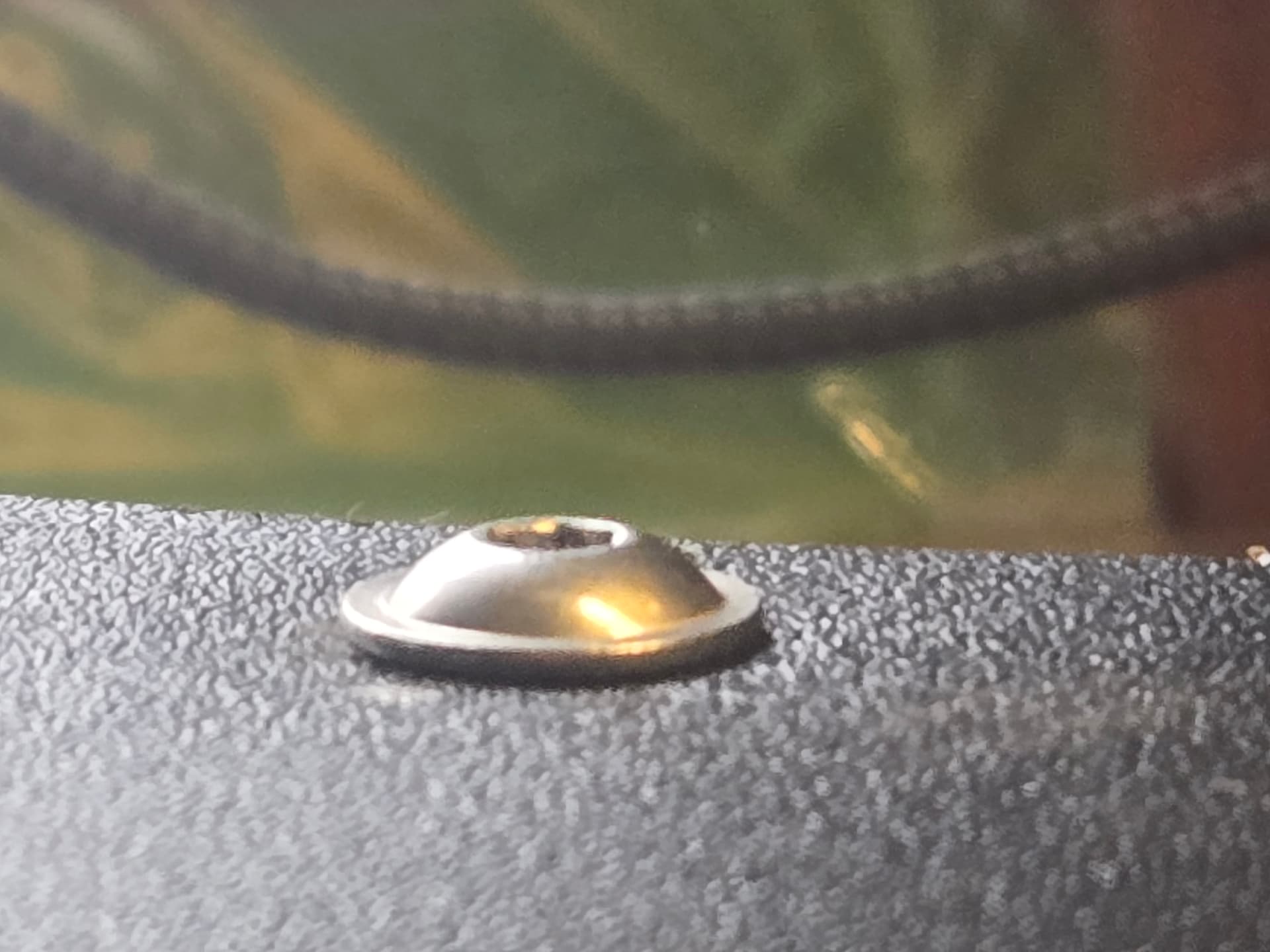

I tied up another loose sand on this board which was changing the to screws on the bottom that are holding the ABS sheet.
The new screws are much lower profile, looks so much nicer
I’m really happy with how putting these fool ABS sheets on the bottom of the sports turned out.

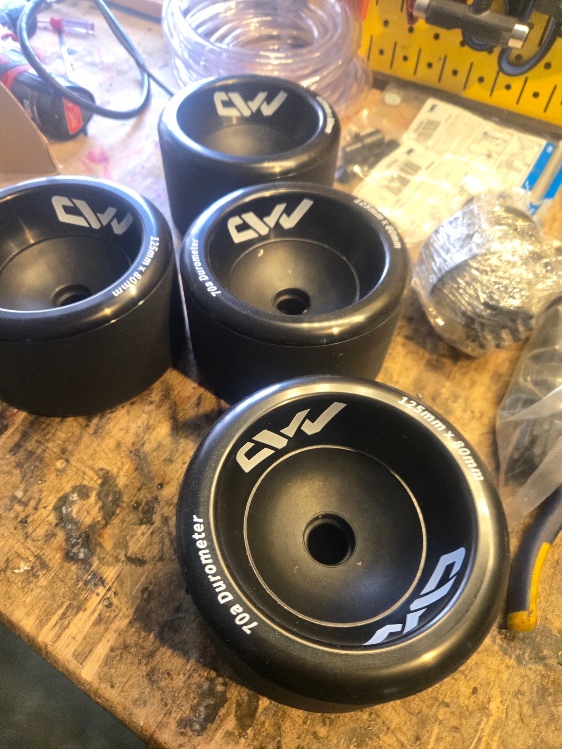

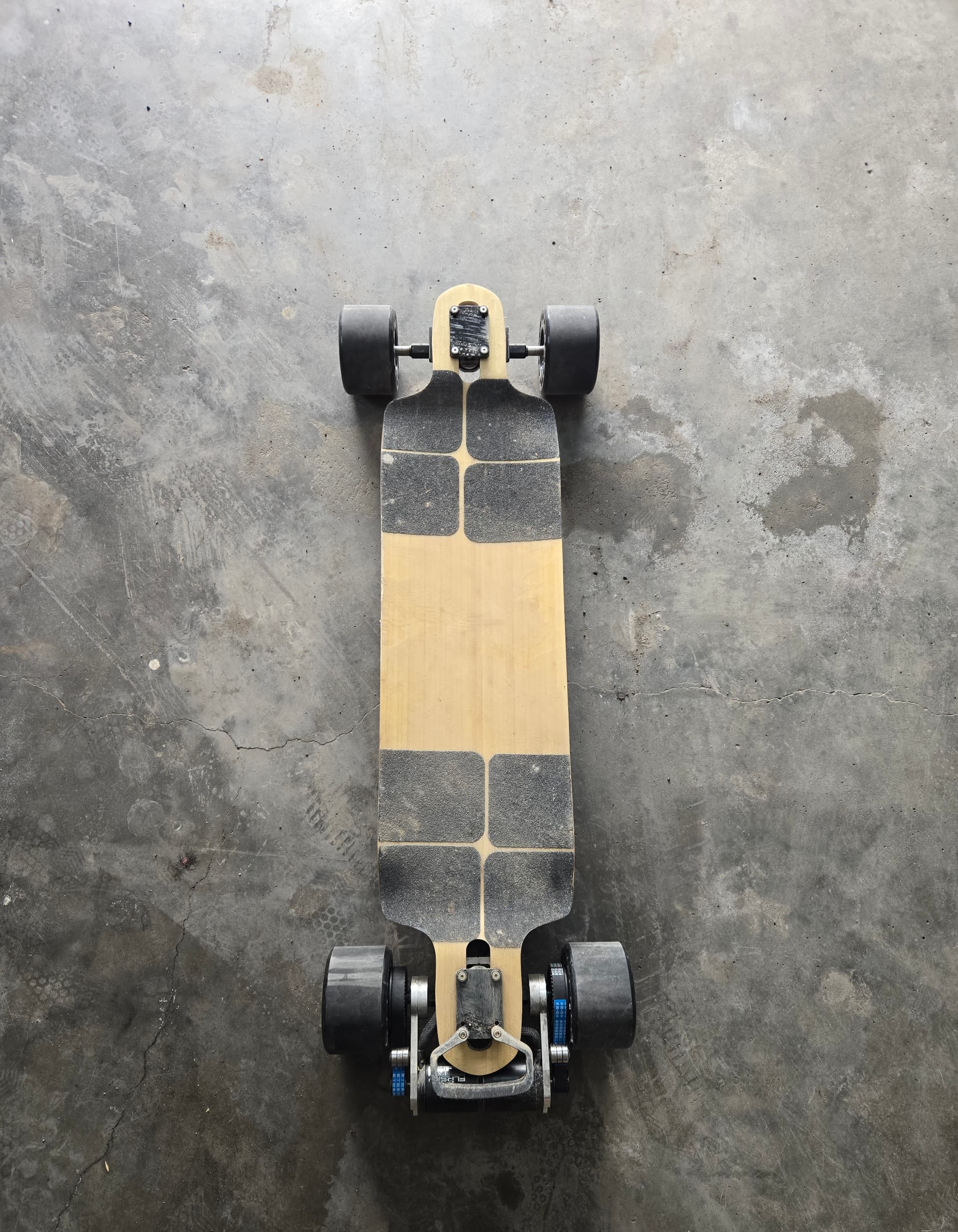

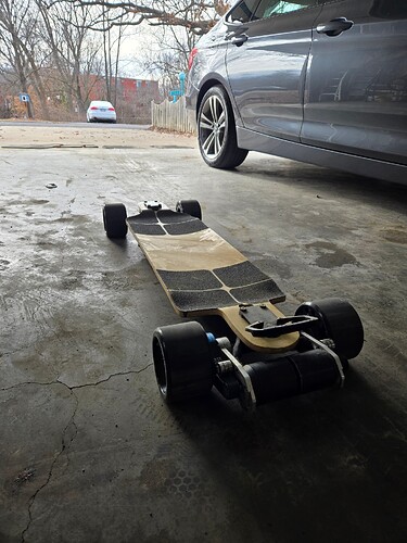

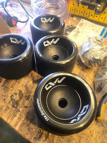

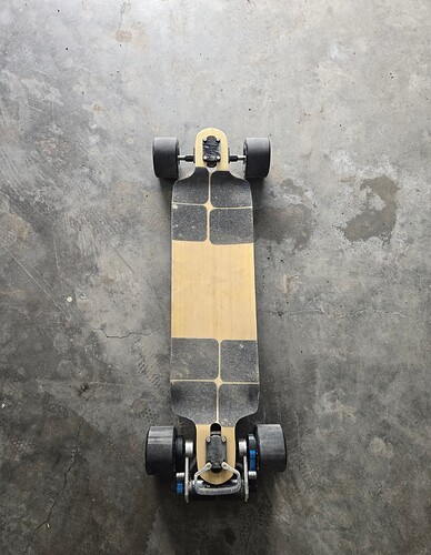

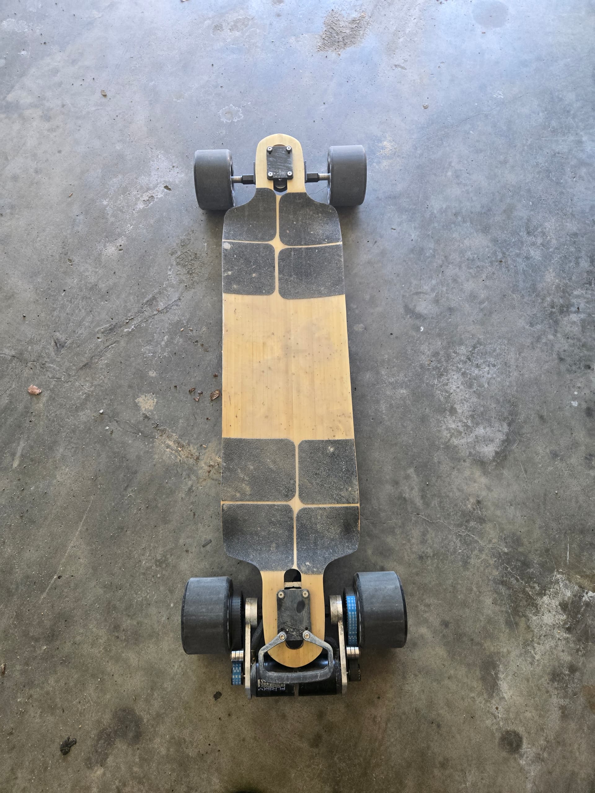

I got a beautiful set of gorgeous,gorgeous,gorgeous, glorious giant wheels!!!
The reality is that I really need to stop buying parts.
And I fought everyday to resist these Mad Max wheels.
I would suffer. And deny myself the joy in the name of prudence…
And then I caved…
And I’m so glad I finally gave in and got them because anybody that likes electric skateboards should get these.
They are so meaty and giant, and cool.
Kudos to you @fujio001 !!!
I have always been stoked on the V1s I have.
But I’m already in love with the giant wheels!!!
The Mad Max are intended to go on the Khymera.
They look so sick on there I’m so stoked!!!
But I have a lot of work to do on that board, so I slept the MADs on the Demonseed so I could ride them immediately.
@Mikenopolis this is my only current set up running idlers.
I try to be cool like Dkwan and run the belts super loose. (Mostly because I don’t have the ideal size)
And it’s no issue with the acceleration but with hard breaking I’m getting a ton of skipping…

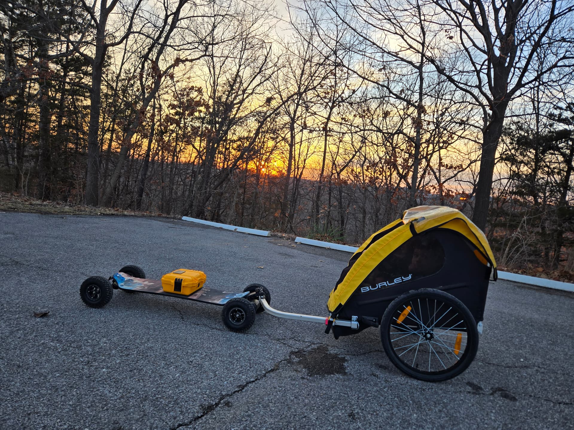

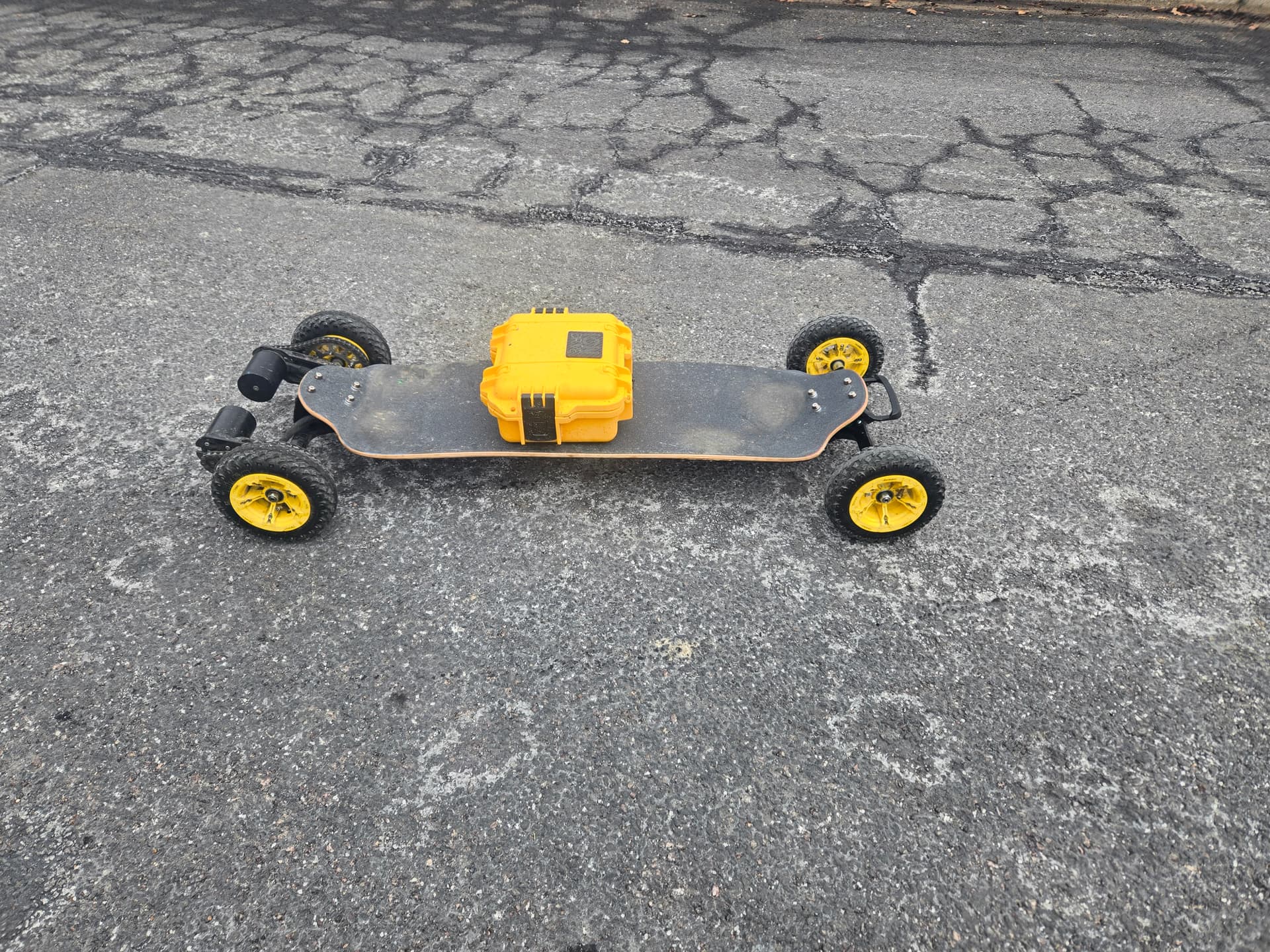

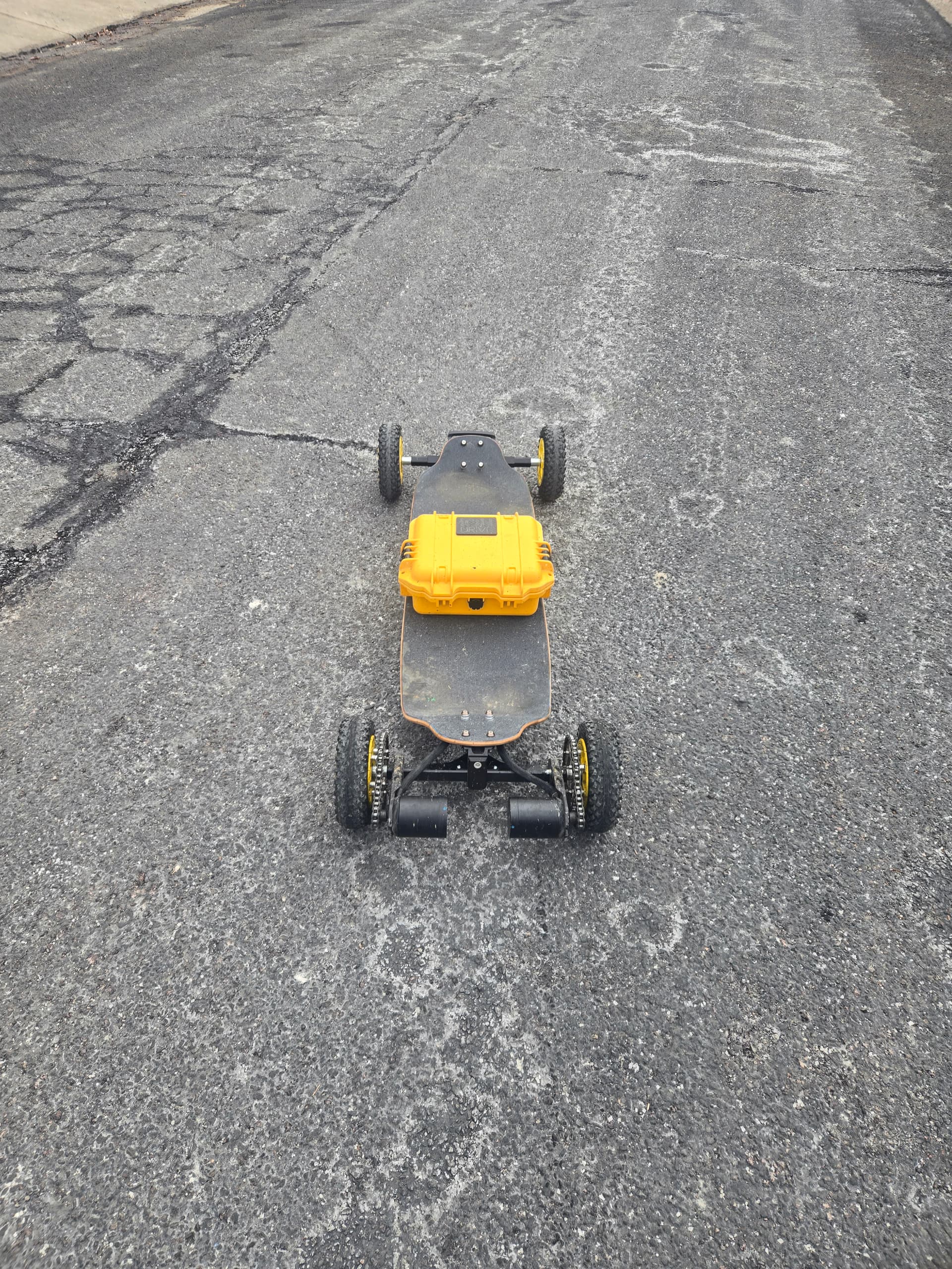

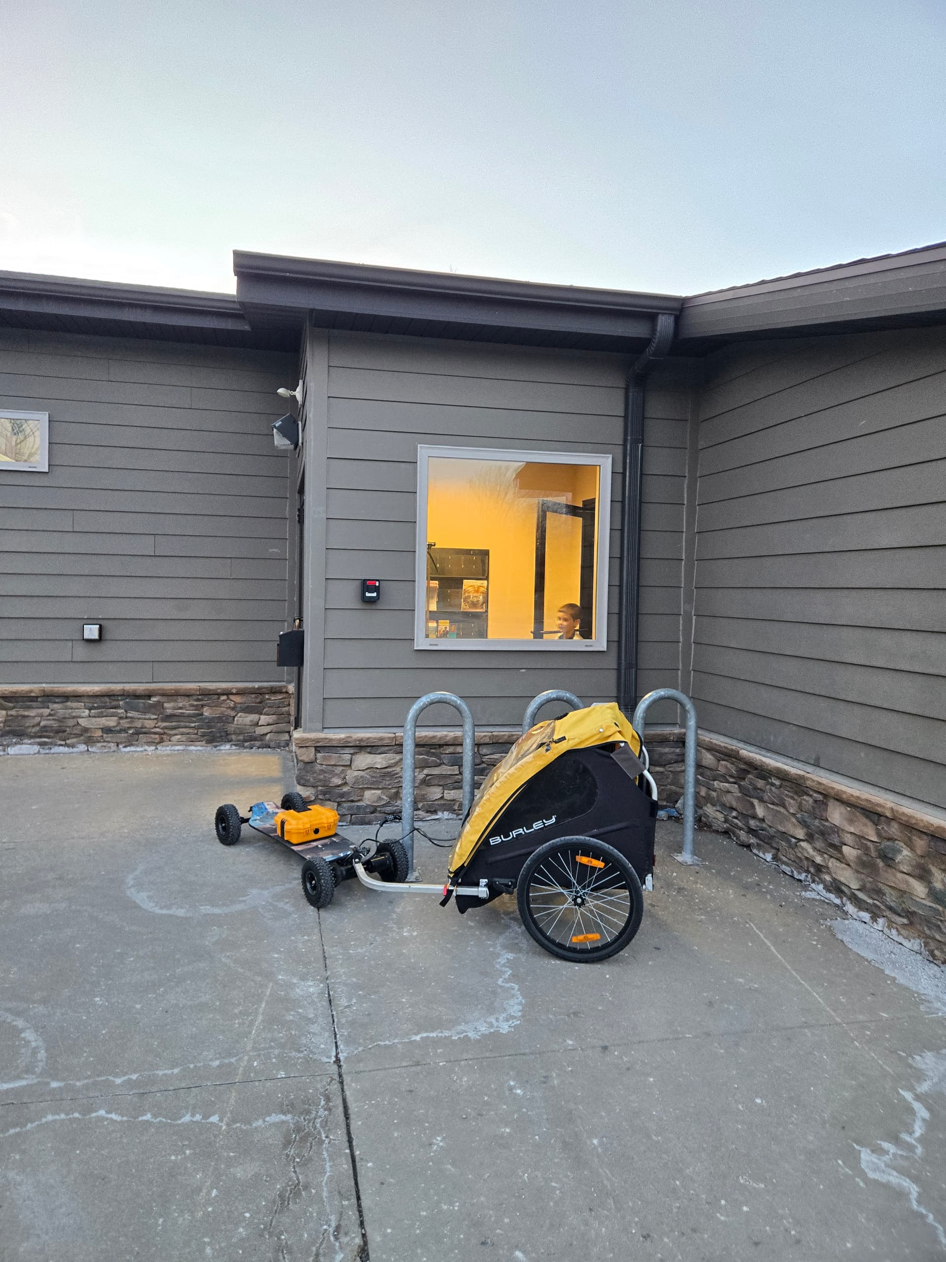

Monday continued to be awesome because it got to 60 degrees and the gravel flux was back on school pickup duty.

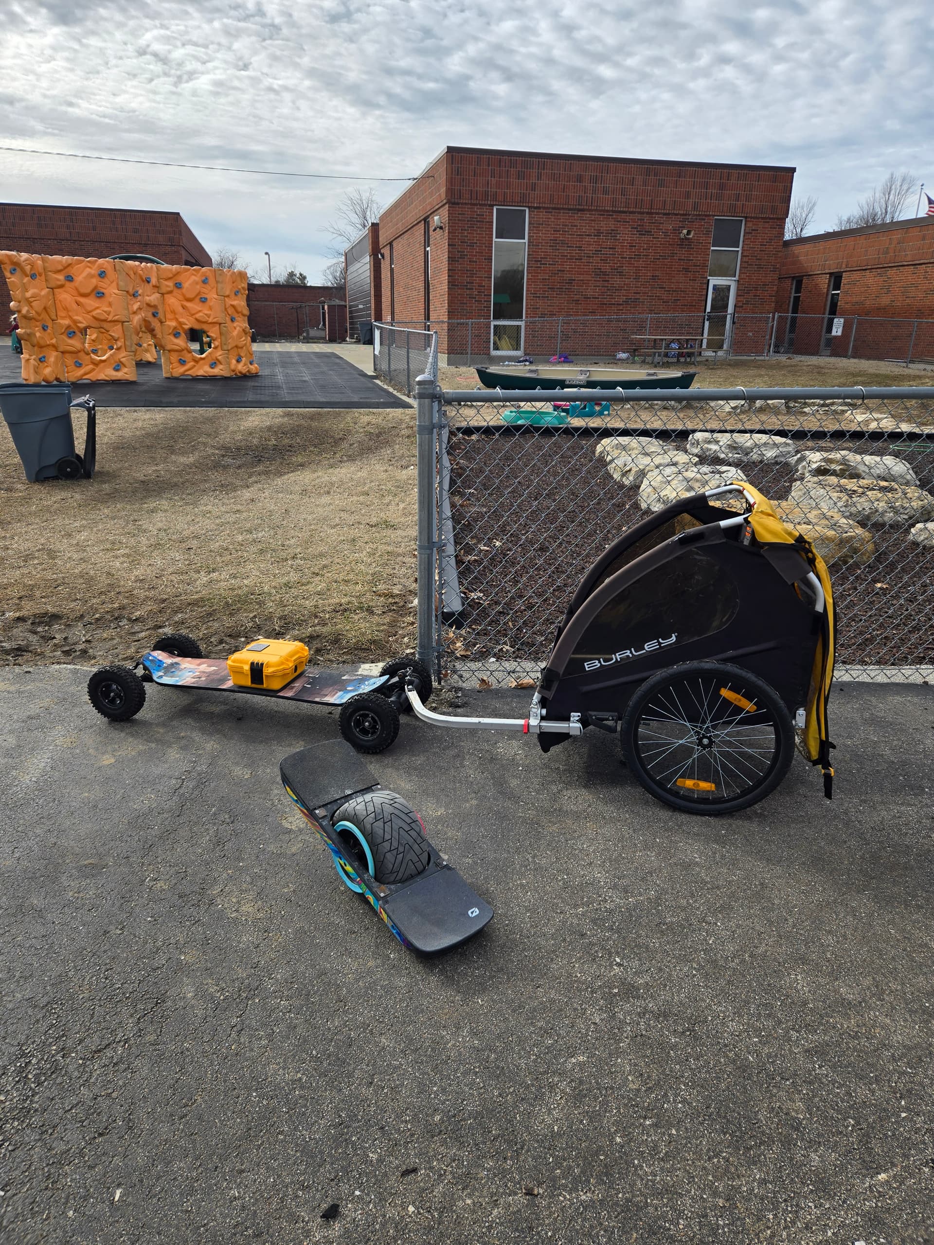

Every day after school the little dude has to go down the steep grass hill.
To middle boys getting into standing up in the trailer. It makes me want to make some kind of platform with wheels on the back of it so he can stand on it like a chariot.
The awesomess continued because the little dude had teacher conferences and we rode up there together.
And wait… We are not done with Monday rides…
The boys had Judo which is only 1.6 mi away from the house and obviously since it was nice out,I took the gravel flux.
It’s amazing how much nicer life gets when it’s pleasant outside and we can ride more!!!
